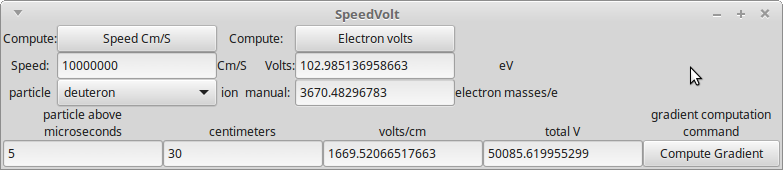

Running, it looks like this:
Put in some knowns and click to get the missing one for most combinations.
