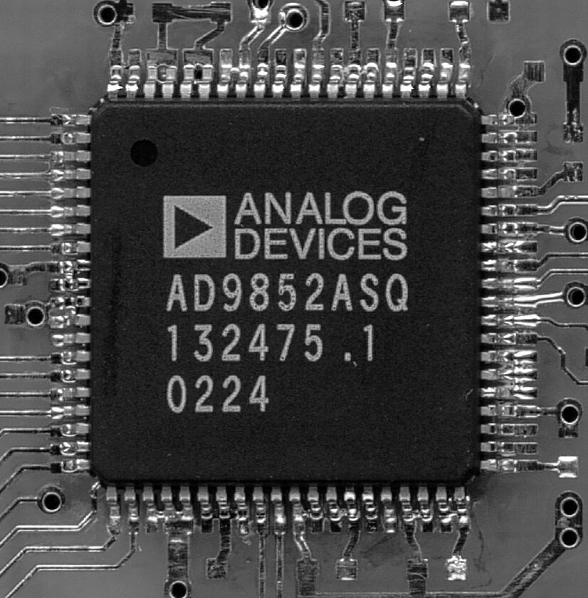

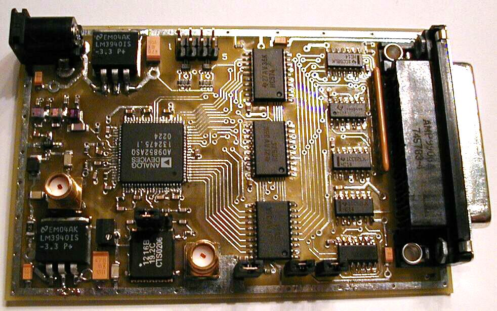

The last time I used one was a few years back to build a controller-readout for my DDS board:
DDS Chip
DDS Driver Board
DDS Synth Board

I've almost always used PICs too. However, the calculations for this DDS chip I was working with
required 16-bits. At the time (5 years back or more) PIC had no 16-bit processors. That's when

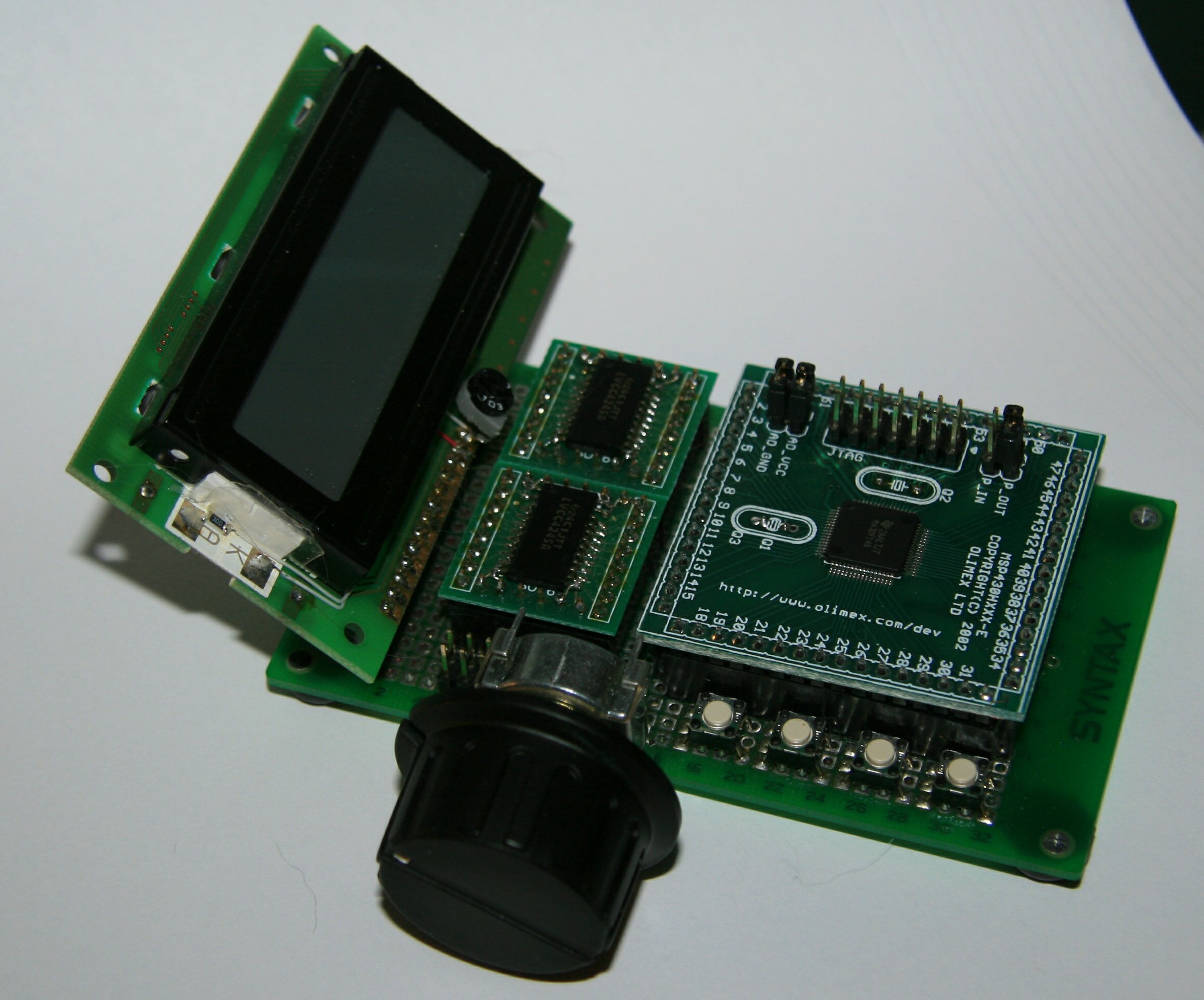

I met the guy who was writing CrossWorks and found out about olimex. I got a free sovtware
dev environment for 430s and a cheap Olimex dev board along with a J-TAG connector to the
computer. The thing I liked about CrossWorks is that it took source as "C" and would emulate
internally or run the processor on the Olimex board (single step or real time) however you wished.
BTW, The project and photo is of a DDS project not DSP. The DDS formula for the tuning word
was huge and the 8-bit device wouldn't do it. Ive got to get anita to get a photo of the Olimex
board, rotary encoder and digital readout that drives the DDS board in the post. I'd still bet
on MSP plus CrossWorks because of its ease to work with. Give it a shot sometime. The
price differential is not that bad. Get a low-end Olimex board, J-TAG cable and buy the single
user of Cross works dev environment. I think you'll see what I mean.
