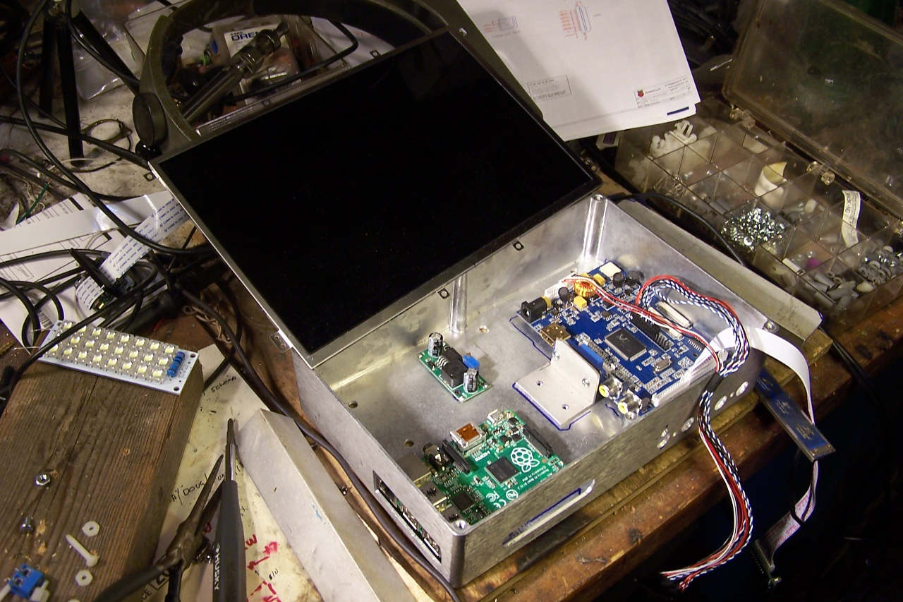

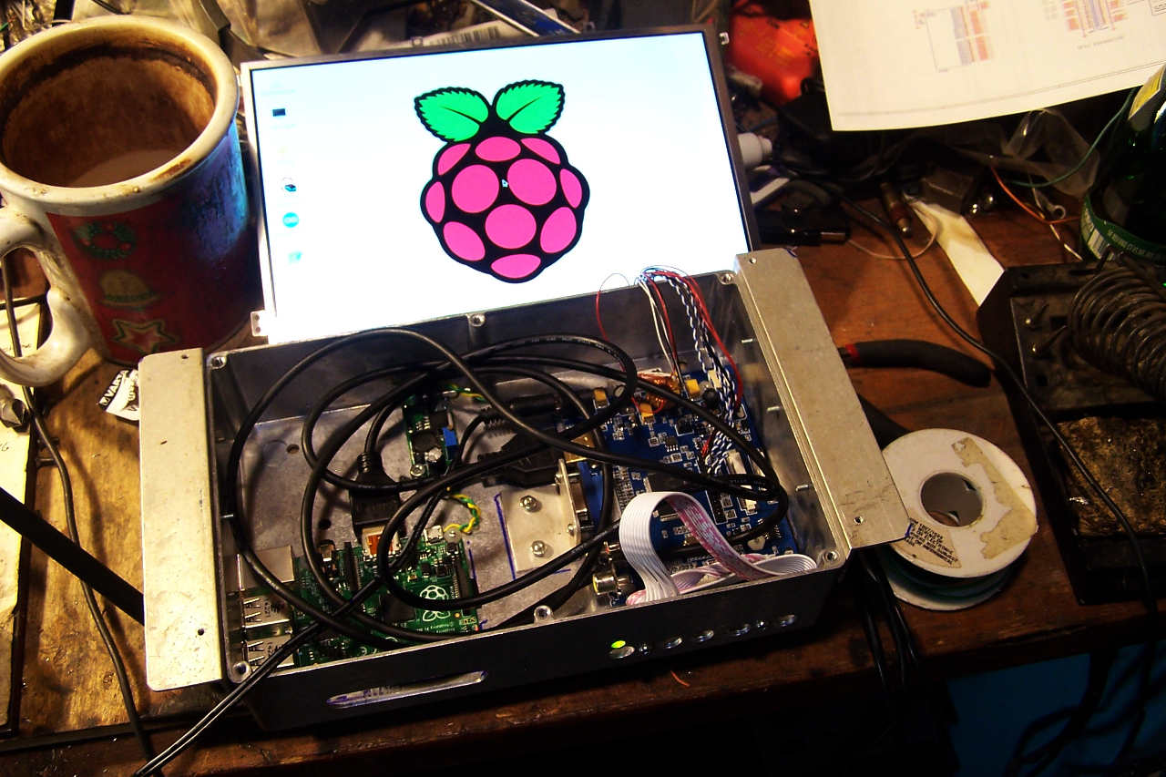

Here's some pix of the Pi hardware going together. I could bolt this box to a wall, or flush mount it if the wall is thick enough. The latter is probably what will happen, and I've left provision for that via the "wings" that stick out past the display panel that replaces the box top. I will add some (a heck of a lot?) of arduino stuff to this thread later. The basic system design is - the Pi does the high level stuff - talk on the ethernet, web server, database, plotting - the arduinos do the data acquisition, control, and anything where real time matters (Pis are glacially slow compared to a modern PC, but they still can do all the same stuff....if you wait long enough).
The basic pieces.  Pi is lower left, switcher is upper center, and HDMI panel driver on right.
Note the sneaky trick of mounting the HDMI board end via an angle bracket to the unused VGA port. Ground and a better mount than those tiny holes anyway, and at the moment, my shop isn't toolled up for 2-56 or 2mm screw work anyway. So I used a lot of nylon nuts (no shorts) and 4-40, which barely fits these guys.
To avoid invoking Murphy's law, I of course fired it up under load before buttoning it up.
Pre-test.  Yes, it's ridiculous to have 2 meters of HDMI cable wound up in there.  I'll find a short one sometime soon.
Since that seemed to work, I buttoned it up and did a more real test, full DC power loading, web server and so on. That's me showing on the screen in the back, served up by Apache running on the Pi...could be worse.
I just love it when things work on the first try...

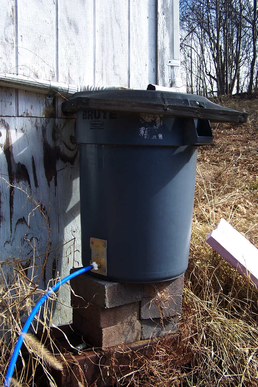

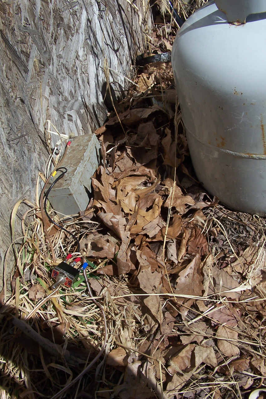

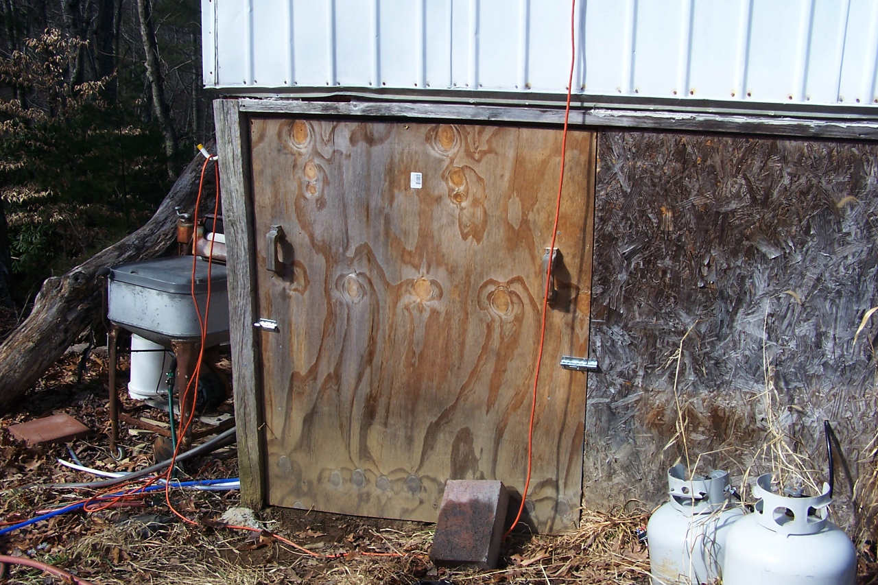

As luck would have it, I caught a day of reasonable weather to install the automation stuff, or well, most of it, into the water system. This involved swapping out the ball valve and garden hose at the supply/collector end of things, replacing that with a nice brass fitting and quick-disconnect for 1/2" NPT, and running some blue PEX tubing down to the cistern end of things. Here's the collector end:
Note, screen over top, overflow hole, pickup not quite at bottom.
This originally took a lot of time and thinking to perfect, it's not as simple as it looks, quite. There is plastic window screen over the top, with the intakes from the gutters near-horizontal. This filters out any large chunks, and the flow tends to wash them off the screen - that's important, as you don't want, say, water through rotting wet leaves. There is an overflow hole in the side of the trash can (which is looking good after a few years in the sun) to eliminate anything that floats. I don't use any water that hasn't brought this to overflow, which a suprisingly small rain will accomplish (~512 sq foot of collection area). This washes off the floaters, and also tends to dilute anything that was already in the tank in case it wasn't so hot - even that thin layer that we don't take at the bottom can grow algae etc in the sun. Since the trash can is free floating, occasionally I pull it out of there and clean the insides. The bottom is often just a little algae and mostly little rocks off the shingles. Half a cup of bleach and a little sponging and it's like new. This is a good system for where I live. There are about 3 weeks yearly when I can't use this water, and it's because of pollen seasons spring and fall. That stuff is "turbid" and will grow bad things as pollen is bacteria's favorite food, we have sun...and so on. Of course, this is why I want and have a large cistern, kept in a crawl space and in the dark. Without light and cool - not much would grow in there even if the right other stuff was present, and in fact, after running all my water through there for a year, there's about 1/8" of crud on the bottom. Won't be hard to remove with a siphon since it was a spot sprayer tank and has a big screw on lid for access (other than the other holes I've put in).

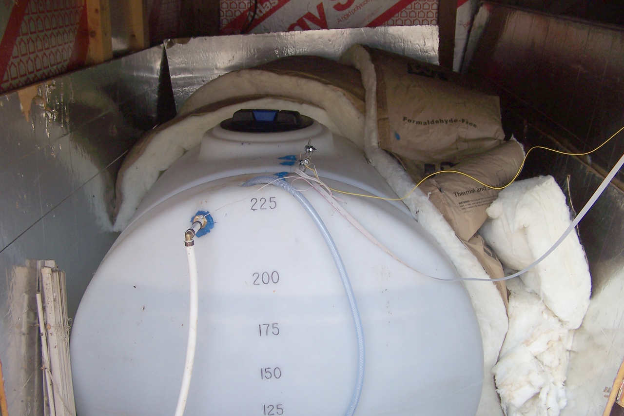

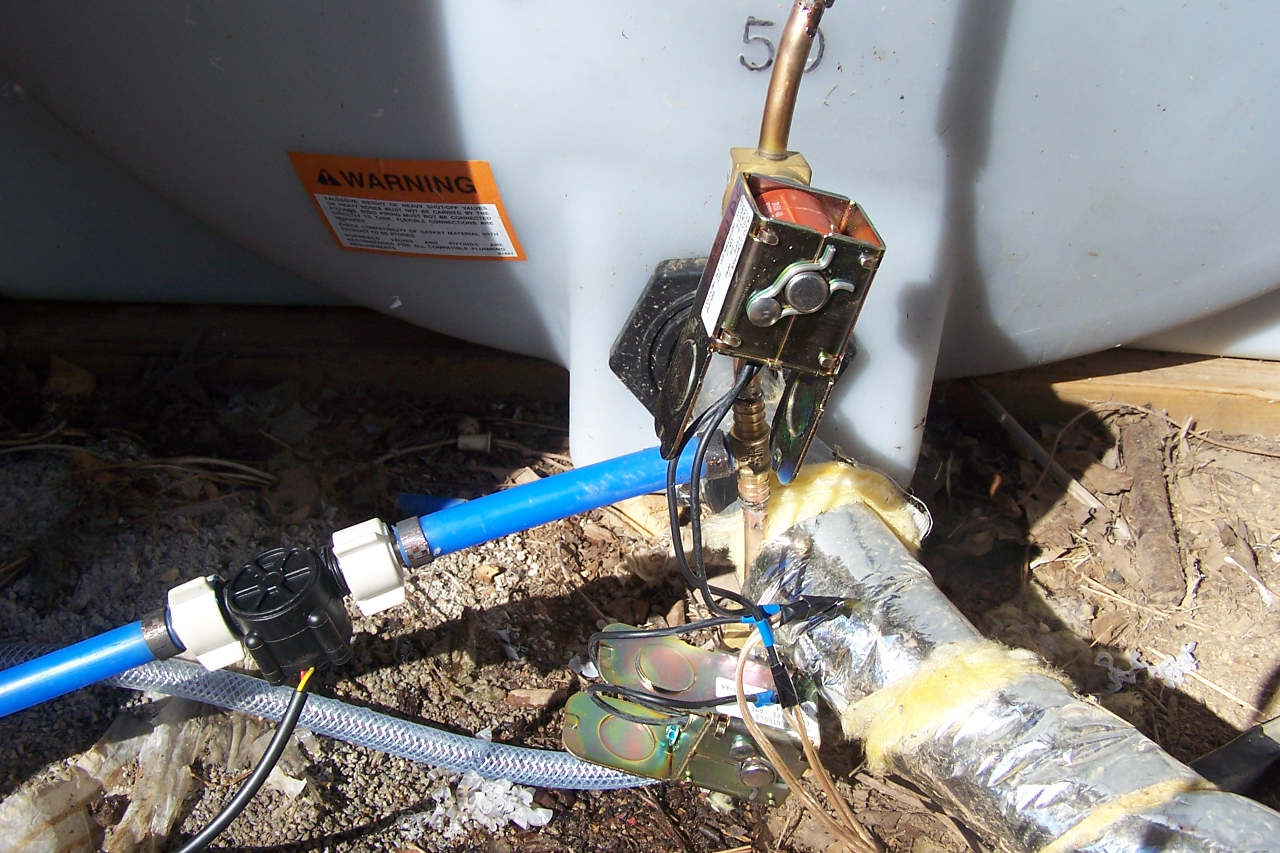

So, here is that end of the system.

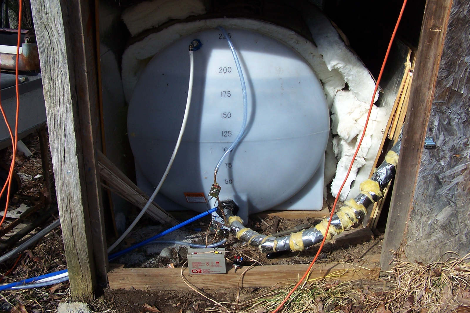

Cistern, overflow/sensor and valves.
Since this is gravity-feed with only a few feet of head, the valve selection was all-important. For example, nearly all electrical solenoid valves require some fairly serious pressure to actually open, and most of them have a tiny aperature compared to the fittings even then. The ones from Adafruit are like that, and they are the better of the bunch out there usually. As luck would have it, I had obtained some other, high quality valves I think were meant to be in a refrigeration system, surplus. While rated at 24vac, they also work well at 5v DC or so, which is how I''m using them and will once the Pi controller is in charge as well - DC is one fet to switch (per valve), AC is a little trickier. And I have the DC. There is an emergency overflow at the top (white pipe on brass fitting) "just in case a computer makes a boo-boo" even though we all know that never happens </sarcasm>. The brass fitting, installed via drilling an almost big enough hole, then heating the fitting above the melt point of HDPE and screwing it in, is also going to be the topmost level sensor contact, that system part described elsewhere. I've already drilled and tapped it for a 4-40 screw and lug for that. The permatex is for "just in case" and I used the good blue stuff.
Below that, there are two valves. One is to let water in, the other is to let it out onto the ground outside. That one will be handy when we've got a half collection can of junky water we don't want in the system - we just let it go out. Or perhaps we want to drain the line (which will be buried at some point) because some of it might not be buried and might freeze, a pain. The other one, that lets water in, will be activated by one of the computers in the LAN of things project, not sure which one at this point...I'm trying to hold down the number of arduinos I need at this building, and might use some Pi I/O for that part, since it's very not-time-critical and requires more "judgement". There will have to be water level and turbidity detectors at the collection end as well, for the right decision to be made. And oops, though I bought one, I forgot to add the water flow sensor (Adafruit) I'm going to want to have in the intake before the valves. Next nice weather, I suppose. For now, It's sealed back up, since it's supposed to get nasty-cold (for us) again real soon. Those valves draw around 6w with the battery and switch on DC (rated at 12-14 on 24v AC) but really, that's not a huge solenoid and you'd not want to leave them on forever, even if power wasn't a consideration - they get nicely warm as is.
Sealed up with insulated door for the cold.
So, now I can eat breakfast in peace...at 1:145 pm....and know that no more standing in the rain is in store for me for a long time. I no longer have to sweat overflow...for one thing. I can just check for overflow (from a window) go out and turn on the v valve, and come out again later to shut it back off. Instead of standing in the rain, waiting and waiting to get the thing "just full". Next step is to install the level sensors on the cistern (and make another set for the collection tank along with inventing some sort of clarity tester). But the UPS guy just brought me a bunch of new toys from Ada - and one of them is a very nice arduino screw terminal shield I intend to populate with the wired-or serial stuff and whatever else. NIce to have screws for wires from sensors too....will make any later maintenance a lot easier, and by then, I'll want to do it less, and be less able to. After all, this whole thing is to allow me to grow old, infirm (and I'm already lazy, at least by my own standards. Heck, if I start goofing off after only 10 hours of work, I feel guilty.).
FWIW, the resulting flow rate is about twice what it was before, using 3/4" garden hose and full size ball valve. That PEX tubing is very slippery inside compared to most other plumbing things. You can usually use a smaller size. In this half inch size, you can freeze and thaw it - with no damage whatever. Kind of useful where I live.
And now here I am, in the warm, testing the Pi Cam with 2 meter cable..the little bluer screen is the pi, the bigger one is a NUC...the rest is just a mess. I scaled down the pi pic around 2x...it's really high resolution, not needed here. Having just assembled an arduino screw-shield, I'm going to put the serial wired-or parts on that, and get ready to test with all the other sensors too. The original Uno code didn't take the required timing into account for a "speak only when spoken to" interface, so I get to change that code as well. Then add more stuff until I run out of pins...

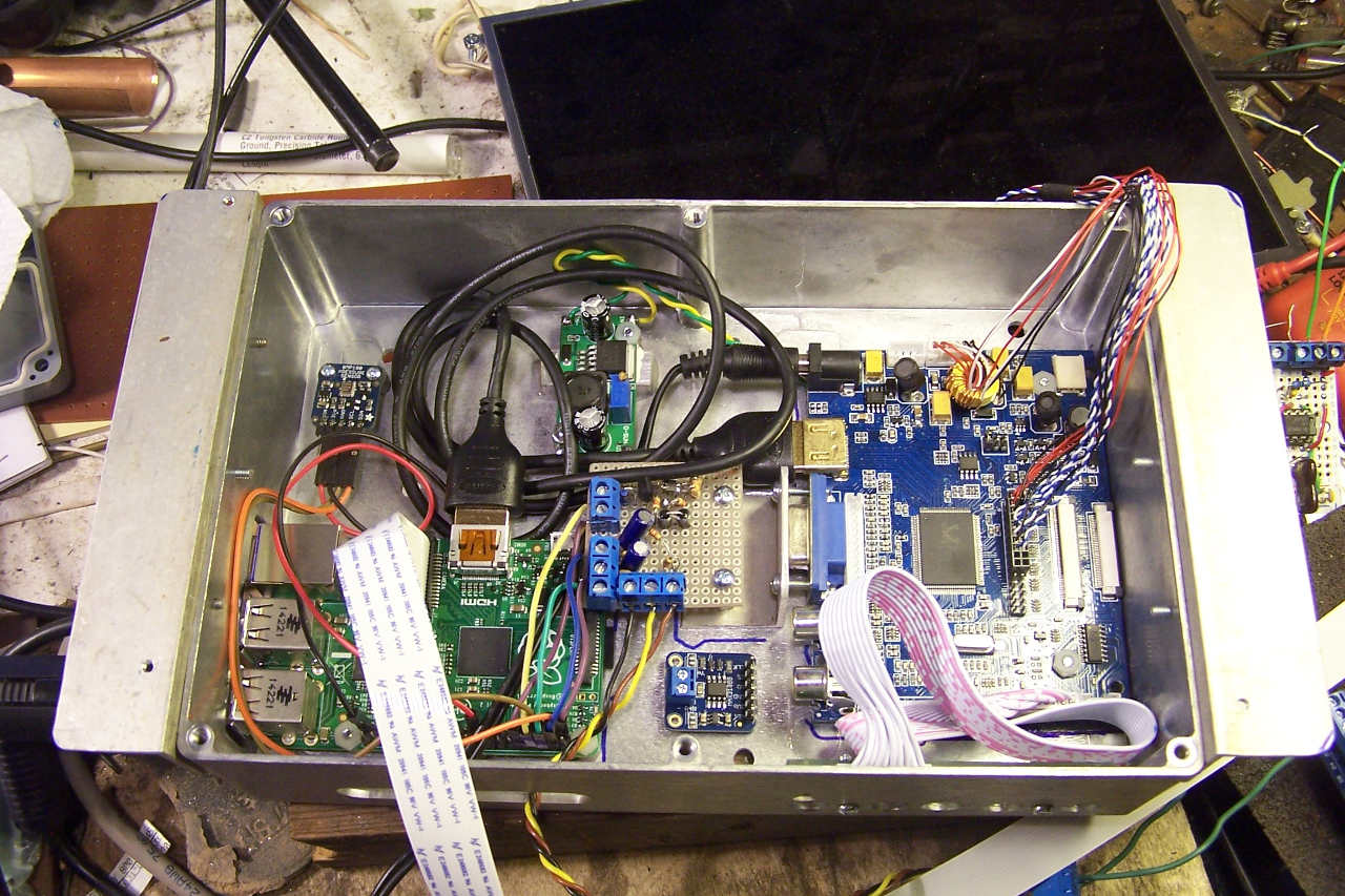

Here's some more pix of things in progress. The Pi has some new contents, as I decided some things might just as well be right in the box with it.
the Pi box
the Pi box
Clockwise from upper left, we have the BMP180 barometer/temp sensor, the ~~12v to 5v switcher, the HDMI/DVI display driver board, and about-to-be-mounted thermocouple breakout board (for woodstove flue temps in that building), the Pi, right now a B+ but I'm planning to upgrade to a Pi2, and in the center, the serial level converter/driver for the slave arduinos.

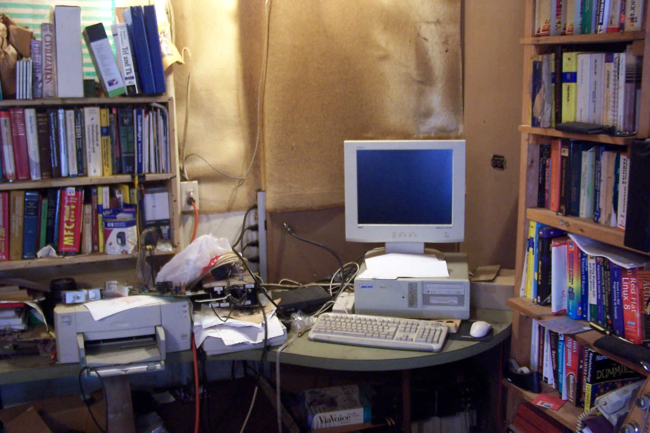

It's going to go here, in my old "office trailer" where I plan to move - and make a lot less of a man-cave than this place. That's the trailer in the movie above, about in the middle, backside. I want to put together a more-normal living situation in it, maybe even (gasp) get a girlfriend again. No human female would ever hack my current man-cave (at least, probably not). This is one of the old op positions from when I ran C-Lab from there. While it's no longer a 386, yes, that ancient NT4 machine actually still works and I recently recovered some cool old software we'd written from it. Of course, that will be seriously upgraded in the near future, with multiple monitors, the Pi box in the wall, and the obsolete books put in deep storage or discarded, to be replaced with current stuff of more general interest. Some benches etc in there will be torn down, and a more normal living space created via that and an add-on (with real insulation and porch) added this spring.
The intended op position, before I clean things up.
The point is - I need a place further from the fusor to run it from, and this "LAN of things" project will include the stuff to run the fusor from there - about 30 yards away, so the air and inverse square law eliminate some of the radiation I get. The other point is to automate a bunch of this "homesteading stuff" so living here is more like what most people experience - except without the ongoing "rent" costs and with less labor. I'll keep my freedom, thanks.

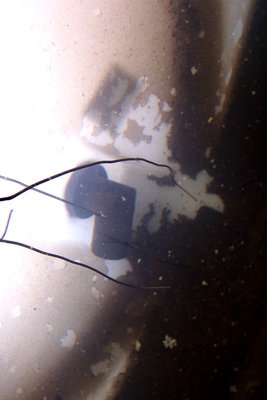

Well, $DIETEY(s) of home automation have smiled, and rewarded some effort I've put into this. Today, I added the circuit board/mount and wiring to the cistern (I put in the Ti wires yesterday, and the sealant is a little soft, but it was hard to wait), and lo and behold, not only did I NOT hit my head, it works! I am seeing ~9v on each output from a sensor wire under the water, and about 90mv on the one that isn't.
Should be relatively easy to tell from the arduino's a/d what is going on (and yeah, I'll probably put a 10k or so series resistor in there...just in case).

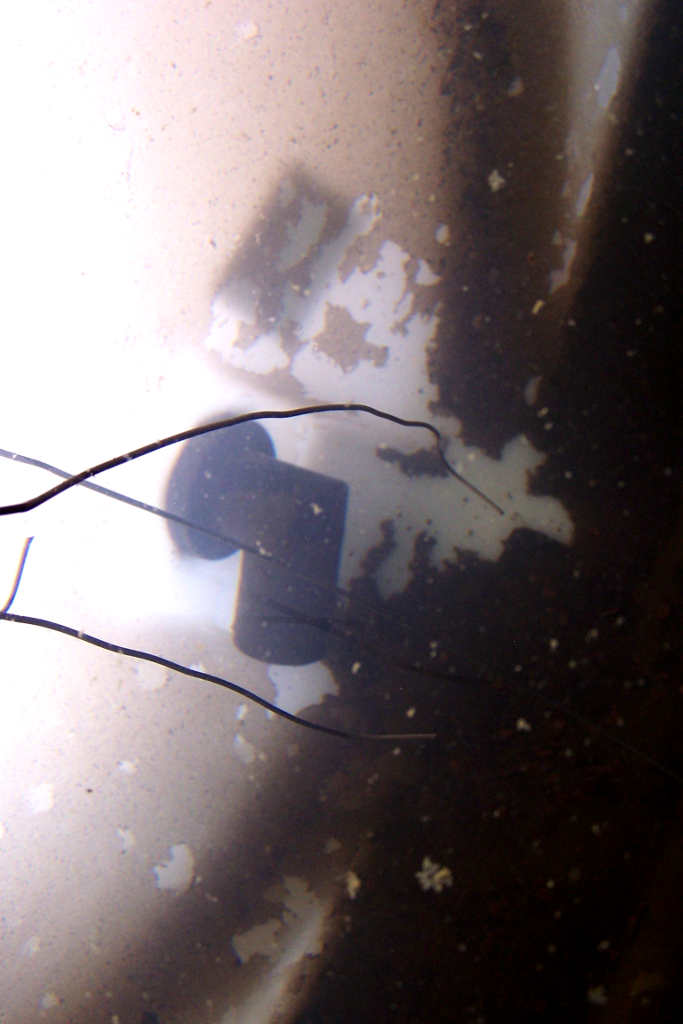

Here's the inside. I've let the tank get kind of dirty - but it's easily cleaned later. Good luck that the shavings from drilling the holes float...
Remember, it doesn't have to be pretty to work, just not shorted and the wires the right lengths...

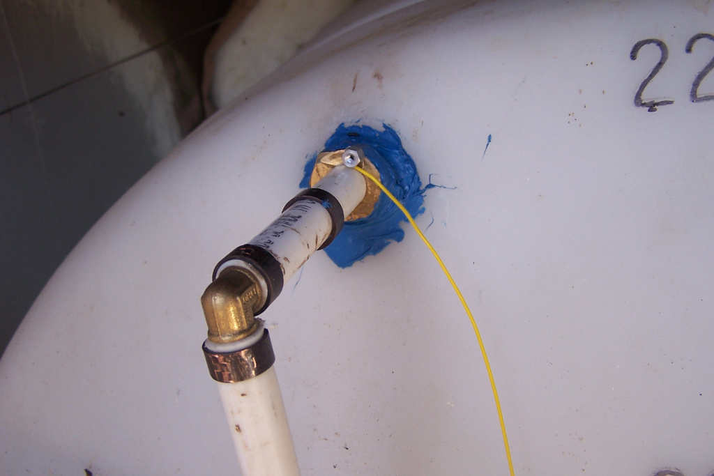

Here's the overflow sensor (and actual overflow piping, not that I trust it to keep up with a fast intake).
Maybe the most important single level - too much.

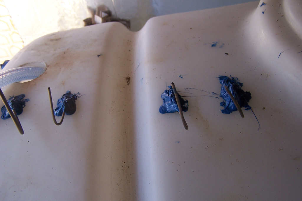

Here's the tank top with the probes "installed". Looks like a joke, but I bet it works fine.
Drive wire at left - goes to the bottom and along the length of the tank at bottom level.  The other three are the intermediate level probes, shortest first.
And all wired up and tested...yes, it works fine. Plenty of "margin" running the 555 sq wave from my ~~13.3v basement UPS system (that will also drive the arduino after a switcher and the pi that will control it, at some point, right now they're over here for programming. And more programming.) I wanted to get this in now, as we're about to go back to crap weather...and I can now do more programming on the pi and arduino now that I know what numbers to expect (well, better than a pure guess).

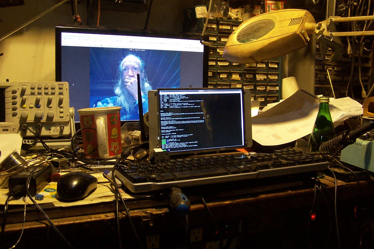

Some results - here's my ugly mug in my mess working on this from the pi camera. It's really pretty good (despite poor material to take pictures of).
Been working all day...on this, beer o' clock now.
I actually had to run this through the gimp and compress it from the original 3 mb to around 600k to get the board to take it at all....it's too darn good. I didn't make any other changes or enhancements, the original is better.

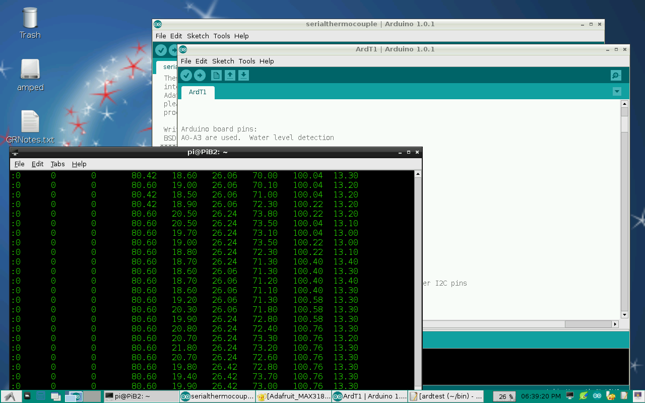

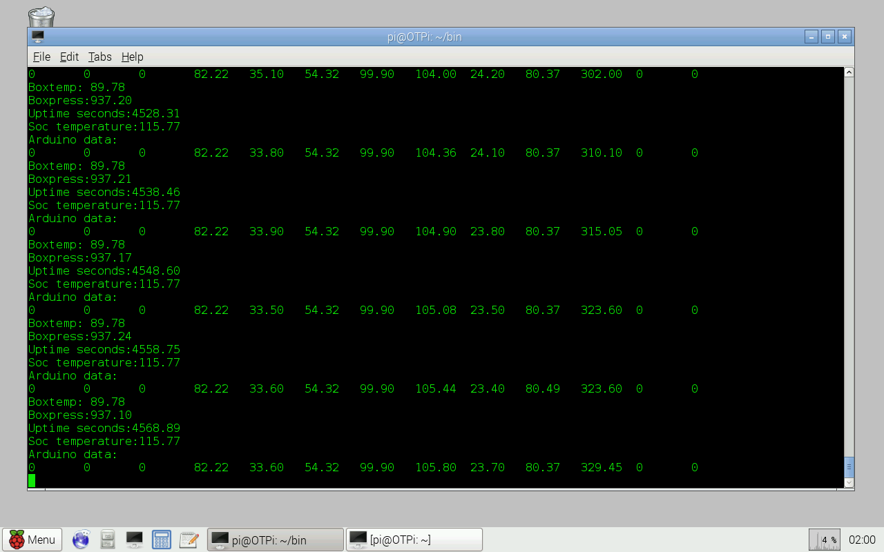

Here's the data aq screen - this is just prototype code for the version that will stuff things into the database (which will be synced to another unit in another building - both need to know each other's status to make some decisions).
The sharp eyed will notice this isn't on exact time intervals - working on that one, for now, it just sleeps between taking data and printing it (it won't do that in the final version). I will put the "final" arduino code on another thread, it's been really stable, and while I could dandy it up a little (low pass filter or median smooth some noise out etc), I might not bother. We'll just see how the cpu cycles come out - the arduino has plenty to spare, so it's a matter of where to do work to keep things responsive, and get the most mips/watt/piece of hardware.
Raw sceenshot from pi
What we have here on separate lines is some data from within the pi box, then some data from the slave arduino (which is now more or less out of pins to connect stuff to).
The arduino format is:
Water in cistern (not wired up, wrong building right now)
Water intake rate (also not wired)
Water outflow rate (also not wired)
Indoor temp (deg F)
Indoor relative humidity (%)
Outdoor temp
Outdoor humidity
"basement" temp and humidity - sensor is right now by my woodstove, but it'll go by the water system in the basement
Thermocouple cold junction temperature (thermocouple is for a woodstove flue)
Thermocouple temperature, currently near my soldering iron to get a nice high reading.
State of water inlet valve
State of water dump valve.
In real life, I'll probably have this combine data at whatever sample rate (it can be fairly fast and not eat cycles badly) into a summary for stuffing into the mySQL database about (hopefully exactly) once a minute, which is still on the fast side for "weather" data, but about the right speed for making decisions about water, heat, power use for heating water, and so on.
I'd have liked to have one more pin on this guy, but I'm fairly sure it would take a little modification to use the SPI data-out pin for something, since I'm using the other pins for the thermocouple breakout - it probably spews random stuff.
What for? Wouldn't it be nice to have a switchable heater under the water supply in winter? I have the heaters and relays. I'll have to fool with that more to see if I can find a way (and keep it reasonably simple, eg, no special modified libraries, want to keep them all "stock"). I seem to have some free gpio pins on the pi, though - we'll see what I can rig. Avoiding yet another box of electronics and its power drain are fairly high on the priority list here. Had I known of the possibility of using just one slave, I'd not have done all that work on the protocol that lets me have many - but again, this project IS a dry run for fusor automation type of stuff - and it will need a few slaves, so...the more the code (and hardware) is the same everywhere, the better from my POV.
I'm trying to learn the rather odd system debian uses to allow things to be on menus and on taskbars so I can make scrot an icon on the taskbar and get screenshots without the little dance I did for this one. I opened a terminal and told it to take a shot 10 seconds later, then hid that terminal. A kludge...Since I plan to be using this for many years...I'm trying to make it "nice".
