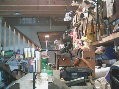

A cute trick I found while looking at flash hole uniformity. Clamp your Teslong borescope in the vice looking up (no mirror) so you can quickly look inside brass.

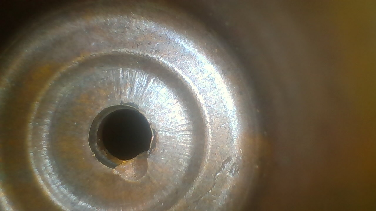

And it's not always a pretty sight. I discovered that I hadn't rinsed and dried mine after testing wet tumbling well enough - After a short tumble and rinse (since the outside looked good), I vibe tumbled with my usual walnut shells to ensure dry-ness. Except not. And some of that media stuck in there, and the remaining liquid was still somewhat corrosive....
Since the entire point of this was to get the brass uniform, and do the experiment of making it uniformly shiny inside, as if new - this was a relatively important and shocking find. Some of this stuff was NASTY, and would have utterly invalidated any test of combustion uniformity.
Here's a pic of the lashup (ignore the mess in the background! Creative Chaos, or just chaos).
Taken with low res webcam but you should be able to guess what I'm up to here.
What this does is make it easy - it's in focus, and with a finger near the end of the brass, you can avoid scraping the camera with it as you put it on there, the top of the vise sets the distance to the subject.

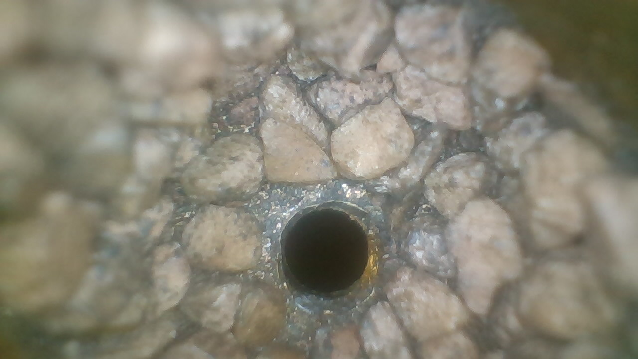

Like I said, NASTY. You can imagine what bad results this would have if I just reloaded it. Since I'm not going near full power, it probably would have been safe enough, just terribly inaccurate.
Look at the walnut and corrosion...that's a big nope.
Most of them looked like this...the others would have been fliers at best. Could have left it tumbling longer for more shiny, though.

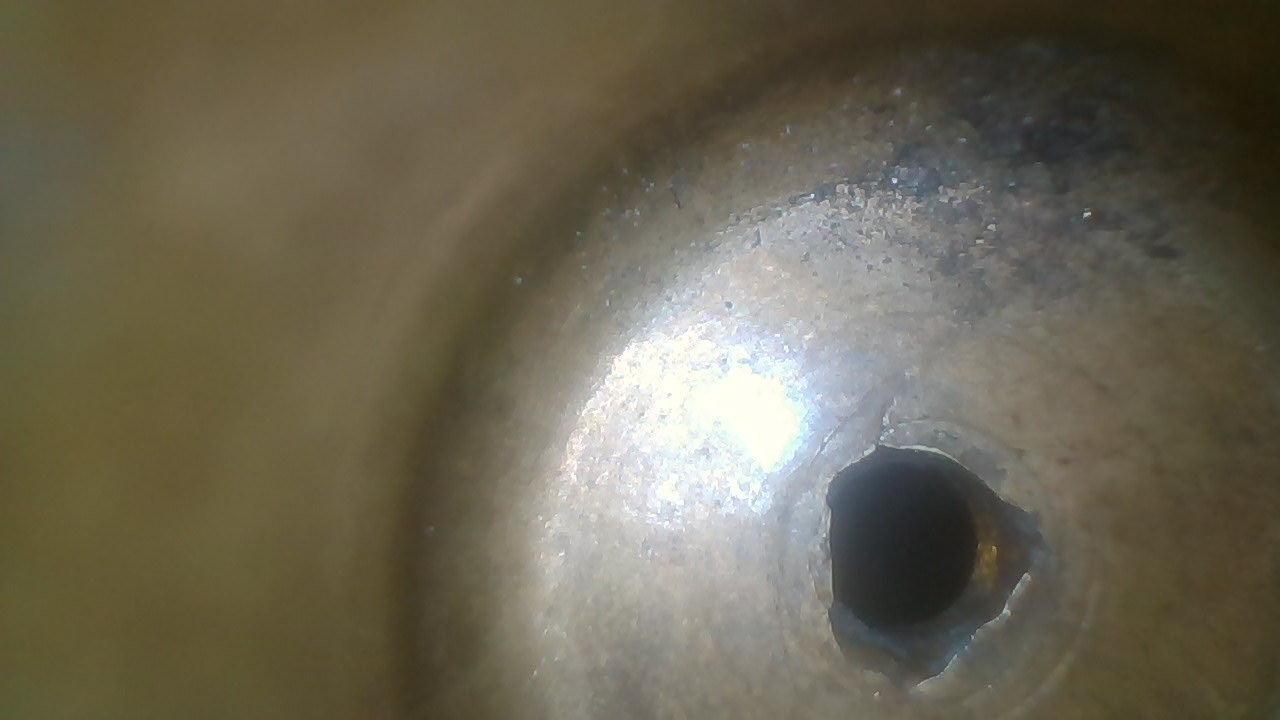

That latter sucks.. bad QC in everything from the base diameter, groove diameter and here's the inside. Don't buy!.
Every piece had this strange flash hole pattern as well - as if they knew there were gonna be burrs, and then just put in a flat punch and smashed them.

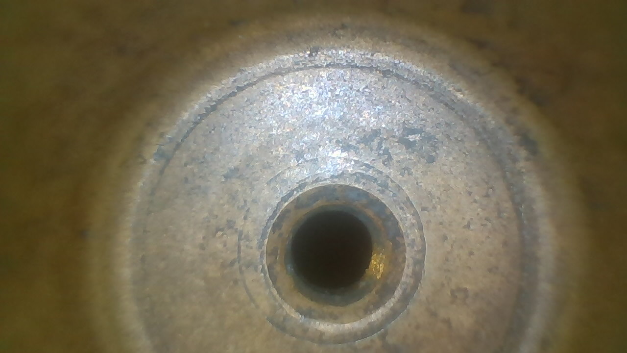

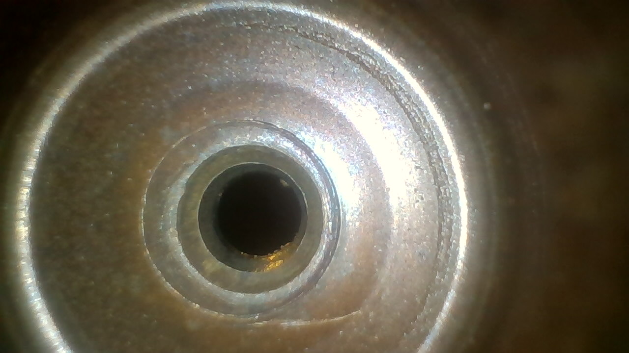

The particular two batches of Winchester bought a couple years ago I show above - there were a few bad flashholes, which is what I meant to check, but the rest was all good. The Norma was essentially all perfect inside. All 3 brands did have a couple grains weight spread across them, roughly in the same quality order as above.
The Norma was the softest brass, at least before I got to doing my own annealing, then the others fell in line.

I ordered Lapua from Midway, and will keep the Norma, which was essentially also perfect - we'll see, they're the same (high) price.

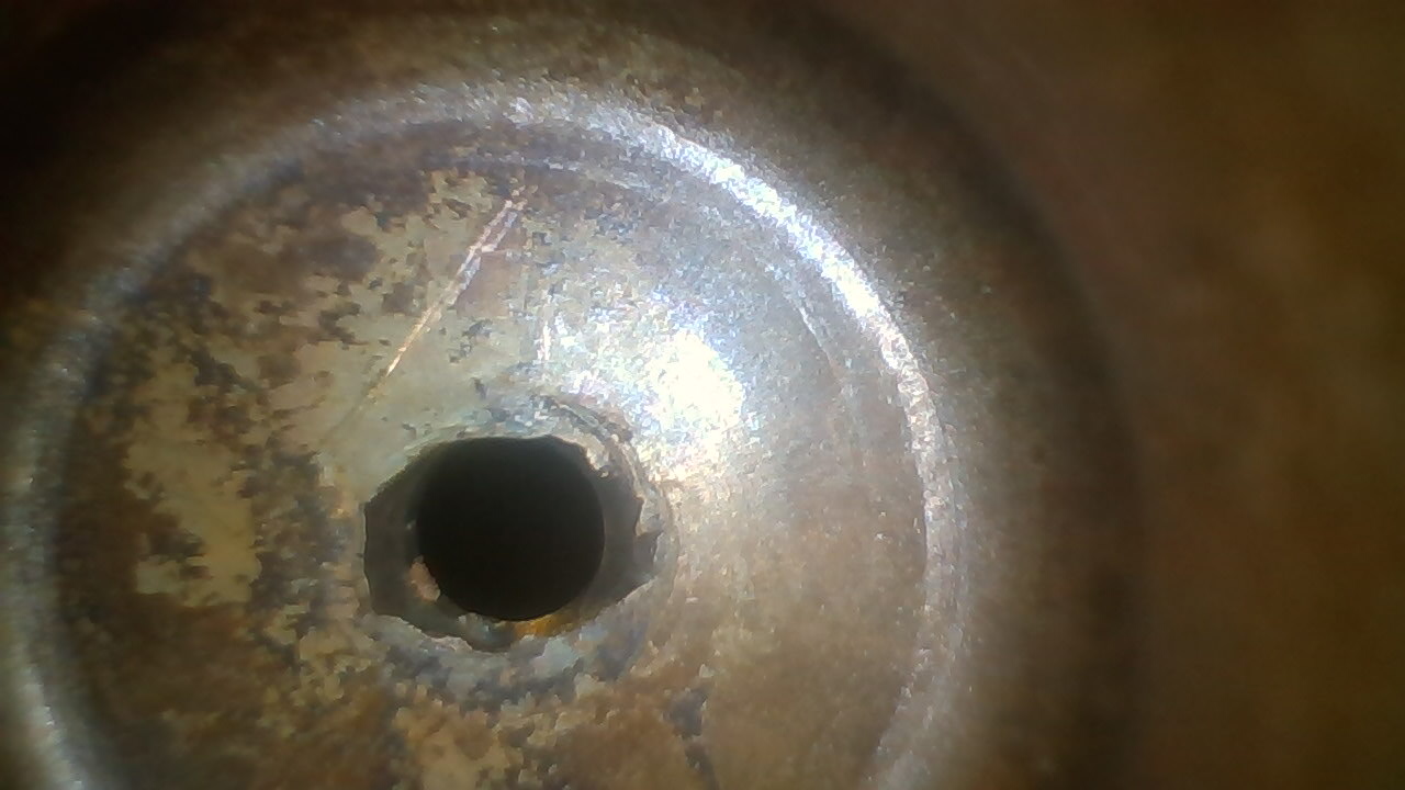

I had two batches of winchester, bought within a week of one another, and one of those was what got me hurt. Rather than try to figure out which is which...trashcan.
That Privi Partisan...well, they got the cheap worked out. Looks like they knew they were going to have a big burr on the flash hole and just inserted another punch down from the top to smash it flat.
Trying to uniform that just makes a mess and raises more burrs. On top, the control of the extractor groove diameter is all over the place. Yes, I know that swedes have a couple mils larger groove than say, .308 and I do have the right shellholders, but that's just ridiculous that a big % won't fit. So...trash. I have some more pics, but I'll have to go over to the shop to get them...it's gross. I may not live a hell of a lot longer, but that's no way to go - safety first.

Norma
Privi
One of the better winchesters

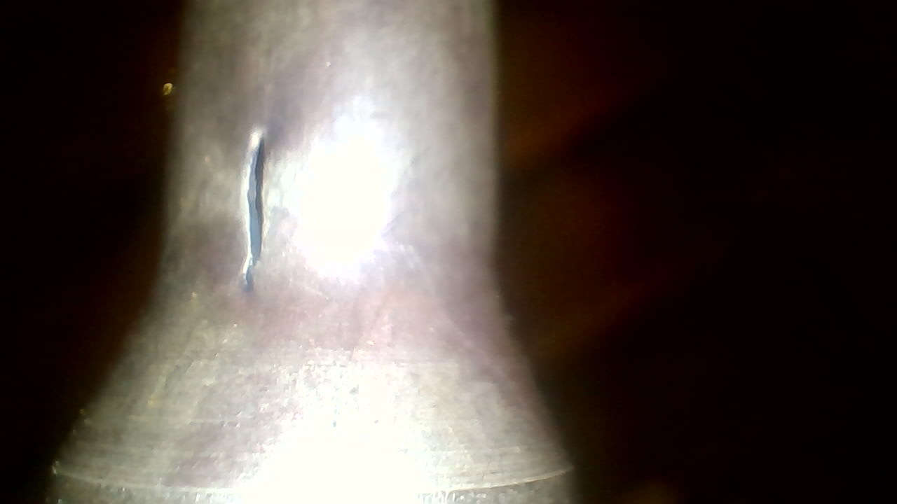

win after only 2 firings
I'm not dissing winchester as a whole. I've used a LOT of their brass, especially in .223 and .308 and gotten great, even record setting results. But it sure looks like they had a real bad day at the office here, and I guess it pays to check everything...everything.
