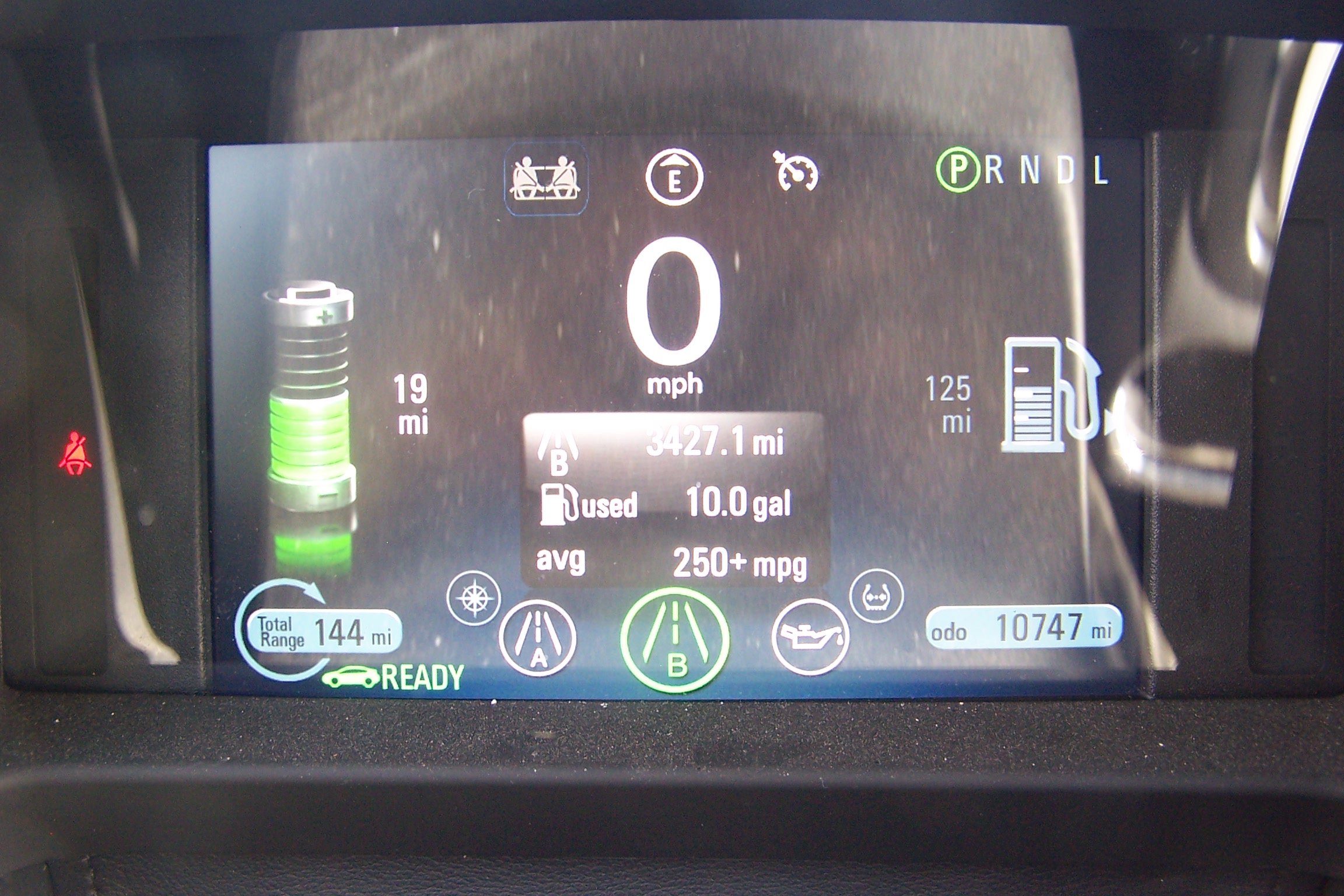

It's been fun, and it keeps being fun! I'm racking up the free miles, getting better as it broke in, and I broke in in the sense of knowing how to get the most out of this - both in fun and miles per charge. I've decided to keep track of my stats insofar as the car makes it easy. Trip meter A was set Jan 1, 2012 (I picked up the car in October 2011, and drove it using too much gasoline, since I didn't have the amount of solar panels required to keep up then). Trip B was set Jan1, 2013, and reset after I took these pictures of the car's recorded stats.
We can do a bit of math and figure out the yearly numbers from the data in these pix, and a movie I took of the same.
2013 stats
As you can see, I used 10 gal of gasoline in 2013, but still attained more than 250 mpg. I bought the last tank around July, so it's "summer gasoline", eg, has a lower vapor pressure and more energy than "winter gas" does - it's a better deal per dollar. I took only a couple of trips outside battery range, never really running the engine past about 2 quarts of gasoline per - and didn't see the so-called 40mpg doing that - more like 20 mpg. But that's deceptive too, as sometimes not only does the engine not warm up fully and get to max efficiency, but it's also charging the batteries - net - in mountain mode. A couple times it was dodgy if I could climb that last long steep hill as I got home, and went ahead and went into mountain mode a few miles earlier to put some extra charge into the batteries for that, and wound up with net extra in the batteries when I hit my driveway. No one has figured out how to report those numbers accurately so far - it's a pretty hard problem - if I've got X in the battery - how much came from the engine, how much from the plug? After a time, how to update that (which to amortize and so on).
At any rate, last year, I did 342.7 mpg...could be worse. The engine force-ran in "maintenance mode" once - I used it enough to avoid that mostly, and once in "it's too cold" mode, for a little while. It really was too cold, and since the waste heat helps heat the car, I didn't mind that one like many Volt owners obsess about - hey, for once you're getting all the energy in gasoline - the waste heat, and the shaft power running a generator to the batteries.
My average for 2 years wasn't quite as good, as that first one I used more gasoline while installing the new solar array, instead of just having it leaning on the walls half the year, and me not knowing how to drive the car as well as I do now. On top, I ran gasoline more than required, as I wanted to break the engine in and get that assembly lube (about 50 weight net) changed out for real synthetic 5W-30, which I've now done.

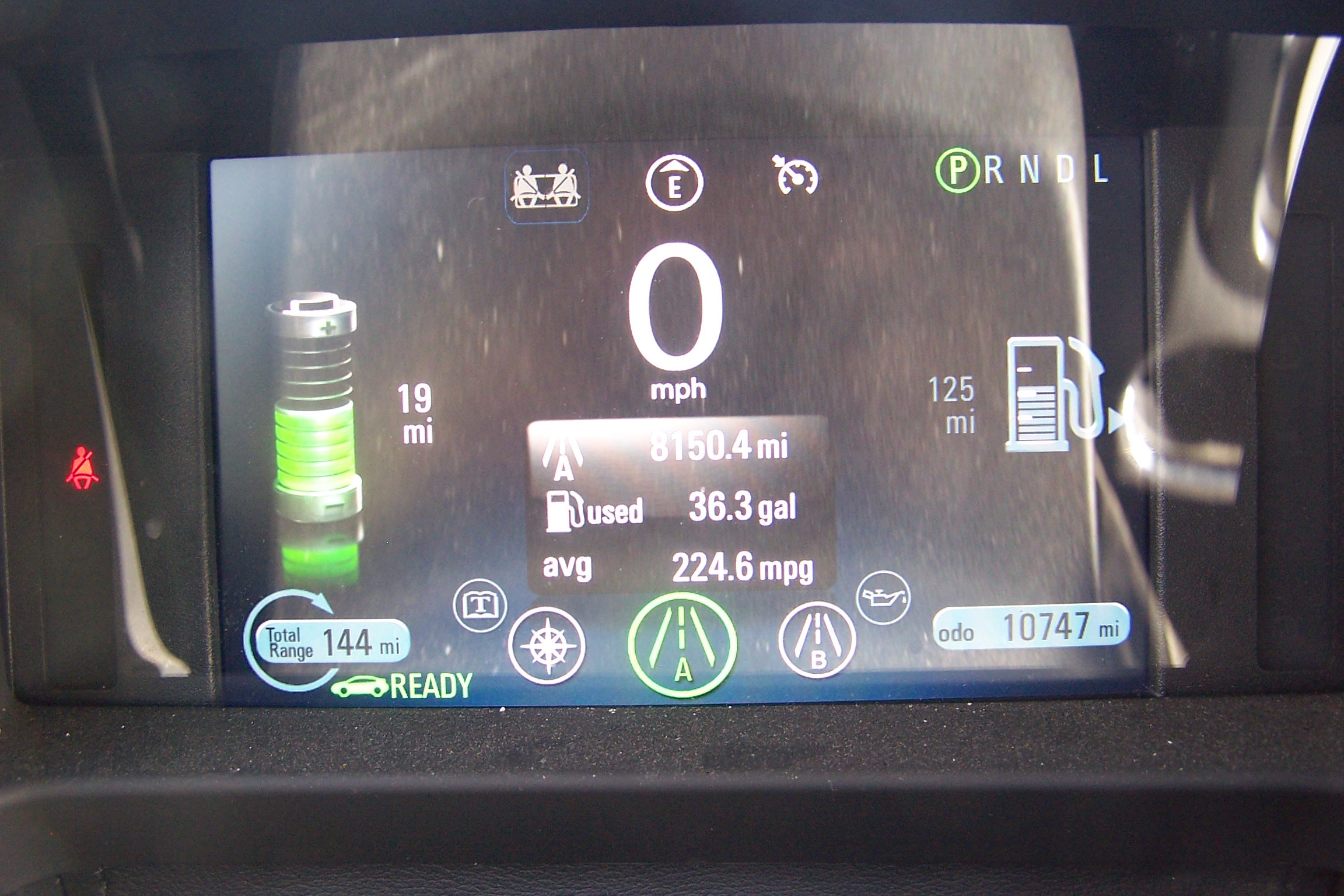

Since Jan 1 2012
Crunching some numbers here: 8150.4 (miles in both years) - 3427.1 (miles in 2013) = 4723.3 miles in 2012. Yeah, I don't drive that much. Even my truck used less gasoline than my mower and tractor - I hardly drive it other than to take out the garbage (or buy lumber to mount solar panels).
Subtracting the gasoline we get 28.3 gallons used in 2012, or 166.9 and change mpg net. That was with the thick oil...and a little less driver restraint and knowledge of how to get the best out of things. Not shabby, even so.
For the pukey total life miles. Well, not all are mine - the dealer's salesman put on 100 miles himself, and at that time, I didn't even have the solar panels on the ground wired up, so I could rarely charge the car at all - other than at the dealer when I bought it, this car has *never* been charged from grid power, just solar.
We see 10747 on the odometer total, minus 8150 recorded on the trip meter, so that interval between October 2011 and Jan 1 2012, was 2597 miles I don't have detailed record for. We'll have to calculate from the life miles per gallon. We are showing 127 mpg lifetime.
Lifetime stats, kinda

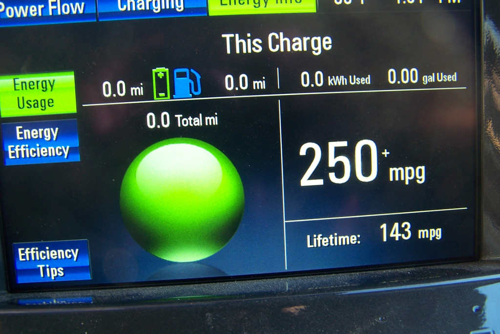

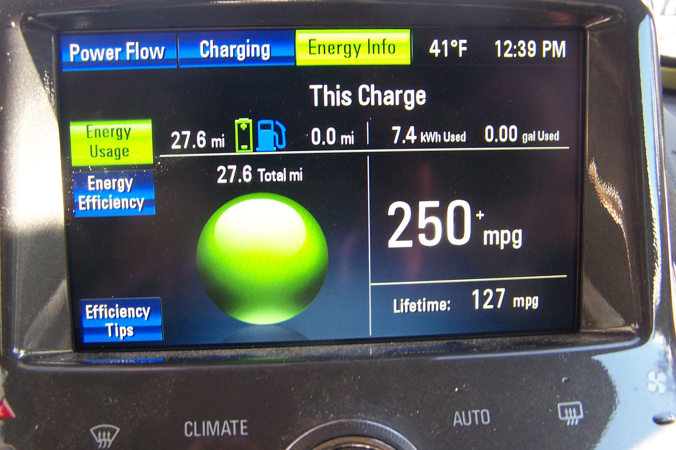

10747 total mile divided by 127 = 84.6220472441 total gallons of gasoline. Now we subtract 2012 and 2013 - 36.3 gallons and we see that I burned 48.3220472441 gal of - gas from Oct (early, don't remember the exact date) through December of 2011. In that period I drove 10747 - 8150.4 miles = 2596.6 miles ( a lot for me, I was showing this off to everyone, and using mountain mode a lot to put energy into the batteries with some round-trip loss so my victims could try it all-electric) for a pretty horrible gas mileage number 2296.6/48.3220472441 = 53.7353060992 mpg - still better than a Prius (and a heck of a lot faster, quieter, and better handling) even under those rotten conditions - little to no access to electricity. The numbers kind of stink, but just try this with a Leaf or Tesla. You'd still get infinite miles per gallon - but almost no miles at all, it'd be a driveway ornament. Yes, I'm a true believer in having that efficient gasoline engine still - even with the added weight and complexity. It makes the Volt possible as an "only car" whereas with the others, not so much. I could drive the Volt to, say, Tesla headquarters, while they drove one of theirs here - and I'd get to theirs first, even though the Tesla has performance more like my old Camaro - you have to stop and charge it. Even with superchargers, which don't in the main exist yet along that route from VA to CA - I'd beat them handily in average MPH. Even if we were both speeding. The Volt limits at a "mere" 100 mph, but obviously that's the computer - it's like hitting a wall, it's still pulling hard, then oops - that's all I'll give ya.
It's going to take awhile to get up to the reporting limit it seems - I've got to drive a heck of a lot of all-electric miles (which is now the norm) to get up to the limit at 250. I'll have fun doing it, though, and now I have the electricity, even in winter, more often than not - I only have to go out for groceries as things stand, mostly, anyway, and if the weather is truly nasty - well, that's why I also have that 4wd big truck - safety wins over money for that, even though the Volt has shown itself to be a pretty good snow car, heck, it's still got the new on it and doesn't have a heck of a lot of ground clearance, so if it's deep - truck.

Note that the extra power consumption per mile on a standard trip in winter DOES NOT include my running the heater - I didn't. I preheated the car on shore power with a portable ceramic "foot warmer" heater and didn't use the car's heat at all.

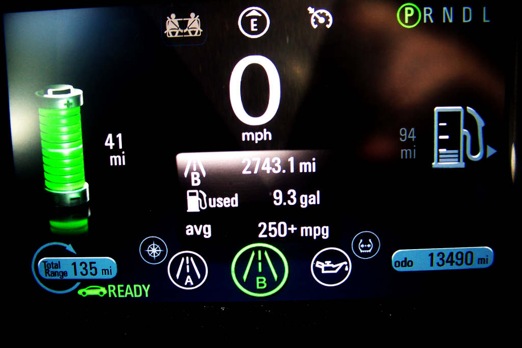

Well, another year has gone by, and I have new numbers for the Volt, so here they are. I realize this is a bit late, but as luck would have it, I've not driven it yet this year, I take the truck for getting wood and so on.
The numbers are pretty good and getting better with time. It was a big deal getting enough solar to run this more on electricity, since most of my errand loops don't require gasoline at all, though I've been bitten by "stale fuel" burns and since learned not to keep too much gasoline in the car so it's easy to cut the average age of the gas in the tank, and not have to burn as much. This past year, I was lucky in the sense that the major fuel burn was a gas maintenance burn, but happened during bitterly cold weather, so I got the waste heat as a bonus for that (long anyway) trip.

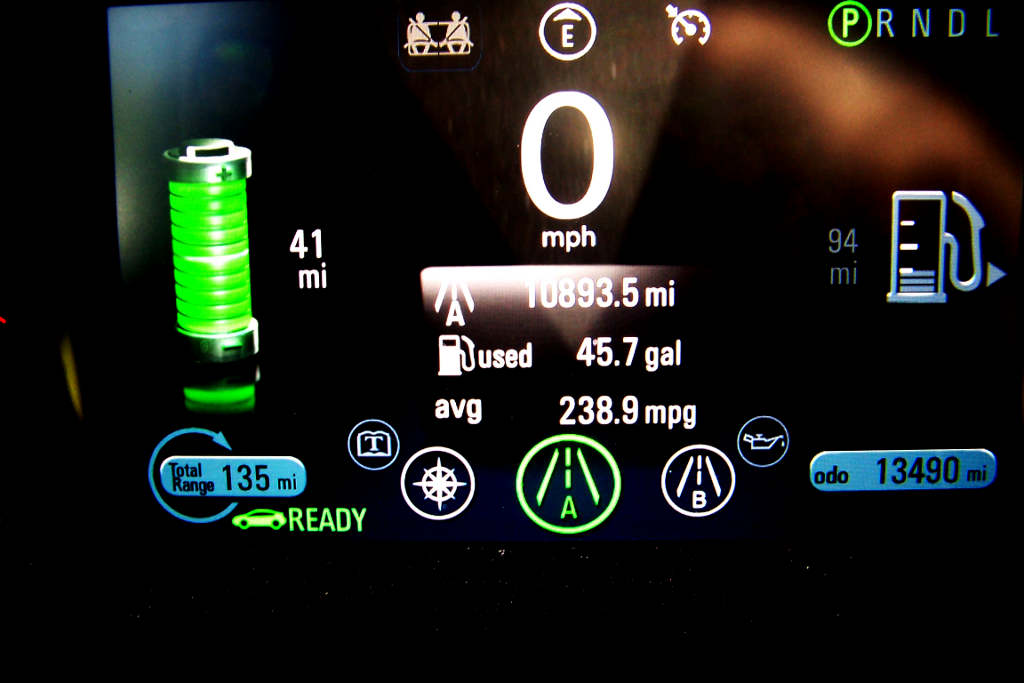

Here's what I now see on my dash. The "A" trip meter is since Jan 1 2012, the B is since Jan 1 2014 (2013 should be above in this thread, I only have two trip meters, and B is just now getting reset for 2015 stats).
Most recent year
Since start of decent solar system, Jan 2012
Lifetime since early Oct, 2011

Evidently, it self-tunes for this, and this wasn't a hypermiling situation - it was full bore on Rt 81, high speeds on an interstate where most confuse the road number with the speed limit - and then exceed that - in the mountains where just after every hill climb, there are usually a few overheated vehicles right after the hilltop.
I burned a fair amount of gasoline early on, both to break in the engine so I could get rid of the thick breakin lube, and because I simply didn't have enough solar power then to handle my driving needs, which were more then than now. I think it's all good, though it kind of spoils the lifetime numbers - they're going up at this point anyway.
This car has not been connected to grid power since I bought it. I've had almost zero maintenance issues - I've changed the oil and rotated the tires, had an antenna snapped off by a few feet thick re-frozen snow (replaced free by GM), and the usual charge door issue, which has stayed fixed since the first time I fixed it with the same sort of moly lube one uses to coat match bullets (powdered molybdenum disulfide).
