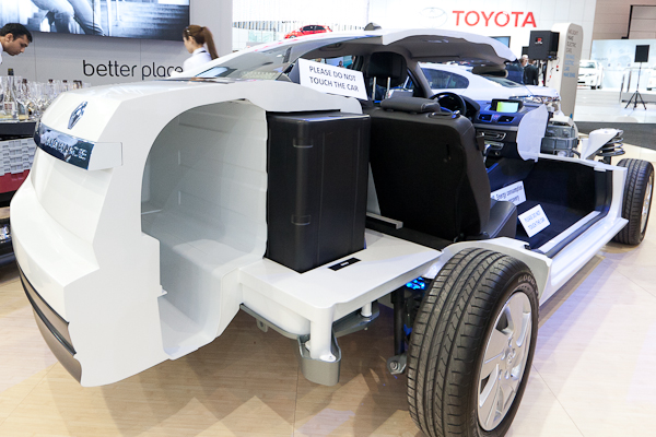

Here's how the battery sits:

Some tid-bits I just came across on the Renault UK website:
"Lithium-ion batteries do not suffer from the so-called memory effect resulting from incomplete charge cycles which can ultimately lead to a drop-off in capacity in conventional batteries. These compact, innovative lithium-ion batteries are produced by AESC (Automotive Electric Supply Corporation), a Nissan-NEC joint venture. They are maintenance-free and expected to deliver between 80 and 100 per cent of their original capacity for an average duration of six years. As the power output from the battery is capped at 80% of capacity anyway the customer(s) should not experience any reduction in power over the period of ownership."
An answer to the question; "Why did you not choose iron phosphate technology?"
"If li-ion manganese technology enjoys an overwhelming preference across the automotive, this cannot be the result of mere coincidence. Only the Chinese automaker BYD and the US battery manufacturer A123 have opted for the iron phosphate alternative. Manganese technology offers the best trade-off between performance and service life, (the two key characteristics for the successful take-off of electric vehicles) without compromising safety Iron phosphate technology gives lower energy density, and thus a shorter service life."
So looks like we're talking LMO for the Leaf/Fluence (same as Volt).
