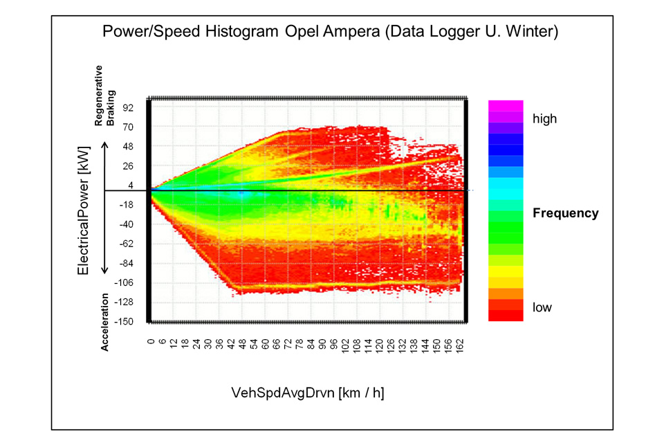

Yes, the two-motor system is used to keep motor speeds and torques in a good range. There are two input shafts to the tranny - it's just a planetary with more than one thing hooked to more than one part of it, and some clutches - pretty amazing mech engineering, I'll have to find that "how it works" video of it. The electric motor-generators are inside the tranny and cooled by its oil, as are the clutches. I believe (have to find that vid and check again) that one of the clutches merely can "clamp one thing" to "ground" and stop it spinning in there, which kind of changes the gear ratios of the other 3 shafts (two input, one output).
The Volt uses current limiting to avoid demagnetization of the PMs, which is obvious from this histogram:

Either motor can turn in either direction in most modes (or be clamped to stop). When the ICE is running, it's a little more restricted - it can't go backwards, and is clutched into the same shaft as one of the electrics. All the clutches in this thing (3 IIRC) are only "dropped" when there's a perfect rev match already made, you never feel one, ever. The only time you feel something like a gear change is when we go from ICE driving one motor as a generator (with the other motor driving the car) to the case where all 3 are clutched to the tranny. For that to happen, revs have to be matched first, so you lose power for an instant, like in most shifts, then wham - you suddenly have a ton of horsepower.
This only happens if the ICE was already running, you're going within a range of speed, and you ask for more than the car could give without direct clutching of the ICE in there, with both electrics also going maxed out (one in parallel with the ICE).
