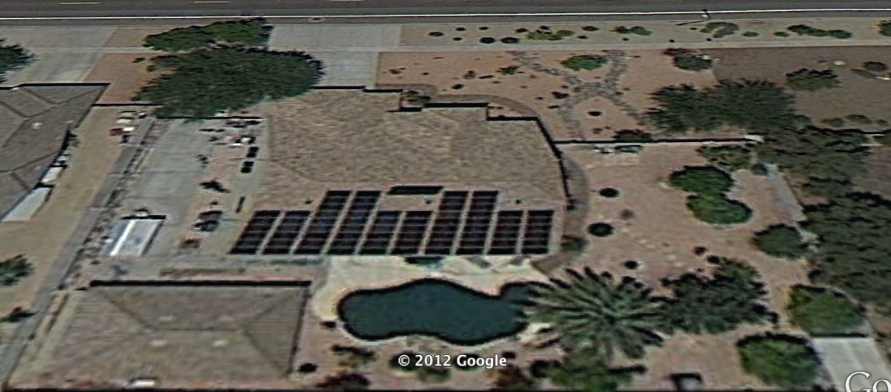

I have a 12.5 Kw grid tie solar system which consisted of 72 175 watt panels and a pair of PVPowered 5200 inverters.
I had to upgrade my service entrance to dual 200 amp panels with a 400 amp line from the transformer to comply with NEC code.
The wiring for the panels enters my attic via a weather head and runs to a combiner box with fusing in the attic. The panels are connected in 8 strings of 9 panels. The DC then heads to the DC disconnect between the inverters.
There is an AC combiner next to the panels that takes the AC and combines it into one line to the Mains.
The billing system for my utility allows for net metering and provided $3 a watt in rebates for the system when I installed. At that time the install was about $6 a watt. The interesting thing about the net metering plan is that the watts generated can only be used in the TOU time frame that they are generated. So I still get to buy off peak power from them. I currently have about 1500 kWh in my on peak TOU bank. Most people load shift to off peak to reduce costs, not us, we load shift to midday to get that power for free. On Dec. 31 each year the utility will pay use $0.065 a kWh as a credit on our Jan. bill. This year it was enough to cover all our fees and such until mid year.
If you have any questions feel free to ask.

Just as an FYI, we are planning a 3290 watt expansion of the system onto the new workshop/office building on the back of our lot. The reason for this is sort of 2 fold, first we want to be net zero with the utility (we are really close now but the second Volt has pushed the ragged edge), second our consumption is going to go up as I get more free time to play in the shop. At some point I will post some pictures of the shop as well in the proper forum.
The add is going to be with Enphase micro inverters because of some shading that will happen near the winter solstice. The line will be run to the existing AC combiner and joined to the back feed there. Really this may still be an issue as NEC only allows for a 20% back feed over rate on the panel bus bar. We have a 200 amp panel with a 175 amp main breaker and a 60 amp feed in breaker currently. The max allowed technically would be 240 amps of total feed in to that panel. 175 + 60 = 235 amps. The pair of PVPowered inverters will actual generate 23 amps each max, total combined well under the 60 amp breaker. The 3290 watt panels will generate at most 15 amps @ 220V. I reality it will never get there as STC on the panels can never really be achieved. The problem lies in the combiner which has 2 30 amp breakers for the existing feed in. All is OK with the NEC now but if I add a 15 amp breaker to the combiner panel then I have to upgrade the feed in line to the main panel to the next common breaker size, most likely 80 amps. This pushes the combiner feed in over the bus bar rating. One workaround would be to decrease the panel main breaker to 150 amps and this may be my only solution. I think this will still be OK as that panel only has 2 loads attached, the sub-panel for the new workshop office building (125 amps) and the sub-panel for the Volt chargers (60 amps).
Code monkeys, what you going to do? You can see the new building location is in the lower left of this view of the property.

You could always break down and do what I do - batteries and a subsystem not grid tied (or load shaving like the other Dave does). Rats, I wish that Volt battery system would become available to us, I'd buy a few in a heartbeat for my system (especially at the current listed price!). As we know, it's not just the cells, it's that whole system for temp control, and for balancing charge between all those cells that matters. Those are so many miles ahead of my submarine lead acids it isn't funny, and it would be like adding around 30% more panels. I probably wouldn't even need the capacity I have now, in either panels or batteries, since I can fully cycle the Li types, but not my lead acids - kills them pretty quick, as I found out before I learned about this.
The advantage is that if you're just using the power straight - you don't go through the wiring the building inspectors care about, and if you load-shave, you're actually reducing the current to the grid in either direction. Say you're using 50 amps in your house, but creating 40 - then the wires out to the power co only see the difference - 10. That's not more current, it's less! Not that code was written by guys who really understand what is going on. IT's more like - make things unlikely to fail in edge cases, and reduce it to a check off list for people who just put wires under screws and really don't know what's happening, all by rote.

I agree on the Volt batteries, I do sort of load shave now by running most of my high load stuff in the daytime, pool pump, most of the Volt charging, laundry, cooking. This is why every time I approach the utility about changing TOU plans from a 9AM to 9PM plans to a noon to 7PM plan they say it will cost more money. Really I think it will cost less and reduce my off peak purchases from them. hmmm conflict of interest to boot. That is why I have taken my TED monitoring system and started to collect the data so I can analyze the load profiles. I think I need about 60 days worth to get the calculations to be accurate. We shall see. The problem is the 9AM to 9PM plan is a grandfathered rate, I change and I am unable to return to it. :evil:
Edit:
While batteries give you lots of freedom, they are a PITA to maintain, cost a lot up front, have a finite life (assuming you don't screw up and kill them) and generally require a good thermal environment to live in. My grid is very dependable, just expensive. In 15 years I can only think of a couple of outages lasting at most an hour. Volt batteries might be a real game changer, I could envision a stack of them replacing the grid for most people. However My daily solar in mid summer is inadequate to support the operation of this place. The solar in summer produces about 63kWh, the operation draws on a peak day 135 kWh and most summer days about 100 kWh. It is the spring and fall times where I produce all my excess kWh to carry my summer loads.
