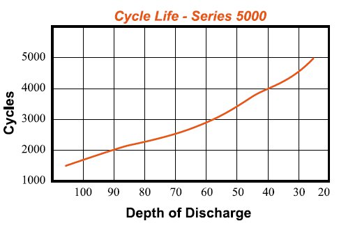

This is kind of a hypothetical question that I came up with while sizing my battery bank and had to ask it since it goes against 'conventional wisdom'...
According to Rolls battery datasheets, operating a battery bank at 25% DOD gives a 5000 cycle life, a 50% DOD gives a 3300 cycle life and 75% DOD gives a 2300 cycle life. So, if your system is sized for heavy usage at 50% DOD, but you have many days of light usage - say 25% (to make things easy), does it make sense to run two days between charge cycles and operate at 50% DOD to extend the battery life to 6600 days? Or even three days between, weather dependent of course, for a life of 6900 days? That's an extra 5+ years of life from the battery bank. I know the Rolls batteries typically last much longer anyway with proper maintenance, but if they normally last 20 years, then it could probably be stretched to 30 years.

Wow, you've picked up on something I hadn't here. I'd been told by so many outfits, so many times, it was almost pure linear and if anything, advantage (over linear) with low DOD, that I'd assumed that was gospel, and have been running on that assumption myself for all these years (and getting 12 or so years out of L-16's that are going only 8 for most people). Seems they are saying it doesn't degrade as fast as linear.
Linear would work out to (more or less) the total amp-hours in/out, or through the batteries, as a life expectancy measure, almost no matter how you got it, only with real life batteries, it gets bad real quick (worse than linear) with higher DOD. They seem to be saying almost that, but that it doesn't keep getting better with shallow cycles. I dunno is the most honest thing I can say at this point. I'm getting good results with "the old religion", I can say honestly.
I rarely hit 50% here - because once you're getting there, the issue is likely to be "when is it going to be 100%", so you start making moves to stop the rundown. Although today was a great energy day (car charged despite AC on all day and some machine work) - it's still so hot, and sun going down I'm running the AC still and a generator that cuts the net draw down to about 10a, vs the 60a or so it would be without that little guy, for just that reason. In this case, the cost of that is balanced against my own belief I don't wanna run those guys down too hard into a week of "partly cloudy and T storms" predicted.
So, what they appear to be saying is it's worse than linear if you don't cycle things or only stay near the top. I offer just one data point. The car starts charging in the AM before the panels can really do that and charge the batteries - there's net drain (considerable) the first time it cuts on in the morning, and my relay system lets it do that for a couple minutes (down to 24.5v) before it cuts out, then lets them get to 28v or so (under charge) before allowing that again - I get about 5 cycles of that every day I'm charging the car in the AM. If anything, that's really perked these guys up! They seem to like a little cycling around the top, which is also the basis of all those anti-sulfation devices they sell to people (I never fell for that but...given this observation...).
I dunno. I'd guess a good deep discharge once in awhile would kill off any "memory effect" and hard-crystallization or passivation of the lead oxide, but I'd not do it on purpose - it happens enough by accident.

It wouldn't be practical to do on a regular basis, but it's an interesting thought. I got started on that while looking at two parallel strings for the battery bank. Instead of running the whole bank as double the amp-hour capacity, I was thinking that you could alternate each half of the battery bank from one day to the next. The advantage wasn't so great in doing that unless you could really hit a sweet spot with capacity and usage.
Their chart has a few squiggles in it, so not exactly linear and it just gets cut off at 5,000 cycles although the trend is towards more cycles at shallower discharge.
Maybe it just gets flaky beyond that point depending on how it's used??

I'd have to analyze that chart better after figuring out if one of the axes isn't kind of 1/x, but it looks to me like it goes up faster than linear at low cycle depth - which is how I've been assuming it was, and I can't complain about battery life here. I appear to be doing about 50% better life-wise than the norm. Or better - those last L-16's I took out of the other system were 15 years old! Most people change them out at 8.
