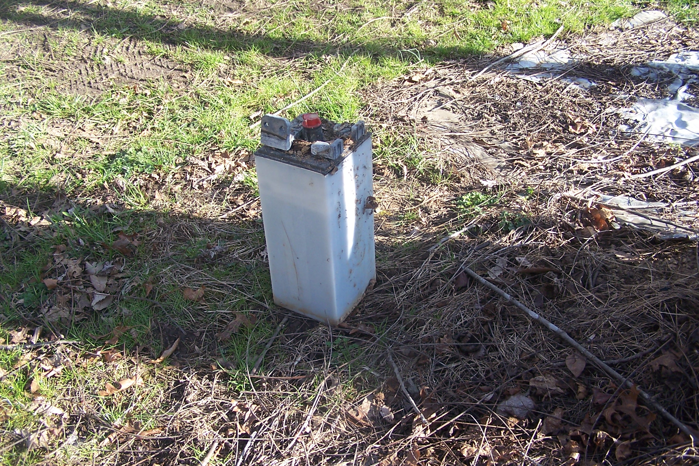

This is kind of analogous to a car battery failing in the cold of February - darn,if we just made to March, we'd make it to November, as all these work better in the warm. Oh well - I'll maybe put the best of the old ones into another system I don't use much - but which can back up the main one in a pinch (buried wire with 120V can push power either way and run a battery charger).

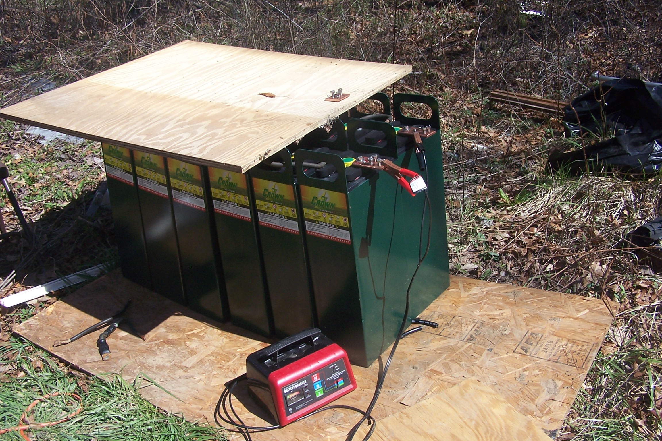

At any rate, I kinda panicked and ordered a new batch of lead-acids (newer tech is mostly a pipe dream so far, you can't buy it for a reasonable price per WH, if at all). Not cheap...$7800.
I'd ordered 1300 ah cells, but they shipped 1800 ah ones at no extra charge and they paid shipping - no complaints here. (Wholesale Solar) You can tell them I sent you. I also bought some nice panels to replace a few of my older ones and gain around 1kw of output (more on that when I'm putting them up) and like the batteries, the old ones can go on the backup system (for a storage trailer I have). Or who knows. I could divvy them up between the east and west sides of the shop and pick up a few more sun hours on lots of days - just postponing the time things start to discharge can be a real big deal especially in winter.
The new ones look real nice:

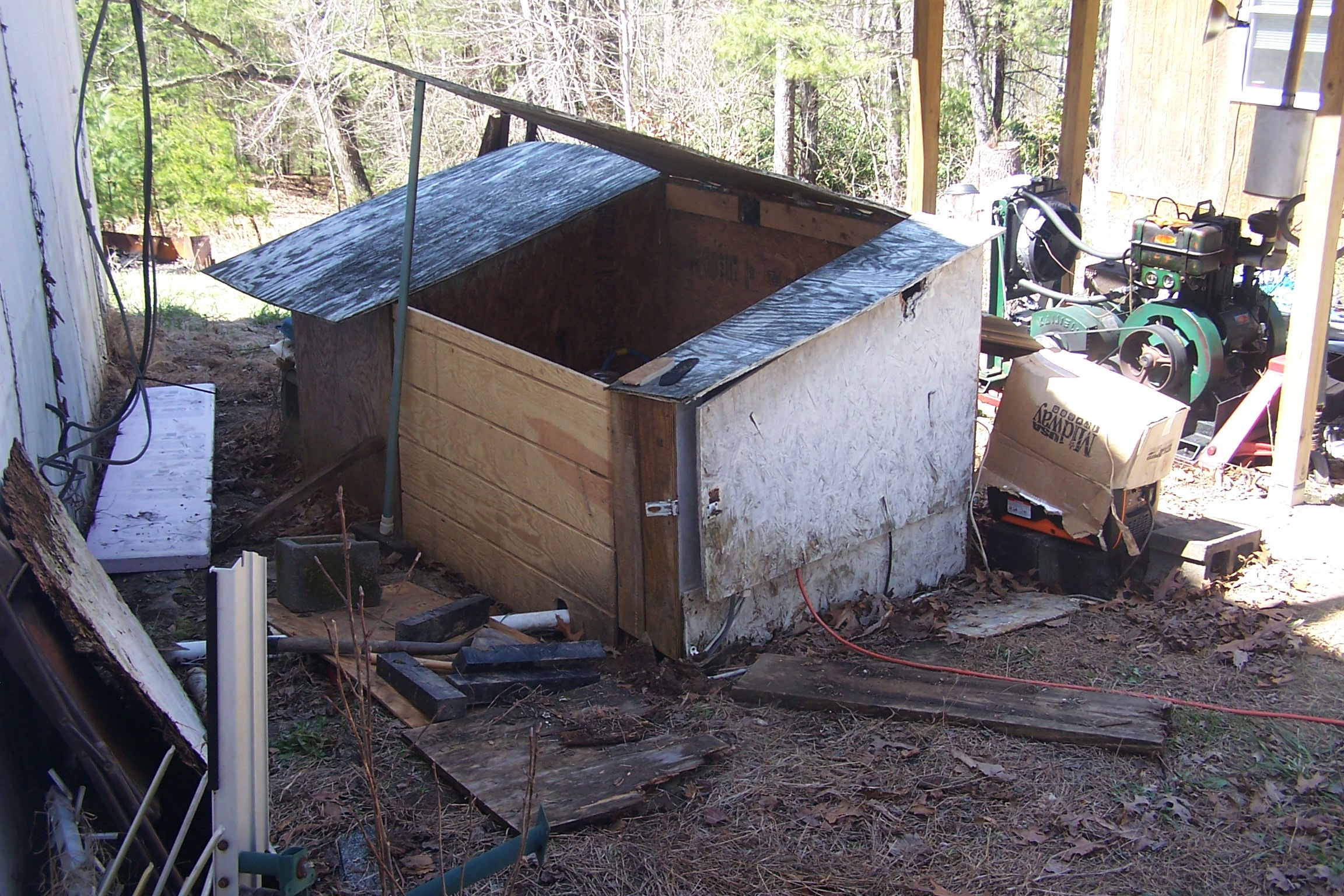

Near the destrination, and uphill from there - important when you have > 1 metric ton to move by hand.
I spent this morning making those really nice and beefy copper terminal blocks for the new guys, all nice and tapped holes and so on. You want this to be easy to do and mistake resistant...

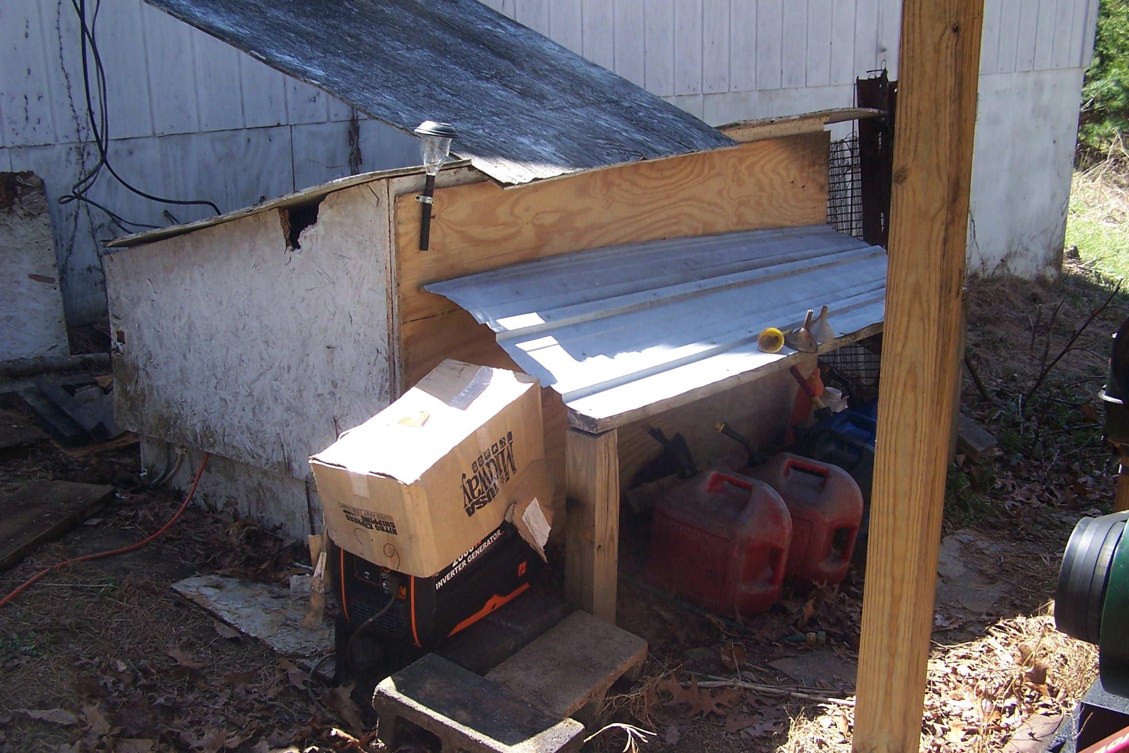

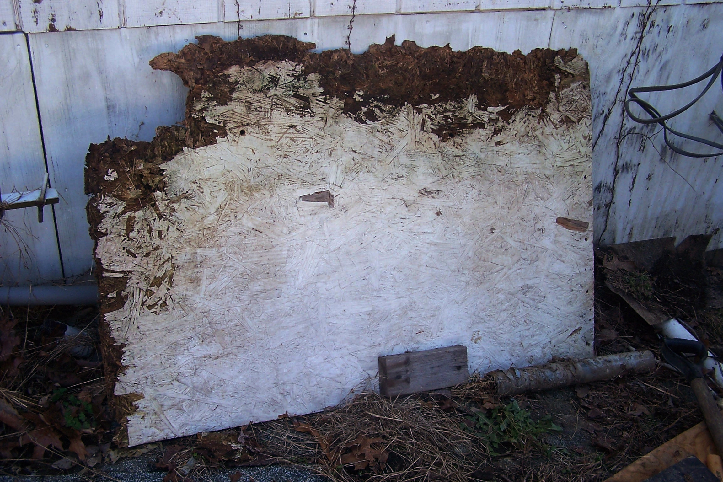

I also did some improving on the box, as it should be more insulating and it's pretty old now - OSB lasting > 20 years outdoors isn't too bad but...
A new front door that's easy to remove.
The old one was pretty beat -
TOO easy to remove - it came off in my hands.

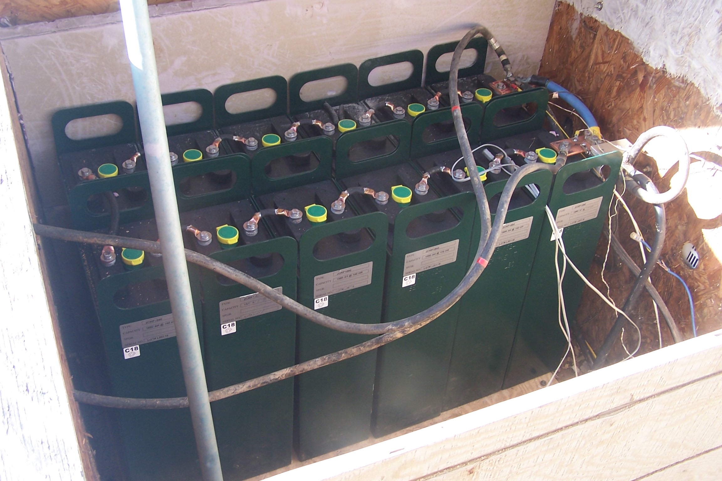

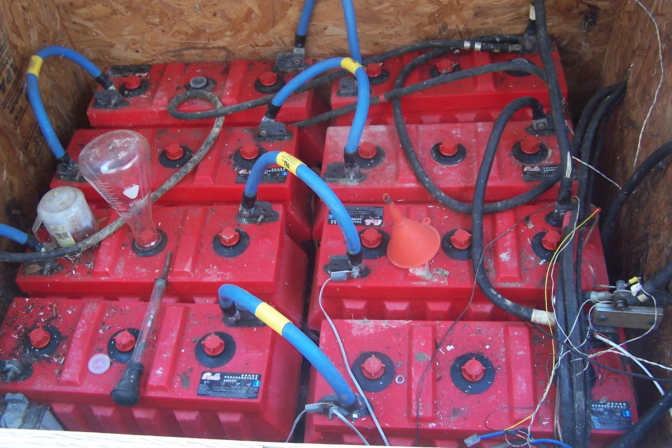

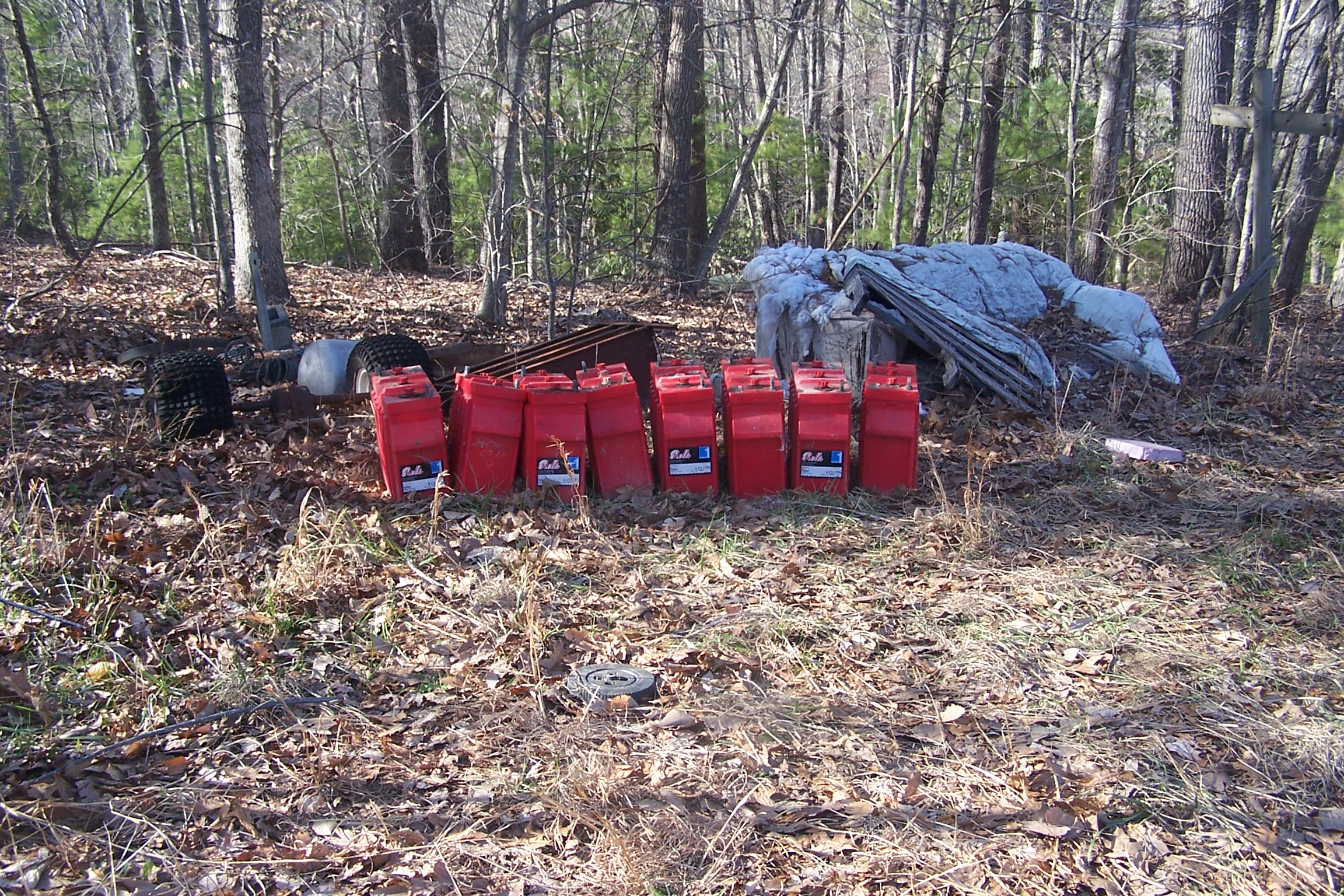

So, all these nice puppies gotta move (ugh) to make room for the new guys. These were nominally 1080 aH total.
The main set of old ones
This wasn't all I had in the box. In the next compartment over was a bank of L16'S and a couple of deep cycle trolling batteries contributed by Bill to the cause to keep me going till now.
Those are all new enough that they should match well enough to stay and be in parallel with the new ones, but of course I'll check...

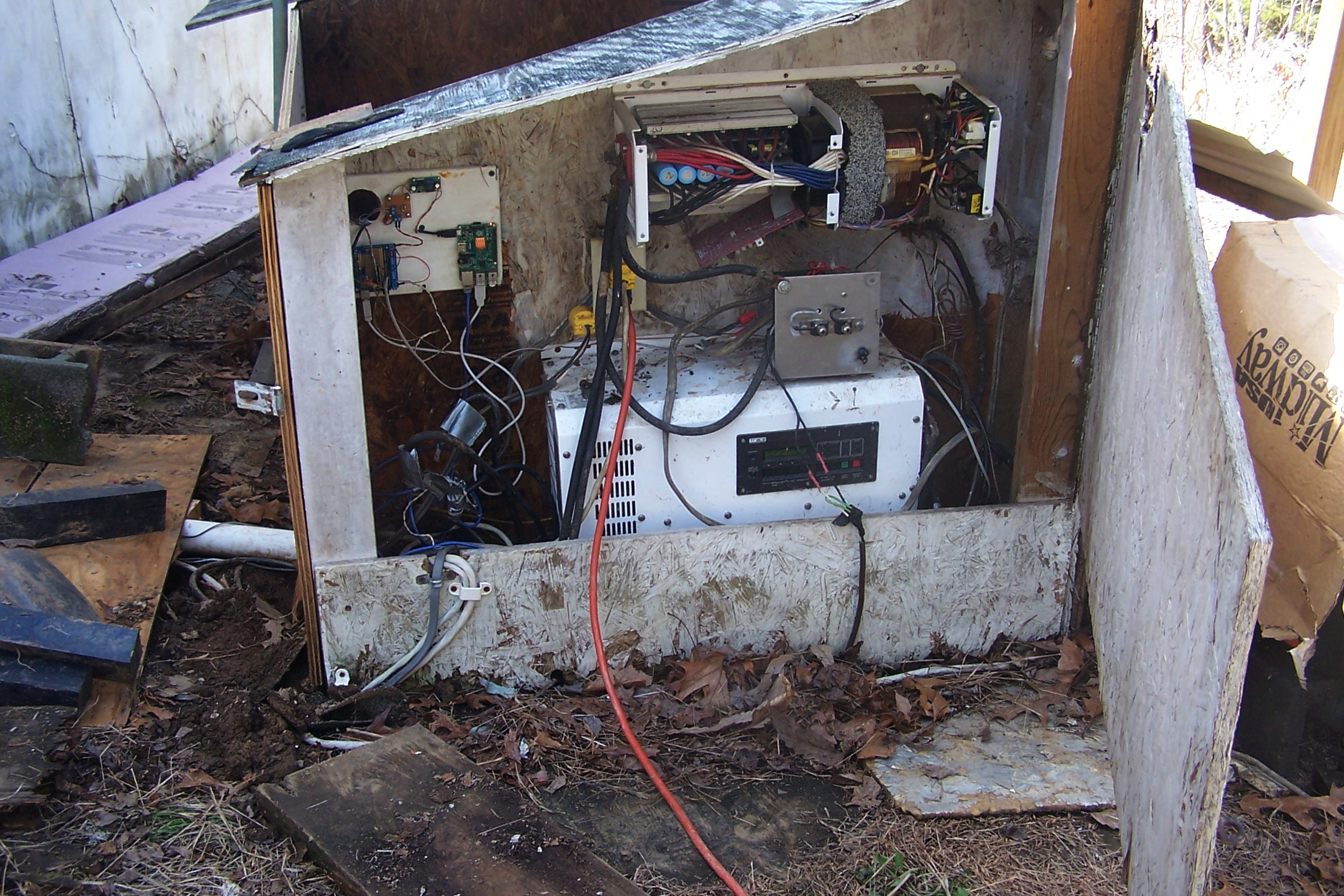

This is kind of the dirty underwear of that box. 2 inverters and a small charger (modified from one for a forklift - ferroresonant) as well as a raspberry pi and arduino that take data and make plots for my LAN, as well as control the water pump and fan on that big Lister diesel.
The upper inverter only runs my 5hp air compressor and can serve as a charger in an emergency - all the backups have backups.
After a glitch on that upper inverter (a square wave one) involving mouse pee and such, I just left the cover off. Now they don't have place to rest and pee without getting hammered with the HV.
The lower inverter is a sine wave one - Trace SW 4024 - that's run 99% of this place for many years, and is heating me a shower right now. Those things will easily make huge peaks - short it with 20' of #16 for a huge ball of plasma. Dead short it and it shuts off in mid half cycle without a spark. Pretty cool.
I now have a larger 240v one inside with the charge controllers for the big machines and fusor power as well - same brand (now Schneider electronics). This is a case where these are just better than what even a really good engineer would do for himself.

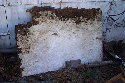

While I was at it, I put a new back wall on there too - the old one was getting weak, and I just slapped this on top of it - as well as adding some thermal insulation. The little Wen gennie runs the forklift charger, or my chainsaw etc. Those little inverter generators are nice - and worth the extra bucks in reduced hassle alone - they are FAR easier to start, use tons less fuel...clean output...if you use a gennie any amount - this is what you want. The old 3600 rpm hardware store ones make good boat anchors and doorstops, I hear.
A new back too - and better insulation not shown. The little Wen replaces that Honda I had, which ate a broken piece of sparkplug ot it'd still be in use - and the best ever. The Wen is good for half the bucks...

These as just delivered

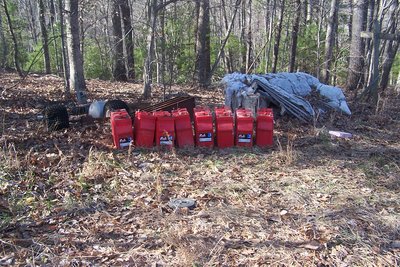

The old guys. Anyone want 1k amp hours nominal at 24v bad enough to come and get it.

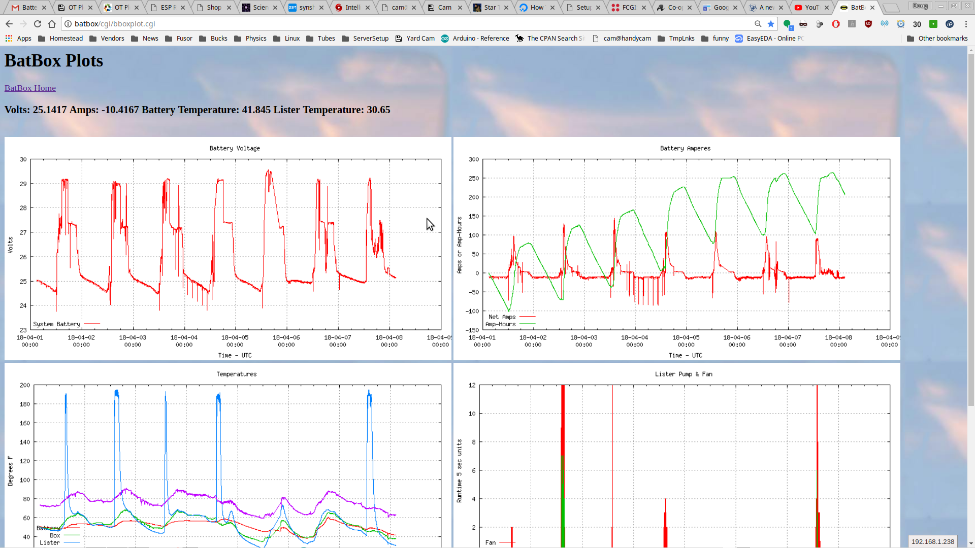

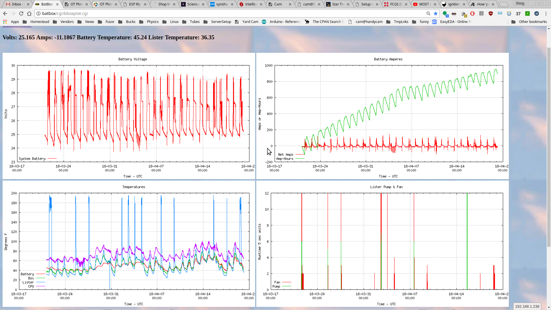

So, some data. It took awhile for the vacuum system to start acting right again after a day of off...and I then left the air compressor on all night...but the new guys stayed above 24v - and most importantly, the integrated amp hour curve stopped climbing at 50ah+ per day - that was a huge fraction of my energy supply going up in ... hydrogen, whatever.
So, a couple curves. On the first night with the new guys, the volts curve is flat - a nice marker.
Plot of a week of data (part of the LAN of things)
Taken just now, some days later
This includes charging up the Volt twice - you can't really tell from the plots that easily, as they show net battery current and so on. I've yet to add shunts that see all the innies and all the outies as separate things. I did get one of those cheapo logic analyzers (~$15) and my reverse engineer the "Xantrex bus" my electronics use for most of this...but since I have too many (poor me), they can't all be on that bus (horrible design on their part - publish-subscribe and no backoff for collisions) and even that wouldn't do it all....

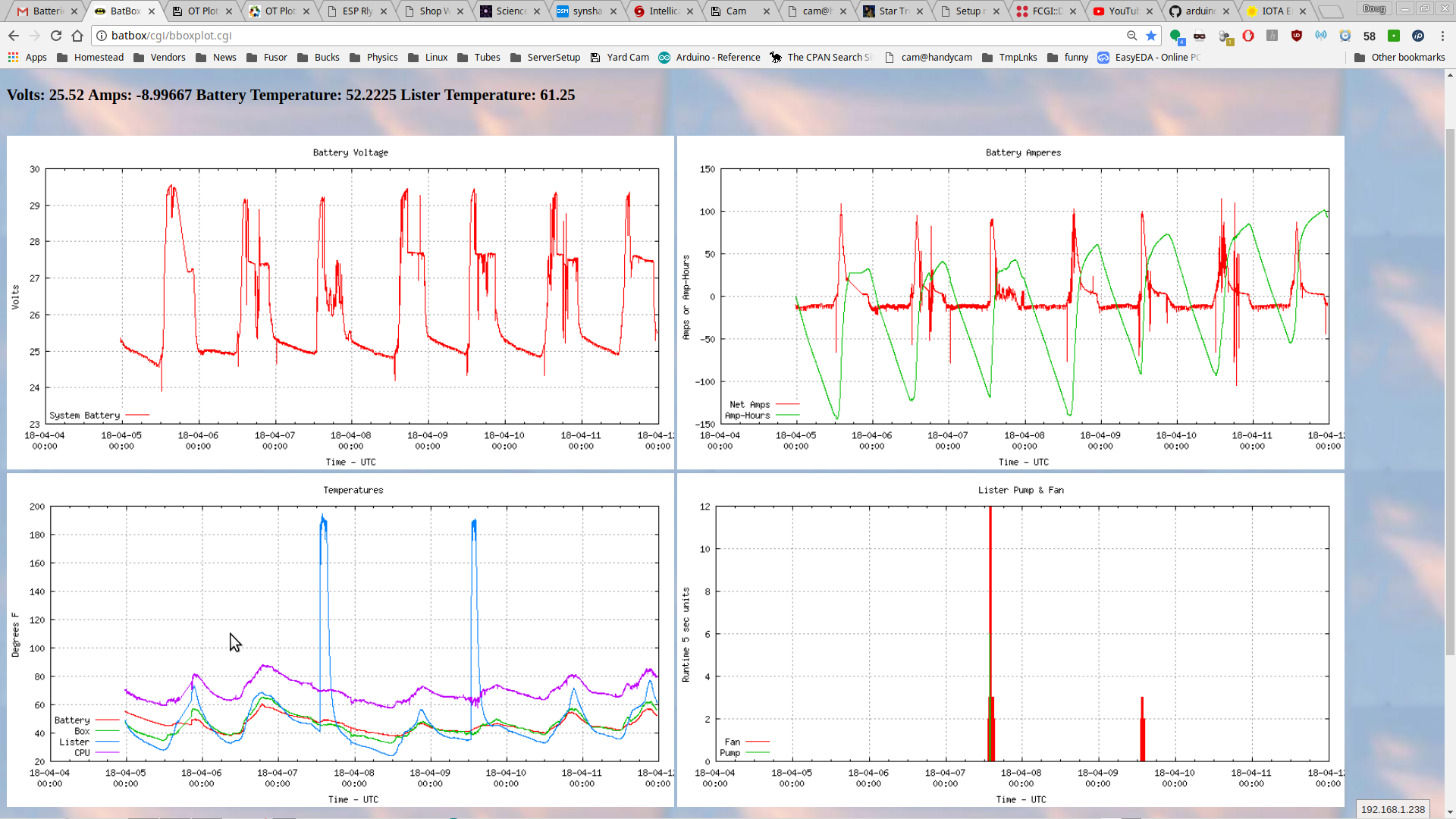

Re: Battery replacement
Postby Doug Coulter » Thu Apr 19, 2018 11:07 pm
More data - this is a one month plot and you can see the change in minimum voltage reached in a night, and a slowing of the "runaway integration of amp hours" when the new batteries went in.
I can affect the latter more with further adjustments of the charge controllers, but the old setup was wasting ~ 50 amp hours/day on a use of ~~ 150. Now it's more like 20 ah usually, but some further adjustment to cut the post charge trickle down should get that better. I'm looking forward to see how the new 1500w or so of panels, replacing 5-600w on the office roof do too. The hope is being able to charge the car, cook a shower (yeah, I actually have a legacy electric heater) or distill water or run A/C even on more-marginal days. No sweat doing any 2 on a good day, but there's this huge variation in weather here, day to day and season to season. And like hot rods, there's no substitute for cubes (or square meters in this case). On a good day I get to full charge before 10:30 AM....now on a lousy day I still get there by the end of the day with no backup gennie, or I should on all but those really dark days with hail and stuff. And those middle partly cloudy days...are pretty common and it'll be a big deal if I can be an energy glutton on those days and still end up with a full charge.
A longer term plot. That one flat voltage at night is the first night with the new pack wired in.
