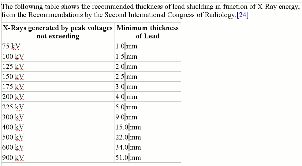

X ray shielding from a medical reference.
