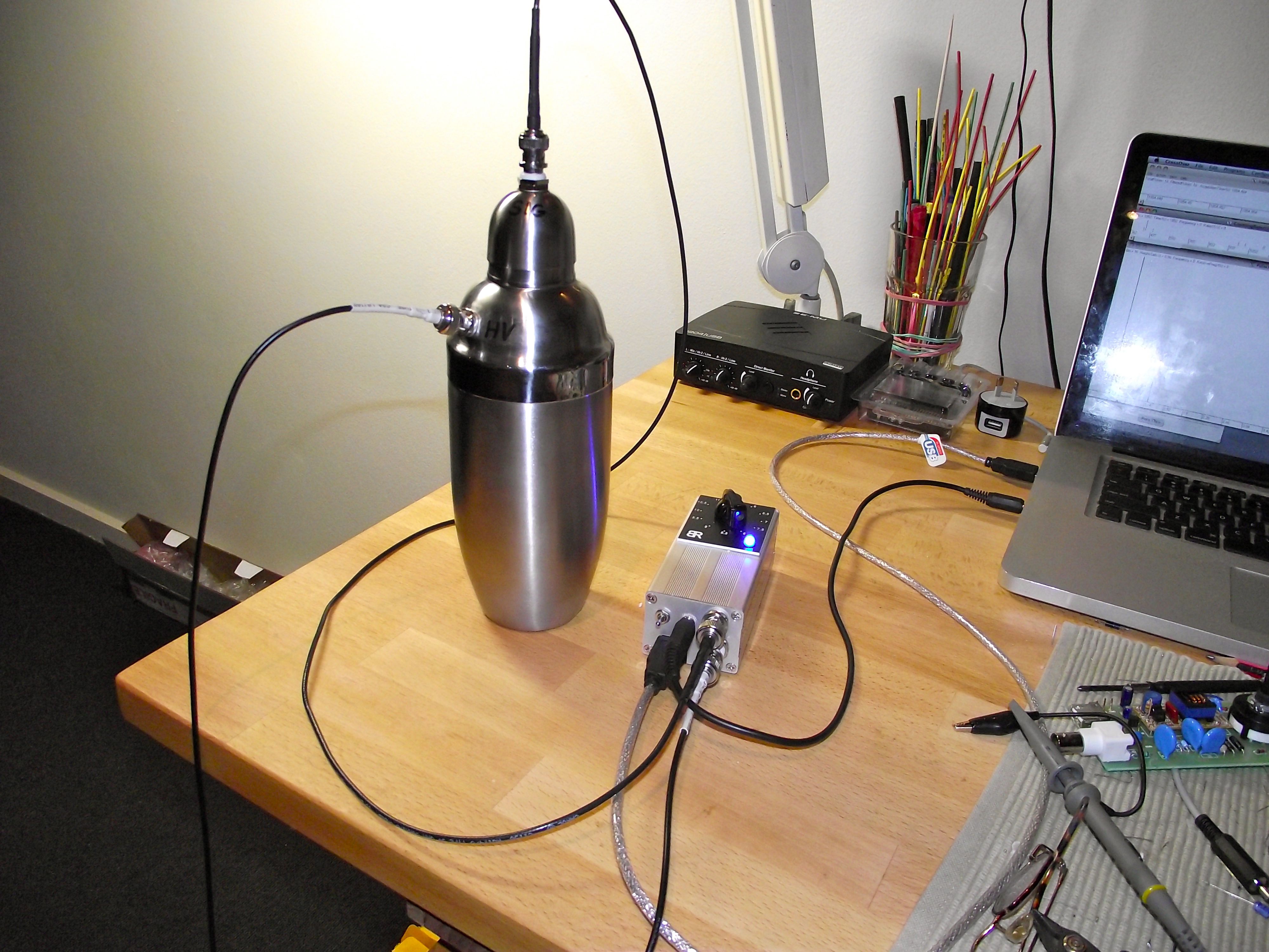

Some of you might have heard about the recent eBay scoop where a number of small LND He3 detectors went for $35.00, well one of them ended up in my lab, due to the generosity of Adam Ingle. My task was to see if it would work with the GS-1100A.

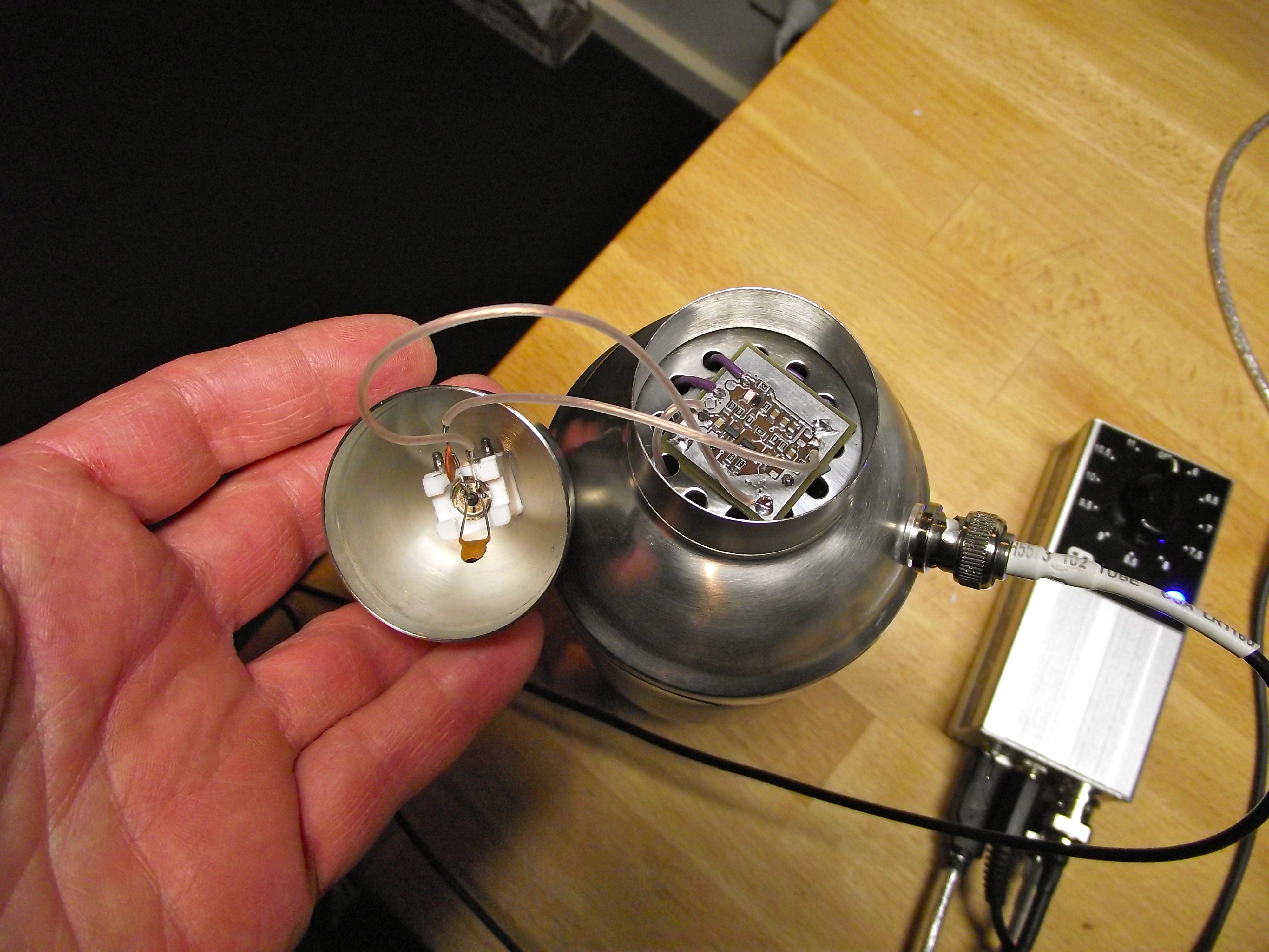

After a few initial measurements I realized that it needed a better preamp, and fortunately I had one of Doug's Fine Wine preamps to spare. After hooking it up to my sound card I literally received the radio on it, so it was going to need full shielding.
I went down to the local kitchen supply discount store, and wahlah, there was a perfect container, a stainless steel cocktail mixer for $12.00.
Not only the perfect size, but it also had a stainless steel cap that formed a separate chamber for the preamp.

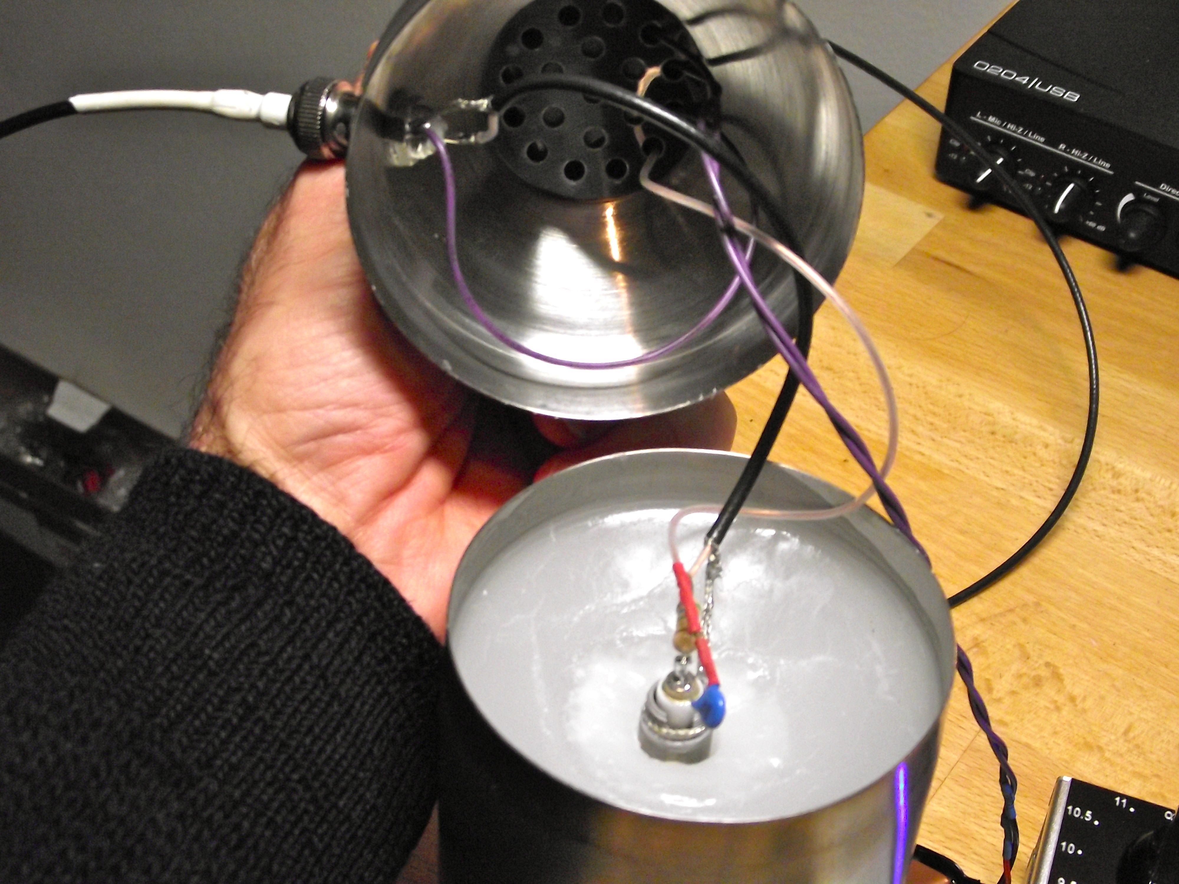

I filled up the container with paraffin wax, and poked a hole for the detector just before it had fully set, the preamp was attached with double sided tape inside the top strainer section of the shaker.
Used with PRA, and my sound card, it seems to pick up just the right amount of neutrons for the background.
Well done on the excellent preamp...!
Steven
He3 Neutron detector with wax moderator, built into a cocktail mixing cup.
Doug and Joe's Fine wine preamp, perfectly fits under the cap and strainer.
He3 detector set in wax, with coupling capacitor (After the photo was taken, I scooped out some wax to fit a 9V battery)

That's some real nice work, Steven - not the least bit shabby. Yes, the bipolar front end of that preamp can rectify loud RF from outside its design bandpass. I'd have used a fet there, but at the fairly low impedance input (about 66k) I couldn't get the noise figure as nice with one, and they are a lot harder to temperature compensate the bias (the preamp is fully DC coupled internally).
This kind of application is exactly what I designed it for - put it right up in the sensor head and send loud, noise resistant signals downstream, so little arcs and sparks from your fusor (or whatever) don't make for false counts.

Very nice job! I'll get some more of those PCB's made - I'm going to need some more for myself too. If I remember right, I was going to add a little more space around the wiring connections so it's a little easier to solder.

Great, a little more space around the solder tabs would be great, and a little bigger pad wouldn't hurt.
