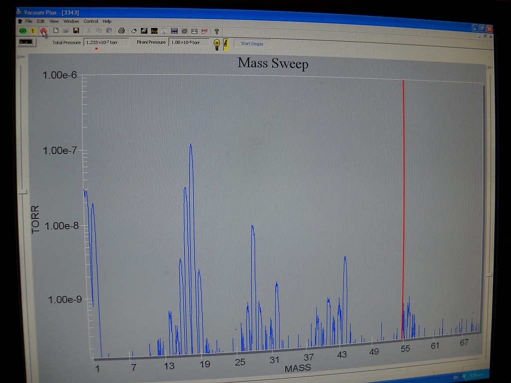

All powered up today with first Mass spectra
Okay a few pics

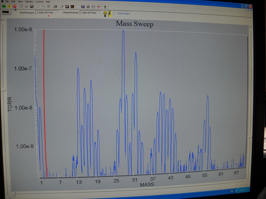

first is sampling ordinary air

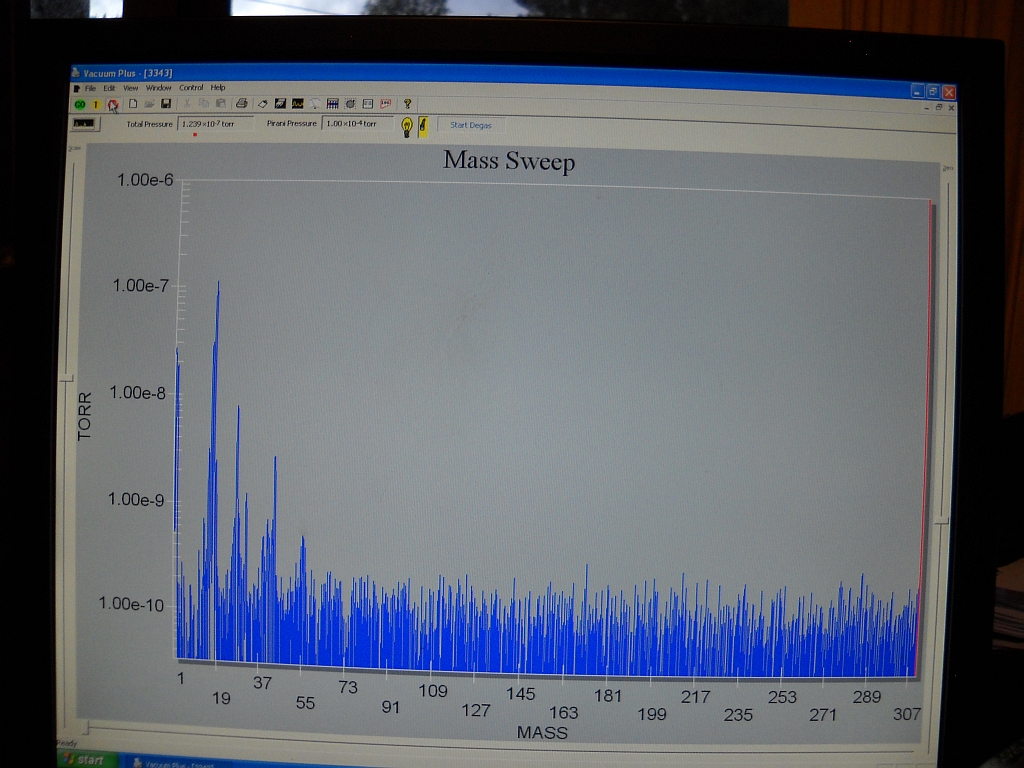

second is the base pressure after 1.5 hours pumping from brand new items
third same pressure but to limit of mass spec head
forth

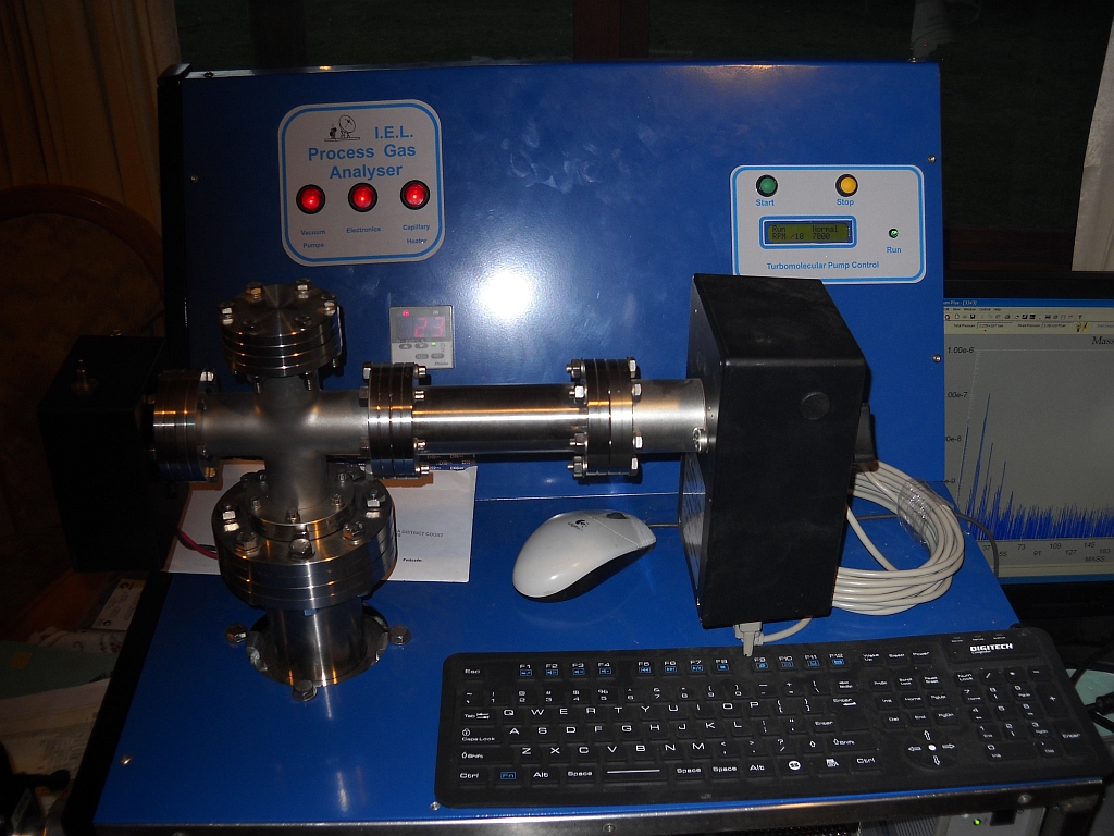

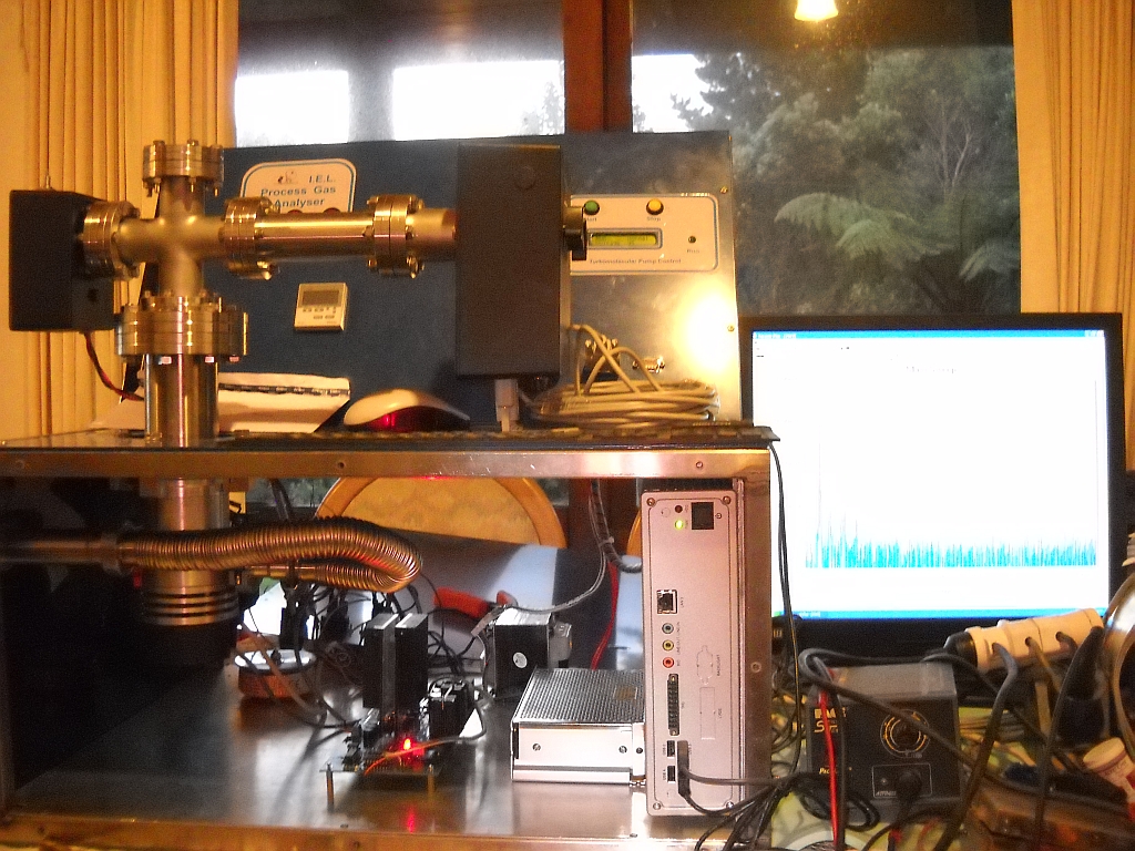

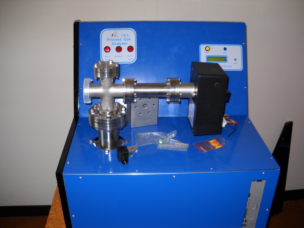

pic of sparse internals
five
pic of what the customer sees
still to mount Samsung 23" monitor on top and deliver during the next week
I'm pretty pleased with the pressure its getting to --no leaks - and fairly clean

How long does it take to react to sample changes with that long of a capillary?
Re: Process Gas analyser
Postby johnf » Mon Jun 04, 2012 3:35 am
It seems to take around 10 seconds
more than fast enough for the intended application
Just finished putting in the sample pump and mounting the new monitor on top

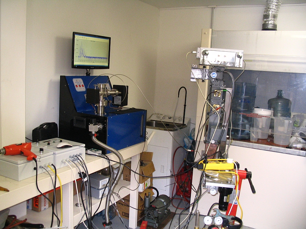

Postby johnf » Mon Jul 16, 2012 4:48 am
I suppose its time to post a pic of the beast in the customers premises doing what he wants
