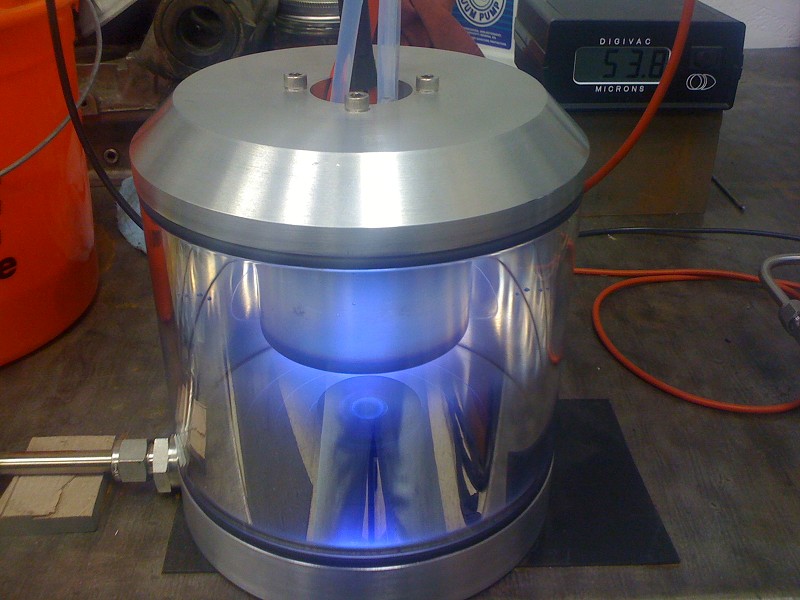

Postby Joe Jarski » Fri Sep 17, 2010 11:41 pm
This is the second sputtering chamber that I built. The first was a 1pt. mason jar just to check the feasibility. I'll post and update with chamber number 3 when it's complete. The cap on this chamber includes a water cooled gun that holds 2 inch targets.

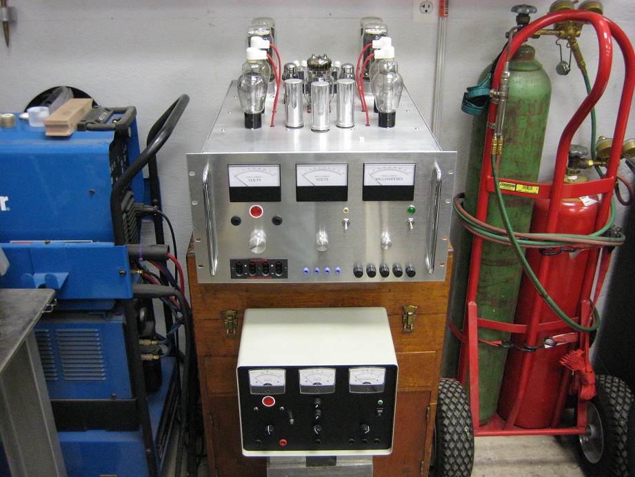

The lower power supply was the first one that I used for sputtering. It's a 25W vacuum tube test bench bench power supply that I built from the book "Beginner's Guide to Tube Audio Design". It worked fine with silver, but didn't have enough power to do aluminum. The second power supply that I tried was a 500V 1.25A electrophoresis supply that I picked up cheap, unfortunately it only lasted about 30 seconds while sputttering. Apparently the the solid state components didn't like the voltage spike from the huge inductor when the plasma went into oscillation. That's probably a lesson for for "It almost worked!". On to power supply #3. Having success with PS#1 & the tubes, I decided to cannibalize #2 for the transformer, choke and other goodies to build #3, which is the supply on top. It's somewhat power limited by the scavenged transformer, but has been working well so far. It's also makes a nice heater for the shop in the winter!

Thanks John. I did find that sputtering order list a while back. I've had good results with aluminum on several materials so far. The tricky one that I'm still trying to figure out is getting good second surface reflectivity from aluminum. Plastics always come out dark, but I'm sure its because of moisture in the plastics. The results on glass have been somewhat spotty, always better than plastic, but not always good. Probably a contamination issue there, which I should be able to cure with this next go 'round.
I've noticed a strange characteristic with aluminum in my system that you may have some insight on. I've been sputtering Al at around 600V and on start up it'll pull about 300mA without sputtering. After some period of time, sometimes a second, sometimes up to a minute, the current will drop to about 90mA with a slight change in the color of the plasma then the sputtering starts. I could only do Al at the limits of my old vacuum system, so maybe it's related to the mean free path. My other thought was maybe target temperature, but I don't think it is. Or maybe single vs multiple ionization?

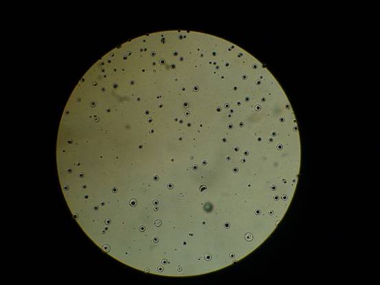

Joe
One of the reasons for bad Al films sputtered by Argon is that alot of Argon gets trapped in the film
after some time the argon aggregates then bursts through the Al surface to escape
pic of surface below normal light microscope used
Re: My sputtering system
Postby Joe Jarski » Mon Sep 20, 2010 10:11 pm
Wow, thanks for the picture! Those craters are impressive, but in a bad way. Is that a unique characteristic of Al/Ar sputtering or is that something that just happens with Al using any gas? I assumed that compact discs were sputtered. Are they evaped or is it another process and/or material?
Sorry to be picking your and Doug's brains so much, but I've found little useful information on the internet. So I've just been working with my own experimentation on mediocre equipment. Going from one of the easiest materials to one of the hardest probably wasn't the best approach either. Hopefully Doug's book recommendations will help me along. Evaporation sounds pretty straight forward, especially with lower melting temperature metals.
