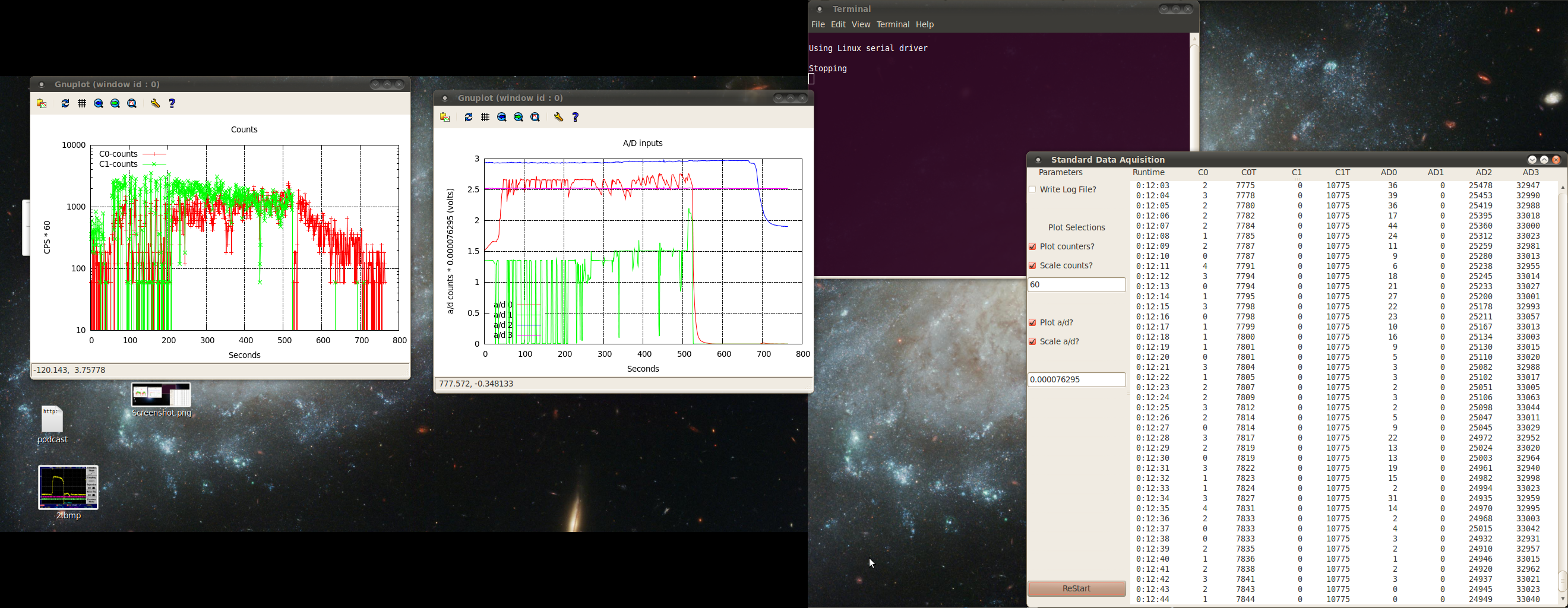

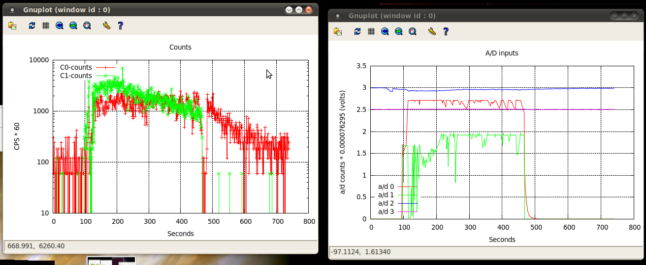

Here is the data aq from that first run.
Early run to bake things out
On the left, the green is the neutron counter, the red is a pancake geiger right in front of the fusor (but behind as much lead as we could manage - that's all scatter X rays during the run). You can tell when I turned off the fusor as the neutrons drop to zero, then there's a short pause while I fetch the silver out of the activation oven and place it over the geiger tube to count the activation. This being a log plot, you can extrapolate back to when the fusor was shut off - so the variable time it takes me to do that job doesn't matter with this kind of data aq system (designed and built here, with help from Joe Jarski). The right hand plot is a few a/d inputs we took during this run, time-synced. The line at 2.5v is a precision voltage reference I use later in data mining to calibrate out any error in a/d full scale range (changes with the computer power supply). The blue line is log pressure - you can see the drop after the run when I pump back down, but without some math, you can't really see the pressure variations during the run (I do that with other software that knows how to handle this raw data and change it into real units). The red line is the HV - topping out at 50kv. The green is the current - about 22 ma max except right at the end when I cranked up the limit a good bit (this plot is linear) - and notice it didn't really help the neutron output - by that time, there's water, H, 3He, and T in the gas in our batch mode gas handling system. Essentially, we've also lost all the D from the tank walls, where some fusion occurs (maybe half when the walls are loaded, and at present, no special D holding material is there - it's just stainless steel). We get about double the net fusion when the walls have D on them, and more in earlier experiments when the walls had Pd and Ti on them. On this first run, you can see considerable instability during the startup - in all the parameters, mostly due to the thing going on and off at the gas threshold pressure, all by itself. You can see the correlation between the neutron counts and the current input (green on both plots). Did pretty well for a warmup run, silver going to something like 1.5k cpm activation (2" sq sample over 2" geiger window).

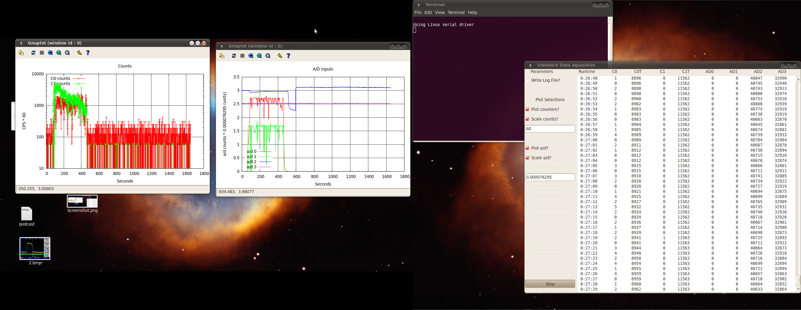

On John's suggestion, while we let things cool off, we put in about 9e-2 mbar of D to let the ss tank walls absorb fresh D while cooling, then made our "money" run. Actually, we did this twice or so, since we were having some fun doing it.
You can see the pumpdown and then pressure increase for one of those in this shot:
Crummy run followed by background, pumpdown, then adding extra D. Note pressure plot is a log of the pressure (PKR-251 sensor comes out that way)
