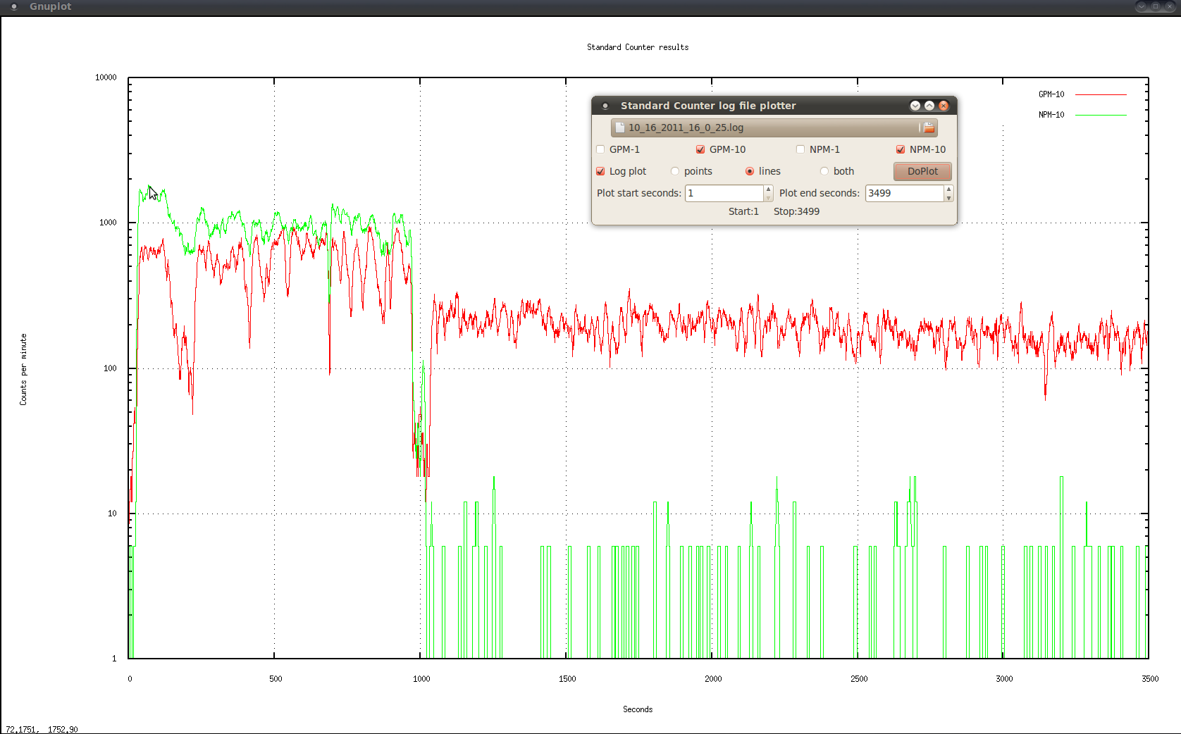

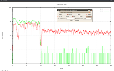

Here's the plots from 30,000 feet: Geigers and Neutrons, lines only, 10 sec averages only, nearly all of run and count after:
Plot of SC log file for run and activation count
A couple of things to note. With our rough ad-hoc calibration off our own and Richard Hull's data, we were making about 1.7 million neuts a second at the start of the run. We are seeing this decay for some reasons we know, and some we don't. The ones we know are that this is batch mode, and after some running, we need to put in fresh gas, as it seems baking and outgassing lets in some pollutants that reduce the neutron production. I need to take a mass spectrum after a run soon to see if we're just making hydrocarbons with the graphite parts of the grid and the D.
(All this windows junk seems to decay with time, it's been hard to keep it all running - windows updates break things, have to go and get new verisions of the main software from the uncooperative manufs to fix that, and so on - quite lame, but a nice lock-in FOR THEM since they refuse to do that without more money after a time -- even though you've already paid them 10's of thousands for the hardware.)
We also see a general decline over the time of a long run, which I don't know the cause of -- hot stuff doesn't work as well? We did not see this on Richards data using the same sensors. Since we've logged this, we can get some real accurate numbers by crunching what's in the log files, but this gives you the overview. At the end of the run, you can see the neutrons drop to nothing, the geigers go down when I shut off the main power (so there's a nice reference on what our background is, right in the plot), and after awhile, where I put the In onto the standard counter to see if I got it hot - and I did!
On this log plot, any decay looks like a straight line sloping down. In this case, that's most of the time for the plot of the overall run. With StdPlot software, we can drill down to more detail easily, and will. We can also go into the log files (attached) and find exact seconds, and do things like find the total counts over some arbitrary time interval to get a long term average as statistically good as the data allows.
Guess I ought to put the log files in there. There are two from standard counter, and one from another computer logged counter I run - the main benefit of the latter is it also logs some a/d inputs that show the power supply voltage and current vs time, along with its own pancake counter at 10 sec intervals. I'll have to write some more perl to plot that one, (different file format) and put in the correct conversions from raw A/D numbers to volts and milliamps. However, empirically, when the geiger counts and neutron counts go down in the above plot, what was happening was the supply was current limiting on the additional gas from outgassing (or whatever is going on), and they return to high levels when I pulse the foreline gas solenoid to take out some gas. At a couple points, I took out gas to the point things "went out" and then let in some fresh (in no case all the gas got out), then adjusted for the right operating conditions.

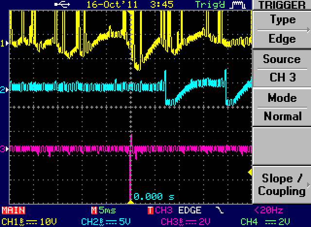

I always monitor all this on the audio and the scope. For fun, here's an example scope screen catpure. Ch1 is a 3He tube, ch2 is a very old B10 tube (farther away) and the third channel is the Hornyak detectos which is what is plotted in the other plots. Nice take on the various sensitivities, and in the case of the 3He, how I need to get back into that preamp and fix up the DC restoration. The B10 preamp is slow (but then, so is the tube response). The baseline noise on the traces comes in because I told the scope to sample fast (2.5 ghz) while the sweep was slow, so I could see even sub-pixel pulses at the slow sweep rate.
Scope capture

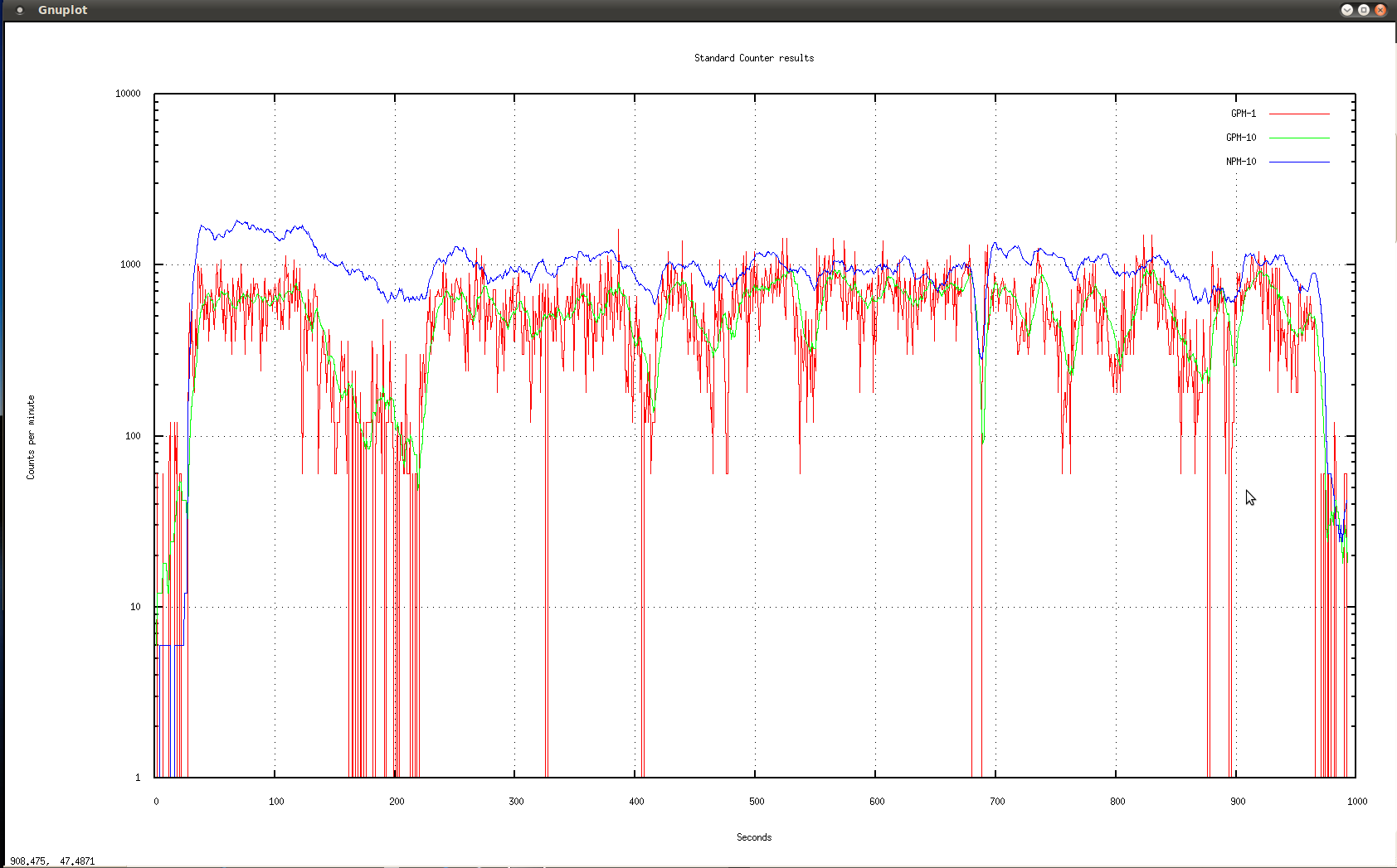

Just the fusor part of the run
The plot above is just the fusor part of the run. I plotted both the 1 and 10 sec avearages for geigers on this, because even though it makes the plot visually noisy it tells you something important - when it went out, and when it came back on. The red lines are always off the baseline when the fusor is "lit". Near the beginning of the run, the gas pressure started going up to the point of dragging down the power supply (because of the current limit I'd set to protect everything else, the supply is a real beast). So I took out some gas -- too much, and it went out. Then let some in, too much again...this is still a bit of effort to run. But I get it going again a little after 200 seconds, and only have minor issues from there on (till my HV feedthrough started arcing inside the tank). When I get the power supply data time aligned and plotted, I'll add it in and all this will be obvious. I'm using the SCPlot software I wrote here - you can zoom in on any part of the file and have a lot of choice what to plot re traces, and styles (points, lines etc). I'm still using log plots here, as they get it all on the screen the best, and in meaningful ways -- the linear plots just blow up the noise better.

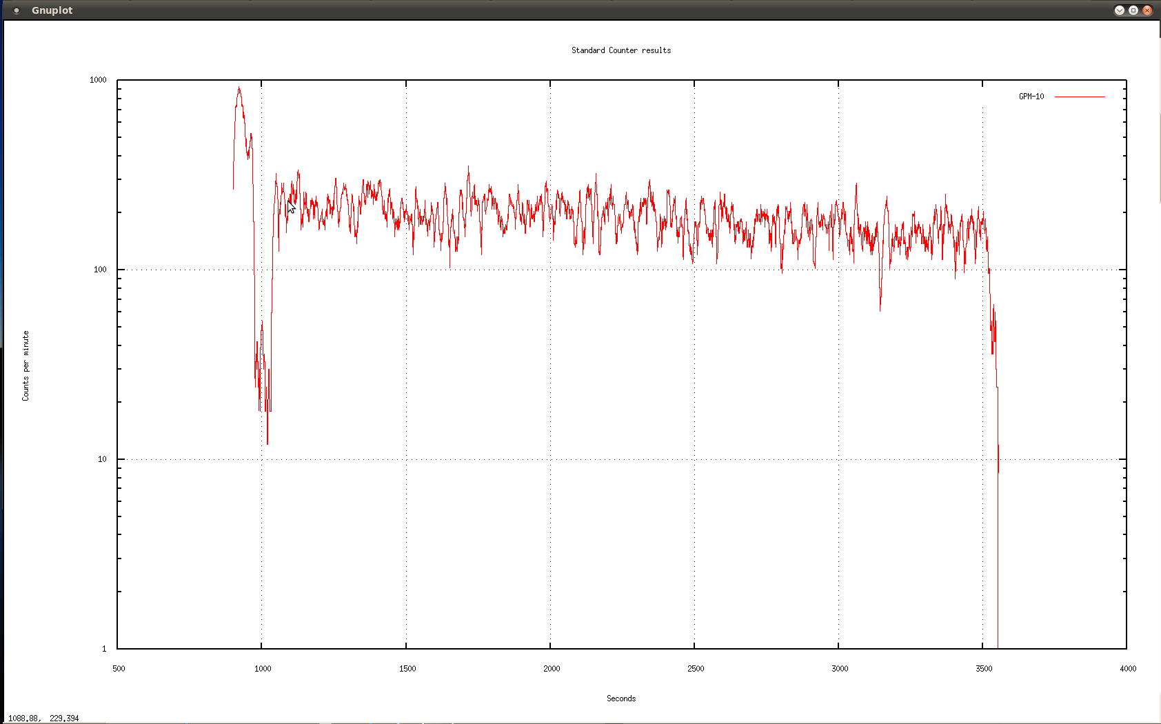

Here's just the Indium decaying. On the log plot, it's a straight line (and is simpler than silver decaying, because it lacks all the short-lived metastable states silver has). Looks like I got it into the 229cpm range, with a background (also shown) that long term average is about 27 cpm here.
Just Indium, nice slow decay

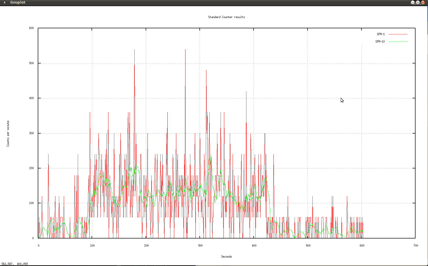

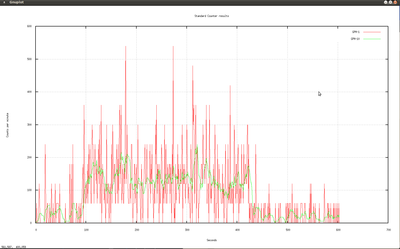

I caught a little of the tail of the fusor run (some high X rays due to the FT arcing still at medium high voltage), then some background, then the indium. I also looked at this on a linear plot, but I didn't take a long enough count here to really see the belly of the exponential.
For noise and statistics semi-junkies (real junkies will download the raw logs and do the work themselves!), I took another count a few minutes later, and plotted it linear this time, with 1 and 10 sec averages so you can see how noisy and random radioactive decay is, particularly when it's only several times the background (which I caught on both ends of this one).
I'd guess I'd have had to make about a 2 hour run just counting this to show the nice exponential shape...
3-4 minutes after previous decay plot end, linear, In decay
