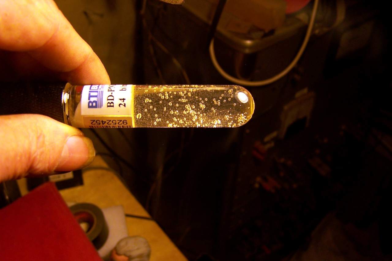

Luxury! Well, I've been trying to get some proof that the upstairs fusor, now with one of those nifty gas inlets, really makes neutrons. See pic, it died happy.
BTI's last gasp
