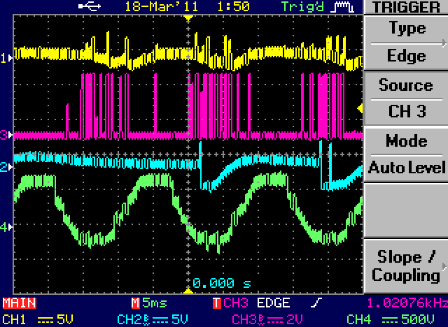

Here's a rather enticing scope capture. Here, we are putting in some 60hz AC on our second grid, and note how it's "herding" the fusion to a particular part of the AC cycle. What interests me about this is that the average neutron rate does not go down, even though the main grid current does, somewhat, and the time during which neutrons are produced is obviously less. So a little fooling around with things like this is obviously warrented. Can I for example increase the duty cycle during which it's making neutrons? In that case I get more output and less input, which of course is the direction to be going in. I kind of seriously doubt that a 60 hz sine is the best perturbation signal, or that this off center randomly aligned grid is the best way to do this -- but again, it does produce improvements even so. Time to whip out a huge audio output transformer I've got (LTC lin standard!) and the arb waveform generator and explore at least the audio range, and perhaps a different type and placement of the secondary electrode, eh?
Top trace, 3he analog., purple trace after thresholding (and is the scope trigger), blue trace is the b10 tube, and the green trace is the applied AC on the second grid.
