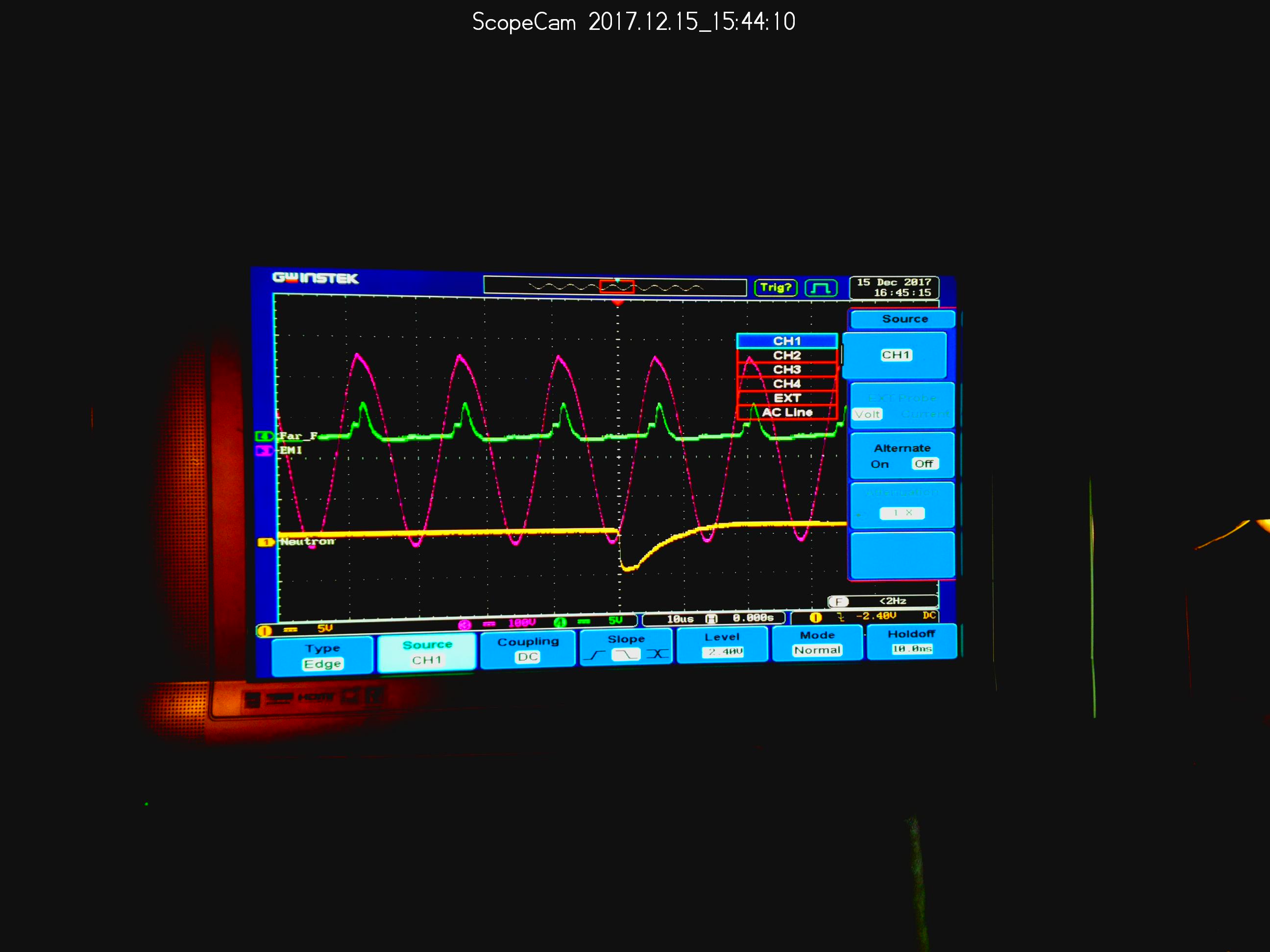

Postby Doug Coulter » Sat Dec 16, 2017 9:23 pm
Running with AC drive on the main grid - actually AC coupled via a 750 pf capacitor, which results in a 30/70 +/- waveform symmetry as any positive voltage on the grid attracts electrons very well. - the fusor acts like a diode to ground for positive voltages - so we have kind of a not-very-good half wave voltage doubler with no output filter. This run is with "around" 14kv P-P at around 68khz sine wave. It's been problematic to measure the real AC voltage as anything near the HV probe moves the reading around hugely - just a handwave near it changes it 50% - so any number I would relate would be pretty suspicious anyway. I could measure what showed up as charge on the series capacitor with some confidence - around 7kv. This resulted in a few neutrons, not tons, but at a lower threshold than with DC by a good bit, and it was easier to light off and stay lit even with this much lower than usual voltage. No ion grid drive was used.
What is interesting here is what we see on the faraday probe channel. We see short positive pulses, as though the D+ ions were being bunched up, and then repelled by the main grid when it went positive. We saw what looked like a beating kind of behavior, where some sort of ion oscillation would build up around once a second or so, and neutrons would be produced along with some "interesting" changes on the scope looking at the faraday probe. If we triggered on detected fast neutrons, we saw this multi-pulse on the Faraday probe 100% of the time. Triggering on just the drive - never saw it.
This might be the first time this has been seen or measured. What might be significant is that we got neutrons well under our normal DC threshold voltage for a detectable output, and with DC anyway, things scale up a heck of a lot faster than linear with increased potential - 3rd power maybe, or maybe a lower power but with (volts-threshold)some exponent. If this turns out to also be true with the AC drive, and of course, there's just about no way that what I tested with here was the magic ideal parameters - then it's going to get exciting when we get louder and get closer to the right frequency, which looks like it's going to be a function of the voltage itself - it seems to be in the traces shown in the video - lower voltages seem to have more phase lag to the neutron output. This is consonant with the existing math for ion traps and mass spectrometers, so perhaps I'm not in left field. But you never know for sure till it's all measured and repeatable. This at least seems really repeatable. More to test and measure. This was for sure a "hmm, that's funny" moment in the lab - we know what that means here.
Thanks to BillF for the help and motivation - and some of the parts.

A friend mentioned he couldn't quite read the scope in the video, so I thought I'd go ahead and just upload most of the slideshow here - the originals aren't too bad.
This one is kind of the baseline, what we saw most of the time.
This is what we see with a free running trigger.
Now, when we switched to triggering on fast neutrons, as detected by the numb but time-accurate Hornyak detector, we saw more interesting things.
Moe than one burst of + going by the probe
The filenames of these contain the timestamps for when they were taken. They're in reverse order here.

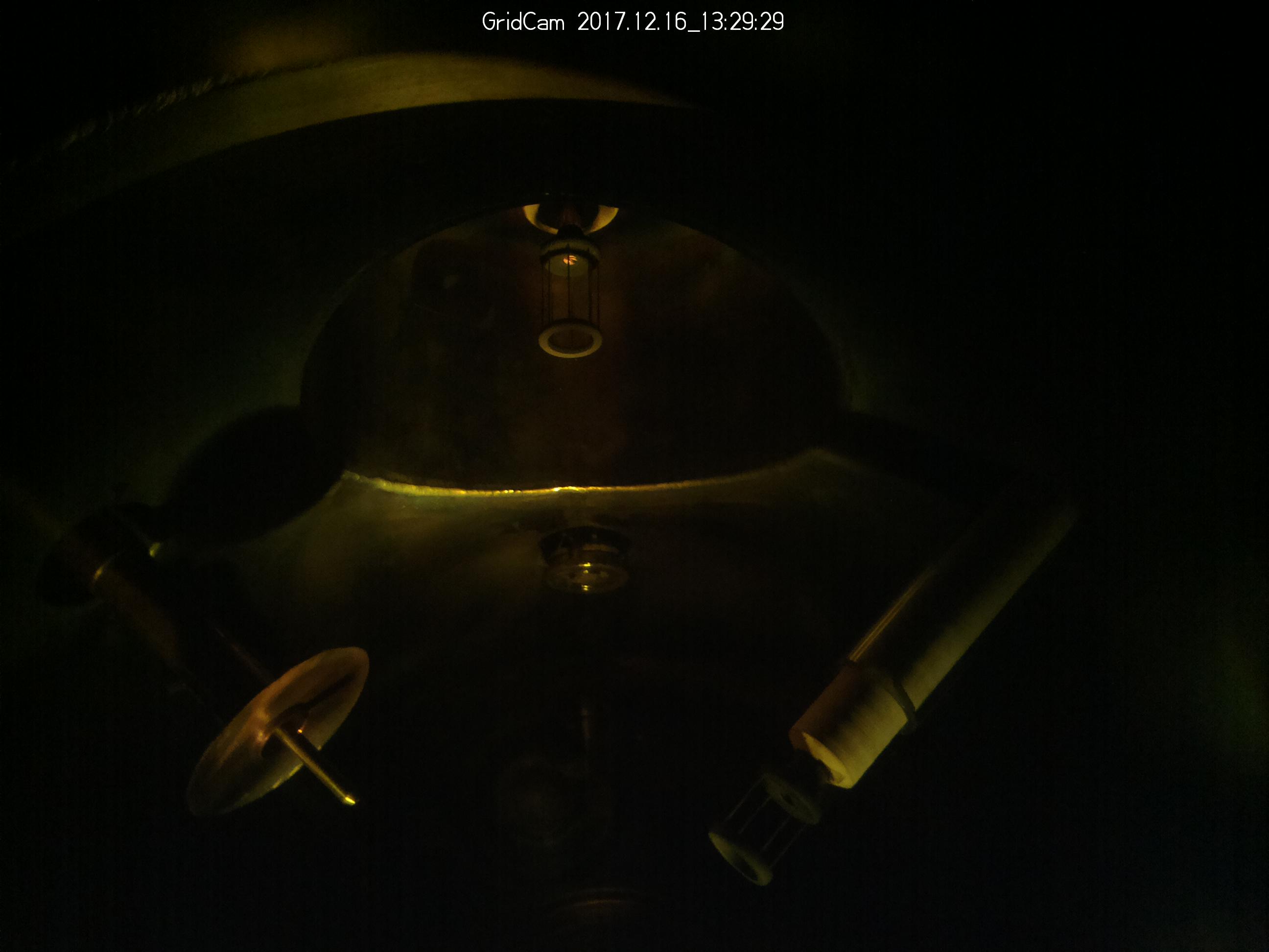

The top view inside the tank (power off, just a flashlight shining in the front window).
Inside the tank.

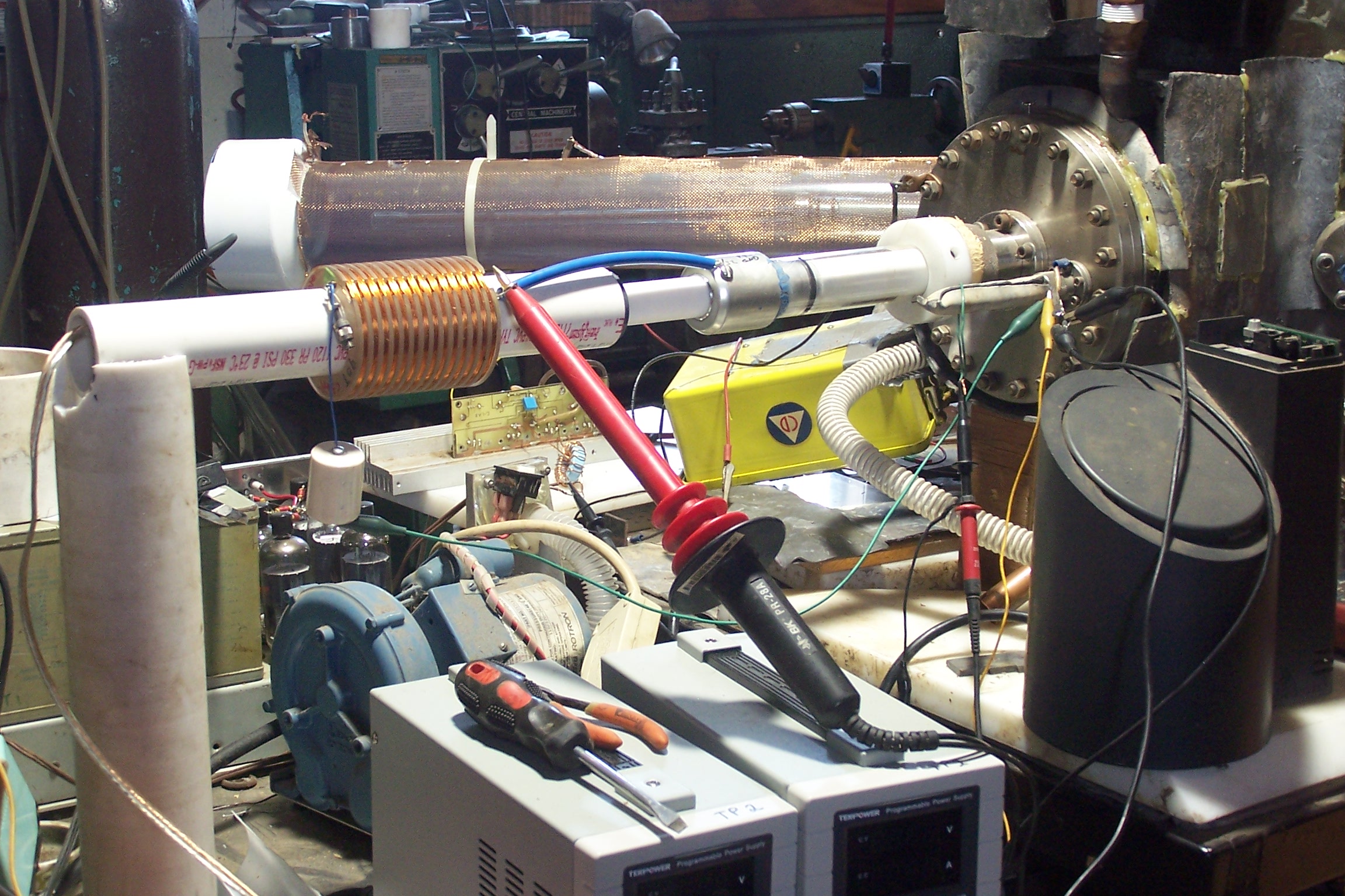

The final drive stuff. A FET H-bridge not shown is driving a 4 turn primary on a ferrite slug inside the big coil shown here. I'll have to design and build another if I want a lot more speed...no biggie, but it'll take time.
Some of the drive stuff.

Preliminary congratulations on your interesting preliminary results, Doug! Being able to drive the thing with AC is indeed a milestone - now some real physics can get going.
Is your Faraday probe signal showing current or voltage? Also, is it surprising to you that it only shows positive signal and never negative? Is it rectified (other than by the plasma)? As you probably know, there's a limit to how much a floating probe can tell you about what's actually going on, due precisely to the shielding effects from the electrons you've described. Down the road it might be worth building a proper double- or triple-probe, but even in the short term since the ion grid is not in operation, I wonder if you could use that as a second probe just to get more information on how the charge is moving in the tank. (Biasing it relative to the Faraday probe you have now and measuring the differential current might also be very informative.)
The fact that your Faraday probe signals are not obviously periodic relative to your drive is puzzling and is bound to make any interpretation difficult. It's going to be awfully hard to construct a model that explains a signal that's different every time you look at it. If this is chaotic dynamics and if you've been living right, it might turn out to have a periodic attractor at some amplitudes or frequencies (IF you can stumble into them). It's always hard in science to know when it's time to start speculating and when premature speculation is going to lead you down the garden path with self-imposed blinders on, but if I can throw in my $0.02 it does seem like the Faraday probe may be picking up signs of a soliton structure in the ion density. The multiple echoes might indicate rotation of that structure, but again, hard to make any inferences without something repeatable (like time between echo pulses or time from some driving voltage threshold to the Faraday probe peaks). Having even one more probe to compare the signals in time and space would be valuable.

Postby Doug Coulter » Wed Dec 20, 2017 4:09 pm
I'm looking at the probe shown in the picture, which is loaded with a 100k resistor to ground (plus parasitic C from the structure shown and a scope probe), so I suppose some of both potential and current. Yes, the ion grid could also be pressed into service, though it's almost equidistant and geometrically symmetric and might not tell us much more. There are, however, some other things sticking into the tank, mostly near the far walls of the big part, that might be looked at. I'm trying to avoid opening it up - it's been under hard vacuum (10-8 mbar) when not in use for almost 2 years now, and that kinda gives confidence about contamination - and has definitely improved repeatability of a lot of things....Yeah, I have a door, and more already-installed feedthroughs, and as a last resort...It's kind of gratifying how long that Pfeiffer turbo has been continuously running...a lot longer than they say it should between bearing replacements. Lucky so far.
Yes, it's surprising that I don't see negative on that probe, very. I normally see quite a lot, due I think to excess electrons that are likely secondaries emitted when things strike the grid electrode. This theory is slightly bolstered by the fact that it has tended to be less when I used grid materials with higher work functions, limiting with what I have now - pure tungsten and pure carbon. It was far worse when the grid rods were thoriated or lanthanated tungsten (I'm using TIG welding rods for this), and the ends something other than graphite. After all, we have an endless supply of electrons available, they go through wires nicely, unlike nucleons, and we have a pretty decent pump for them in DC modes. Still, you'd think that due to some of the above, I'd see an excess of electrons and for sure not an excess of positive (well, maybe my eyes aren't good at integrating a tiny long period negative against a few short positive pulses to see the net accurately) here. Always more to learn. I suppose it might be due to the power supply in this case being AC coupled and things balancing out in the coupling capacitor.
I'm really not sure about the rest at this point. Yes, we could have soliton like behavior, migma like, strange attractors, or phenomenon that could be described in several ways. What I do note here is that this is nearly the first time we've been able to measure anything much dynamic going on at all - while also getting neutrons. Just pulsing the main grid with a big negative pulse didn't show us anything like transit time on the Faraday probe - just capacitive coupling - and also - no neutrons modulated by the pulse. Just getting any kind of transit time took a couple years of trying this and that, and what finally showed us something we could take to the bank was modulating the ion source grid. FWIW, the numbers we got still approximately agree with what we're seeing here. Going backwards though the math (I wrote a perl program called speedvolt to do some of that for me and checked it against transit times in electron tubes for that e/m ratio and sizes) it seems we're getting insanely low energies on our D ions...which would kind of explain why existing fusors are so lousy. Partly because Richard was right about most of the ions being created near the bottom of the potential well (such as that is - it's not a pure function of the applied potential) - where the cross sections are favorable for ionizing stuff. In fact, one valid way of starting to analyze the old fusor is to think "why is this so terrible, it would seem it ought to work better than that?". In explaining things, maybe the best way is to attack this from both ends - why is that so terrible as one end, and how could it be really good from the other - maybe we meet in some decent middle.
There's plenty unexplained to look at! I'm trying to live right, and yes, we do have the necessary (and maybe sufficient) conditions for chaotic dynamics - it's certainly fractal in the sense that this is all recursive - the input state is the previous output state. I'm hoping that there's a simpler solution to the dynamics than a pimply snowman on it's side, of course. We could hope for a strange attractor.
In fact, it's been my observation (mentally) that the dynamic equilibrium achieved in a DC operated fusor is one such attractor, and it's the one that makes the least fusion - when everyone makes their rig stable, it's worst case in actuality. We've noticed repeatedly that just about anything that knocks it off that perch momentarily increases neutron output, which is part of why we are doing this now.
I do strongly suspect that when we see those multiple pulses on the faraday that what we're really seeing is the results from more than one previous cycle, almost time-aligned at the probe position - and probably better aligned at the grid focus (which I don't show here as it's pretty dim at this power level, but it qualitatively looks about the same as with high power inputs of DC).
