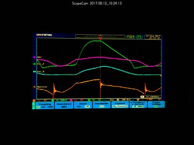

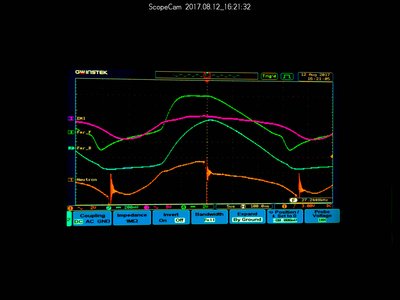

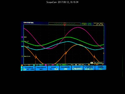

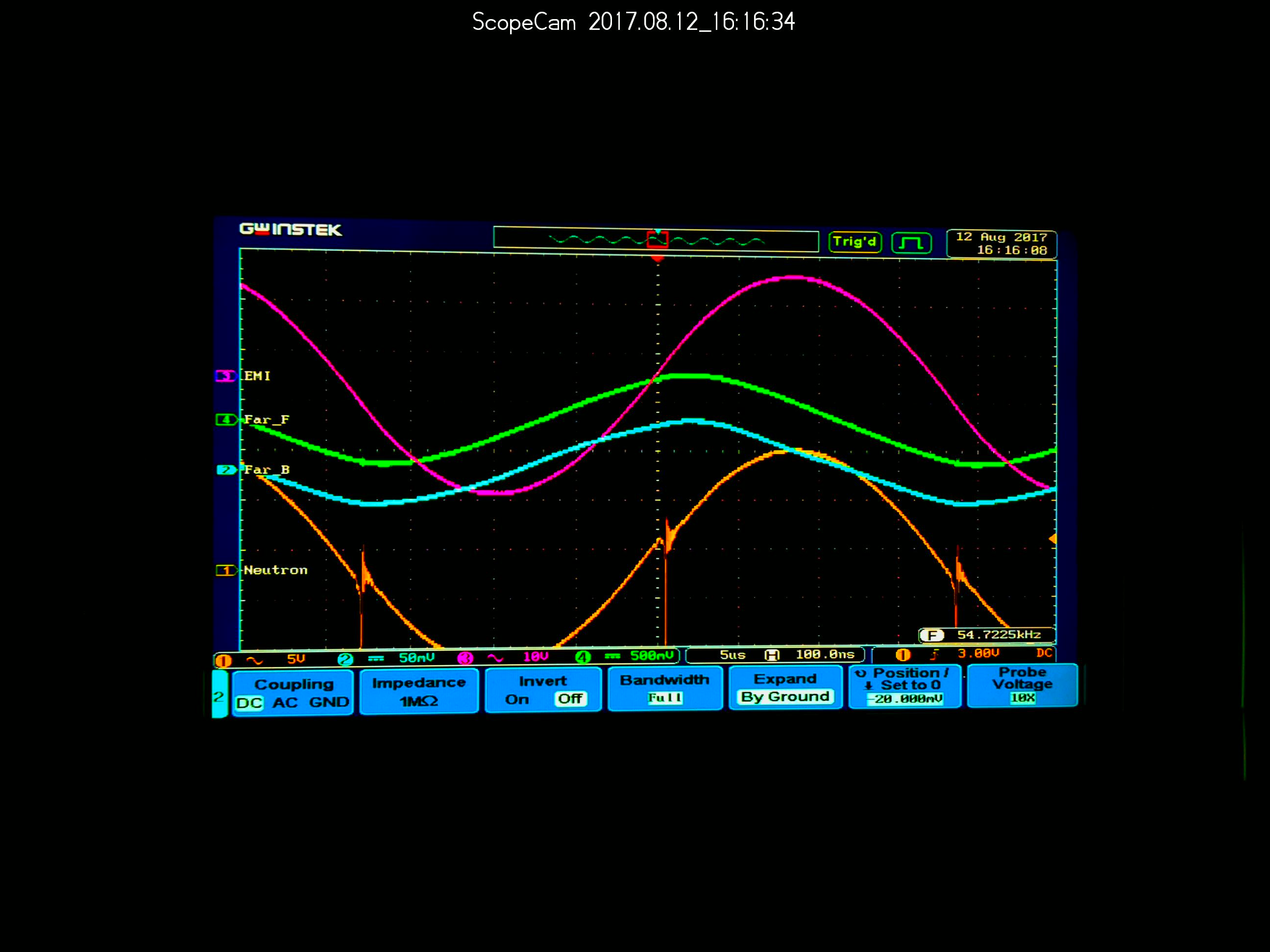

Here's the log text I wrote while doing this with info on what I was doing. The first two (one picture and one plot) were at a lower frequency than the later ones - I adjusted to nearer resonance to get more voltage out and easier light-off at some expense in higher power when not under load. It actually draws fewer watts under load!
17_08_12_16:15:33.scopedat
17_08_12_16:16:19.scopedat
Above not lit, different scope gains, changed frequency higher nearer resonance

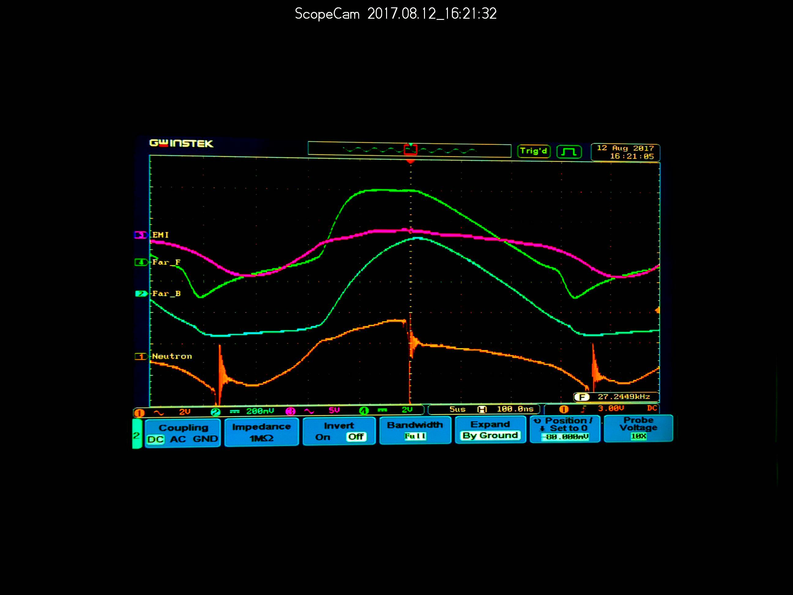

These lit no DC, but it took 3e-2 and ion DC to light, then took down to 1.9
17_08_12_16:22:10.scopedat
DC on:
17_08_12_16:24:48.scopedat
DC wasn't into the higher voltages for good neutron production, more like 10kv or so - current limited at 5ma - I used what we used to use for the ion DC power for this.
It did make some neutrons, just nothing to write home about - around 100k/second.

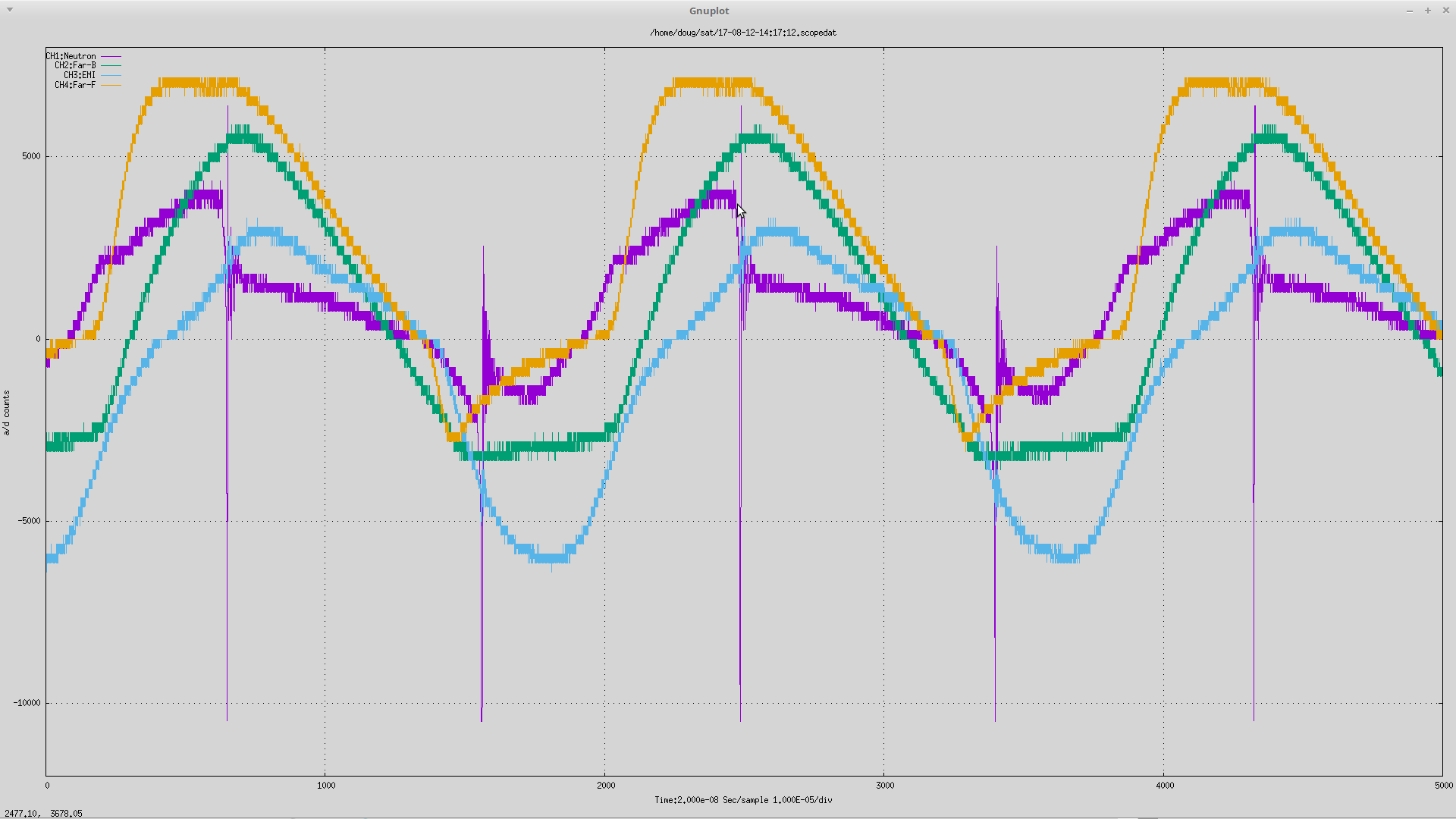

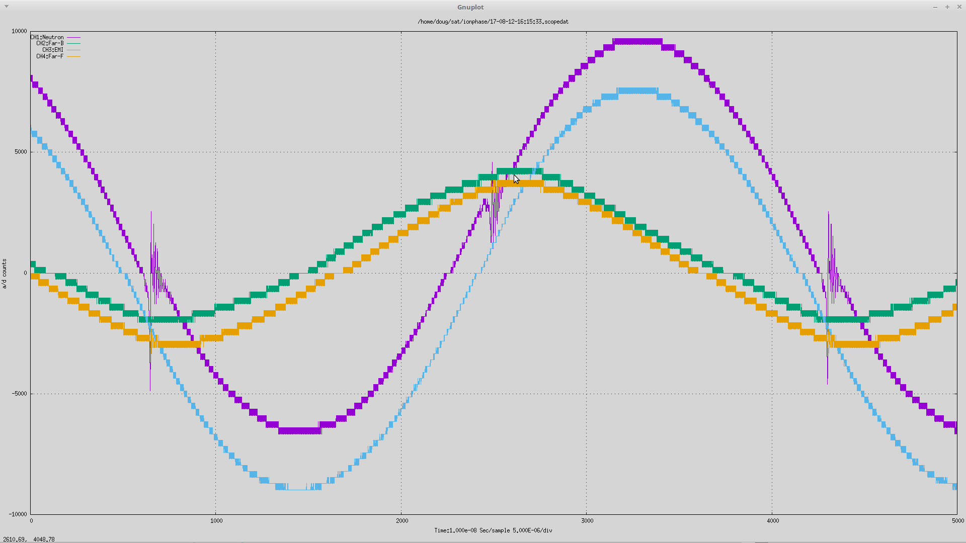

So, here's the visuals for step one - just tuning it up and with no gas present and no DC:
At the lower frequency.

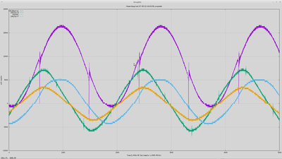

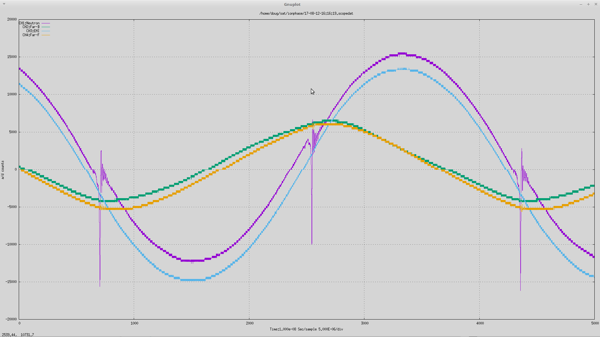

Plotted from scope data (colors and scale different)
Note, the scope plots are from raw a/d data from the scope. Color mapping is different, but the labels are the same. This is what the scope a/d sees, and all are zero-based unlike the scope display.
If anyone wants raw data to do analysis from, I've got that - I just wrote a grabber program and a plotter program (which for now mainly concentrates on shapes, not labels and pretty stuff).
Gnuplot lets one place a cursor anywhere and then see the XY coordinates of that spot exactly. So one can find out what was when and how loud for basic human mark 1 eyeball analysis and not worry about the camera being tilted. And we know the scope sample rate, so at least we get time exactly right.

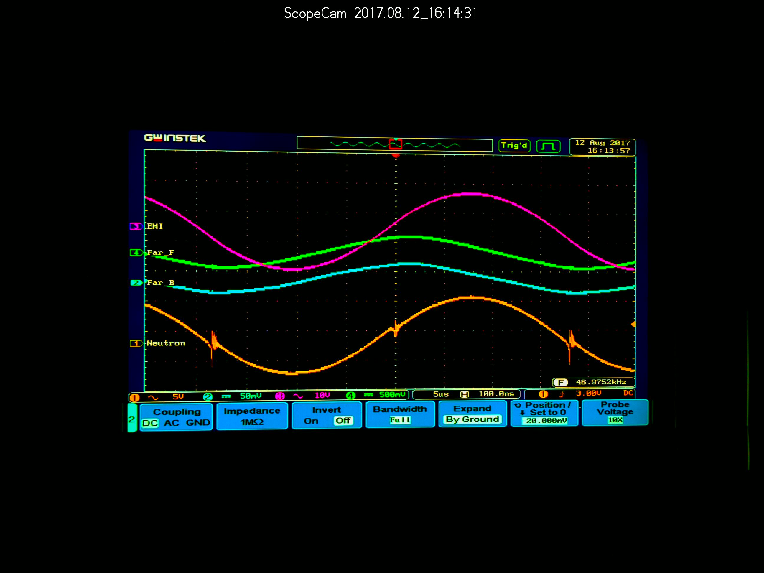

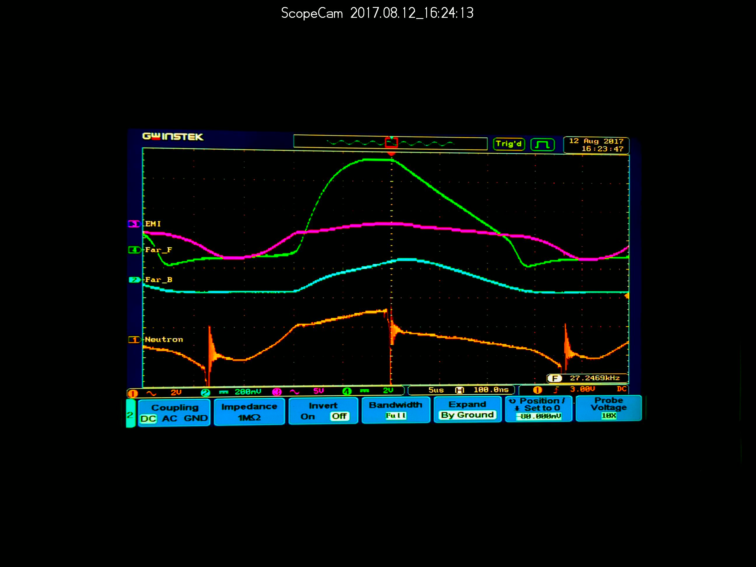

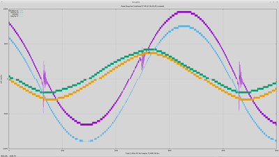

After turning up the frequency somewhat, but still no gas, no DC power and no light:
Slightly higher frequency and amplitude

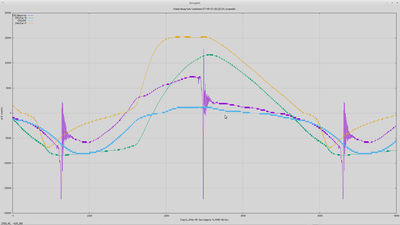

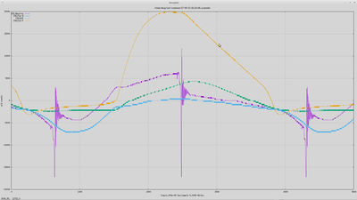

Plot. The glitches are where the H bridge switch happens.
We see here that with no load, the primary waveform and the EMI are pretty much in phase with one another (the latter picked up by a 100 Meg, 100::1 probe near the HV output - just capacitive coupled - for that matter, through plastic) This is going to change when we get a load on this.

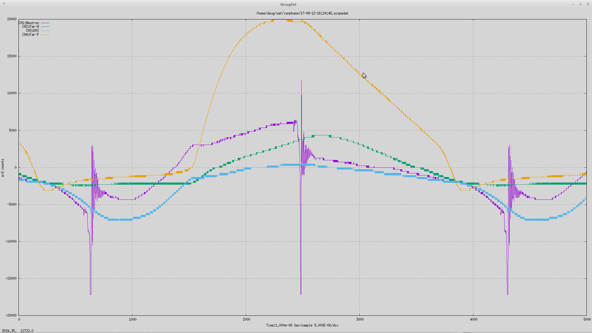

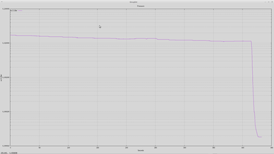

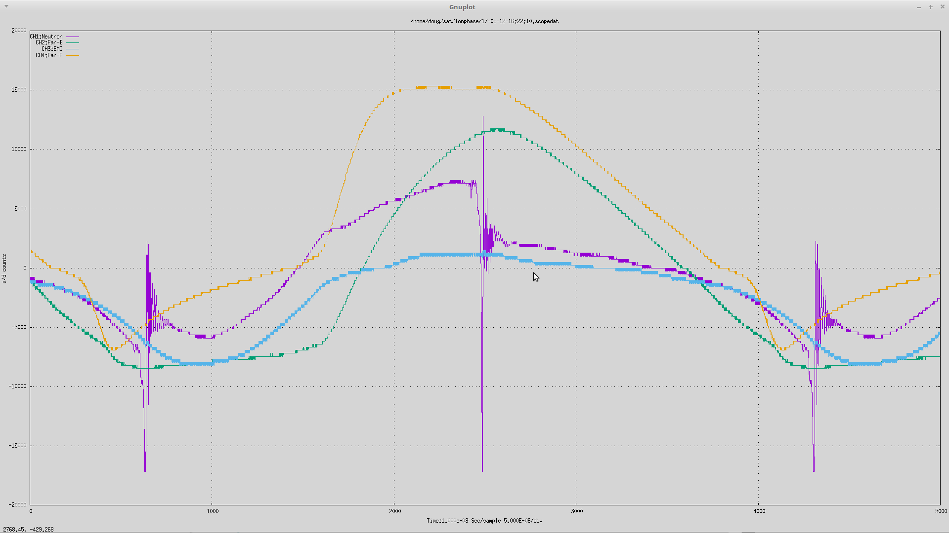

I put in a bunch of gas (around 3.5 e-2 mbar) and temporarily turned on main grid DC (about 30kv no load) to get it to light, then took gas back out to around 1.9 e-2 mbar and turned off the DC for now. That resulted in the below. Note that I changed gains etc to get a good picture; part of the reason there is both a screen capture and a plot for each state here - the picture shows all the incidental scope parameters better. Some things, like the coupling from the ion AC source to the faraday probes get a LOT louder when it's lit - which kind of makes some sense. The load changes the primary waveform and now the peak voltage at the output is around one of the zero crossings of the H bridge (see glitch). This is some of the info I need to be able to interpret the rest I'll be putting up later on.
Note lower volts on primary and vastly different waveform there. Supply for h bridge drawing *less* current in this state(!)
gnuplot of roughly the same stuff (can't hit two buttons at once, but I try)

I WILL analyze this to the extent of noting that the almost perfect 90 degree phase lead of the two faraday probes goes away once things are lit off. Check the scope gains, but capacity coupling would account for the lead here. Once there are ions and a lot more current on the probes is involved, you'd expect there'd bit a little transit time as well as less differentiation of the input.
The whole reason I did this baseline is because other data I got - soon to come here - showed me some kinda baffling things, but now that I know that and where the actual peak of the HV ion waveform is in relation to the other stuff...it all makes more sense (to me).
ALSO NOTE: scope trigger rates are often confusing due to that nasty glitch on the signal I'm using for a trigger...be warned. 28khz or thereabouts is the right number for most all of this.

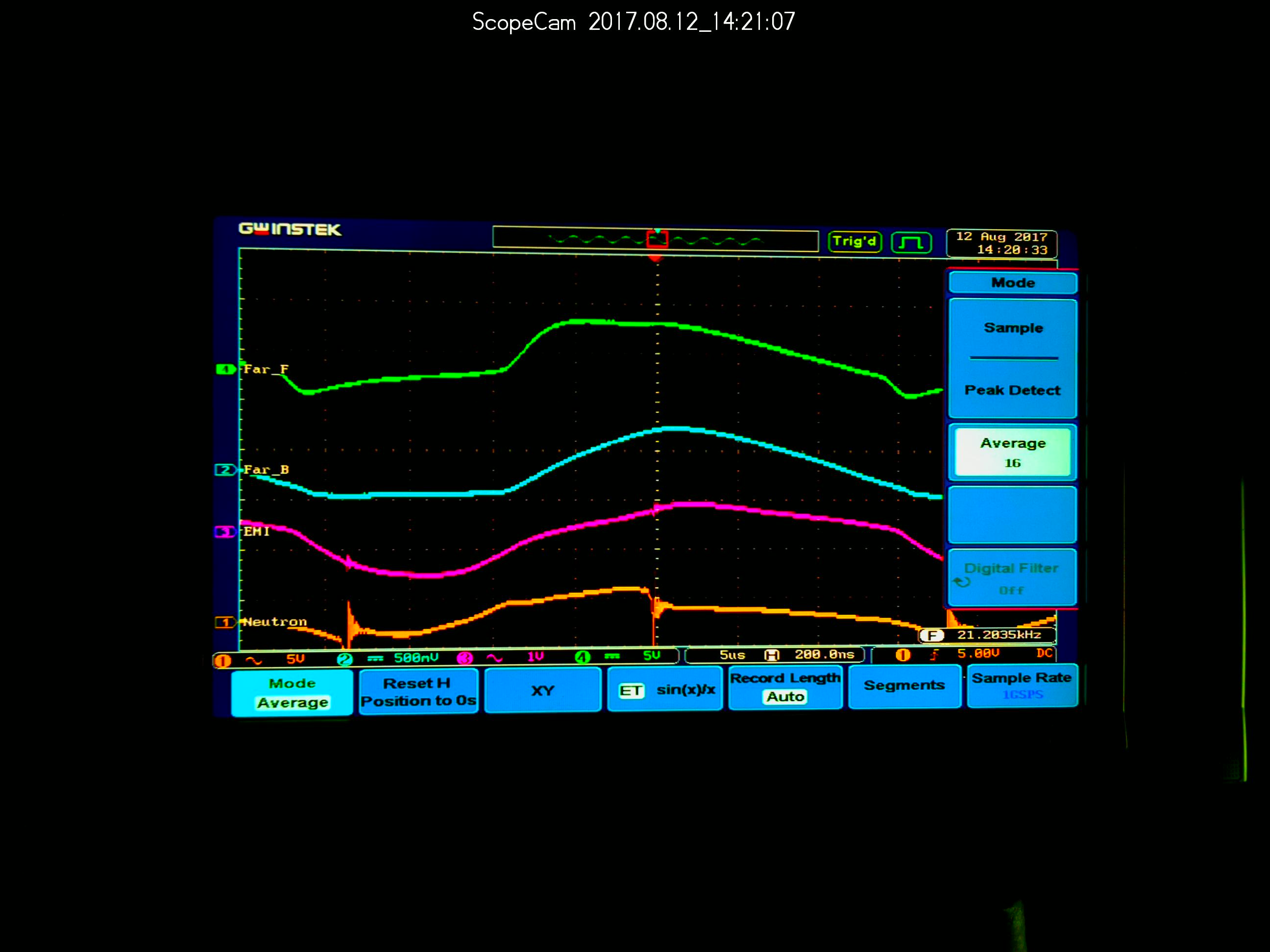

So, here's the skinny on the run earlier on the same day:

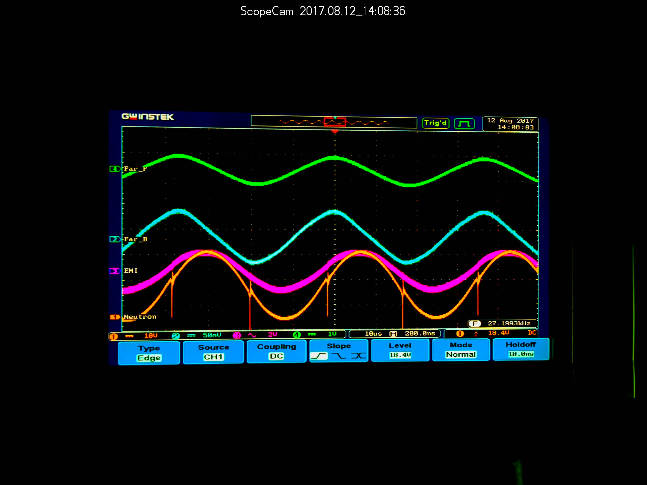

m_0000_20170812_140837.jpg and
17_08_12_14:02:54.scopedat are with no load, vacuum, 22.4v in .591 amp, above resonance
im_0002_20170812_135120.jpg gridcam shot (there are some regular cam shots too)
Very hard to see faraday front probe even in other cam shots.

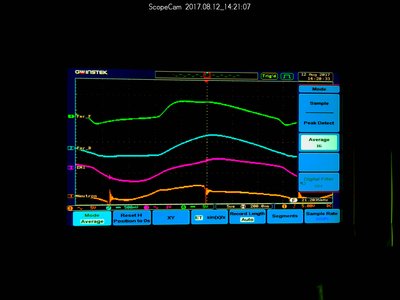

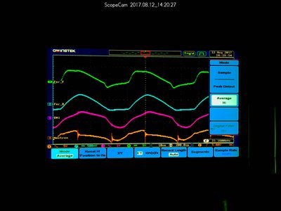

17_08_12_14:17:12.scopedat ion lit 1.6-1.9 e-2, .386 amp note changed scope
gains -
17_08_12_14:25:27.scopedat
and a different sweep on one
vid with main grid off-on-off vi_0015_20170812_142707.mp4

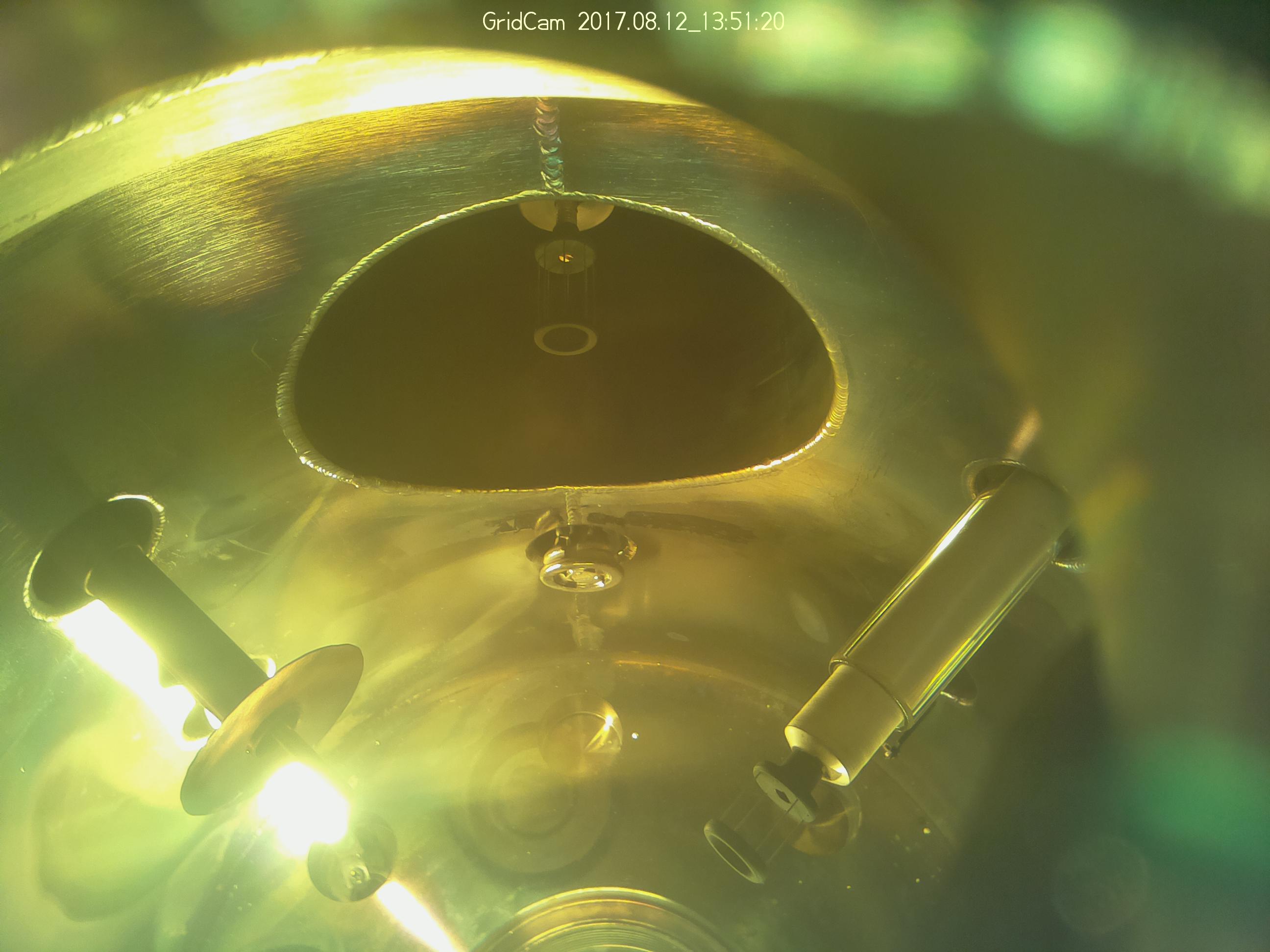

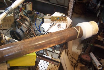

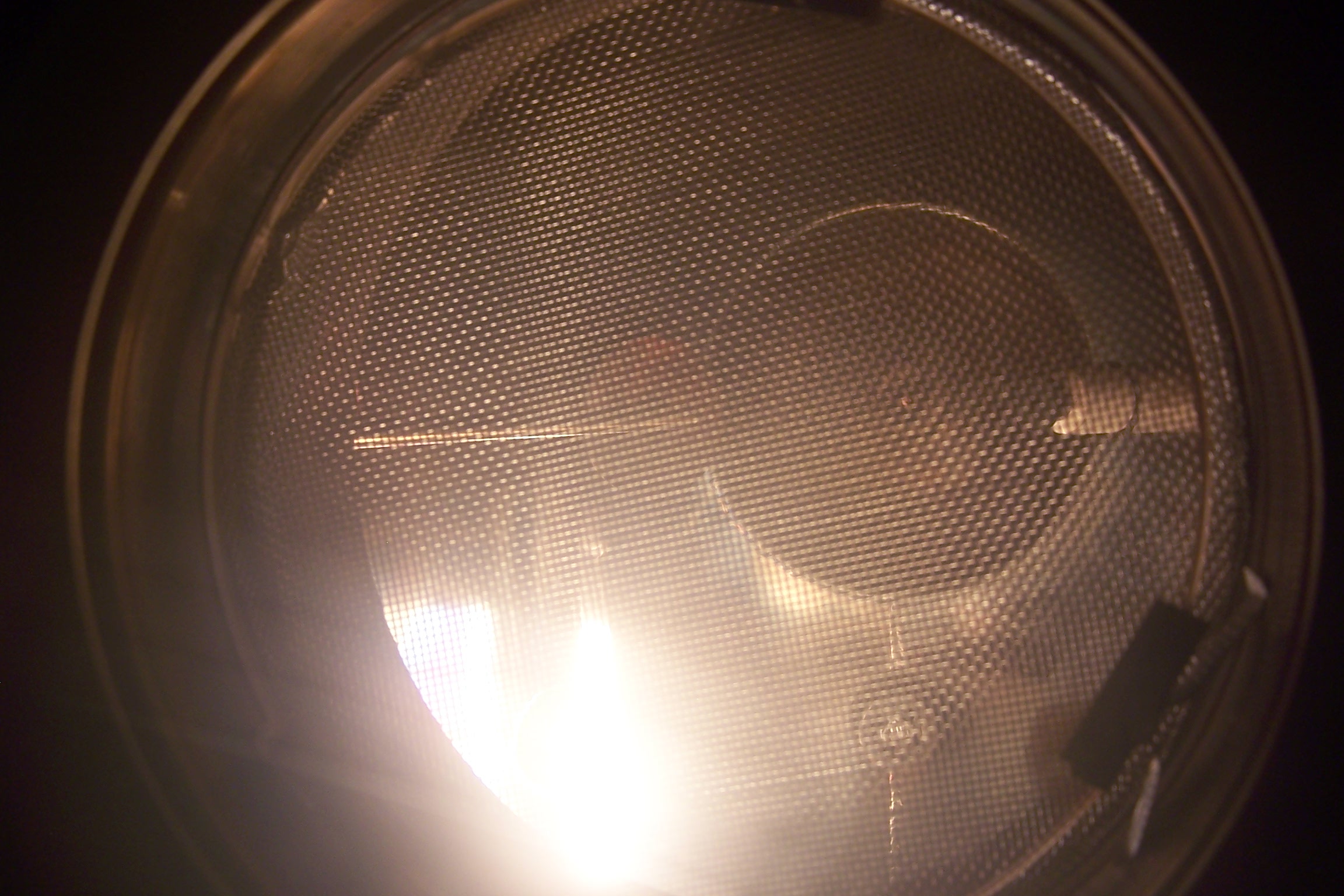

First some pictures of the insides of the tank. Due to view angles etc I couldn't get a picture of every grid and probe in the same frame...Oh well.
the grid cam I have all the time. Ion grid on right, faraday_b on the left with light behind it, main grid in sidearm.

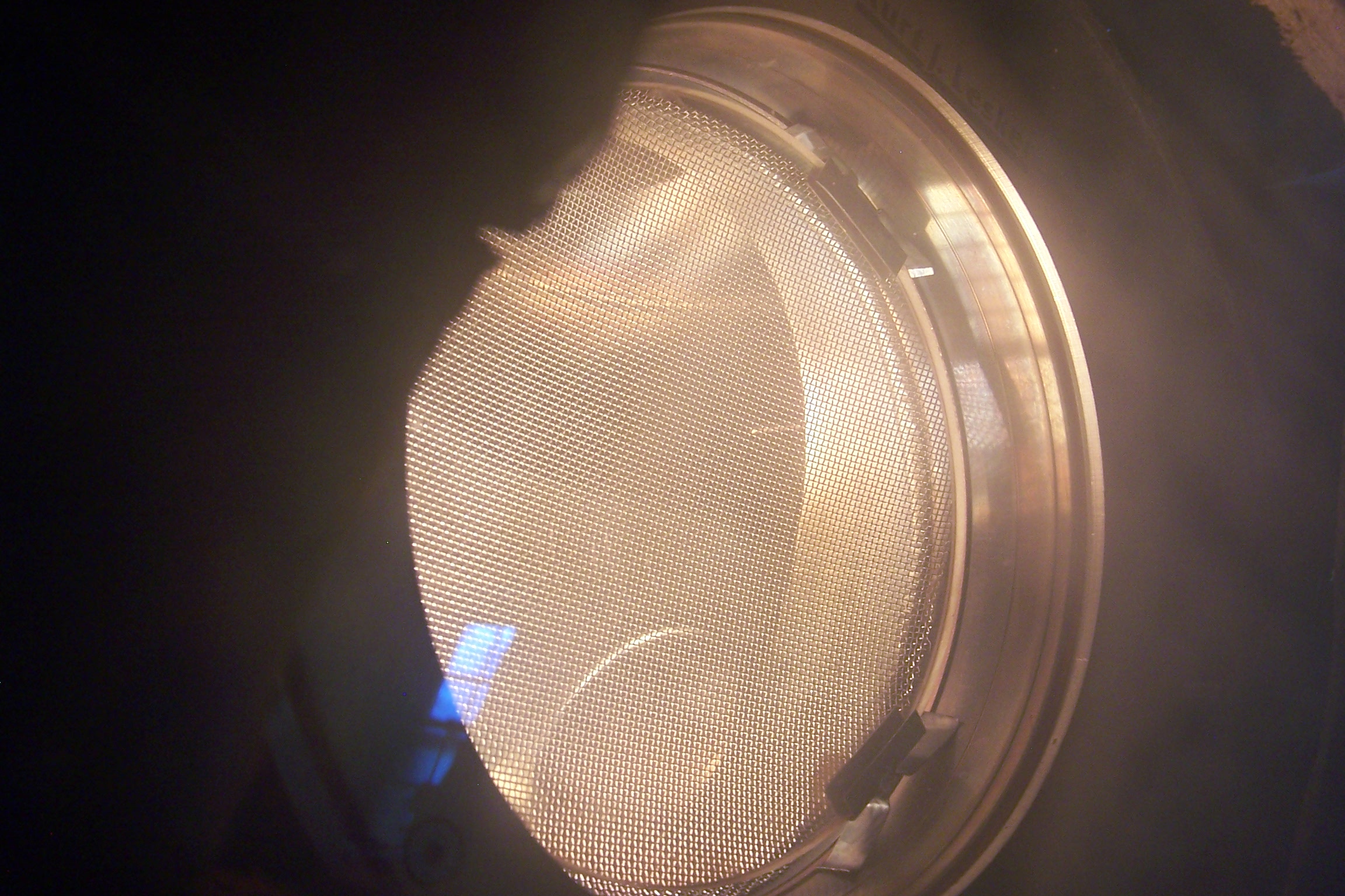

Some attempts through the front glass (and sadly, dense stainless steel screen which keeps the glass from being ruined by hot electrons).
More or less the same thing from the front.
The screen makes it kinda hard to get a good picture, but those glass doors aren't cheap, and the sacrificial glass that's here along with the screen is turning brown...
Up and behind the ion grid, you can just see the end of faraday_f poking into view at upper right.

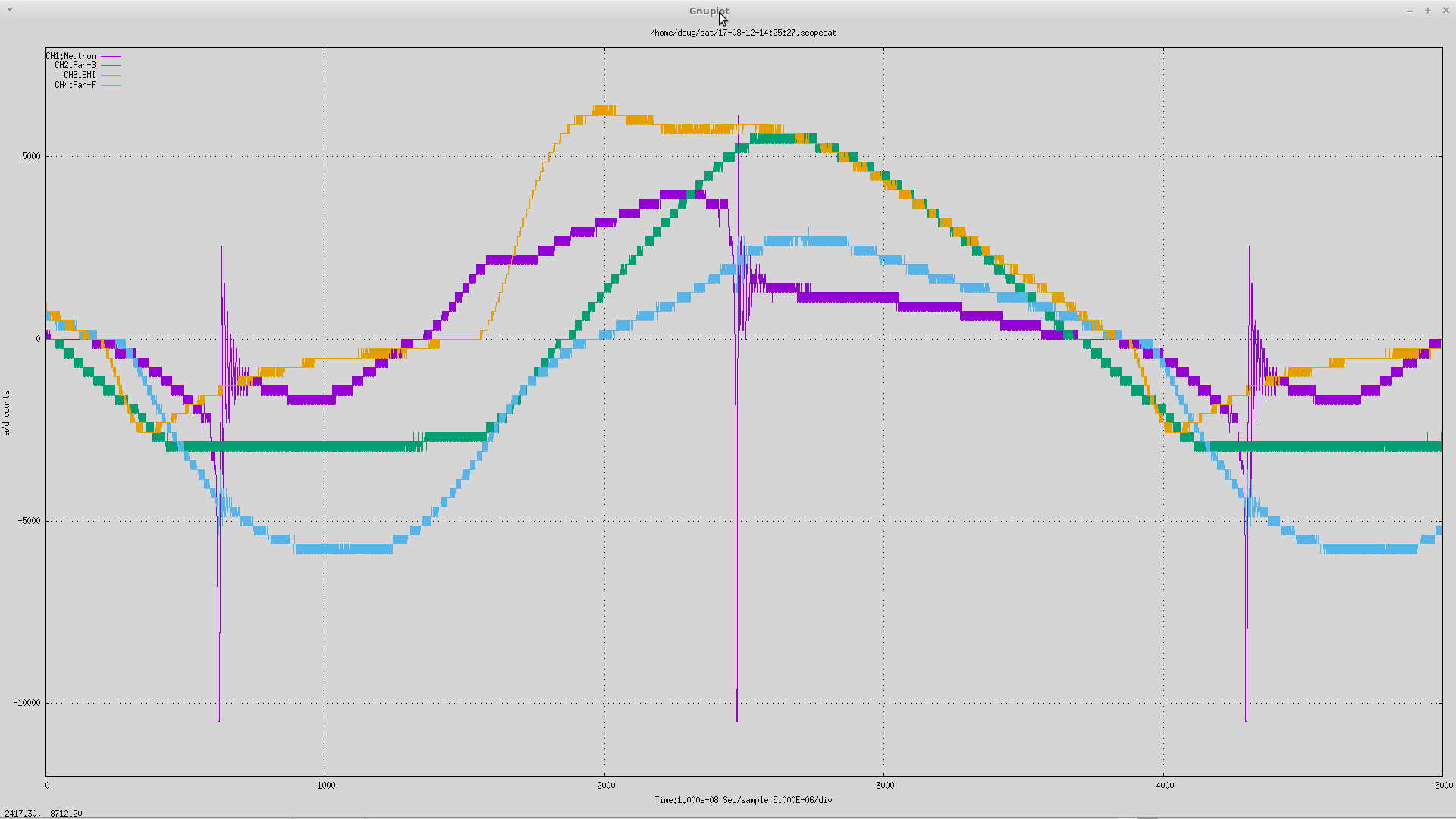

Here's some data from this setup:

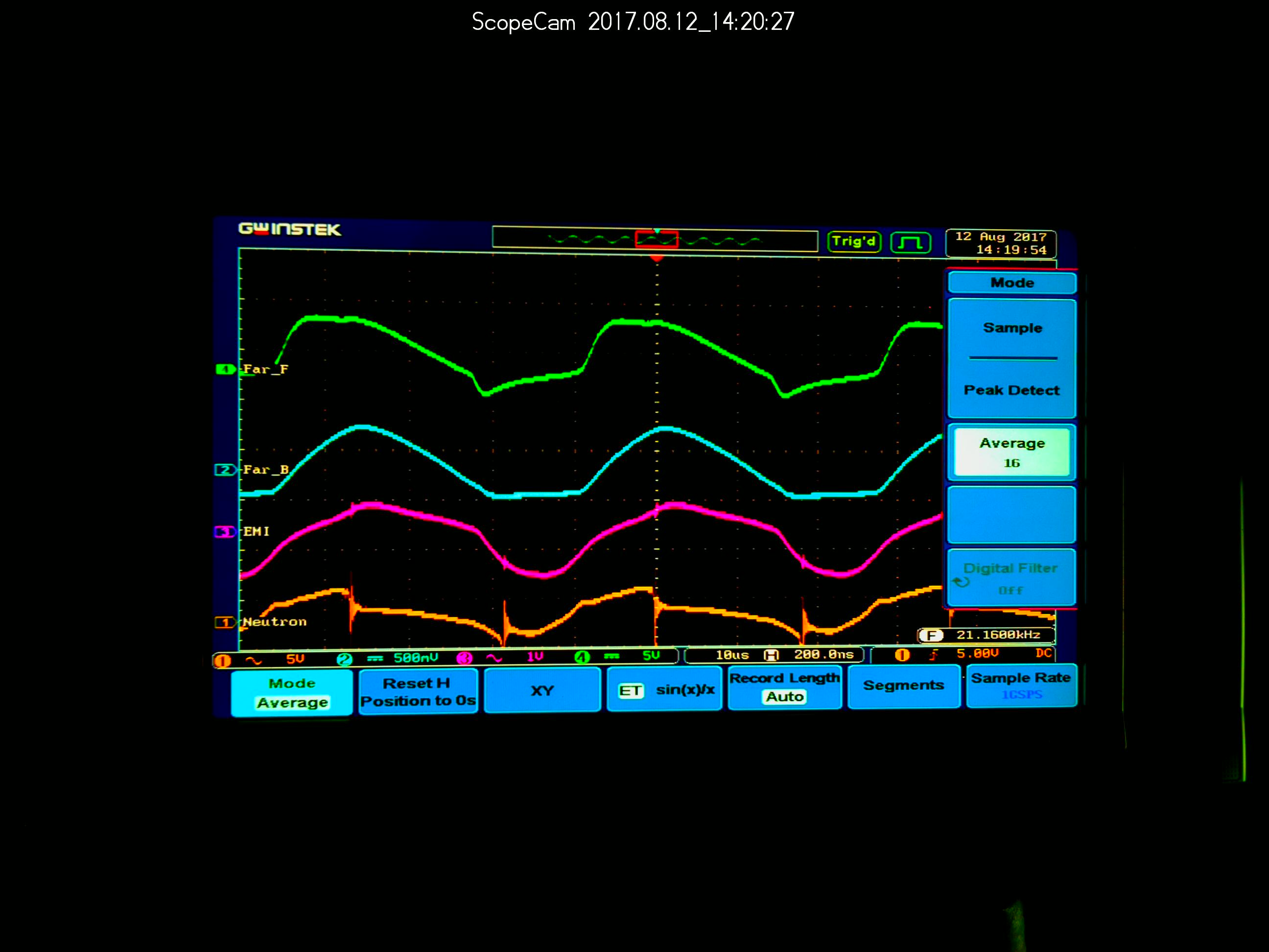

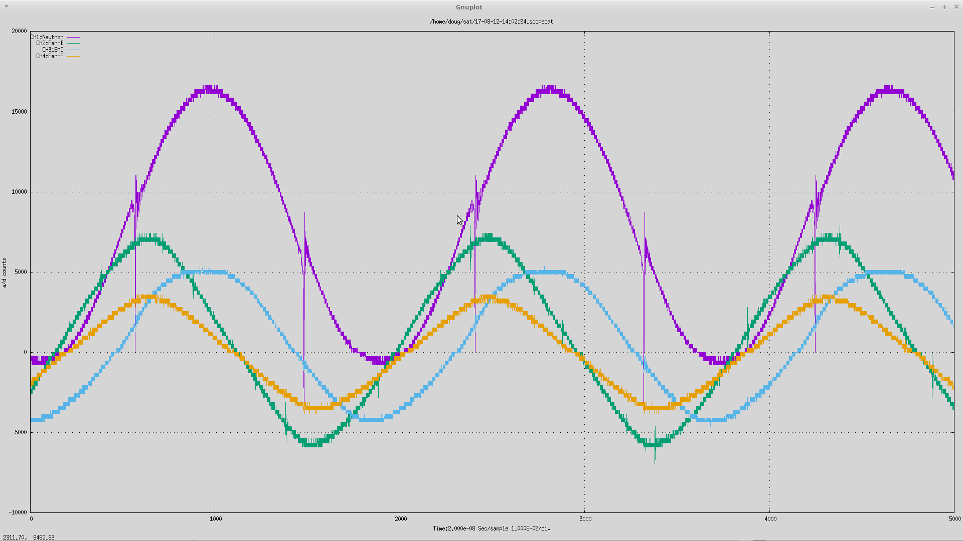

See "code" above for the key to these. Different stuff hooked to the scope for this...which is why I had to to the first post after moving some things.
The EMI channel is in it's usual place for this - it's picking up signal from the main grid. Power to that is off, but the power supply is connected, which makes it a fairly low impedance to ground, mostly resistive, so not much differentiation phase wise.

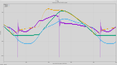

Here's the plot from raw data of the same thing:
gnuplot of same
Which made sense at the time. But when that phase change documented in the first post happened, I didn't have a reference to the HV output...and didn't know its peak had shifted to close to the zero crossing of the drive instead of the usual peak...so nothing made sense, and I had to back up (more next post).
The two faraday probes ARE phase shifted due to differentiation in this - just about the full 90 degrees. But that changes when there's actual ion current. That, and the fact that the relative phase of the ion AC output vs input changing at the same time, well, kinda confused me, the data didn't make any sense to any interpretation till I went back and did the first two posts here...life's like that sometimes.

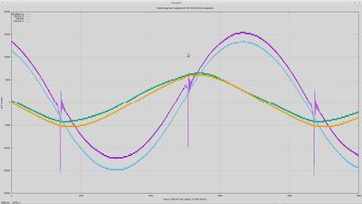

Gnuplot of the raw stuff:
Plot. Note distortion on sines from ion loading

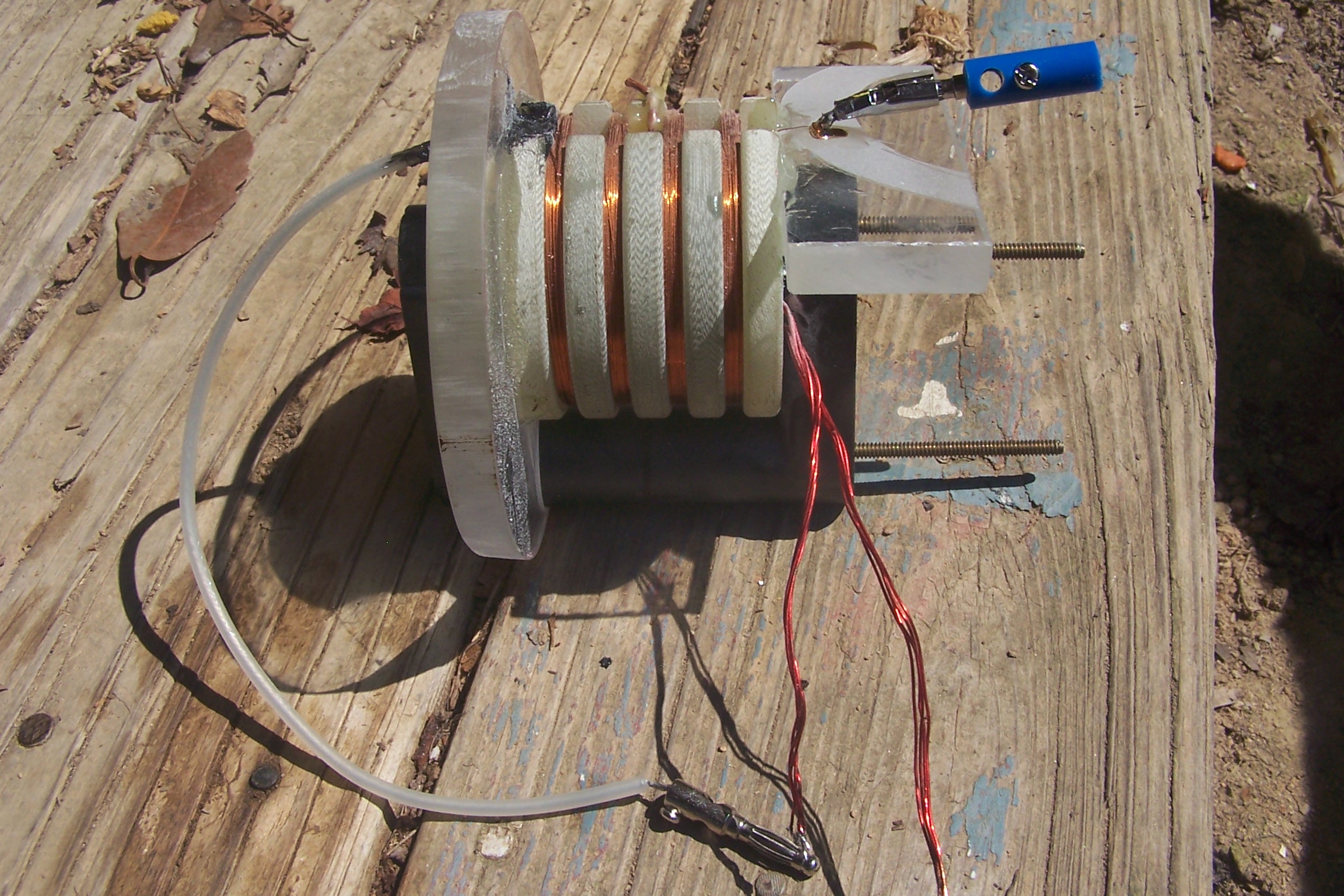

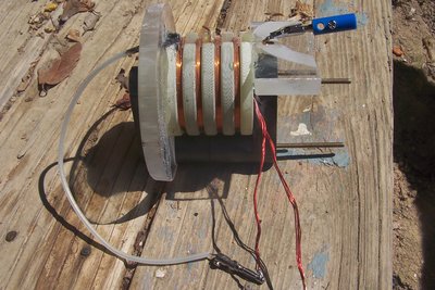

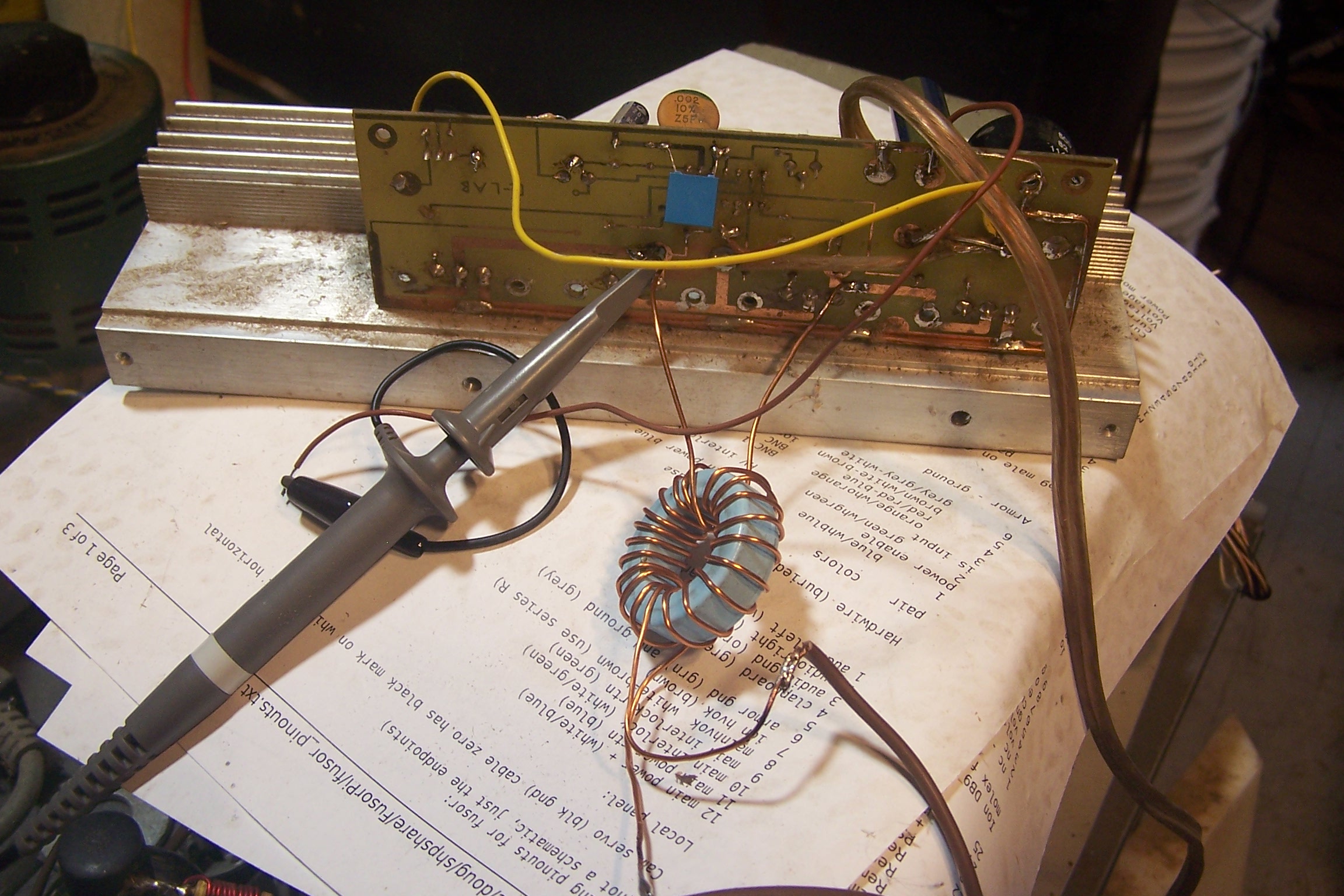

I'm using a really nice little HV stepup transformer, coils found by Bill, I didn't wind these or make the forms - and these are indeed nice and have a pretty high self resonant frequency given the stepup.
I happened to have the core from some old (large) computer switcher (not a PC!).
Because we're making over 20kv pk-pk, there were corona and arc problems. So, prying off the original secondary terminals, gluing some old polycarbonate in the right places and so on solved most of that (we've not tested to extremes yet, but so far...). It looks like this. I'm using banana plugs for HV which sounds dumb but where they are their "pointiness" doesn't result in issues with corona or arcing and it makes things easier to fool around with.
Here's the step up transformer
This thing did NOT like the square wave put out by one of my old H bridge switchers (pictured later) so I tried using a series L and running it somewhat above self-resonance. In fact, I happened on a combo that is "net" in resonance at 27khz (transformer alone was 21 khz) with a series choke. This all has the interesting property of drawing more power when unloaded than with a gas load and it lit off, I'm guessing due to core losses - the choke gets quite warm and maybe other things I wouldn't put my hand on in operation. I used the same core to make a choke for each lead since it's an H bridge drive, they can share things if the phases are right (they are). But in an ideal world I think I'd use a bigger core. The driver looks like this (run off a bench power supply right now).
The old H bridge design and series choke
This is run off a bench supply and at 20v input 9which is 40v pk pk output to the transformer nominal, more due to the series resonance) draws around 600 ma. Under gas load, lit off, it drops to around 350 ma..I have a probe on the square wave to trigger the scope for other stuff...under no load the output is more or less proportional to the input voltage.

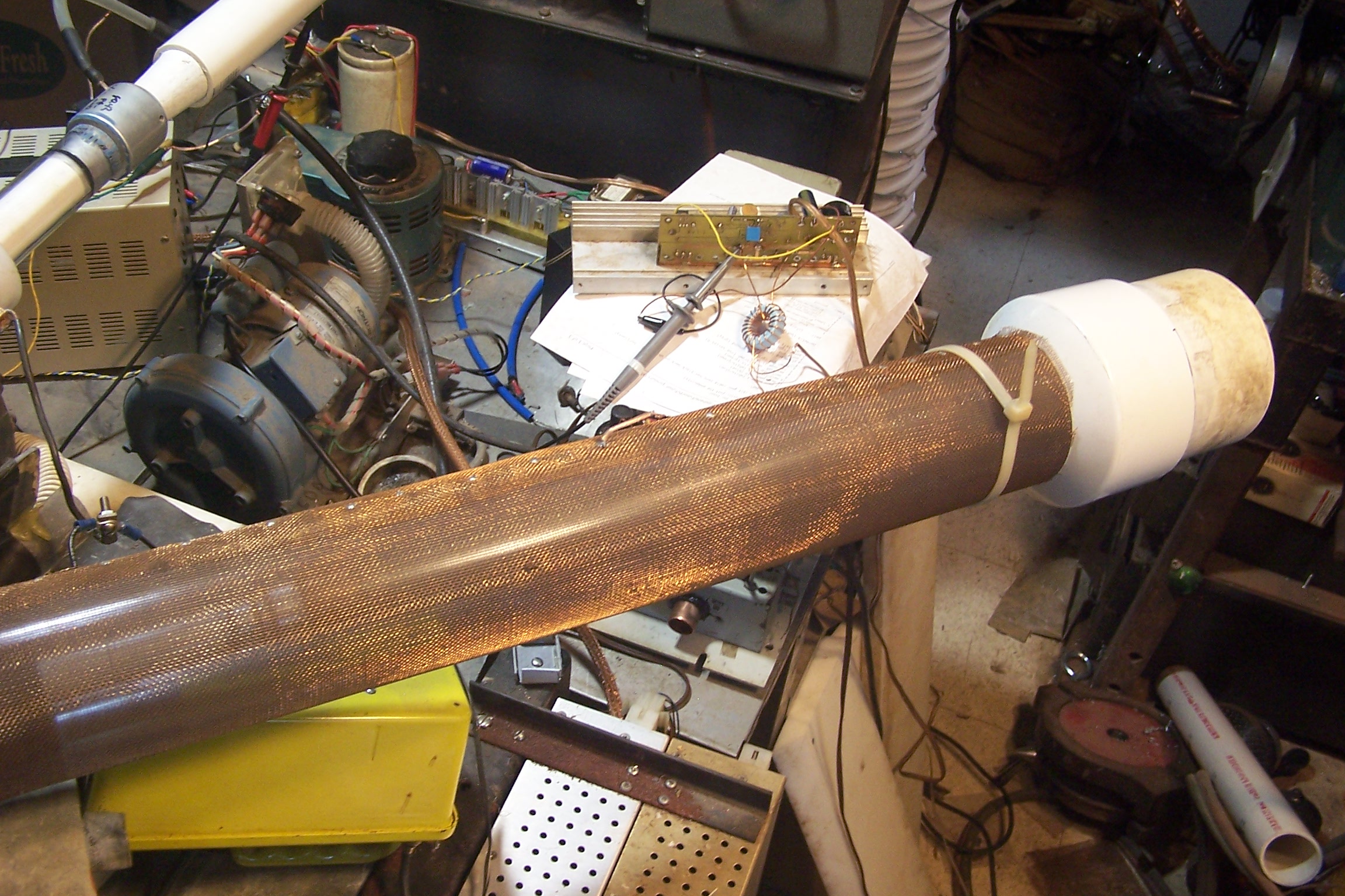

This is all lashed to the "ion grid" feedthrough part of the fusor apparatus. I'm using BN inside of pyrex here as well as for the main grid, but here we are using 1" pyrex so it won't take quite as much voltage (no issues so far, the main grid feedthrough is very overbuilt for current conditions). inside that nice (and expensive) cat 80 pvc under the brass screen is also a 50k 200w resistor for ballast, which I've not used in a long time. There is a bypass lead of glass insulated copper pipe to the end, so I can plug my HV into either direct or the series R. As time goes on, I might remove that resistor and shorten up the pipe. FWIW, this sched 80 PVC is really nice stuff, and is thick enough to thread for setscrews. It just fits over nominal 2.75" flanges and a couple screws will hold it on as you see just fine.
I use this on both grids, and in the case of the main grid, one could wind a primary coil for a linear transformer with the secondary on smaller pipe inside...with my 8" shielded PVC over all for safety and lower emi into the measuring gear.
Overview of ion grid stuff

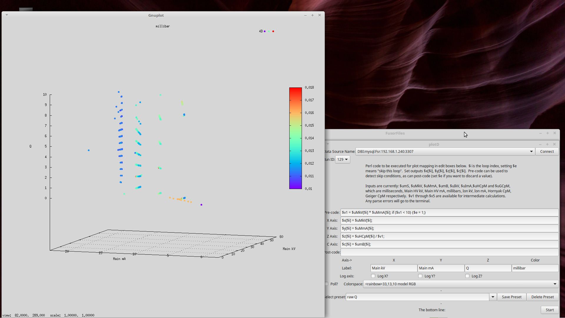

The meat of the biscuit. Good but not crazy-good.
Decent Q for our stable modes, not super fantastic, but a little better than usual. I didn't push the low limit of gas pressure, which seems to improve Q (and a lot of other things, like where the heat goes) on this run.

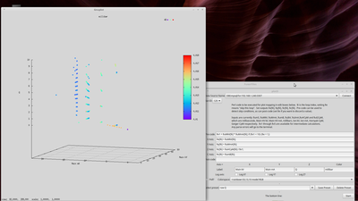

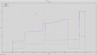

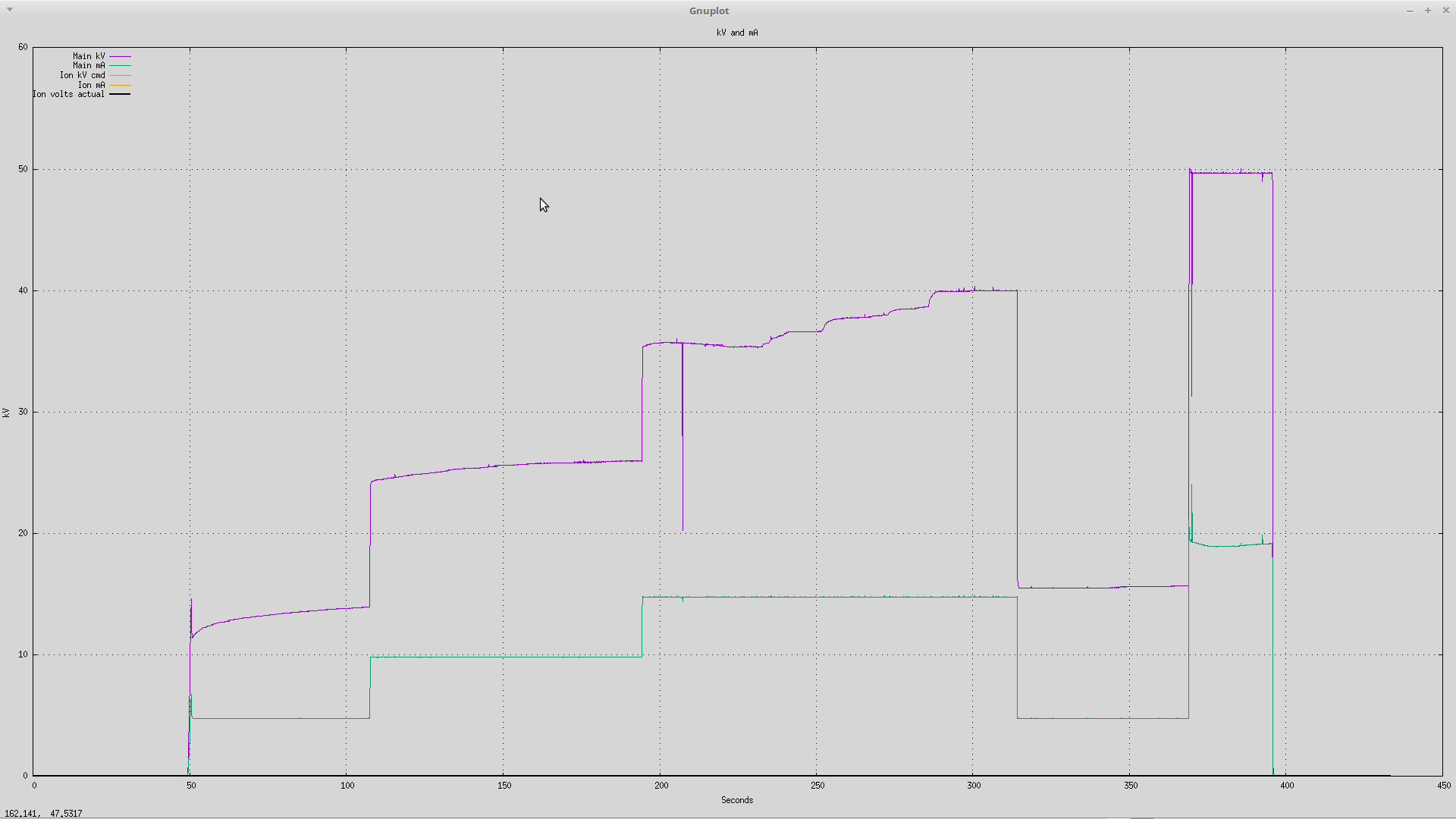

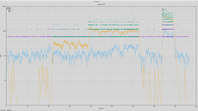

Here are the other plots from the database. This isn't all we get, just what we like to have plotted. We can do fancier things with that perl program that does the Q plot (such as insert code on a per sample and per axis basis - so we can make one "time" and the rest whatever, as well as make scatter plots with that one)
The power inputs. Our ion source is now negligible in watts...about 330 ma at 20v in to that.
I've made the main supply current limit remoteable, and was mainly testing that function, as well as "just how much is it gonna take to get to our usual 50kV?" We make it easy, and with less gas, we might make it even easier. Heat seems to move to the end of the grid far from the feedthrough with less gas too - and that end can take white heat continuously.

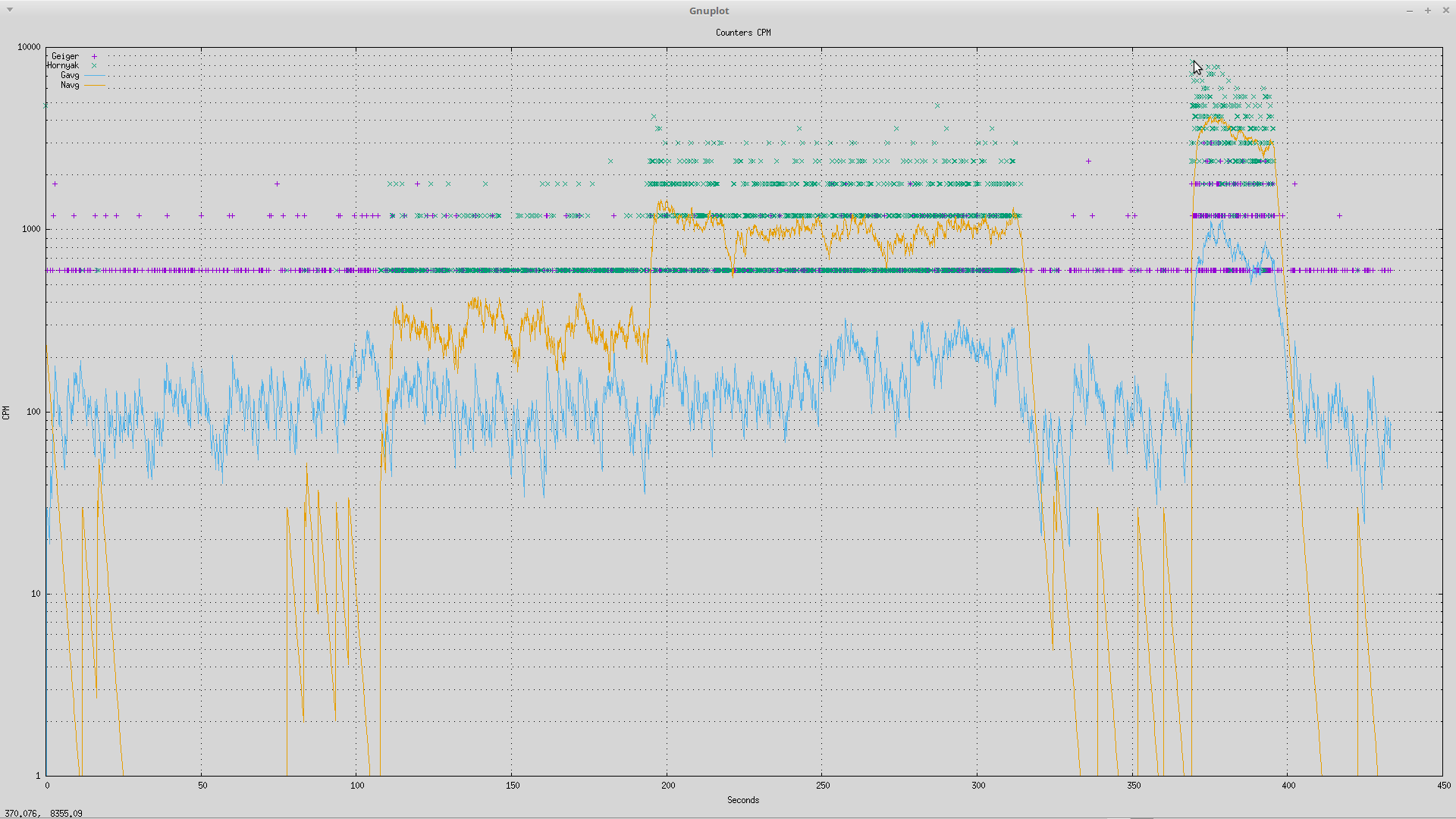

The radiation counters
So, mo power, mo radiation. Not a surprise. I didn't check activation as the other parameters were all over the place - on purpose, this wasn't "that kind of test".

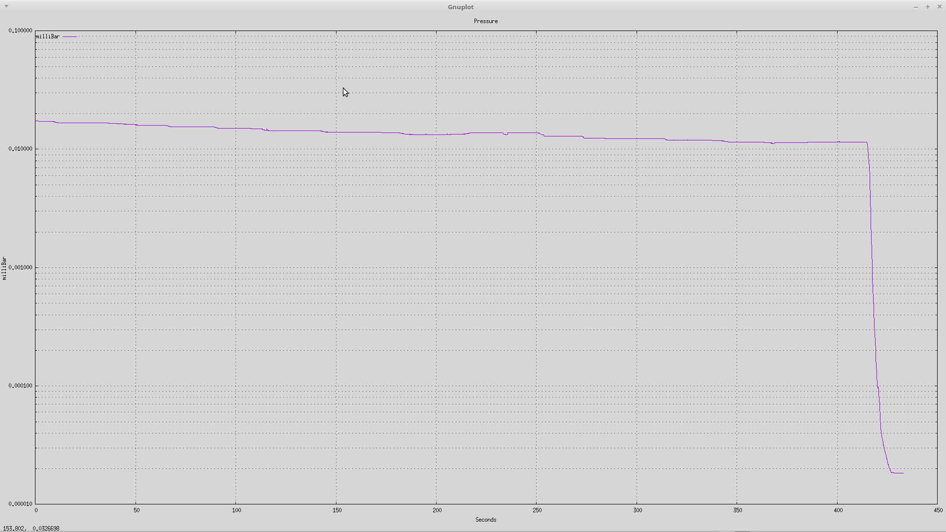

Lower than usual pressure - normally won't stay lit at less than about twice this (indicated)
This is maybe pretty significant on a couple levels. Being able to run lower pressure seems to make everything better. This new ion source makes ions so effectively and efficiently we can run half our usual minimum, and it looks like if I push it, we can go lower still - didn't even try this time. Also of significance is that we now have so many ions, it messes up the pressure gage - turning on the RF ion supply makes the gage read 20%+ higher than with it off...I guess it expects its own ion generator to be the only one around (and it IS behind some tight mesh grounded screen).
Remember, according to Pfeiffer it reads around 2x high on hydrogen anyway...
So, database move test is a success, variable main power current limit a success...maybe we can go more places and do more things now.
