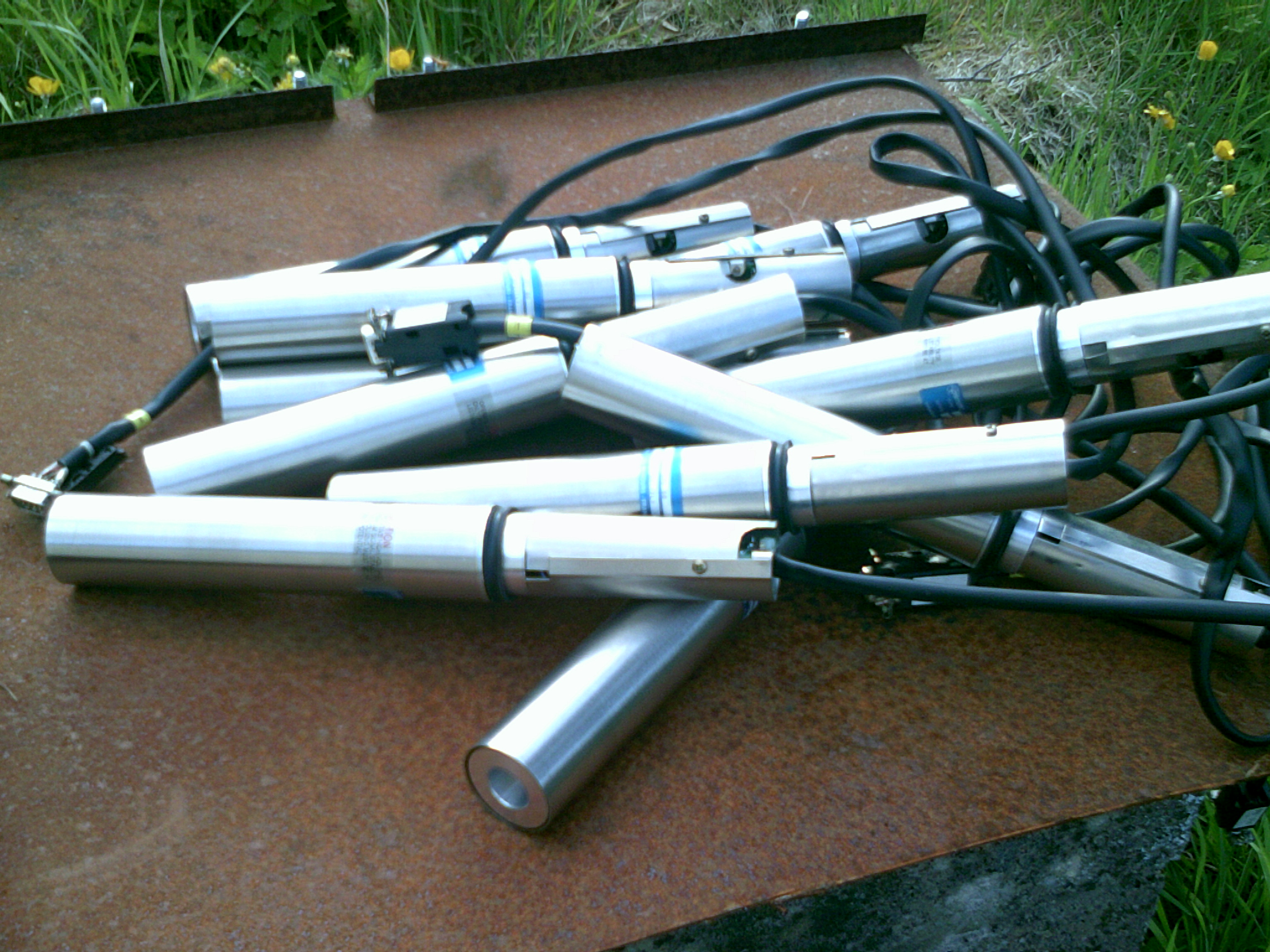

Does this constitute a ' gaggle ' of PMT's? :
They have an integrated pre-amp and a well Nal crystal
Starfire
