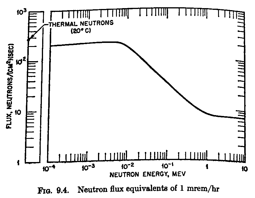

Does this answer your question? (from "Nuclear Reactor Engineering", Glasstone/Sesonske, 1967):

Yes, that helps a lot, as I have some rem to other conversions (perhaps we should collect all of them here).
I processed the chart a little further so it's easier to read... a flat scan would be better of course (but I know it's a pain, because I do it here a lot).

But bottom line [literally!] is that according to this, and text, it looks like fusion neutrons are worth;
___1mrem/hr = 6neuts/cm^2/s
and max continuous rate for a 40hr/week industry worker is 2.5mrems/hr.
So 15neuts/cm^2/s is the max continuous rating which is 1Mneut/s at a distance of 72 cm.

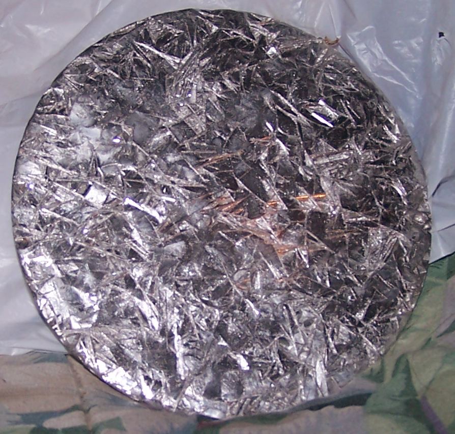

I can buy it fairly cheap (rotometals) but....not fun to work with -- very poisonous and tends to catch fire in the casting melt with resulting fumes one breath of which is fatal. I sorta solved that by making alloys of it that dissolve the Cd at lower temperatures, but when they cool they tend to segregate, so you can't use them thin, or you risk holes in the coverage. Very pretty, but not that useful. The piece pictured is about 5" diameter and about 1" thick. It's very brittle in this form, so you couldn't cast or pound it into sheets and form it around things.
Semi eutectic CD alloy
I used some alloy design from the Rare Metals Handbook here (though at the moment I forget which). This has Bi, Tin, Lead as well as about 40% Cd. The thing is the crystals are so large it has to be used pretty thick or you've got holes in the actual Cd part of it. Or in other words, it's only a solution when molten.

Did you try using chills (large heatsink) when that was cast? It might help with the grain size somewhat (faster cooling/less time to segregate and form large crystals), but at that size it's probably tough to get a reasonable grain size anyway.

Yes, I did try a little quicker cooling, attempting to get to say, 1/4" thick without voids -- failed but it looked better than the picture which was just natural cooling in a parts tray. It helps but my method wasn't so good. I suppose I would have to make more of a custom mold to pull that off well, so I could dunk the whole mess into a bucket of water or similar. Can't start with a cold mold for thin things -- it hardens and stops the flow into the rest. This is weird stuff to cast -- it gives off a lot of heat of solidification right at that temperature, and expands some, sticking to the mold, it wets everything all too well. To even get it out of the parts tray (which has a lot of "draw") I had to use silicone mold release. A flat bottom Al pan means casting in a pull-out bolt or similar or the only way to get it out is to break it. The stuff isn't terribly heat conductive (or more correctly, has a big ratio of thermal mass to conductivity) so even if you chill the outer part the inner part takes its time cooling.
