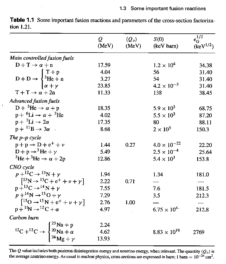

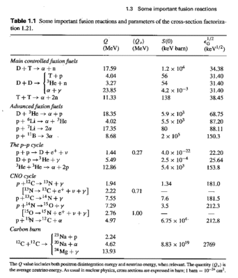

Right -- it would take around a megavolt of "pressure" to actually push two D'+s together against Coulomb forces, we are getting some fusion via quantum tunneling at voltages as low as 20kv, but of course it goes up fast with input energy -- all the way till the point where you get no net gain and beyond (no low energy cross section sharp resonance in this one, as there is in DT).
Some data of fusion reactions
This is from an astrophysics book, and assumes a thermal situation -- everything random -- but S(o) is a sort of measure of cross section probabilities.
I think thermal is :
A. Not the way to go, too much random loss and so on, and
B. Already being done as well as it's going to be by the tokomak boys, or perhaps the DPF guys.
C. Leaves electrons in the mix, and they are notorious for radiating loss energy as photons.
