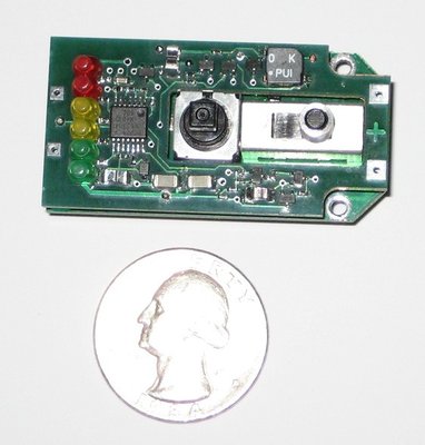

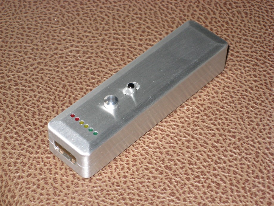

Since the topic of little rad detectors has come up again, I figured that I should post some pictures of the one that I made a few months ago (not to mention that Doug has requested it too), which is a little larger than a cigarette lighter. I loaned mine out and have been waiting to get it back so that I could get some better pictures, but for now I'll post what I have.
This is the circuit board minus the GM tube which is a Russian surplus unit. It runs on a single 3V 123A battery. A few things that make it different from some of the others that are similar is that it has a LED bar graph display with the first green LED flashing every count for low level stuff and the last red LED about half lit on the hottest torbernite rock that I have. There's a button for the power switch and a 3 position slide switch that changes from clicks/nothing/vibrate, a la pager motor.

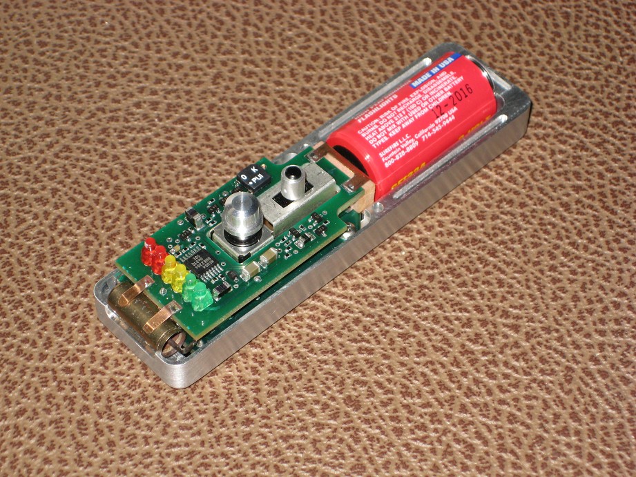

This is the unit with the cover off. The GM tube is in front and about 1/4" diameter by 5/8" long.
And the final product. It's 1" wide, 7/8" thick and 3-3/4" long.

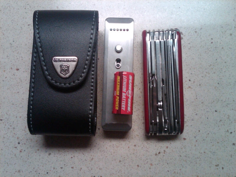

Hi, I think Joe is a little modest on his capabilities here. The counter started out as a rather large "micro" counter. Joe did a "Honey I shrunk the Kids" thing on it and made his own board and replaced everything with surface mount tech. You can tell it's pretty compact in the knife comparison photo. Joe made practically everything. I think he even made the screws. The body was made from a solid aluminum bar stock. It is a very handy item and has verified radioactive items in antique stores rather well. The Chinese have already copied this and I bought mine from a far east trading company. Joe, just kidding about the copy. -bill

Thanks for posting some more pictures Bill - it gives a nice size comparison. I initially built two of these and Bill has the second unit -- you're probably right about the first one being copied in China by now.

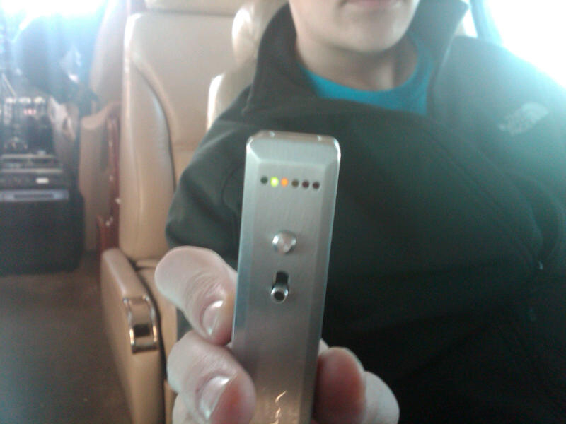

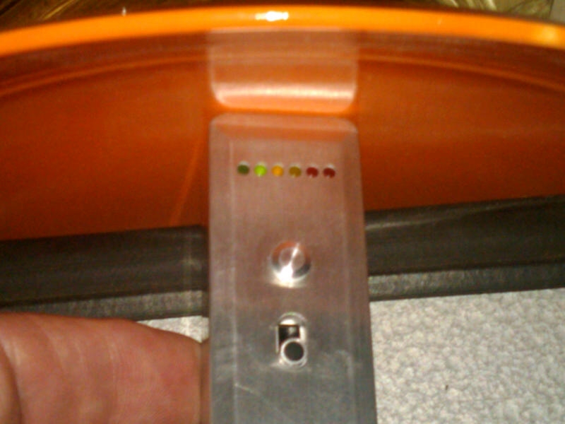

Hi, Joe Jarski special today 15:39 @ 16,400 feet asl. Actually got one more dot than this. Surprisingly strong for such a low altitude and small detector tube. I Suppose the TSA 470B (Henny Penny) would have gone crazy. Merry Christmas to all. -bill

Wow! That's a lot higher reading than I would've expected. You weren't flying in a fiestaware plane were you?
The readings look about the same.
Re: Mini GM detector
Hi, No, but I was about 10 miles from a nuclear fuel plant and 20 miles from that 10 Billion Dollar uranium deposit; although I don't think that would make any difference. -bill
Yes, but were you also zero inches from a hot source taped to the back? Bring that thing over next time, Bill - and lets see how it reacts to local sources and try to see how hot that really was (cross calibrate it)....that looks pretty hot from the time I saw that before - really took some stuff to get it going like that. Torbermite only got a couple more leds.
Hi, You know I wouldn’t knowingly fudge anything; heck I’m just happy when I get the results I’m supposed to get. I will calibrate it against a known (hot) source we both have ;(radium dial oil pressure gauge) and see what it says. Does make me wonder why it read so high though. Next flight I will take it and the Prm470B with me. Thought about taking the Ludlum and the Geo210, but I need a Geo 310 for that altitude.
