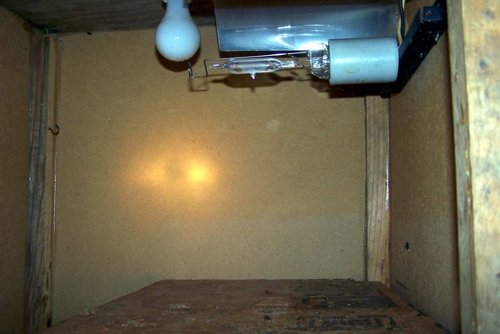

We are working with fairly new positive resist pre-sensitized board, available from a bunch of sources. The newer stuff says you can do it with a regular 100w bulb, but I use a rig I built by getting a 250W street-lamp kit (mercury vapor) and breaking off the outer envelope to get rid of the phosphors and UV block.

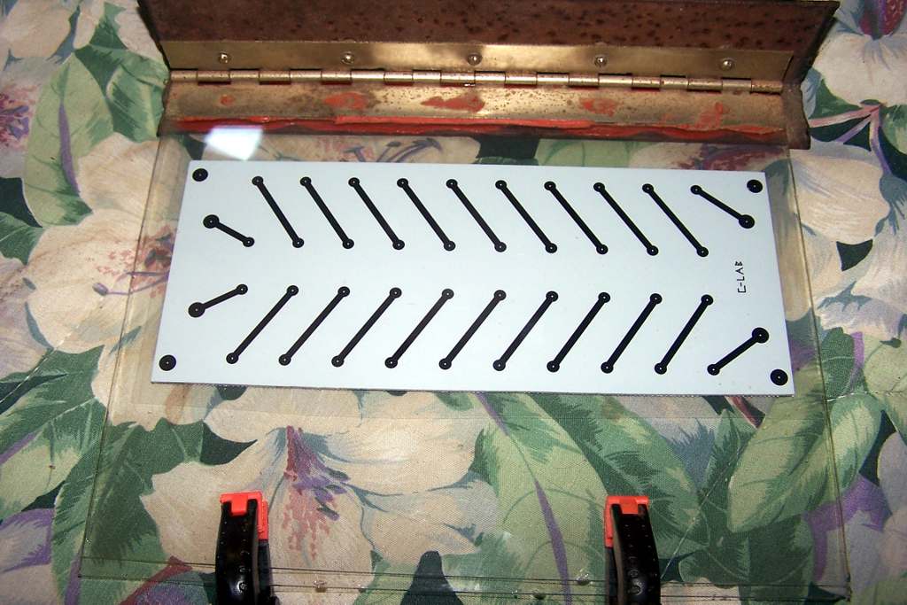

To just make sure everything is scaled right, I test the components against a paper printout, and make sure I cut the board to size correctly, using the real art and the print frame I built.

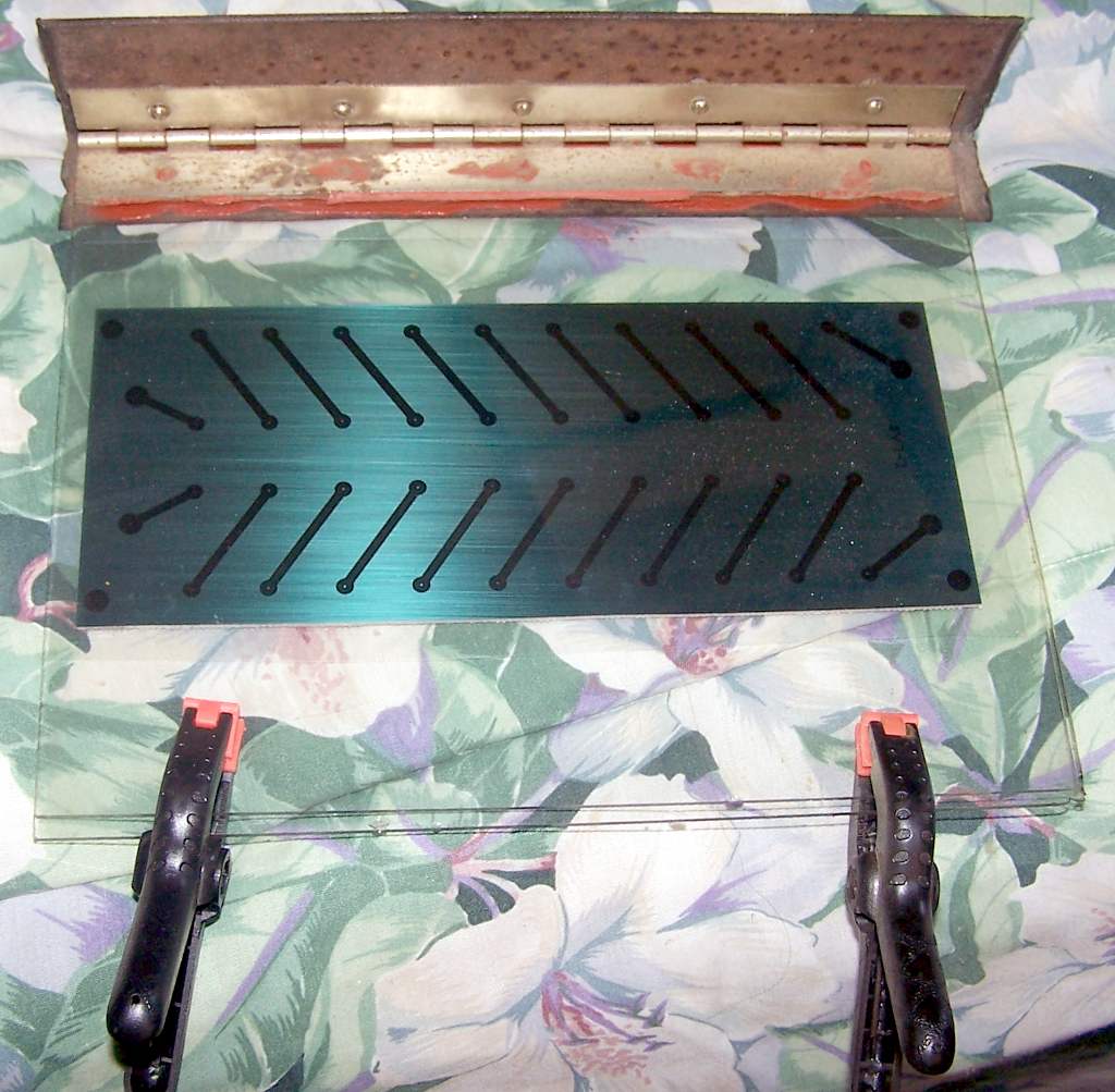

Printframe
A good contact print frame is essential. This one is made from thin glass (so it doesn't stop much UV) from the hardware store, and a piano hinge and silicone goop. The trick is setting it so when a 1/16" thick board is in there, the top is flat -- so I made the hinge height adjustable. You can see the board and art here, with the light protective film still on the board so you can take your time and fix anything that needs it at this point. Now it's time to fire up that exposure setup and let it warm up. Merc vapor lamps change output in both amount and spectrum for the first few minutes, so I let that happen while I put the real printing setup together. you want to do that well away from sunshine -- dim room light at most, as this stuff is hyper sensitive to sunlight (about 30 seconds exposes it on a bright day). So right after I have it all setup in there, I put something like a magazine over the print frame so I don't get overexposed from room light alone.
I used my general purpose environment chamber for this. You don't want all that short UV getting into your eyes much, so the door is nice, and it stays a little cleaner in there that way. This is just a big box I built that I can heat or cool the insides of, or make it real humid in there for rust blueing -- or just hanging freshly finished knife handles so dust doesn't get in the finish.
So, while that's warming up, we get the real exposure set up.

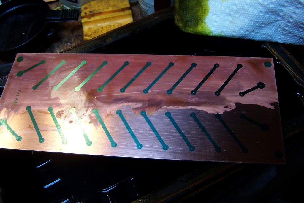

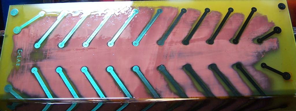

The blue-green is the photo sensitive resist.
Exposure time would be pretty non critical if everything else were right, but that's almost never the case. For this source I use 4.2 minutes in that rig. I wrote a little perl/Tk script for this computer that runs a set time and beeps me, like an egg timer. The photoresist is kind of proportional, so you can fudge things a bit in development by varying time, strength of developer, and so on. The developer for these is a 10% lye solution. Even if you think you've got an airtight jar, it will eventually turn to mostly sodium carbonate as it eats CO2 from the air, and that happened to me this run. The carbonate doesn't hurt it, it just doesn't develop, so I added more lye, and overdid it somewhat, causing problems you'll see later on.
As you can see, where it was exposed, the blue washes off faster than it does where it wasn't exposed -- as much. No laser artwork has black as perfectly black for one thing, and even a fresh board will develop if left in there long enough. I made a bad spot on this board you can't see yet when I poured in fresh lye right on it while in the "tank" which is a hambuger tray from the grocery store. So, don't do that. FWIW, that expensive developer they sell is just a saturated lye solution, not real pure lye even, that you dilute 10::1. It's a lot cheaper to just get a jug of lye and do that yourself...
Now we test if we developed it well enough, using etchant. You must wash the board off completely first, as the two chemicals don't like one another one bit, and make a precipitate, I use a windex jug with distilled water and a paper towel (but be gentle, the resist film is real fragile and easy to scratch).

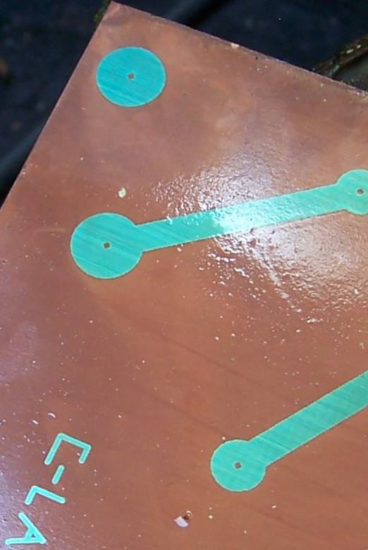

By just wiping a bit of Ferric Chloride etchant on there with a paper towel, you can see if there are any flaws, and now is the easiest time to fix them. There can be resist so thin you can't normally see it that will still hinder even etching, and this shows it up really well. Most other etchants don't do this so well, and if you don't like Ferric Chloride (because you have some brains and are tired of having it permanently stain all it touches), you'd still keep a little for this step.
As is normal, there were a couple of flaws, which you fix now. Either scrape a bit with an Xacto knife, or add a little dot of sharpie, depending on which way the fix needs to be.
Can you see the flaw here? Actually there were several, which I fixed. There was also some eat through (that dumb move of pouring in a little pure lye right on the board), which I didn't fix because a: I didn't see it, and B: for this I don't care much, it's different with smd and 8 mil tracks, here they are fat more for corona reasons than any other, and I plan to solder coat them anyway.

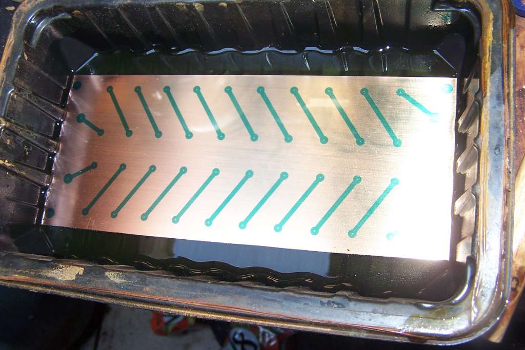

Continuing on, we are going to etch the board now. I'm using cheap Ferric Chloride I got in solid form from Marlin P. Jones. Ammonium persulphate etc are friendlier when you have them.
When they say add the Ferric Chloride to water slowly, they aren't kidding around. It may take up to an hour to do for a full batch without making the solution boil violently, and this is not stuff you want hot and splattering around. It's almost like adding pure sulphuric to water, extremely exothermic. It doesn't seem to go bad in storage, and I use 2 liter soda pop plastic bottles to store it in. When fresh, it's pure brown, it gets some green/brown in use which lets you know it's not going to last that much longer. Adding a spoon or two of HCl helps it last a little longer, if you can hack the fumes from that (you don't use much!).

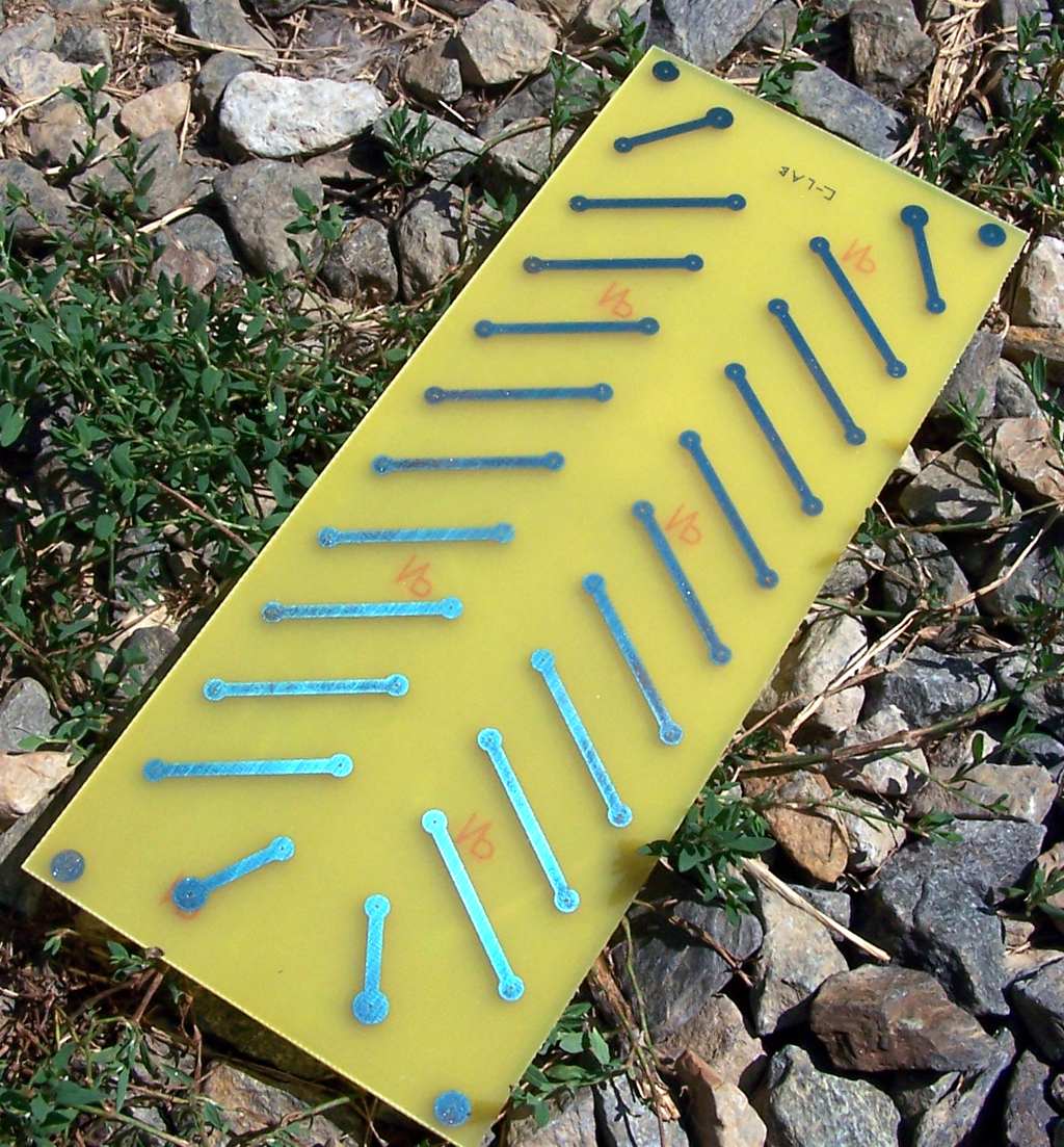

I used the same hamburger tray, washing it out well between the chemicals. I don't usually do boards this big, so I only snatched one out of the garbage for this. I wanted to show this partly etched board to point some things out. Spent etchant collects where there's a lot of exposed copper, and etching stops, even though I was rocking the tub back and forth as hard as I could without the etchant coming out. I have tried other ways, from sprayers to air agitated baths in specially made thin (but wide and tall) tanks, and they do work better if the setup hassle is worth it and you don't mind the amount of this evil stuff they put into the air. This effect is also true in developing, and a very gentle brushing with a fine brush helps that go better. You will note that the etching is fastest near the edges and near the places where the resist is due to this effect, and with thin lines you have to worry about undercutting a little bit. The etchant works better the hotter it is, but to be around it, you don't want it too hot. I heat it up to about "making tea" temperature in the microwave first.

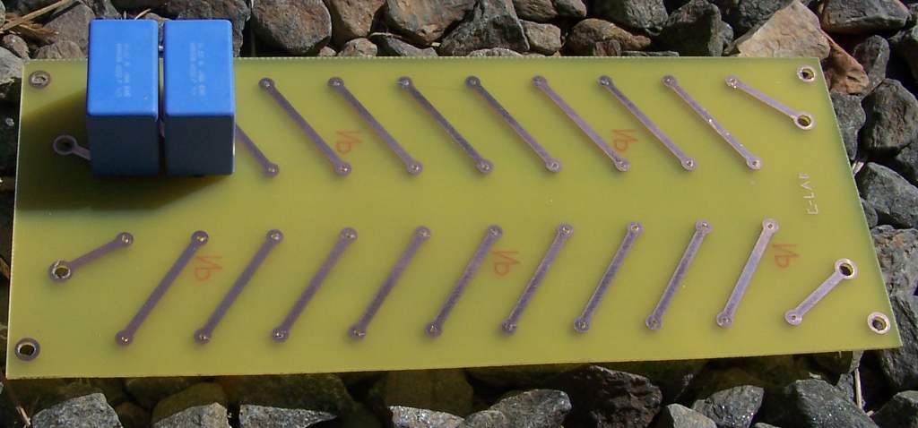

Here it is all nicely etched. A little too much, some of the tracks got pinholes. No sweat on this one, as I'm going to coat the tracks with solder to make a radius that cuts corona down anyway.
You can solder right through that resist, but I generally clean it off with acetone just before soldering, which gives a nice pristine surface (at least until you touch it with your hands) that solders easiest.

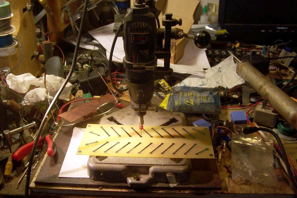

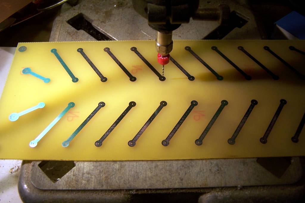

Now it's time to drill the board, with the setup below. This works better than it looks, especially since I left guide holes in the pad artwork to guide the drill tip.
Note I have the quill lever set so it's about horizontal, and in use I grab it between two fingers and it takes almost no motion or effort for each hole. I use light, light, more light, and magnifying goggles and watch for parallax while the drill is real close to where I think I want the hole. With a little practice, this goes pretty fast, but of course if you had one of Jerry's CNC machines, you'd do it with that instead.
Obviously, you want to use a drill a little bigger than the component leads here. I mic'd them at 31 mils, and the next larger size solid carbide drill I had in the box I didn't have to search for was 46 mils -- fine for this. If the collet on your Dremel tends to grab like mine, don't put the drill in full depth -- the collet frees easy when you're done if you loosen the nut and then push the drill in -- then pull it out. There has to be some "in" left for the trick to work. Having to pull hard "out" means you break these drills too easily.
Once you've drilled the board, make sure the parts fit. Here it is when them upside down to show that. What I actually did was drill for just one first, in case I was going to have to fudge things because I didn't get the art just so. It happens.
Now for the easy and fun parts, stuffing and soldering.

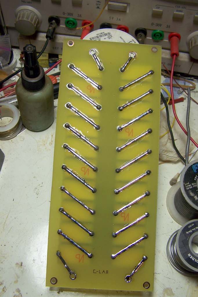

No need to use the fancy Metcal on this job, the old standby Weller station does fine, and has variable temperature, which I am going to take advantage of here.
I am using real good solder for the pads, and then I'm going to go back over it all with plumbing solder at 100f higher tip temperature -- it's cheaper and it blobs better.
Here's the result.

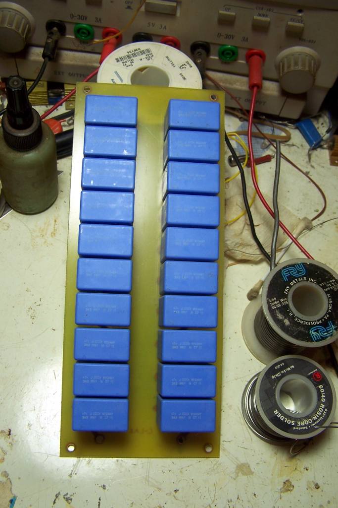

Now, since I'll be pushing the creep insulation strength of the pcb with 20kv peak between the cap stacks, I'll paint it with glyptal before use. Wait for it:
Here's the family Joules ;)
