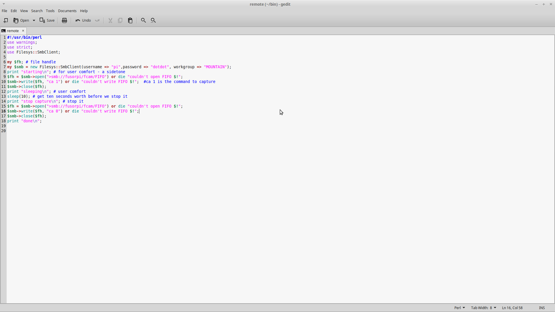

Here is example code in perl to do one of them - record for 10 seconds, which can run from some other machine on your LAN.

This does look quite a bit better when it's syntax-highlighted in say, gedit. Don't leave home without syntax highlighting!
Syntax highlighted. Make more sense now?
