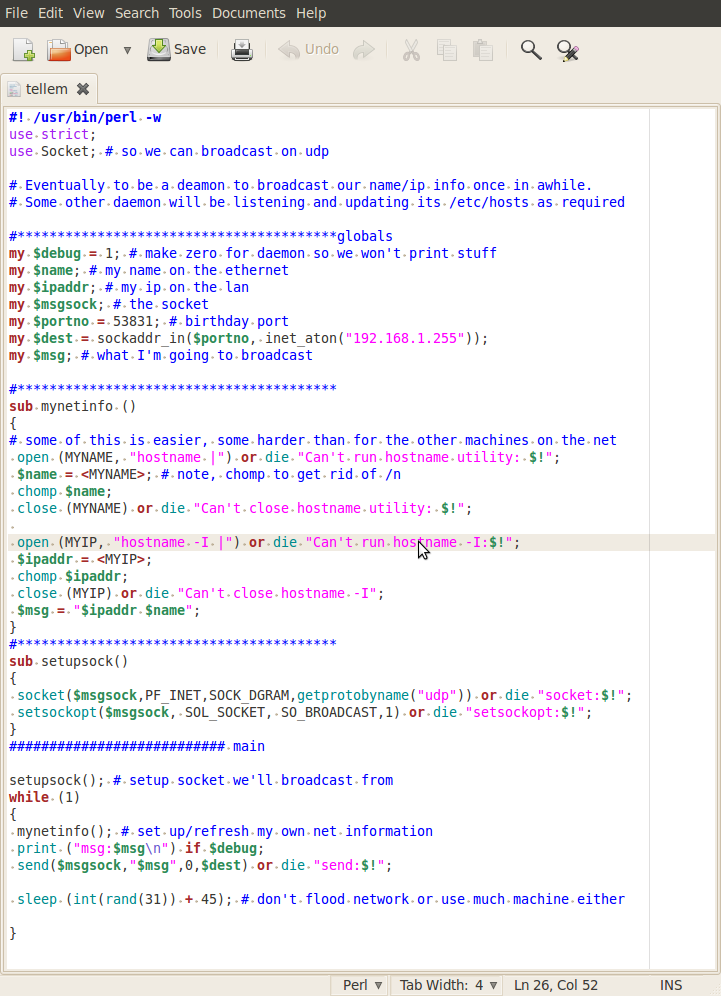

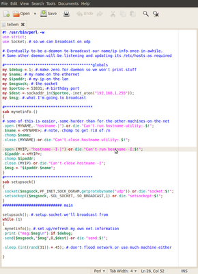

For example, here's one of them in gedit.
What code should look like - linux's version of notepad, but with actual features like color syntax highlighting for a dozen languages.

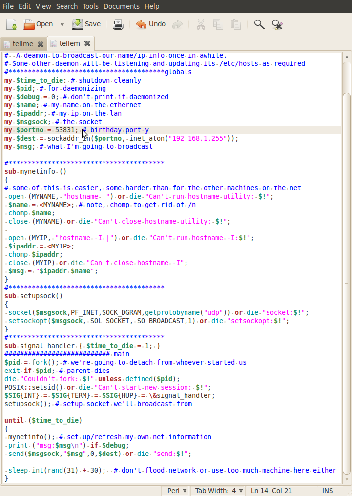

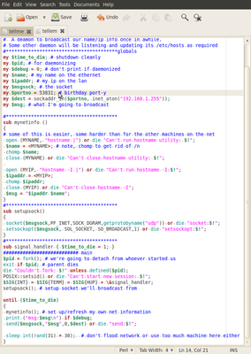

But I ran into an edge-case that's kind of interesting, and in my case, important to handle, which is the next job. The way I get my own IP address is essentially to run hostname -I. Well, on a host with more than one ethernet adapter (the fusion machine has 3!) it returns all three. In my case that's one for the wired ethernet (essential when xferring large files, but usually unplugged when HV is around to avoid frying other things on the net), then wireless (slow - 10 megabit, but fine for data xfer during a run, and safe), and another wired one that usually doesn't have an IP at all, but when it does, it's from windows running in Virtual Box and talking to my mass spectrometer on a completely different network space than my usual 192.168.1.x, and the hostname program potentially returns all 3 IP addresses. Oops. /etc/hosts doesn't handle that one well at all.
There are workarounds of course, but they are messy and complex and not as deterministic as I'd like - you can only have one IP on a line, but you can have more than one line with the same host name for example, but that merely wastes space and it still just pulls the first name match anyway when resolving.
Going with the philosophy "be strict in what you emit, and loose in what you'll accept", the first place that needs work is the tellme program, so it can pick just one, and hopefully the right single IP to send. If I get multiples, I guess I will take the first one that starts with 192.168 and ditch the rest before sending.
Another caveat is I forgot to close STDIN, STDOUT, STDERR on my daemon. It works anyway, since I disable printing etc, but I should go ahead and make that change too just to be "clean" and "set a good example" so I will. But, so far, so good, and it now looks like this:
Doesn't quite fit on one screen anymore...
