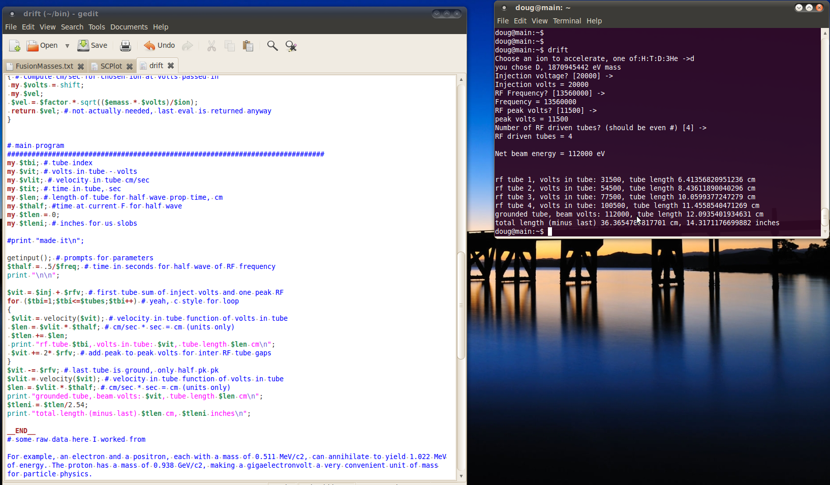

While watching markets (ugh) today, I wrote up a little perl script to calculate the lengths of the tubes for a drift tube accelerator. This is a little rough, and makes some assumptions, but gets to the right (hand checked, ugh) numbers. It is assumed that you are putting in ions at some DC injection voltage, which you can specify; the program has defaults I've set for about what I think I want for the first go. It's assumed that the first tube, the output of the ion source, is at ground, followed by some even number of tubes driven out of phase with RF, followed by a final grounded tube. The voltage after the first gap is thus ion source volts + RF peak volts, the next gap gains 2 times RF peak volts (one tube at + peak while the next is at - peak volts), and so forth till the last gap only gets one more RF peak volts as it's ground, not the opposite phase. The length of the first tube is really the length from it's front face to the middle of the gap to the next tube, and after that the lengths are middle-gap to middle gap (the actual metal tubes will therefore be the number output minus one gap length, which will be short for all but the first, focus, gap. So, it's a little rough, what I like to call research grade code -- because the point of writing it is to get the answer, once, not for it to be pretty and long maintained "production" code which hews to a higher standard (unless you work for Adobe or Microsoft).
Here's what a run looks like for the defaults, and assuming I'm accelerating D.
Screen shot of run

So, I have to munge the gap corrections to the lengths by hand (and maybe I'll be virutously lazy and do the conversion to good English (oops, now only American) inches throughout to make that a little easier, but this is the basics. I tried to use the latest numbers from Terman for the factor, and from Wikipedia for the masses, and I subtracted one electron mass from the atomic weight of the ion involved.
