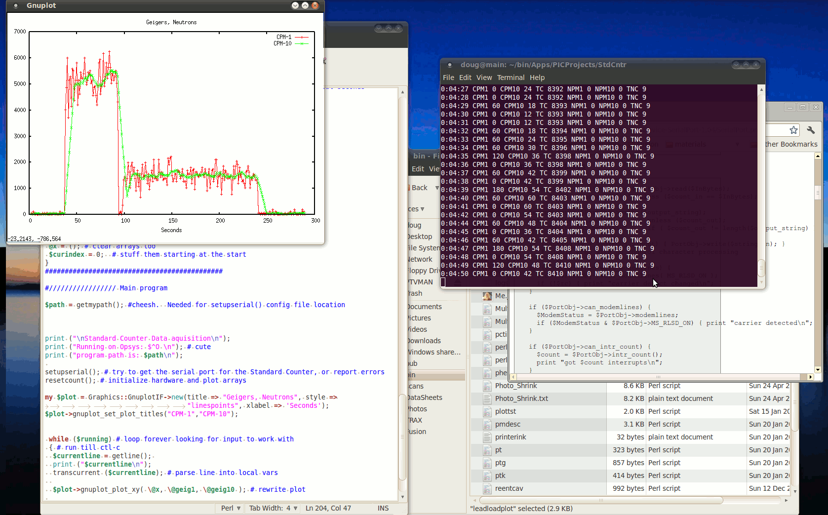

Is coming along, for linux first, then windows if there's demand for it from people who don't mind installing perl, cygwin, gnuplot etc on windows. Right now, I'm just doing the basics of getting the Standard Counter discovered (out of all possible USB devices) automatically, set up, and data brought to the PC for a rather simple plot (at the moment). I will be adding a GUI to handle things like what to log in a logfile, plot scalings, and optional things to plot, like smoothed data, the aux input for neutron counters, and so on. Lots yet to do, but this is what things look like now.
Screenshot of StdCtr.pl program running, raw data on STDOUT, plot via GnuPlot
This shows background, a lamp mantle, then a CS-137 spark gap, then background again. This just starts plotting at time zero and compresses the X axis as required during a long count. Obviously there should be some other options, but I'm just getting the functionality chunked right now.
I'll add log scaling for the Y axis and some other stuff of course. From here, it's quite trivial to also shove this into log files (named by time etc) or a SQL database, though the database would have to be created with a known table definition and so forth first (so other programs can all be putting stuff in the same database, different tables, all timestamped together and all that happy crap).

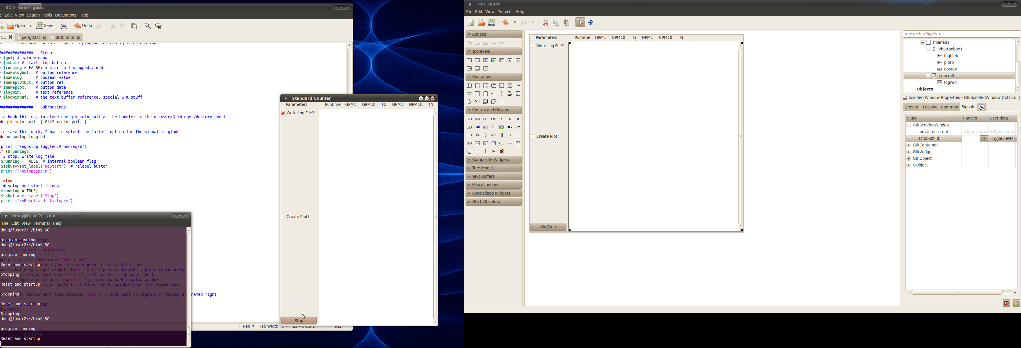

Making a little progress on this on the weekend. As promised, I'm doing a GUI for the program shown before. I'm doing this as a separate thing, as I'm having to kinda learn GTK2, Glade, and well, isn't that enough? The gui is coming along fine so far, but this is like creating the universe in a sense. It's not taking much code at all -- all you have to do is specify the properties of the universe so it works out, stars from, life appears and evolves and so on - might be as simple as choosing the right Calibu-Yau space for the string theory, or saying "let there be light" as in "let there be a space where Maxwell's equations are true" but boy, the homework is killer....
There's a fairly cool advantage here. Perl doesn't natively know how to "yield" to the opsys when it's in a forever loop polling the serial input (with time resolution better than a second). This isn't normally much of a problem, but it makes for nasty looking plots on the system resources, since Linux is cool enough to let you eat an entire core or thread doing that until things get busy, and it makes the program look like a real hog. With GTK and its pals, I can schedule polling for say 1/4 second intervals, and have the serial input code just do nothing if there's nothing to do right then (no complete lines), and that suspends the entire process until either the next tick, or someone clicks on it. For the moment, I'm also using STDIO on the terminal to emit debug and "I got here" type messages as I debug the code. Once you learn this, it doesn't seem so hard, but it's definitely another world from using DevStudio on Windows if you were used to that (and I was, more than a little). Neither worse nor better, maybe better -- I like the events auto-magically getting hooked up, and can tolerate the way Glade works to design a UI, so far. But the learning curve is quite steep -- Glade doesn't do it all for you and create the routines that happen on events. The old version did that, but generated code that changed everytime you edited the UI stuff, which wiped out any event-specific code you'd added, yuck. Devstudio would orphan code in that case, which would cause a different type of problem later...toss a coin, this is going to work in the end, and work well. This code should also play in Windows too, the way I'm writing it so far, with zero changes needed and not even a re compile -- take that, DevStudio :oops:
Here's what it looks like so far. The window on the right is going to get the output of the standard counter (like a terminal program or text editor), the left pane will fill with option check and radio buttons etc, and the gnu plot window will be elsewhere on the screen - its own process, which BTW is a good way to make things easy on the machine, we just let the opsys decide who gets cycles when. In a real situaion, there might after all be several other programs running for logging, and we might even add database connection to this one to shove this into a DB instead of "just a log file". Which also implies that at some point, I'll need to add a feature to put gnuplot on any of these logfiles, which will be simply named as something like StdCYYYY_MM_DD_HH_MM_SS.log so you don't have to type names and they'll be sortable easily.

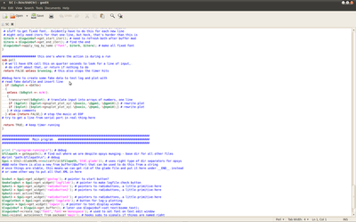

Edit: here's what the gui code looks like. Not usable as is (doesn't do much) but establishes a simple framework and "how to get rolling with this junk" kind of boilerplate.

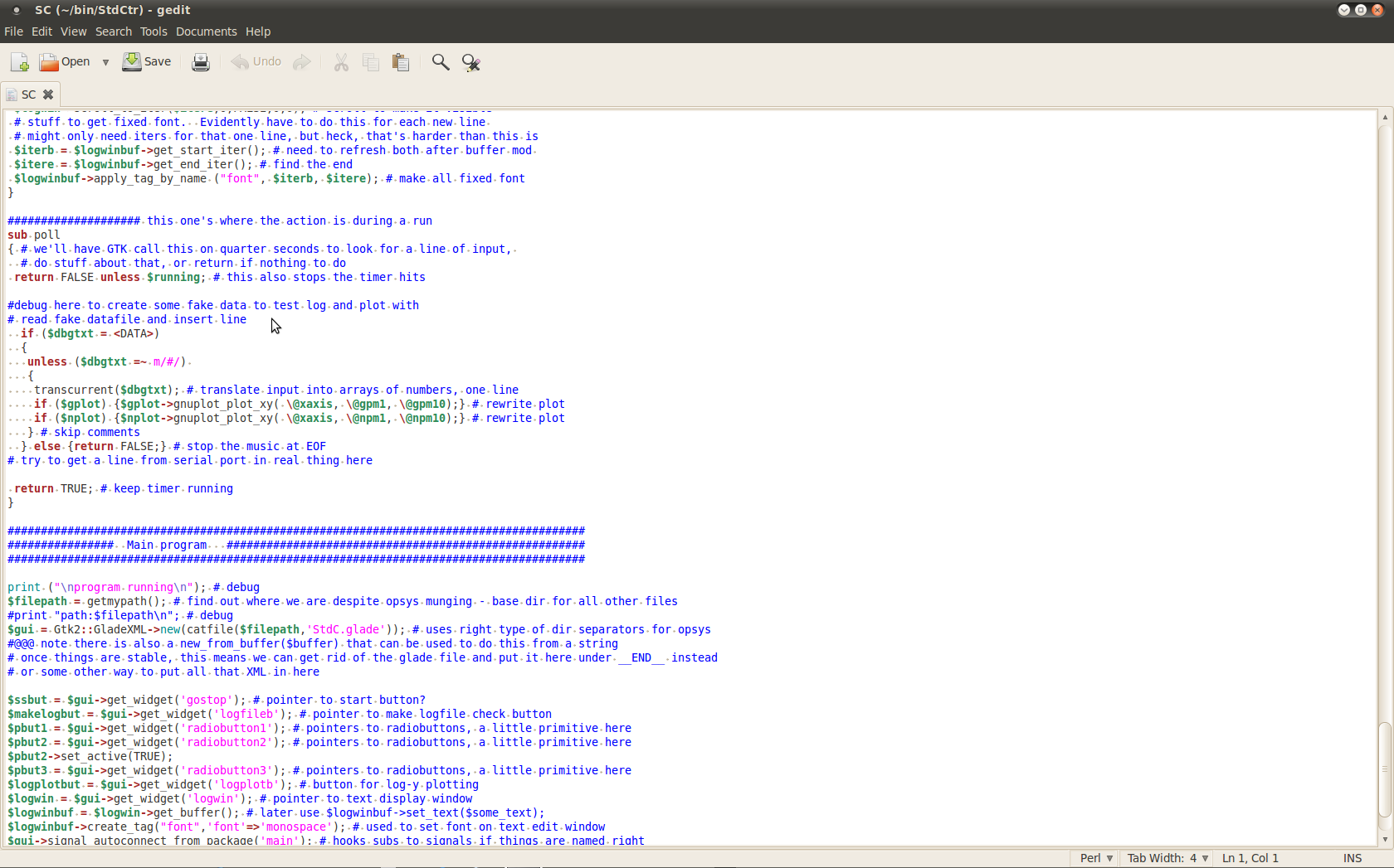

Anyone who wants to look this code over, a syntax highlighting editor is the tool of choice. Perl looks like gibberish enough even with that. Gedit, Padre, Geany all are free in linux, there might be some free option on one of the latter for windows, dunno -- I run perl there, but don't write it there.
Edit: I forgot to add the .glade file to this upload, and since I feel like this is useful for backup and example as is, here is that file too. It describes the UI for the project. I don't see or edit this, I use Glade to edit it graphically. If it's like most XML, you'd go blind reading it anyway. note that in general I have to rename all these with a .txt extension or the board won't allow them to upload. That's because some might be evil code that would hurt users. So any of these might need a name change to be used.

Ok, SC now has the more or less final GUI, and is now useful as a template for "doing this kind of thing" so I'm backing it up here. It will now write a log file if requested, for now of fake data we created for testing before I add the USB/serial stuff -- so it's wide open to "put your code here". I'll add the gnuplot stuff next (also will test with fake data) and do the actual serial stuff last. This is just the order I'm doing this all in to make it into a bunch of simple tasks that can be well tested at each step. I find this works well with the way I think, and results in code I can trust. If you can trust all the pieces, and some weird bug pops up, you can avoid having to re-test them all in frustration, because you already did and know they work right, piece by piece.
Someone once said "If architects built buildings like most programmers write code, the first woodpecker to come along would destroy civilization". It's not far off. So I used lots of tiny, unit tested subroutines to encapsulate each little bit of functionality and organize this. Perl is not wordy unless you make it so (I did), but this gives me more chances at reuse out of the "bag o' tricks" later, and the chance to put in more comments for later understanding after I've forgot what I had in mind...
Here it is. Rename the .txt extension off and look at it in a syntax highlighting editor, or it's real hard to read.

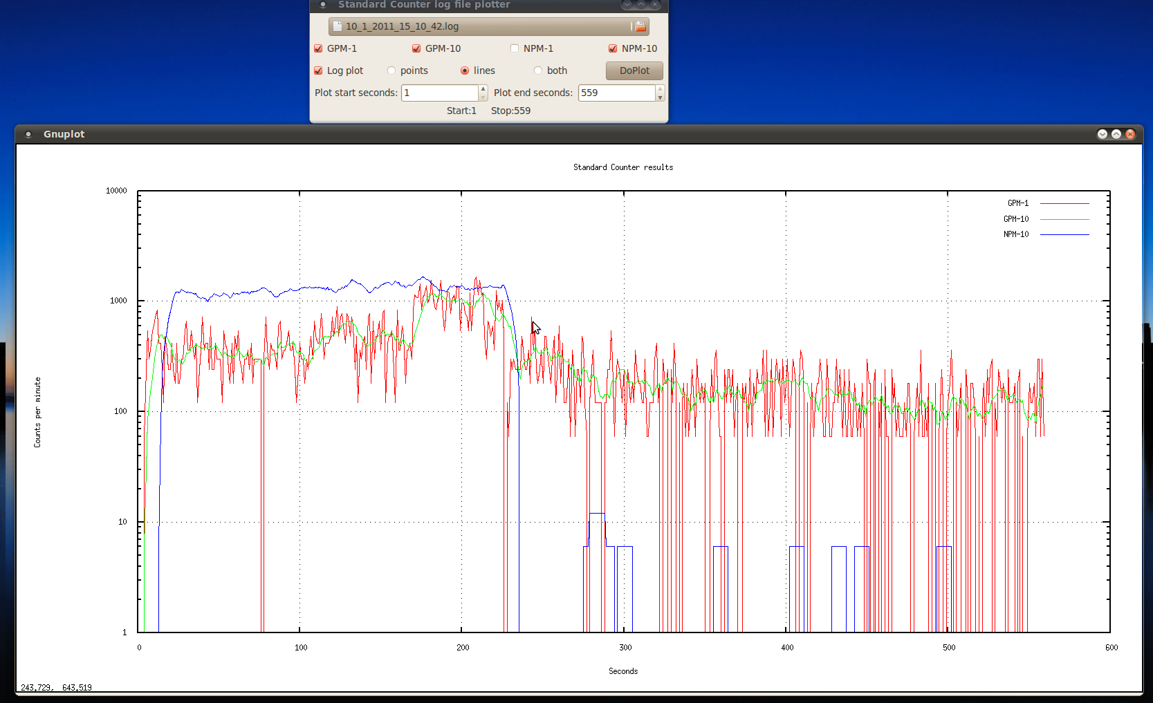

I included the latest/greatest SC, which is the code that talks to the hardware and makes logs and plots. But the new one, SCPlot, is used to plot and replot from the log files SC can create, so you can really dig down and analyze. It lets you choose which of the 4 possible data streams to plot (or any combination), what the plot style is - lines, points, or both, log or linear, and now you can set the stop and start times so you can blow up some section of the overall log for close inspection. As usual, gnuplot will let you put your cursor on a point, and report the X and Y values for that point, scaled in the same units as the plot.
Screenshot of sample file, no neutrons counted in this one
All you do is select what file to plot, your options from the GUI, and hit the doplot button. This runs very very fast, so it encourages you to mine around in your data.

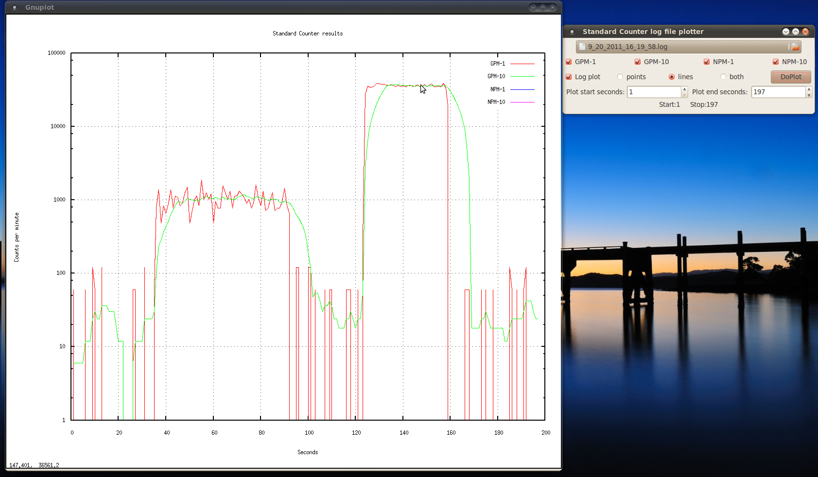

Here's a more interesting plot, from the log file taken on one of Richard Hull's runs at HEAS 2011. Contrary to his humble statements he's reached 1.7 million neuts/second at least at times, on a ten second average, and got silver to a higher peak than he claimed as well - you can see the dip in the geiger counts when he turns off the fusor, then puts the silver on the counter. On this log plot an exponential decay is a straight line.
Richard Hull's run HEAS 2011 (one of several)
I show silver peak at 690 cpm (one second) or 371 (ten second average peak value) on this run. Not too shabby at all!

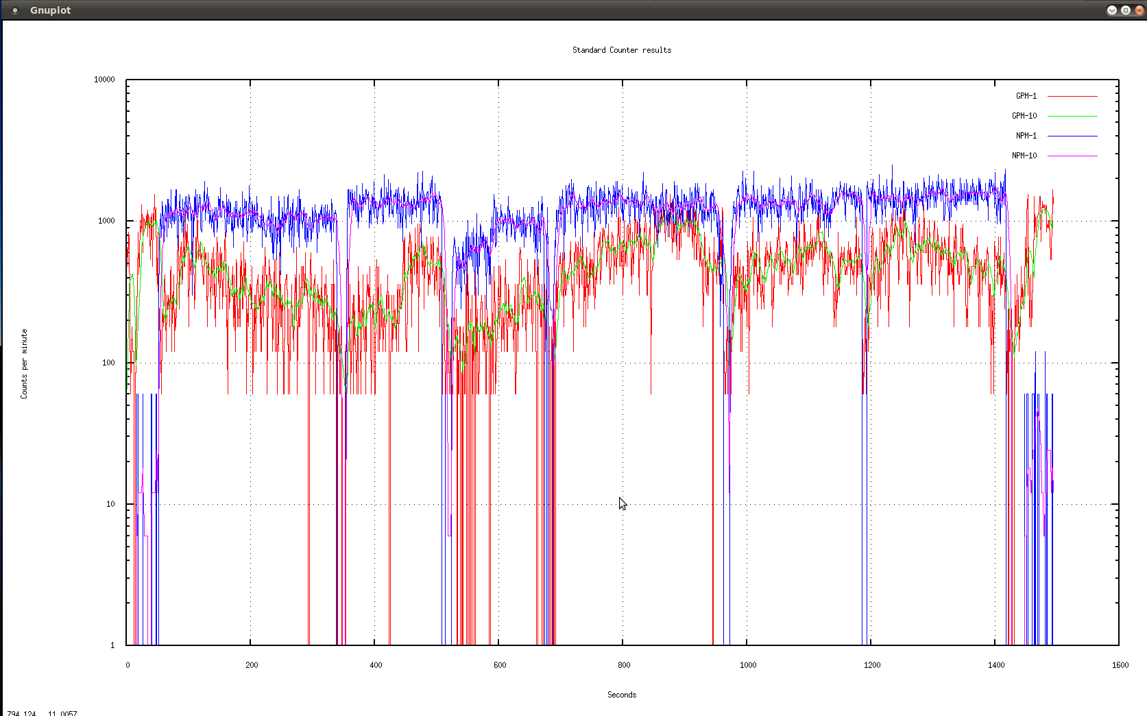

And this next run hits 2 m neuts/second near the end for awhile. Richard, like most good scientists, doesn't over-claim on his results. But the numbers don't fib here.
Some of the variations on the X rays are people moving between the counter and the fusor, but the dropouts are where the fusor stopped for whatever reason. Happens here if I take out too much gas for it to stay "lit", or of course, when I turn it off.

Nice job Doug! I like the new options for replotting the results. This is probably the first time that there's been a direct comparison between two labs without a huge amount of uncertainty from everyone using different equipment. Even as hectic and disorganized as things were trying to get fixed timed runs, not to mention "Richard's run", the timing is all logged and the rest can be extrapolated and still produce good data. Awesome!
