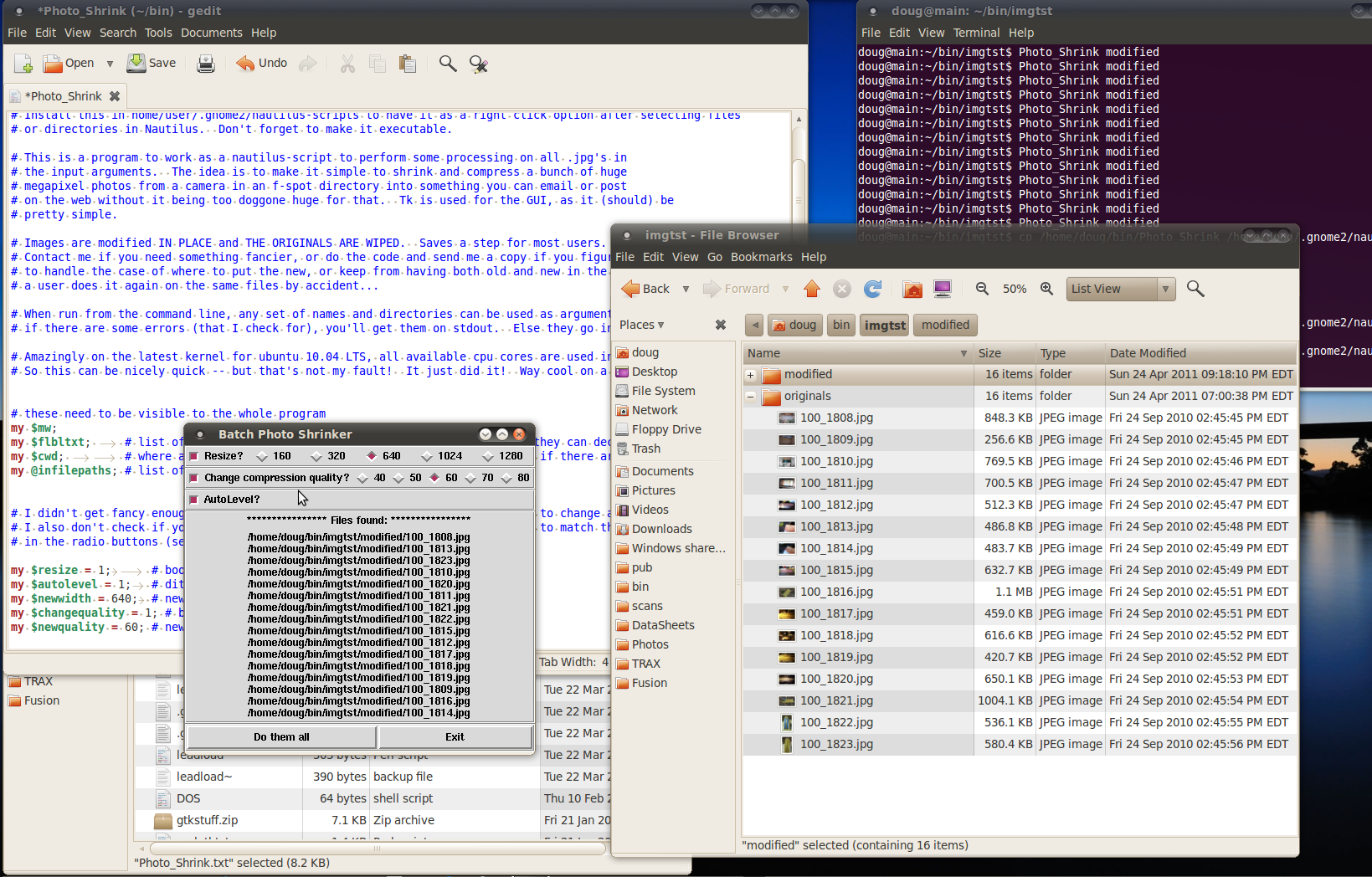

Here's what it looks like when run on a directory:
Screenshot
What's nice about this, in linux, is that if you install it in /home/username/.gnome2/nautilis-scripts and make it executable, it will show up as a right click option in the Nautilus file browser in linux, and let you do selected files and directories really quick and easy. Like you get from the linux camera capture program, F-spot. It does this in-place, which is one of the tradeoffs.
