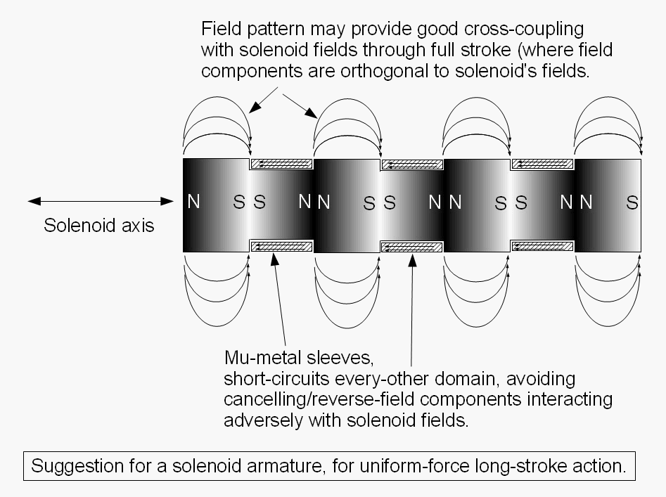

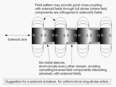

Postby chrismb » Sat May 12, 2012 11:14 am
Hi John..
..quick sketch.. just an idea.. something like...

Re: Magnetism experiments....
Postby chrismb » Sun May 13, 2012 5:27 am
Hi John,
Do you ever get that feeling you're rushed something out, looked ok, then later realise it wasn't what you meant to do!
That's as with the diagram above. Might sound bizarre, but I thought I'd drawn what I wanted to, but it dawned on me last night that it wasn't.
What I was thinking was to put the shielding around the shared domains. I'll try drawing it again. Maybe it won't look nice/work out when I draw it again... more laters...
