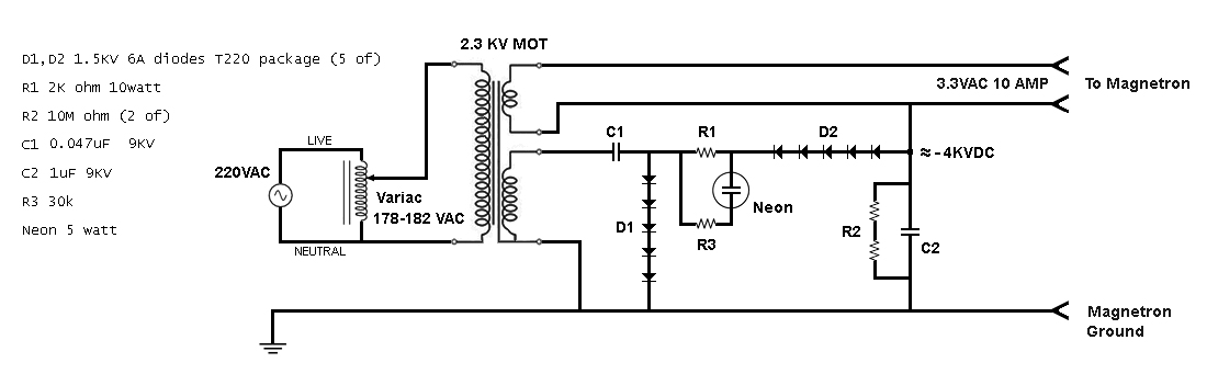

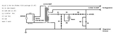

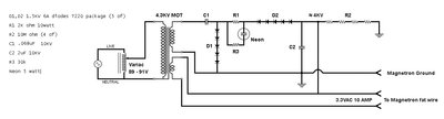

Latest power supply schematic for ion gun.
I have made some small changes here: I redrew the transformer, showing the internal ground connection to the transformer core, on the output side, not the input side, which was incorrect. I also removed two 10 megaohm resistors, to drain that large capacitor faster. I found that a 1uF cap @ 9KV will suffice for C2. I also reduced C1 to around 0.047uF @9KV. So, to be clear, the top circuit is the latest one.

Thanks for the neater and more readable version, Jon -- this is exactly what I have going here. You will also need a positive polarity supply for the ion extraction electrode (pusher in your case) which I built off a CCFL inverter/multiplier so it's separately adjustable -- you don't need too much current for that. But thinking about it - once you get the voltage right (or know what right is) you could probably do that off the original transformer as well, saving some parts and money. Diodes that go 50-60hz are a lot cheaper than the fast ones needed for a CCFL after all. For that, a bunch of dirt cheap 1n4007's in series would do just fine and the caps need not be so large.
Since 5w neons are quite rare, you could use a smaller one there with a larger resistor in series with it. I used that big one because I had it, and because it's a kind of dirt cheap milliamp meter I can read from across the room -- the lit area of that big plate is more or less proportional to the current being drawn through the big filter resistor. If you have a real milliamp meter, a 50 ma full scale is about right there instead of the big series R -- you'll run below that, usually 30 ma or thereabouts. But in that case, you'd have to devise some meter protection as the transformer will easily put out an amp if the output is shorted...where the neon just lights up bright.
I'd note that the bleeder shown is what I have -- but it's really inadequate to discharge that big filter cap quick enough for safety. I just didn't have power resistors of the right value so I used a bunch of little ones that don't really draw enough current. Anyone building this should make up a chain that can draw a couple milliamps -- about 10 watts at the full voltage. The charge on that filter cap is wicked. I'm lucky to be alive after getting across it a couple times before I put it where I can't get to it easily anymore. So instead of 40 megs with 1/4 watt resistors, you should have more like 2 megs with say 10 watts dissipation capability (at least). In my case that would have spoiled the purity of being able to make the thing entirely from parts on hand....duh.

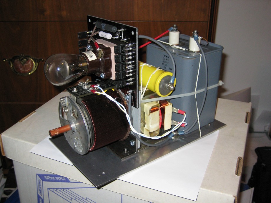

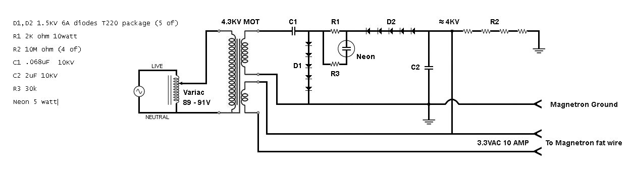

I'm almost done with my uWave power supply. Everything is working good so far - I get about -5kVDC out of the filter cap on the top end (120VAC input), which falls in line with the others - plus I have a smallish magnetron. Although, now I have a question before I finish things up. Do the "F" and "FA" connections matter in this case? I'm thinking it doesn't because we're running these CW so the phasing shouldn't matter like it would in a typical oven running in pulsed mode, but I just want to check. If I need it, I've got it written down somewhere... could take forever to find though. He's a picture of the guts for everyone's amusement...
Re: Microwave Ion source
Postby Doug Coulter » Tue Jul 05, 2011 10:05 am
Filament phasing hasn't been an issue in mine, I didn't bother to even check. Some MOT's have two secondary taps (for higher or lower line volts) and that would matter some. We're running our variac at about 89-91v output, just at the point where we have enough filament power to make it go. It's pretty stable there, it's right about where the transformer core begins to saturate (which also keeps the transformer from getting too hot in full saturation). One could probably substitute the variac with an incendescent bulb, actually, but I've not worked out what the wattage rating would be to give the right output. I plan to try that at some point, as the load is friendly to that approach.
