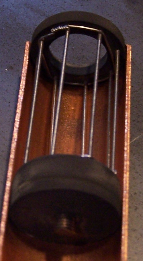

For reference, here's a pic of the older, twisted grid. Other than that, the differences are, the rods (tungsten TIG rods, because they are cheap, and very straight) are larger - .040" in the picture, where in the new grid they are .020", and the new grid is about 1/2" longer than the old.
Old (but record-setting) grid design. Graphite ends, Ta wire to pull the rods together so it doesn't fly apart under the E field forces.
This one does not throw a focused beam out of the end, or if it does, at least it's way out of focus by the time it gets to the viewport, about 15" away from the end. That could be construed as either a bug or a feature. The new, straight one, DOES toss quite an energetic beam of "something" that is repelled when I put negative volts on my ion source grid, which is halfway between the main grid and the window, but off to the right side, as I demo'd in one of the videos on my DCFusor youtube site. The bases on either one get quite hot. It's obvious why on the old one - it's thick and conductive carbon. With the new one, not as obvious why, as its thin, anodized Ti.

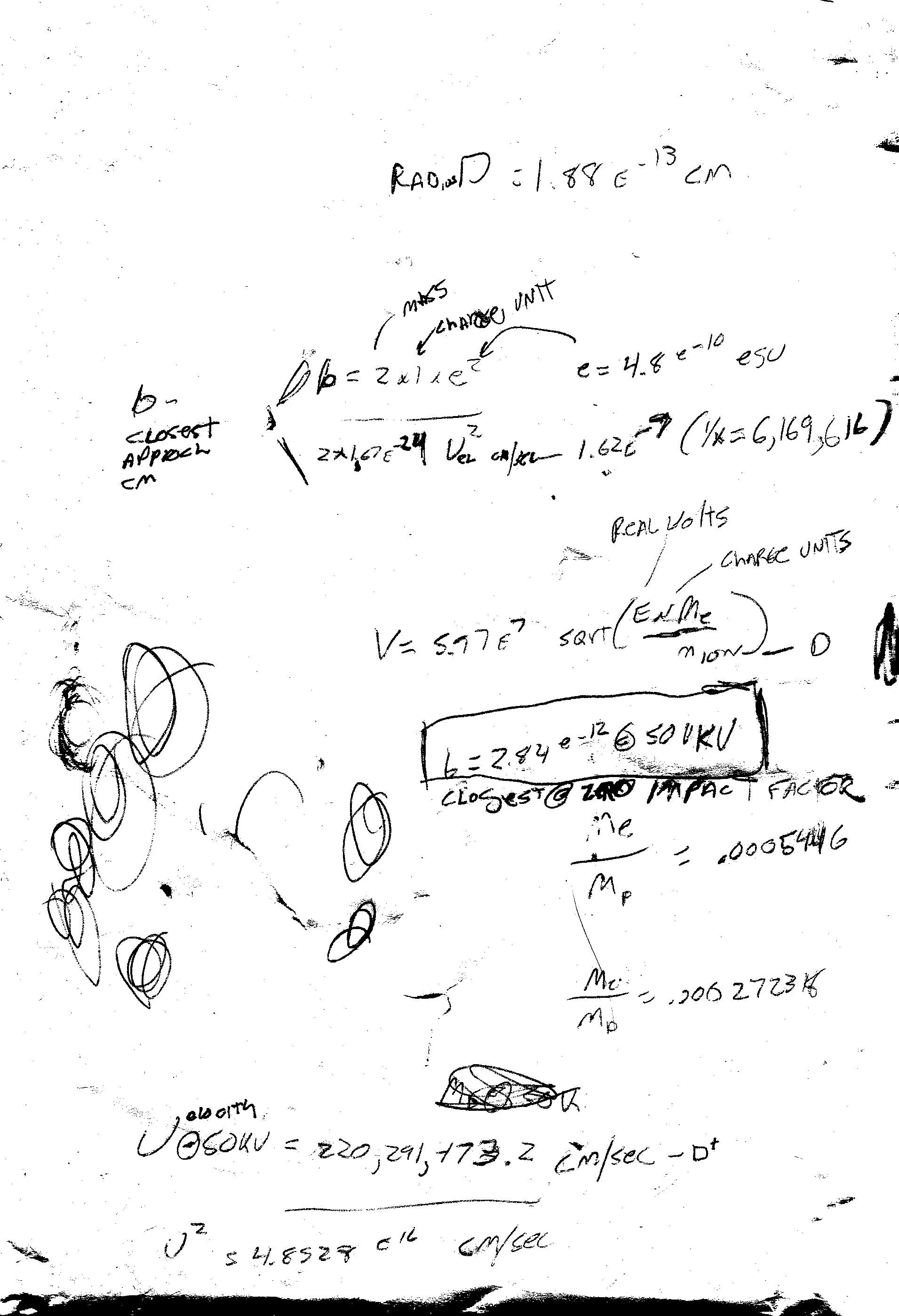

Here's where that "closest approach with zero impact (perfect aim) factor math comes from. One of the reasons I like the old books - they give the actual units used, and examples. It's almost as though they were trying to communicate(!).
Unlike just about everything after the 60's or so, which is just trying to impress you with command of jargon and "clean looking" but actually messy, math.
Math from "Nuclear Physics" by Kaplan, library of congress cat # 54-5732, C 1955
And the next page where they estimate the well width a little higher than they do now (all that tunneling probability stuff - who's to say where the cut-off is?).
I calculated the D velocity in 50kv from Terman's math. I also changed the 4 in the numerator in the closest math to 2, since we have a D, not an alpha, here. I *think* that was the right thing to do.

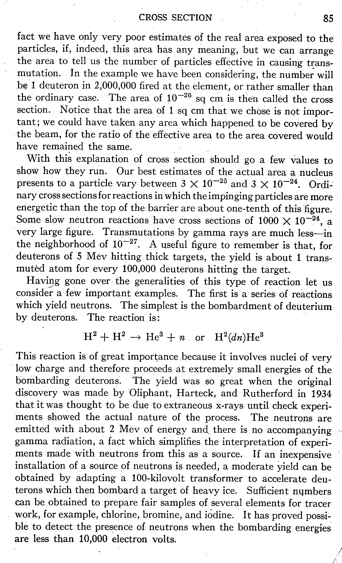

Well, even though I'm a bit short of electricity tonight (east coast US snow storms), I couldn't resist adding this next page, as it tells us something interesting.
From Pollard book
Note he mentions cross sections smaller than the actual stuff involved - there are a lot of reasons we now know for that - spin, forbidden transitions etc, but they noticed it experimentally before the theory caught up.
