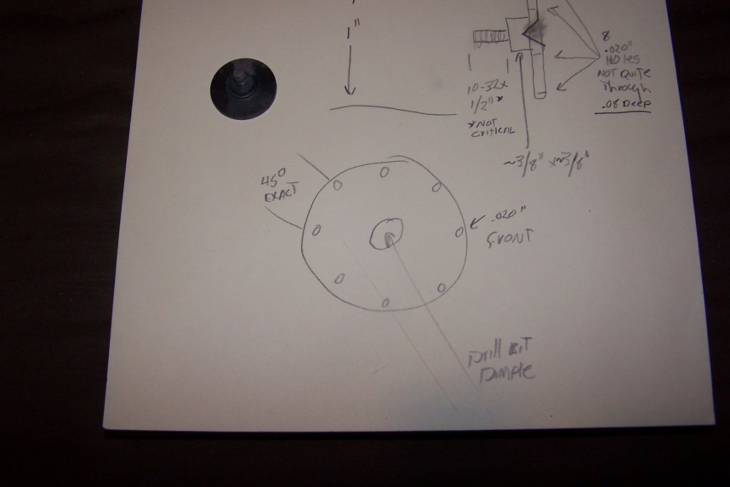

When I get a little further, the W rods will be held in their .020" holes via centerpunching around the edge, like before - that worked quite well. And if I can get that Ti ring round (it's 1/8" wire bent to a circle and butt welded with my TIG welder), and drilled (gotta figure out how to hold it centered - I'm partway though building a jig for that), then the new other end will be that ring.
This time, insead of the circle table and mill, I used the tool-post grinder I made for my lathe, and a big degree wheel stuck on the chuck with magnets to get the alignment (I used one for cams from Summit Racing). The reasoning was I was breaking drills, a real bummer with what they cost and how long they take to get, with the mill, which won't spin anywhere near as fast, and Ti is picky about that when making tiny many-caliber deep holes, or it won't clear the chips. Looks like they came out plenty accurate - all of this is in the 1 mil error range, total. That despite not having grade 7 bearings (not hardly) in the tool post grinder - they are the cheap guys, but have no sensible play at all - the issue is how straight the quill/collet is, and vibration, which amounts to a couple mills when the drill isn't in contact with a hole.

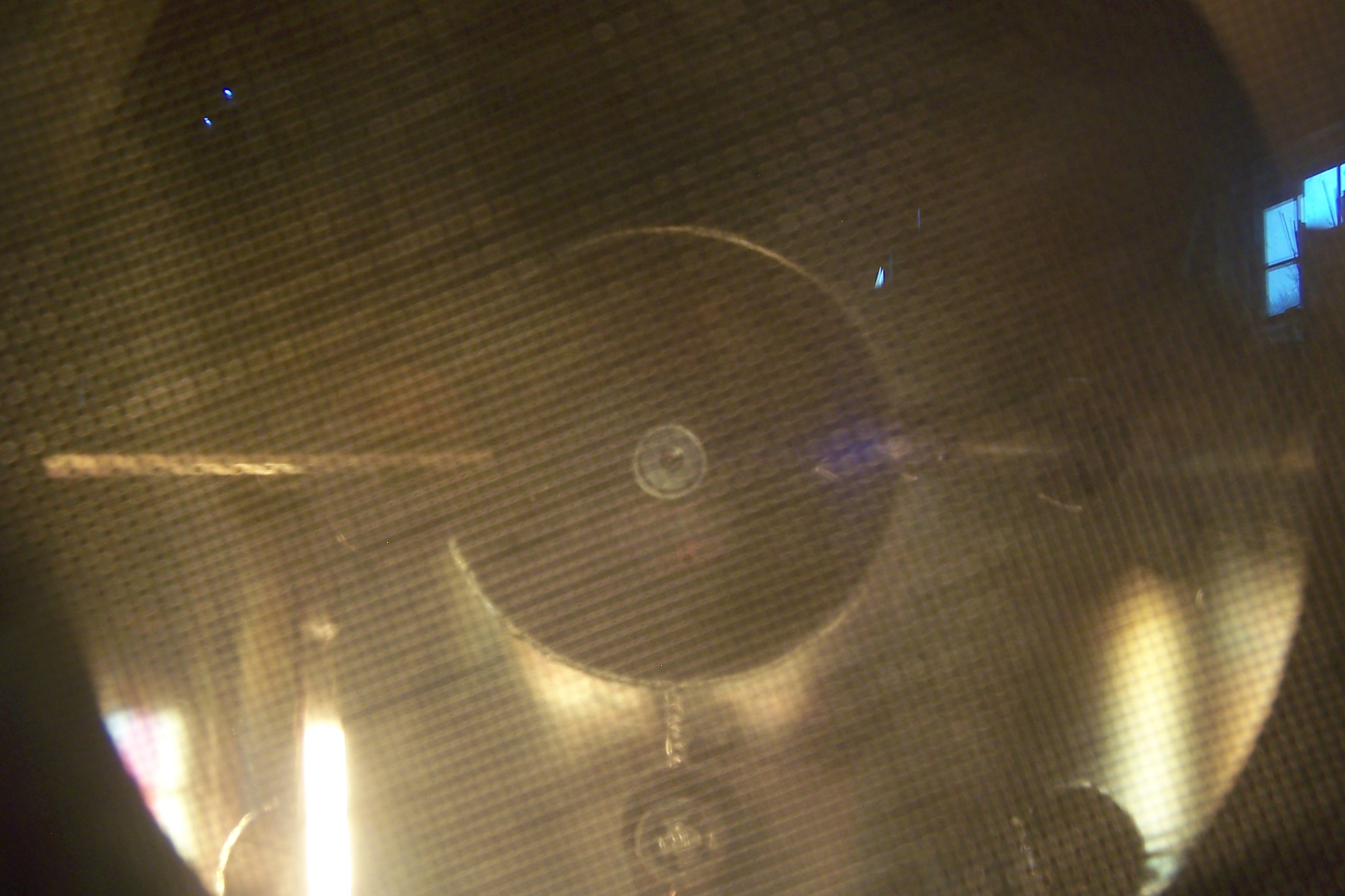

The last time I made one close to this good, I discovered something I hadn't seen before - the beam out of the end was so finely focussed, I was making a screen I'd put inside my view window heat to orange hot, with something negatively charged.
Here's a video that shows the effect better than typed words can - watch the spot move away from the ion source grid on the right - closer to us than the main grid:
This is with the previous accurate grid. The older, all carbon but for the .040" rods is what we ran just before the 2013 HEAS, and it shows no null with ion source voltage variation - this seems to be due to the slight twist on the older grid, which was a mistake in manufacturing (perhaps, it actually works really well, as that video showed, but doesn't toss out this concentrated beam from the end as far as I can tell. Or it's not as well focused when it hits the viewport (about 15" from the end of the main grid - all the way across the big tank).

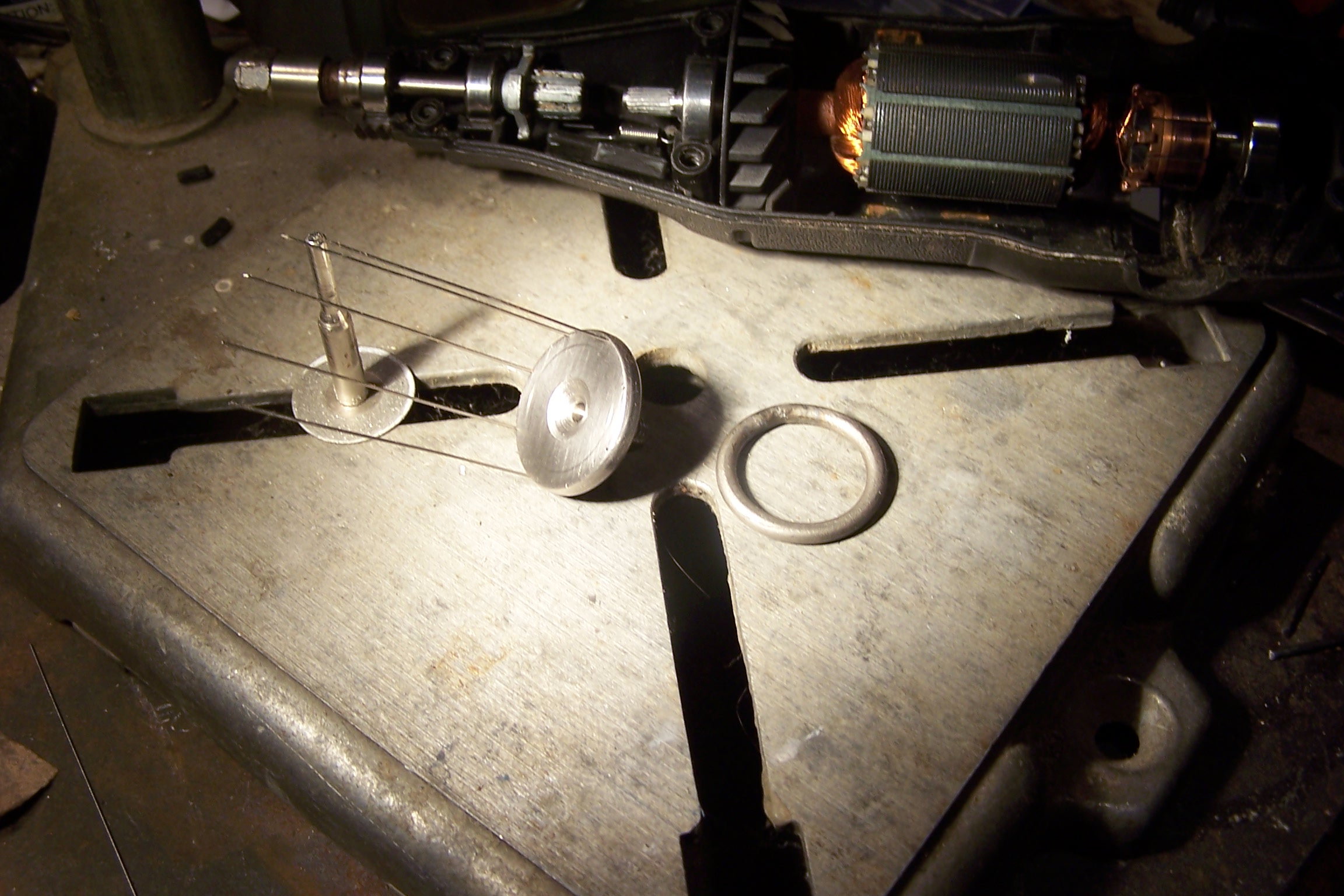

But, wouldn't you know it - right after I manage to get a really nice baseplate made, without breaking off any drill bits in holes (I did break one, but that was just by touching it a little too hard) - my dremel tool, mounted in an old dremel drill press I use for cutting TIG rods to length, took what is probably its final dump and burned up the shaft coupler (which I've remanufactured several times, but this time - big smoke, plastic all melted, it's probably toast for good now). It melted the coupler that was epoxied (by dremel) to the end of the motor shaft. So now I have a knurled shaft with all the dips still full of epoxy, and now also the wrong diameter to use the "hose trick" for a flexible coupler. Sigh...it's always something, isn't it.
So, I save 20 bucks or so on broken drill bits - and lose 200 to having to buy a new dremel and of course, the new ones don't fit into the old drill press, so...I have to buy one of those too. Soooooo close, but no cigar, yet.

The new base looks a lot like this, but doesn't have the rod holes all the way through, so the back is really smooth.

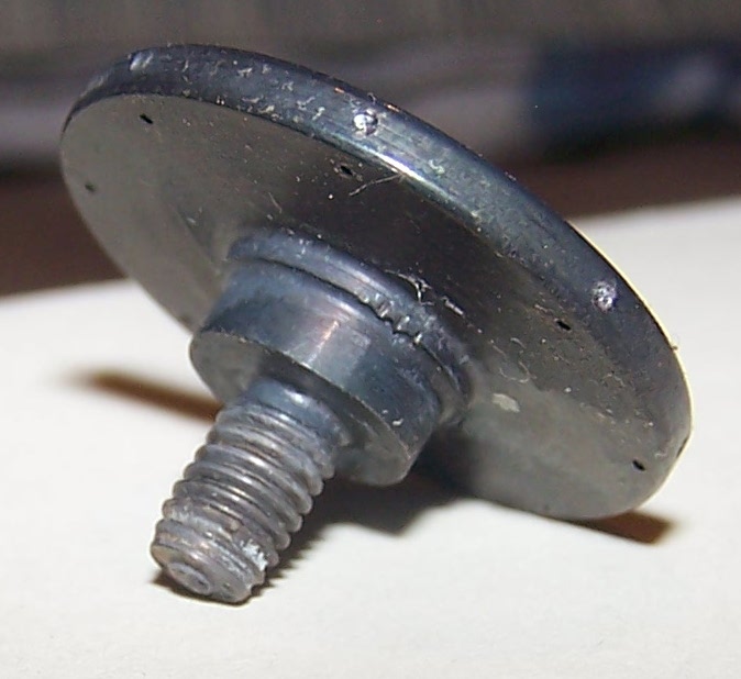

Here's a detail of the older grid, post being broken - I may still rescue it with more anodic etching - tungsten is etched in an NaOH bath anodically, where Ti isn't affected noticeably by that. It's just a matter of getting the E field in the bath to go down that tiny hole...a real pain to jig for.
The old base. Only problem with that one is the holes having been drilled all the way through. If I can fix it, I can use it again, perhaps after making a washer to "hide" those rod-ends from the field.

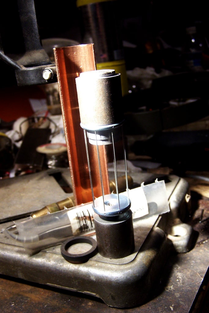

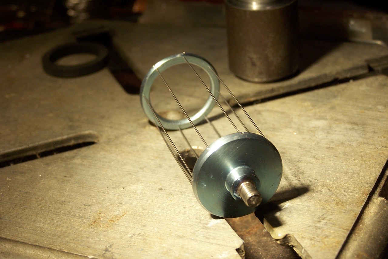

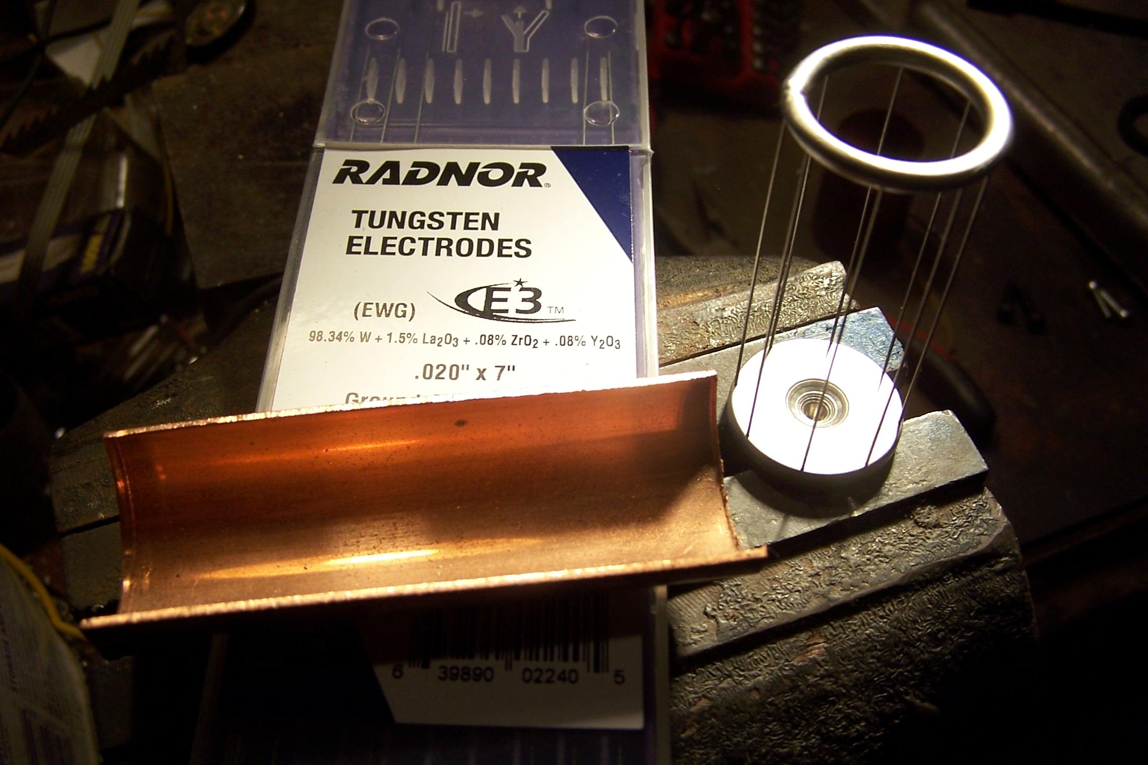

We don't take no for an answer around here. So I rigged a jig to cut rods on the toolpost grinder on the lathe, which turns out better anyway...life hands you lemons, you make better grids.
So, here's what it looks like, along with the rod stock, and the copper pipe jig I use to hold things straight while I stake in the rods with a spring-loaded center punch. I've also made a jig for the ring end, so it won't compress out of round in that operation.
It's a piece of 1" iron bar, turned down to .780" at one end to just fit inside the ring while I whale away on the outside. Tight fit so it won't slip or be crushed.
I left this pic at full rez, so if you click on it, you can really see the details.
Ta-Da:
Here it is, before anodizing the Ti and staking in the rods. Just a test assembly to make sure I got all the pieces done correctly.
The point of making that Ti end ring is to eliminate the graphite, otherwise a great vacuum material. But when hot D hit it, it sputtered and made hydrocarbons, according to the mass spec. This might be in part responsible for the drop off of neutron output late in my "batch mode gas control" runs - but only part. The other benefit I hope I get is that I can "stake" the rods into this one, which I couldn't do with the graphite - I had to "tie" the rods together under tension at that end with a circumferential piece of Ta wire (what I had that would take the conditions easily - nichrome might have worked as well).

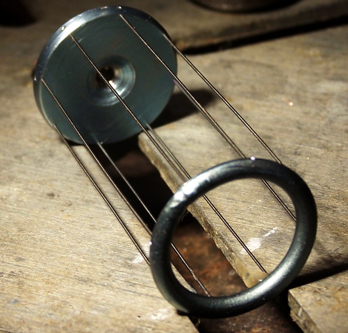

Moving right along, she's done (I hope). Ain't she a beaut?
View from opposite the HV feed end.
This is the view from the non-hv feed end. The titanium was anodized in trisodium phosphate solution (using an Al foil cathode) at 38v, as I liked that color. More on that later.

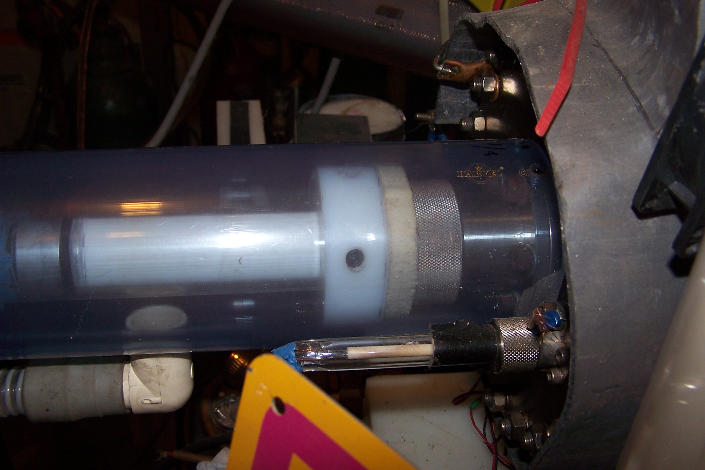

OK, we got 'er done, and now it's in the tank. The new grid is a good bit longer than the old one - probably a mistake, but time will tell after breakin and purity is reached again.
I used a spacer behind the feedthrough to pull the new grid back to about the same extension as the old one was - more or less, and here it's fairly critical, with the whole "good range" in about 1/10 inch - so I might not have hit the sweet spot - I'll work on that one once things are more stable.
Here's the spacer - it's the piece of rmax between the HDPE clamp and the tank fitting:
Spacer, a quick kludge.
And here's what it looks like in the tank. Doggone auto focus gets all excited about that SS screen right up front, going to have to learn how to turn that off on this camera...
Mounted up and ready to ride!

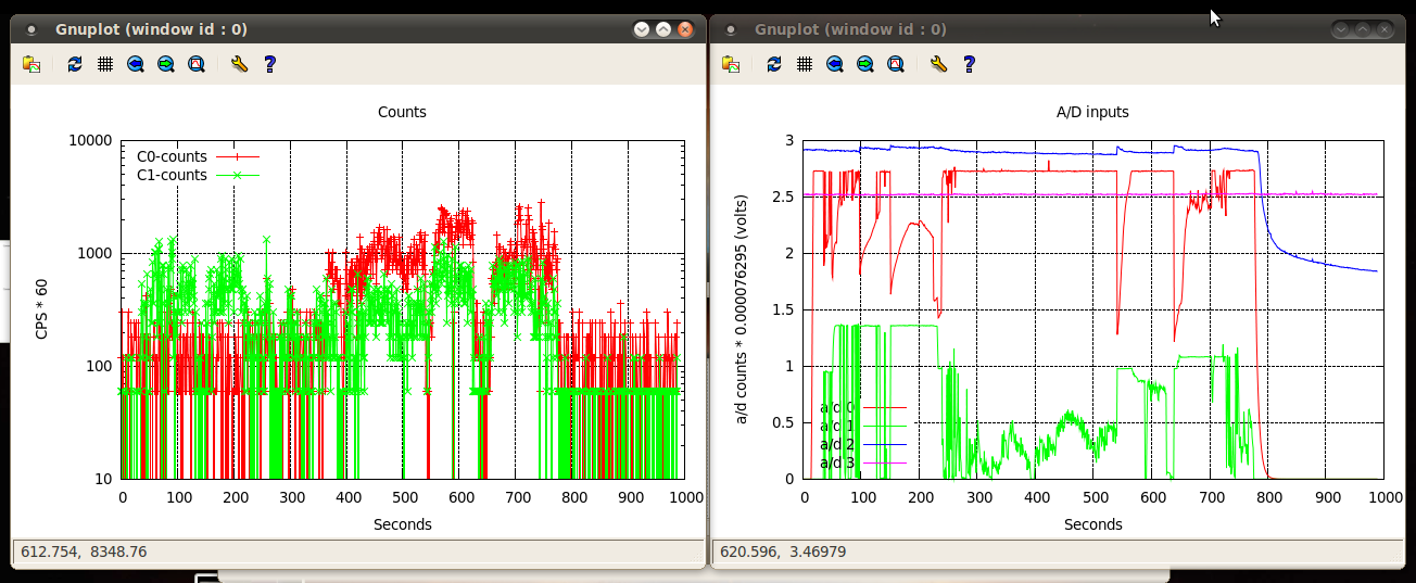

I then did a break in run, and some analysis, which will be a new thread under "run data" pretty soon, right now the movies are uploading to youtube.
The main change I noticed in the run was it will run at lower pressure "on the natch" eg, without an ion source. This one also throws a tight beam out of the end that heats my RF screen to incandescence, like that other accurate grid I broke. All the other phenomena are about the same, but experience has taught me to withold judgement till the thing is "broken in" and the tank is pure again, so I will. For example, the old grid, when first put in, was hard to get to 1m n/s with. Now we've made 7 million n/s with it...and can hit 4 every time we power it on.
This one hit 1.4 m n/s on the first go. Not quite the 2x I was hoping for, maybe. We'll just have to wait and see.
I DID NOT get the null I had on the previous accurate one, but for that, the ion source grid was in a different place too, and it was a different grid. So....maybe I'll try that placement/grid again.
Here's a screen shot of the data aq on this run. Nothing special, I was just playing around with the parameters, and trying not to melt anything. Stuff did get red hot...or more, close to where the Ti might melt, but at least the temperature distribution was even.
acreenshot of first run data, more will go on the "run data" threads later.
