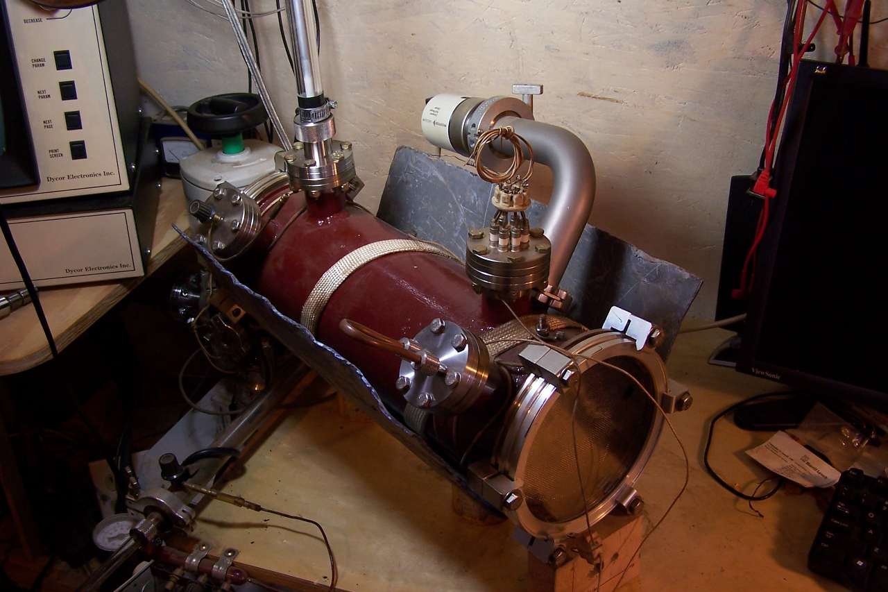

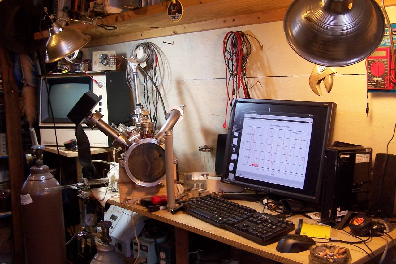

Here's the thing as it now sits. HV isn't yet hooked up for real, but I have a ballast resistor standing on end there. I have a 60kv 150w supply I plan to use on this, as soon as I make a cable for it.
Overall view

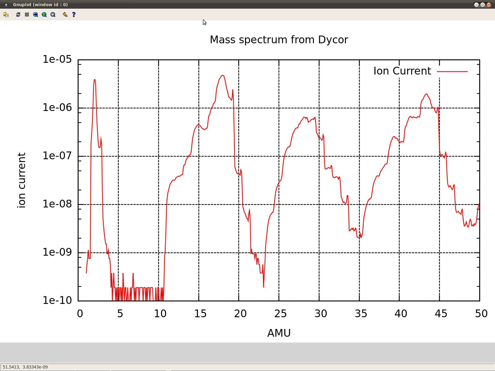

Here's what's on the computer screen right now as I'm baking it out:
Mass spec output
Yup, water, air, dust, fingerprints. Not unexpected at all. I expect that tomorrow it will look like it did yesterday, or close.

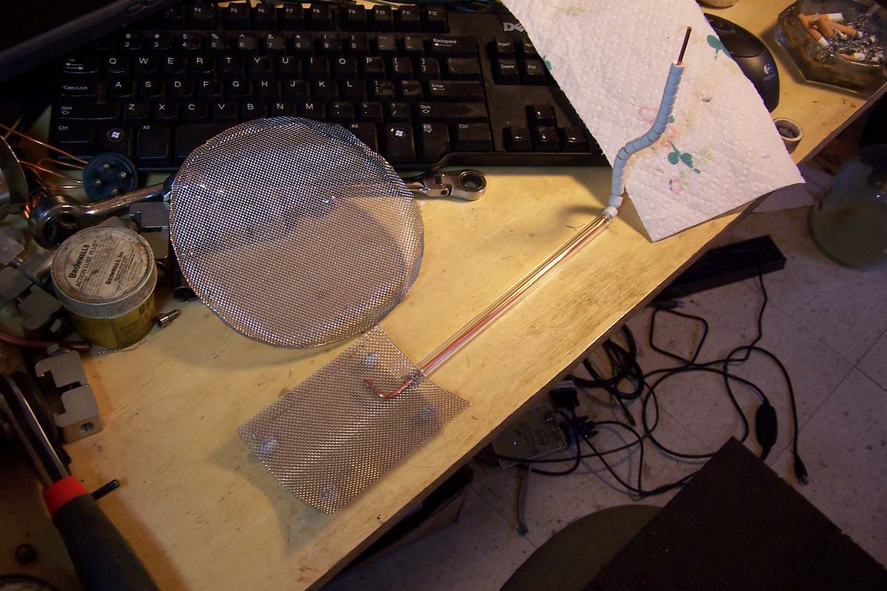

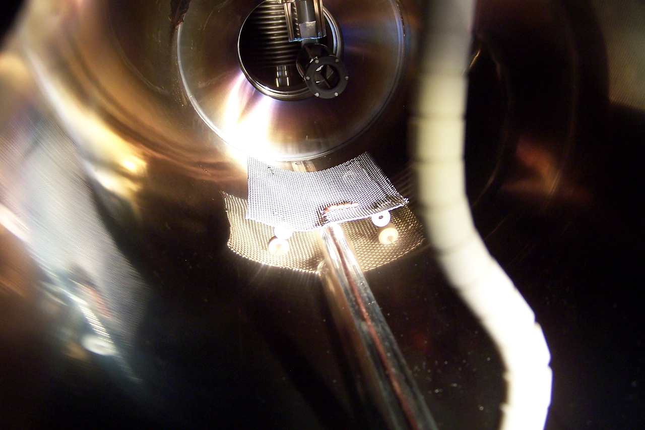

Here are the new screen for the window, and one to lay on the bottom of the tank and act as an electrode to both measure and perturb the E fields we will have.
New screens inside
This is stainless steel screen Bill brought over the other day. The electrode one is tied to the fat wire with nichrome wire, in the manner of sewing. I also sewed a few fish beads to the bottom to insulate it from the tank. A piece of pyrex tubing is the main insulation, and the other end of the wire plugs into an octal tube socket I put on an 8 pin feedthrough. Can't do much kV on that one, but that's not what it's for.
Here's what it looks like before I put in the protective screen and seal it up.
Innards before final assembly

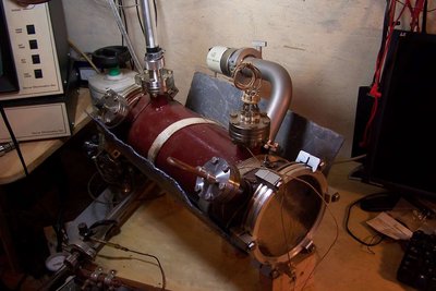

Postby Doug Coulter » Wed Apr 20, 2011 9:22 am
'Cause we're going out tonight! There really is no such thing as a one-day fusor, that was sort of a stunt to say the least. In initial testing I forgot how much comes out that window, and picked up an estimated 3 mrem of X rays before I got the dosimeter and then quickly turned things off. Well, that's not acceptable, so on goes the shielding, shown in progress here:
Dressing the lady in situ

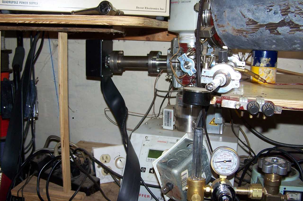

We bought a qf-40 to CF-2.75" adapter from Andrew Seltzman, so I could relocate the mass spec head in an out of the way and more useful place (depending on what's planned), down closer to the pump and inside the main tank valve. So now it's here:
New spot for mass spec
The idea in this case is to be able to look at gas compositions when the main tank is above the pressure at which the mass spec can work. By relocating here I can't see tank ions directly anymore with the spectrometer ion source turned off - but I have that going on in the other system anyway. Also, since this system is in a high foot trafiic area, that head hangning out into the aisle was a worry, no more.
So, after some more fiddling, there's still work to do, but it's an improvement.
Needs the tough parts still -- all that filling in the gaps in the lead and something done about the window. New inlet valve installed.

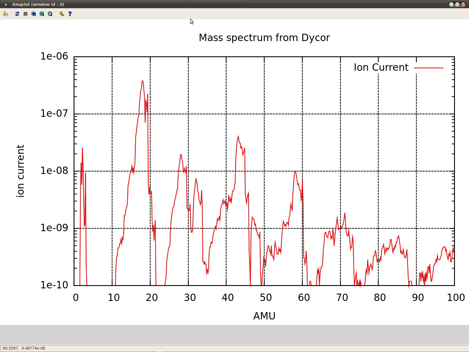

Note that this was a 2.4e-7 mbar before I tore it down. After two hours baking at 150c, and cooling down it was still at 4-5 e-6 mbar. The next morning (now), it's at 4 e-7 mbar. Quite a lot of the mass spectrum shown isn't air -- it is mostly water (as usual) and the water is bigger than the air, so if I have a leak, it's a pretty dinky one - probably the new inlet valve, as I'd forgotten to clean the seal button before putting it together -- no big deal, I can do that easily at any time.
Most of that high mass crap seems to be an artifact of the mass spec itself -- it all goes away after half an hour, but is always there right when I turn it on. This thing must have been used in some dirty process in the past, or something similar. As of half an hour after taking the above picture, it's mostly gone except some stuff in the CO2 range -- normal after you've wiped down some O rings in solvent during assembly.
Note that two hours of fairly stiff baking wasn't even close to enough and that all night pumping after that still wasn't enough. Most people without mass specs have a completely wrong "feel" for just how hard it is to get to hard vacuum even in a leak-free system. Just no idea. A couple days with one of these will change your vacuum technique for life, and you won't need one as much anymore - but till you actually experience just how hard it is to get rid of that adsorbed gas when you're in molecular flow (eg random billard balls of gas atoms leaving, then sticking on the next thing they hit till you get lucky and they go into the pump and are gone) you just can't use your normal intuition on this kind of thing. As a wag at Lesker said, "vacuum doesn't suck". You have to wait for the individual gas molecules to "blow" out of the thing, and the system walls are like flypaper to them, so they keep getting stuck on them, come loose now and then, but more often than not, simply stick to the other tank wall and wait for nanoseconds -- to weeks, before doing it again. Water, being sticky (polar), is the worst of the normal things you run into, but other things you should never even allow in the system if you ever want high vacuum. (Cd, Sulfur...Zinc, Solder...oils...you get the idea).
I laid the ballast resistor I'll be using on the tank so you can see it. The PVC fittings will hold this and protect me some from HV, and will be in turn covered with grounded wire mesh for EMI shielding. This system won't have the big input powers I use on the other ones, so I'm hoping I don't need forced air cooling for the ballast this time. In case anyone is wondering, that gage is way out on the elbow to keep its stray H field away from things. Early on I got some "interesting" photos of ions being guided by that right into it from lng distances away, which couldn't have been doing the gage much good, and was sure messing up my lower energy experiments -- so that's the fix I applied for that problem.

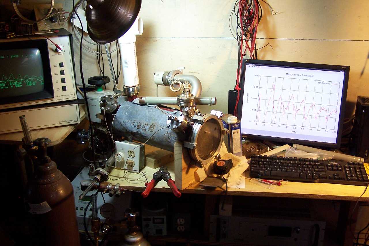

And here's what that mass spec looks like with no changes other than another half hour of warmup. You need to pay attention to the behavior of your gear, or you'll be fooled a lot.
Evidently, this one picked up something nasty earlier in life, and what ever has diffused to the surfaces overnight gets blasted off and detected every time you turn it on. Once that's over with, you have a chance to see what's really in the tank itself.
Mass spec after run-in time -- limitations of gear.
With air about an order and a half below the water -- it's mostly water, and probably almost no leaks. And all that water was from opening the system for about an hour total, on a not especially damp day. Once I get the window handled so I don't get fried, I'll run some power through there in a glow discharge and really blast the walls for awhile, flush, and it should be a lot closer to normal after that. Nothing works as well as baking from the inside -- heat, UV, hot electrons....much more effective than just some heat from outside.
