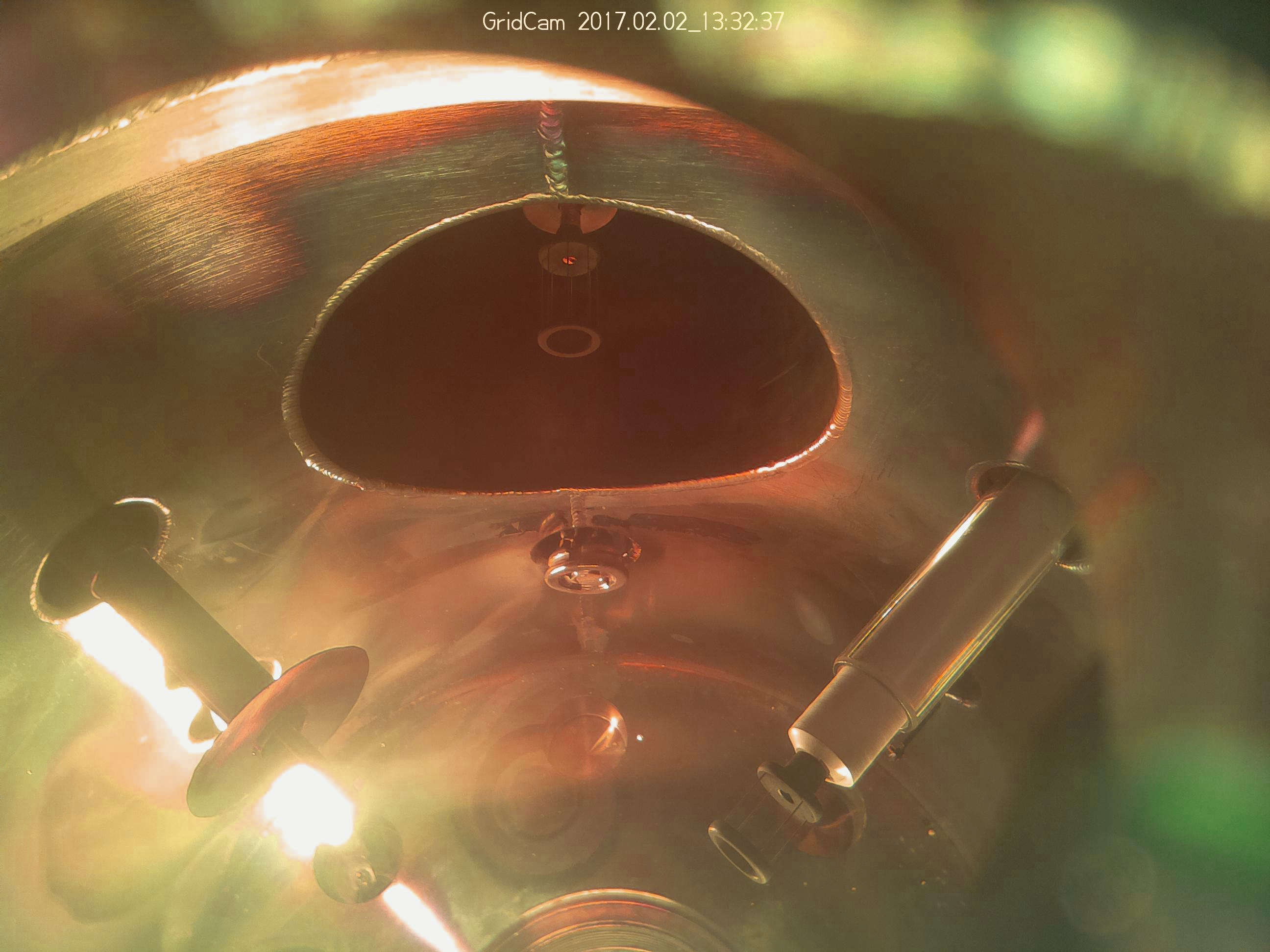

Here's what it looks like in the bake-out heater light (500w in a shiny box is LOUD):
Weird color from overloaded cam dynamic range?

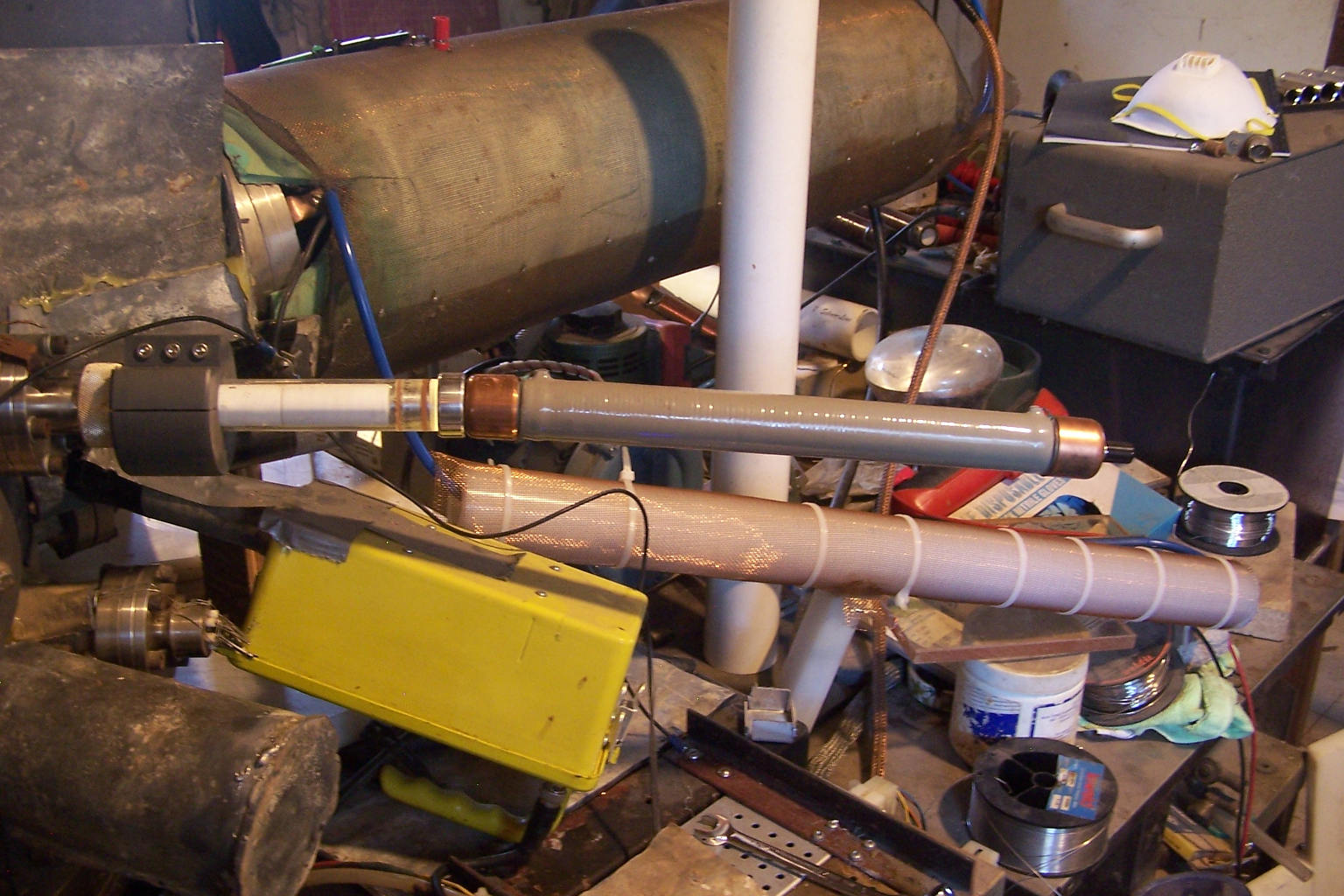

And from outside with one of those big ballast resistors I test with on there as a kludge:
Testing 1,2,3.
Testing 1,2,3.

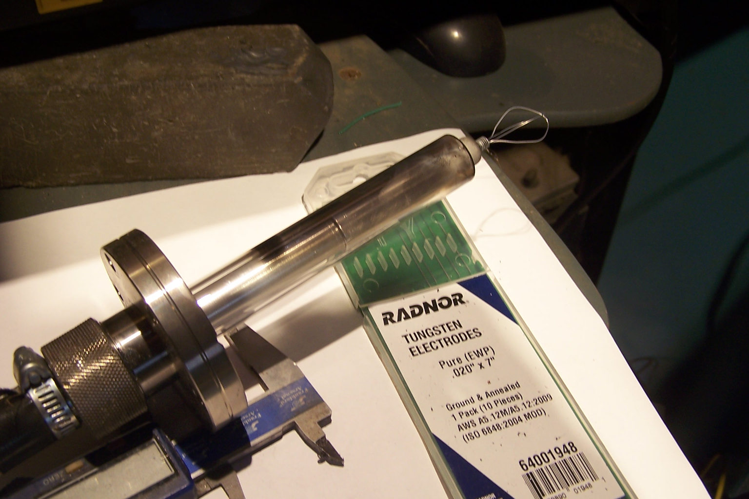

You might see where due to marginal previous performance I'd turned down the center Al stalk a little where it goes through the grounded stuff. It was marginal at around 10kv. And duh, I forgot and we tried 20 on it the other day, and it just plain failed. What's of more interest to me here is the side we can now see - this was the "back" side. Look at all that metalization on the glass! Well then. Probably some sputtering from elsewhere, but also the old bugaboo - hot ions + glass = silicon.
To help with some free info - in the pic is also the grid wires I now use - TIG rods, special order tiny, and that grey block at the top is the buffing compound I used on the new one (6061-T6 Al) - the stuff seems to be color coded to some standard. It's the aggressive grade, at any rate.

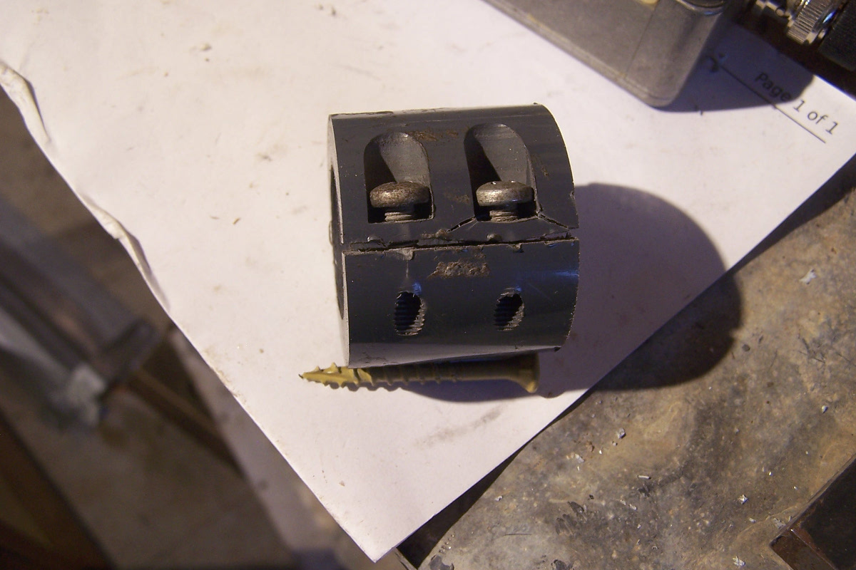

I got away with the gorrilla tape and hose clamp on the 3/4" thickwall tubing but it's a definite fail on 1" and larger...hence the nice new PVC clamp.
For completeness, here's an old one for 1" pipe that failed - the new one is overkill (but will hold up the insulating/shielding pipe nicely) and the old one is, well, cracked - too wimpy.
