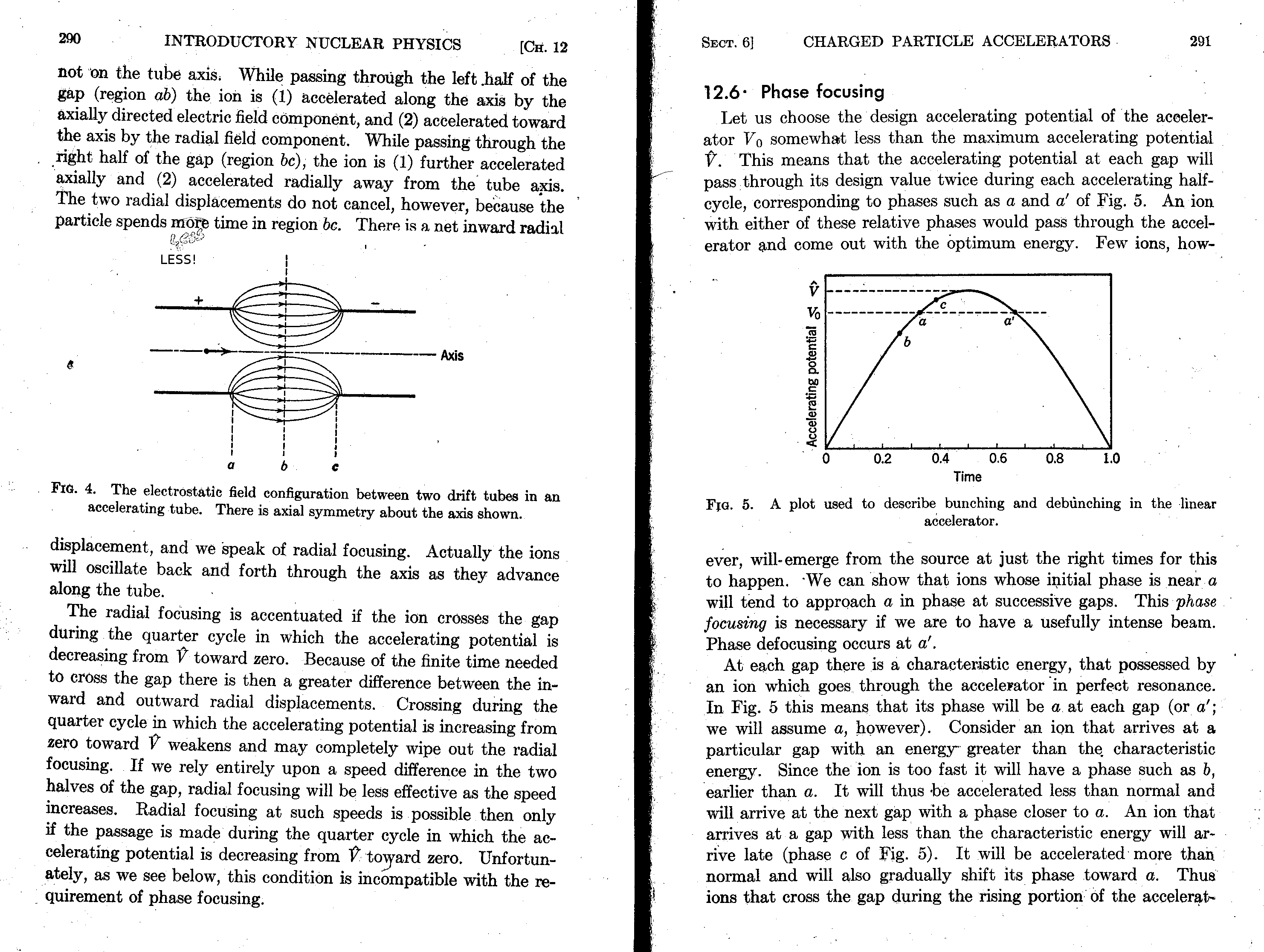

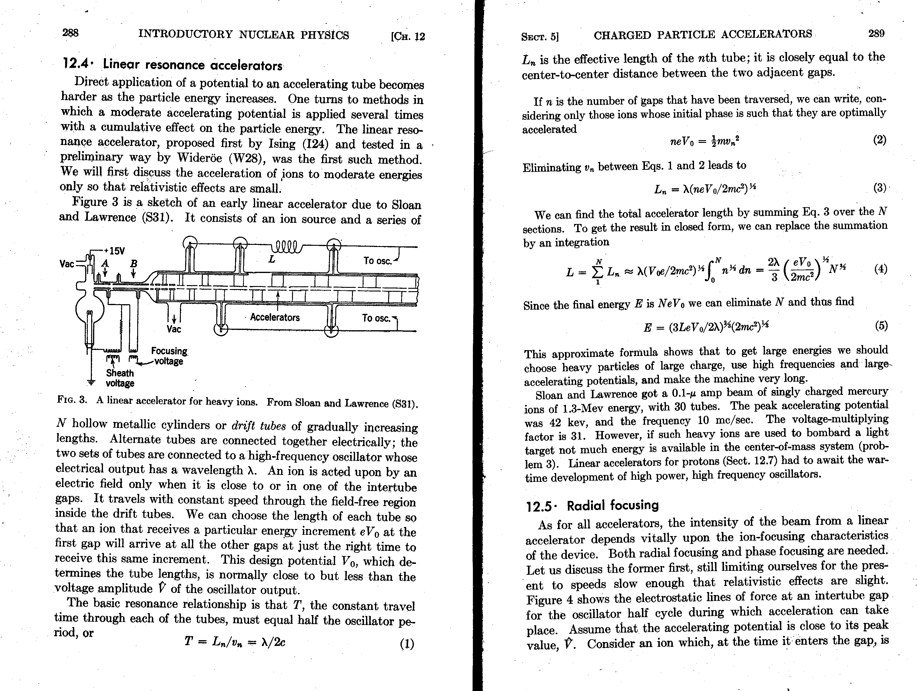

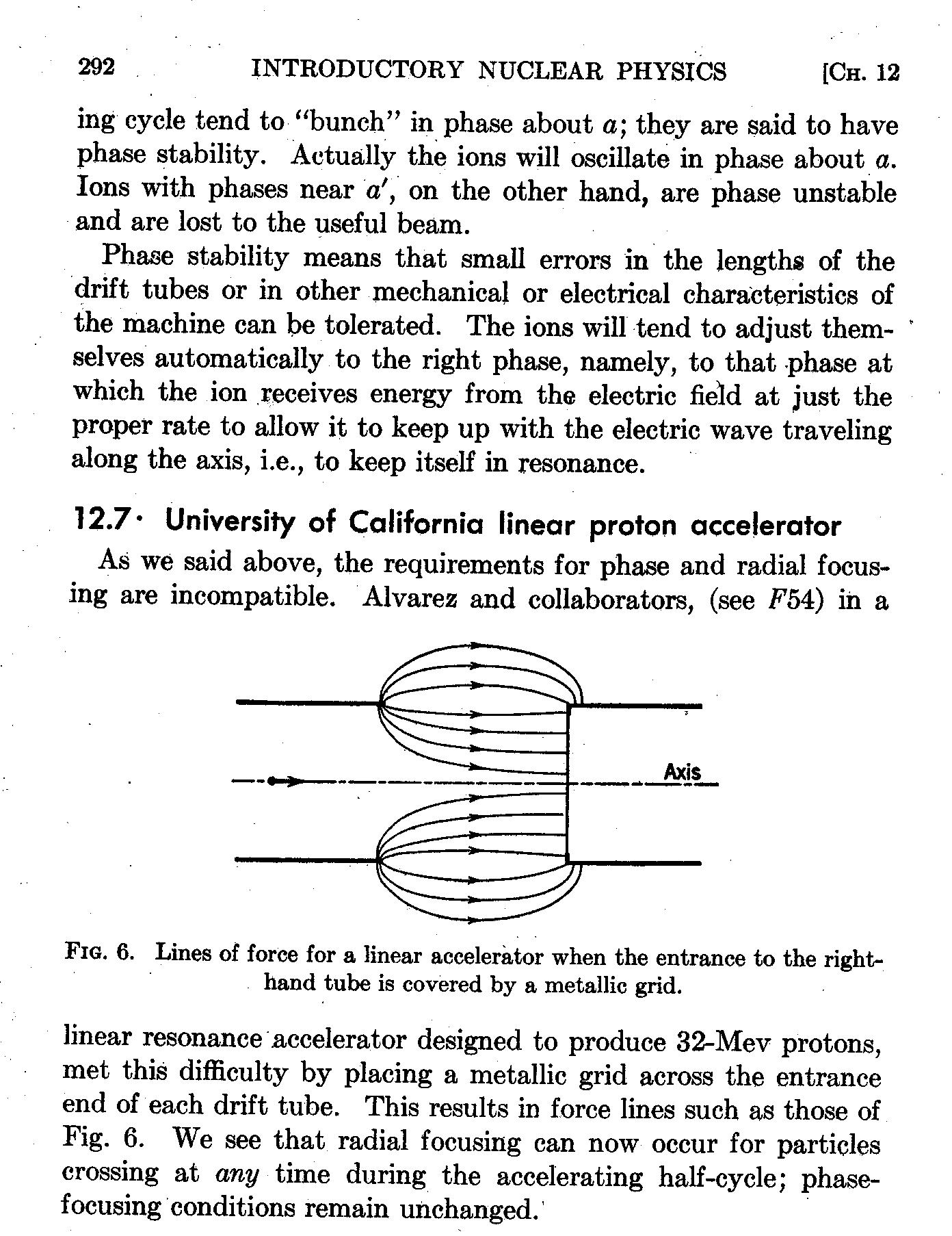

Since this isn't new science, nor is it really new tech, I'll let Haliday say most of the words. Note the page on focusing has the only actual error I've detected in the whole book - a particle spends LESS time in the second half of the accelerating gap, not more (and see, the sentence makes more sense that way).

Like I said, the drift tube accelerator is a little picky and is a mass spectrometer. Here's the results of a couple of runs that show that with only changes in both DC and RF voltages, you can indeed accellerate different ions...You pretty much just scale the volts by the mass/charge ratio of the two ions, then can use the same hardware (if it will DO the different voltages).
Yeah, I used the ratios calculated from the (hopefully corrected correctly) mass numbers inside the code. Those require quite an increase to go from D to T, roughly 3/2 as you'd expect. I'm using this program to investigate that sort of thing, an this might militate to using higher frequency, shorter tubes, and lower voltages to keep things reasonable -- I'd love to be able to do lithium for example, and I don't need the higher beam energy. For DT you only want ~110kev total. But for DD beam on target, you want at least 125kv, so perhaps the real advantage is that these can easily be made and inserted in a simple quartz beam tube - substituting one should be pretty easy. I'm still exploring the tradeoff space here. There's another ISM legal band at 2x this frequency, and one at half, and crystals and so on are common for these frequencies. They laid out the allocation this way as harmonics are often generated in cheap bulk industrial RF sources, so if you radiate some 2nd harmonic, you're still legal and not interfering with anyone allowed to complain about it. If I was running a few or tens of watts, I wouldn't worry much, but at KW levels, even a small antenna will let some significant power out into the world, especially at these voltages... could be going to more drift tubes has other advantages -- better bunching for one, but some disadvantages, more capacity being obviously one.

You can call it any way you like, Doug, it's your experiment and forum.Doug Coulter wrote:Please read the Haliday I scanned at the link above, it explains how bunching works (and why it won't with a square wave) as well as anything I've seen so far. And it DOES work with sine waves, or it wouldn't work in cyclotrons, linacs, CERN and so on - except, it does work in all those places - the design documents are in our library too, and their results speak for themselves. You need a time varying field that accelerates the laggards more, and the ones that are ahead less, to keep the stuff bunched. A vertical risetime does not satisfy the conditions. Ion traps use sines too...
But Haliday doesn't discuss the point I'm getting at in the pages you've posted, so there's nothing to read about it. What Haliday doesn't discuss on that page 291, fig 5, is that as any particle tend towards phase a, once they get there any small temporal perturbations that put it on the b side of a mean it is lost because there is never then enough e-field to get the particles back up to the speed of the rest of the bunch. a is both an attractor and the minimum viable location in the phase, which is a recipe for a 'loss cone' for particles to exit focussing if they happen to undergo any down-scattering that push them further back than a in phase.
He put a 'b' there but didn't mention it again in the context of phase focussing. Particles will bunch around the 'phase attractor space (a' to V<hat>)', and in doing so some will be on a tail of distribution on the 'wrong side' of a.
So, although he discusses pulling forward the 'laggards' in the a' to V<hat> region because the phase attractor is a whilst the 'operator' field is set ahead of a, he makes no indication of what would reduce losses for those laggards that get further behind than a. Those are lost, but this is a situation mitigated by a square wave that (in theory) has the same acceleration vector at all points in the positive part of the phase, so the 'loss cone' is reduced.
I did my calcs for my device and the losses using sine were way to high by this mechanism. A square wave tends, more so, to push the particles on the a' side of a because there is no let-up in the accelerating field. In other words, set the square wave potential to V<hat>, slightly higher than the energy you want the particles to be at, and though the phase attractor is a, the phase grouping tends towards a', which is a more stable configuration. By having the e-field slightly higher than the target/design velocity for the applied e-field period, all the particles will try to push towards the front of the square wave. This is then 'stable' because you end up with a distriution of particles rushing ahead of the wave, which can then be swept up if they slow down a bit, whereas with sine they will bunch at the design phase and the distribution of particles will mean some are ahead, but some are behind too and never catch up again. Well, this is how it is for my device, and I don't immediately see why it would differ much for most other periodic-gap accelerators.
I'm not saying sine doesn't work, I'm just saying there is a loss cone of particles out the back of the phase that can be mitigated by more-squared waves. And in practice, bear in mind long ago the best they could do at MHz was sine, and even if you do generate a pure sine, by the time you put an accelerator load on it then the power signal will undergo compression and end up more square-like anyway. What is v.v. bad is if you end up with a very spikey power signal, for example as a result of inductive effects, which is the 'opposite' of moving towards a more square-wave. If you end up with your sine becoming spikey then the phase attractor a to V<hat>, will narrow so that you end up with a much larger tail of the particle distribution ending up on the 'too laggardly' side of a never to be pulled back into the bunch.

In a (normal?) particle accelerator, there's no way after the first stage that things "get behind" by very much - only coulomb-spreading of the bunch, which has minimal time to operate stage to stage, and is "fixed up" at every gap by fields far larger than the self-fields of the ions (unlike in a fusor where the applied and self fields are comparable due to high current density/voltage ratio). There are effectively "no" collisions. The mean free path is many times the path through the accelerator. All the particles that don't get into the bunch on the first stage are lost, before you invest (waste) any more energy on them (more than 99% in most designs). They might get another chance on the next cycle, but you really don't care - you only wasted roughly the ionization cost plus one stage's V worth at most trying to gather them up. Most of them hit the wall and become neutrals. But there is so little of anything whatever in the there that inter-particle collisions are nil in these devices (until the target, of course).
Going down the pipe the rest of the way they oscillate around the ideal phase a little, as Haliday says. Not all devices are run in thick gas to get collisions (which is the only way for things to "get behind" - there's no other friction) - you're viewing the entire world through the lens of your own (proposed) device that runs under vastly different conditions than, well, everything else there is that is in use and working so far. What I'm attempting here is simply to build an accelerator to use the beam(s) for experiments, very conventional, actually. The scheme presented here is known to work quite well, though few or none have tried it on such a small scale and at such low energies (mere 100's kv). To the extent I push the state of this art at all, it will be with "high" beam currents - in the 1 ma range, vs the few micro-amps most of these things do (at best). I'm hoping that combining the standard accelerator tech with a superior ion source will help me get there (or close enough). One feature of this not much discussed yet is that this ion source works well down to such low pressures no differential pumping is required to get that long mean free path in the rest of the apparatus, and puts out ion currents "to die for" vs most of what's described in the literature for sources that have any meaningful lifetime in use, and at far lower gas pressures (while fitting in a room). While an anode layer ion source makes more ion current, it only works in pressures a factor of 1000-10000 more than this, which would indeed lead to frequent particle collisions in the beam tube and things "getting out of phase" enough to be off a whole half cycle.
As to what would work best in your device, it can't even be modeled or guessed at until some specs are given for the mean free path for collisions between the moving ions and the neutrals, if you're still saying that's how it is going to work, vs the original way you proposed for two colliding beams of ions in it in that patent you keep forgetting to actually post up here and allow discussion on. Isn't that a little intellectually unfair? It would seem to the casual observer that if you've got a very short mean free path to cause that difficulty, you won't get particles up to enough speed to overcome the coulomb barrier at collision and create fusion when they do with a mere 500v or so per stage as it were. The lack of that information makes it look like you're trying to have it both ways at the same time, a sin of omission in your modeling?

Fair comments. Yes, I can see it could be important to actually want the particles in a problematic phase to drop out early, because, as you point out, I'm aiming for collisionality whereas a beam process wants to avoid that.
