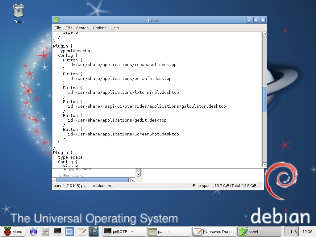

Now, to get this sucker on the taskbar (I liked mine on the left) I put it in the file: in: /home/pi/.config/lxpanel/LXDE-pi/panels/panel near the end. Note this is a hidden directory and yes, there are more than one sub dirs with various similar names - and they don't work for a pi.
I added this:
Button {
id=/usr/share/applications/ScreenShot.desktop
Near the end of the file, before the part that shows running programs and the clock and stuff on the right. It looks like this:
Screenshot taken with this very thing...heh, ain't bootstrapping cool?
