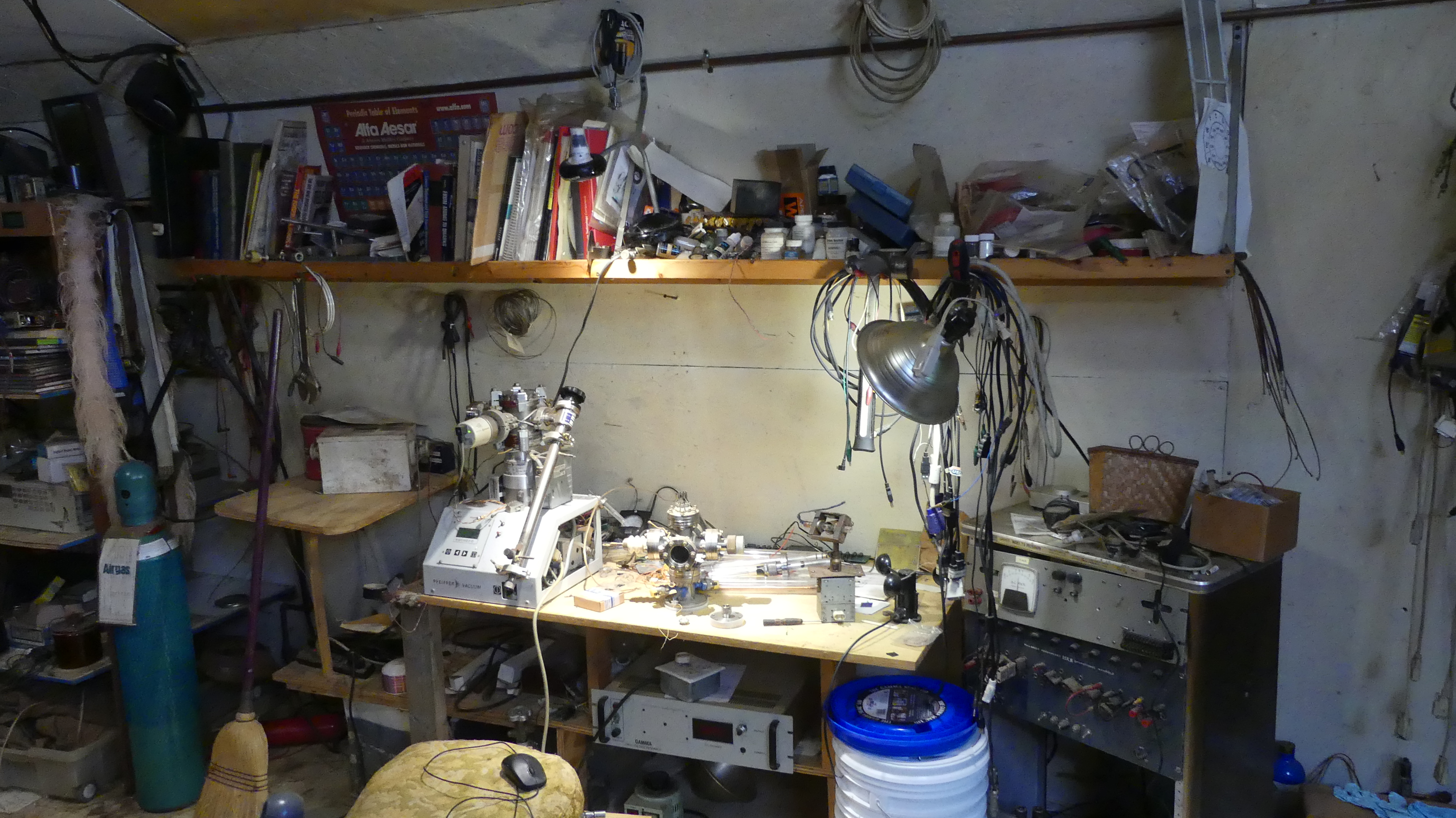

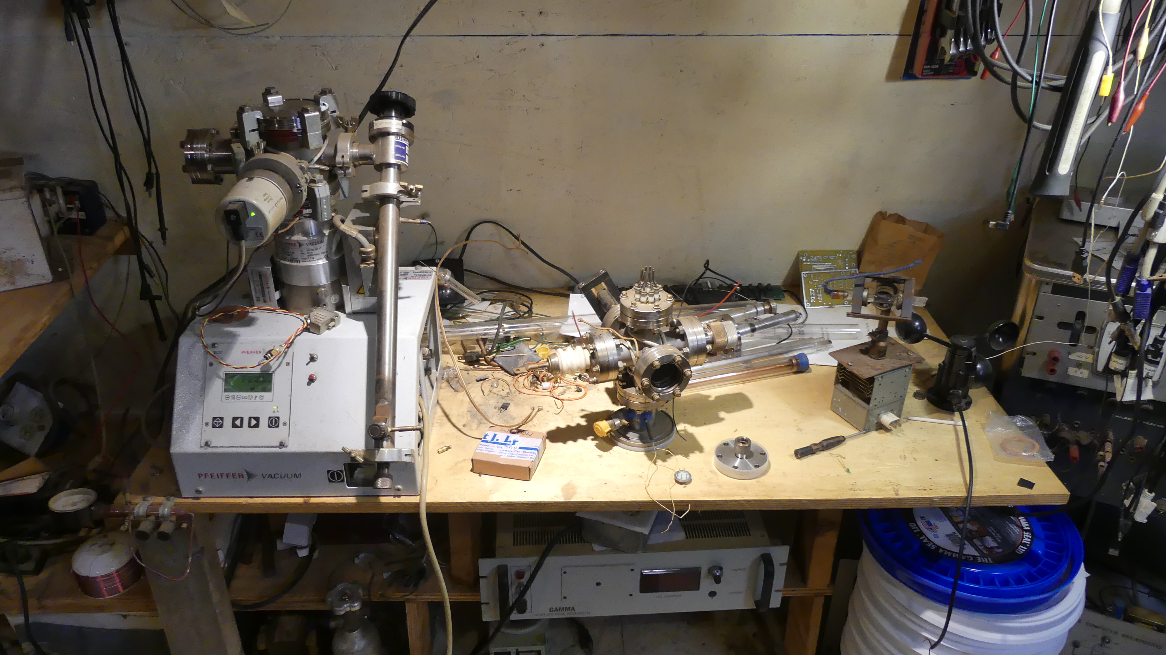

My earliest work was with a smaller pumping station, and I'd built up a fair amount of stuff to hang on it. Rather than disturb the main setup, which otherwise is good, no obvious flaws, by taking it down repeatedly and losing purity - out-gassing is a bear - I'm going to move to the smaller one again, and have been cleaning up and getting it operational again. I've had a couple of different chambers on it, and right now am figuring out what's going to be the best test mule for this set of experimentation and learning. The little 2,75" cross is what I have a ton of parts for, the there's this "ship in a bottle" aspect of working with it much, as well as the tank walls being close in are going to affect the fields I want to apply, so it's not cast in stone yet.
But at least so far, I have large parts of the bench visible, and after 24 hours or so of outgassing just the blanked-off pumping station and gage, it's back to normal (for it) at around 6e-7 millibar, which will be plenty good enough if I can hold it under a few e-6 as a baseline. As any vacuum experienced person knows, surface area is the enemy fortification, and water is the enemy. We'll see what I can get - half of this was QF and that "leaks" water a bit....
Anyway, it looks like this now -
The cross is sitting down on the bench. Lots of adapters and goodies on there, gas inlet valves, feedthroughs, window, wiggle stick...but no room in there!
Everyone needs real tube type opamps, shelves full of exotic materials, and a feather boa in their lab, right?
The upstairs station
Guess I'm going to have to spin up some more and somewhat different data aq and control stuff, but with all the experience and spares from the other setup, shouldn't be any sort of roadblock to do.
Now we want to measure some different stuff, so a new setup is called for - the old hardware is so tied into the other system there'd be no point trying to move it anyway. Here I don't expect quite the possible electromagnetic violence that forced the other setup to need fiber optic isolation either. Even wifi from a newer pi might do...The database server is already setup elsewhere (and in a safer spot) on the network here, and works great - adding another database is not a big deal.
At least I have a plan now. The pause in fusor operations and posting to play with other stuff was to let a plan form on one of my internal back burners....it's a good technique when you can't just force it because of that whole tree-forest and inside/outside the box stuff. As Paul DiLascia used to say on MSJ - when I run into a wall programming, I just go mow the lawn, and the answer comes to me.

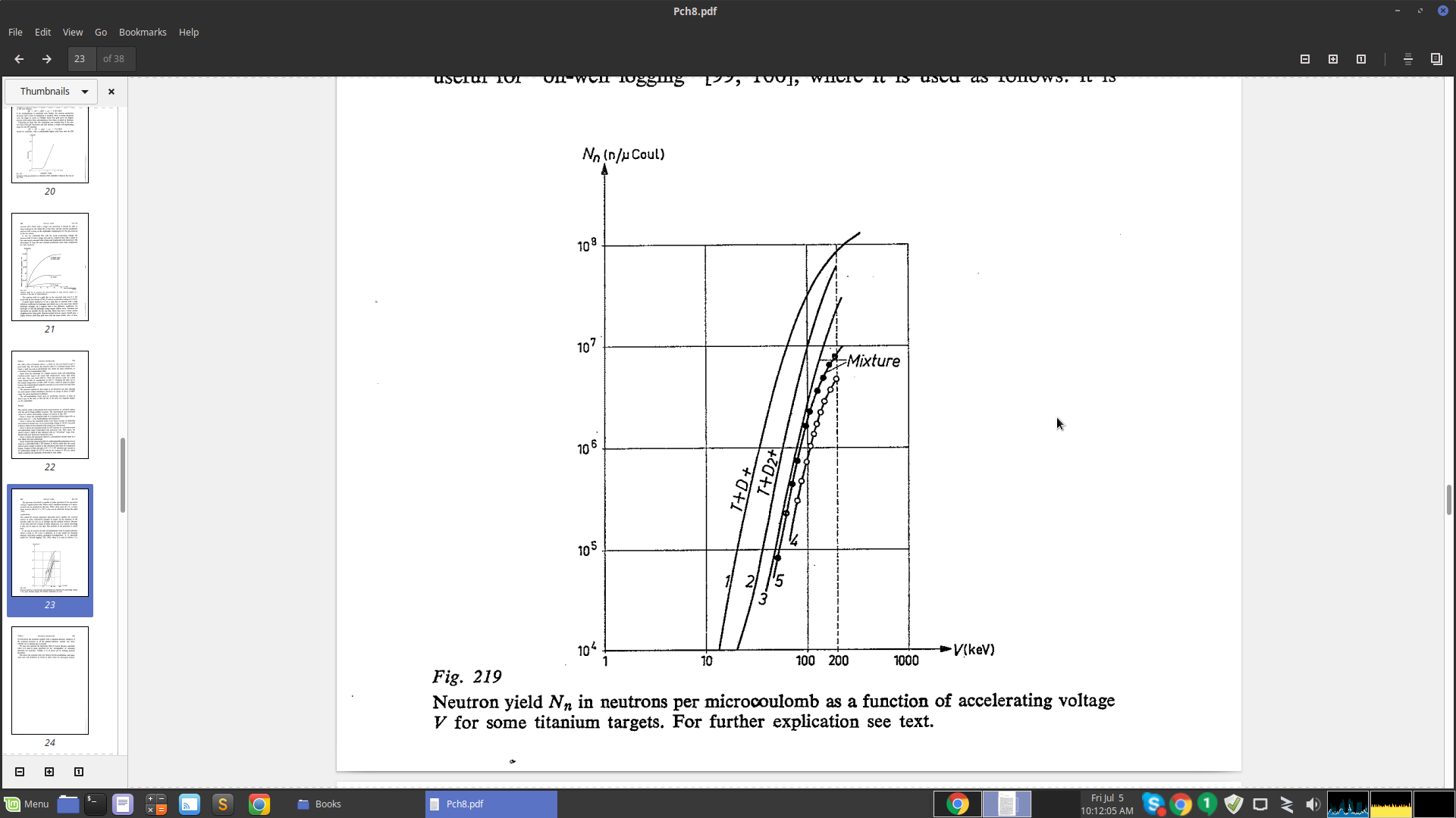

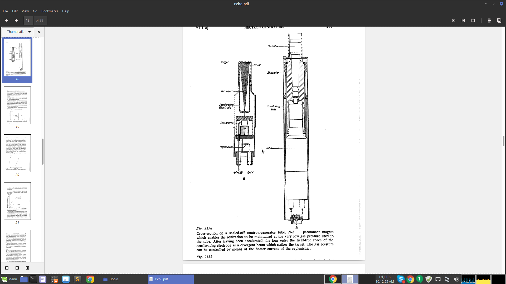

As the Hitchhiker's Guide to the Galaxy points out - the one thing humans cannot survive is a sense of perspective....so here's a couple of screenshots from a Phillips vacuum tube book from sometime in the 50's (I once put the whole thing online, but can't find it now).
Old design for compact sealed off neutron generator (borehole tube). Beam on target.
Note millions neutrons per microamp kinds of output
So, we only have factor 1000 or so go get up to the Q levels generated by simple 1950's tech... ;)
I do note that this plot doesn't show the "power law" kind of curve that ours do. Maybe if it could extend low enough to show our Q levels it's only curved down there, or something else completely different and interesting is going on with our setups?
Ah, found it in the old library: http://www.coultersmithing.com/data/DataSheets/Neon/
This is from Pch8.pdf contained there (along with some nice other stuff).
