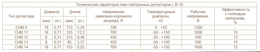

Postby chrismb » Sat Oct 01, 2011 10:54 am
Re: Russian neutron tube data, CHM SNM

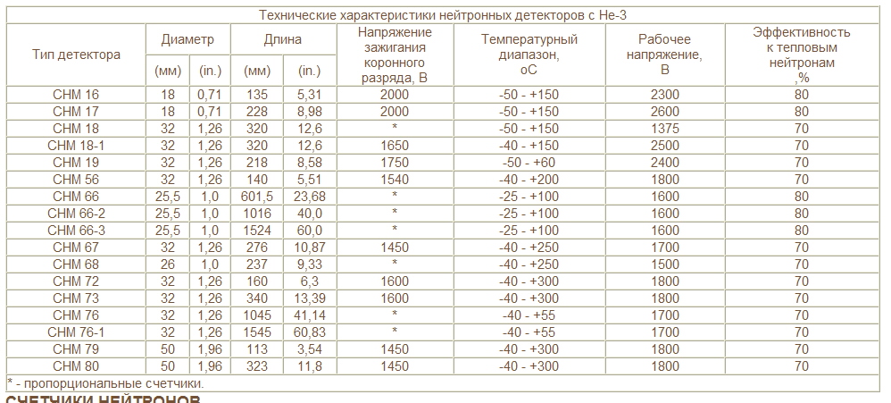

Postby Doug Coulter » Sat Oct 01, 2011 11:00 am
Thanks Chris! I'm re-posting them here as well - redundancy is sometimes good.
He3 data
b10 data
