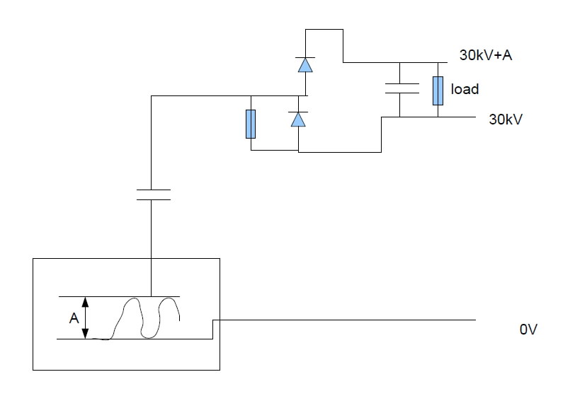

Can you give a bit more on what you're trying to do, Joe? If it is for AC on top of the DC, you may be able to use a charge-pump arrangement, isolated with a cap.

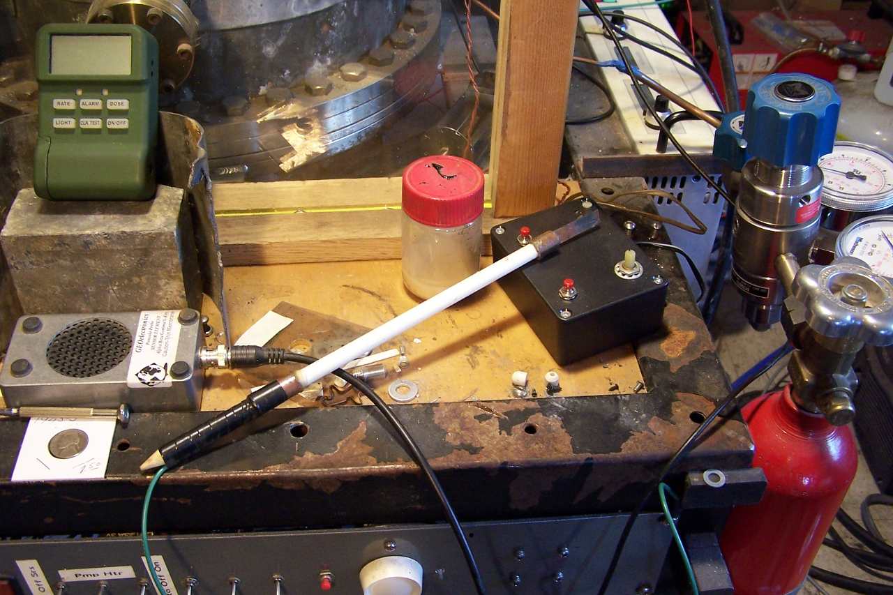

First, the magic screwdriver:
Screwdriver for HV, made of fiberglass. Note ground between me and the business end...tested to 40kv, probably good for more.
I keep this around, it's useful.

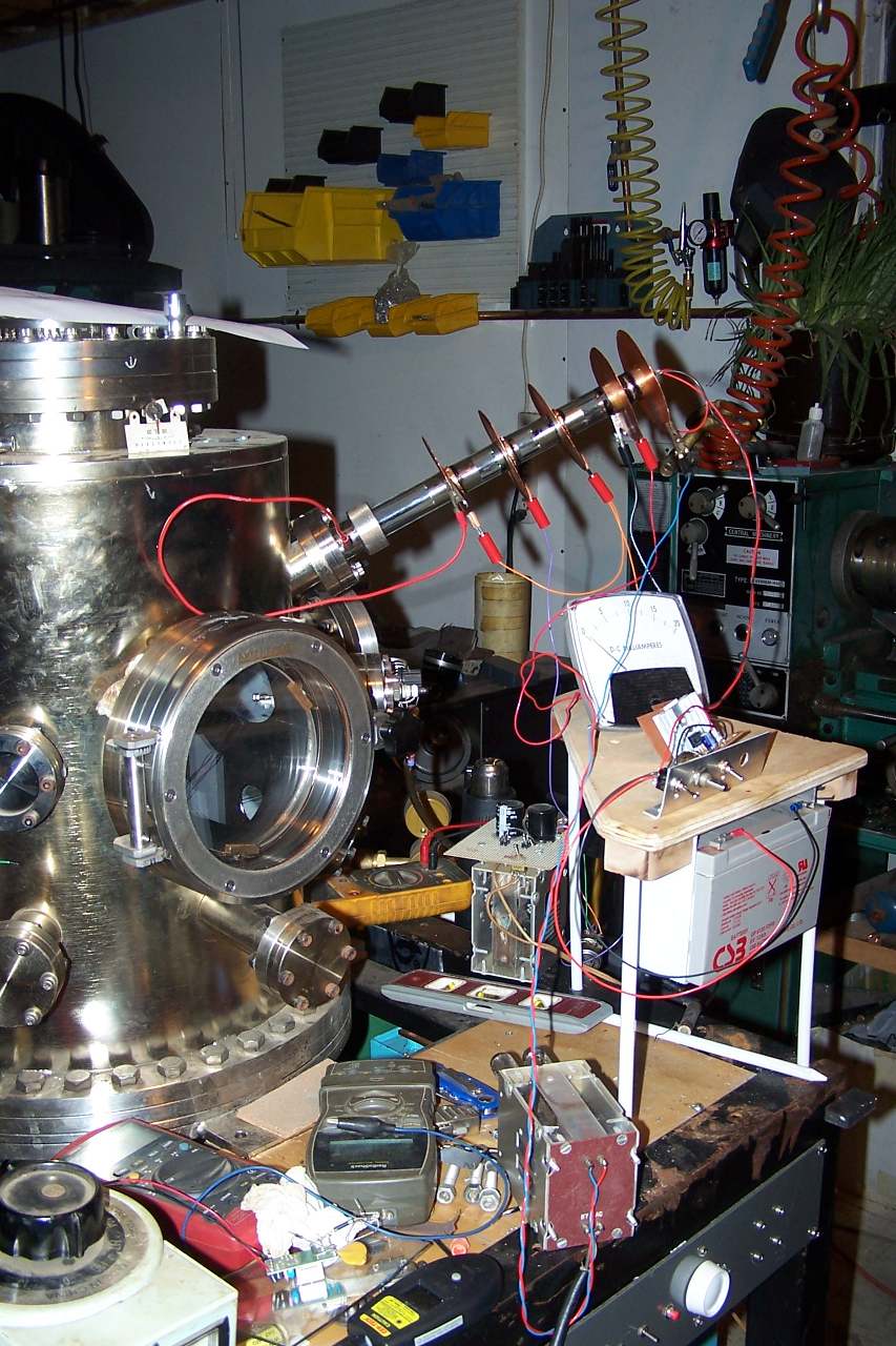

This is the setup I had going then. I used some more of those fiberglass rods to support a little table floating off ground, and used full sized pots to control several small HV sources run off gel cells for the electron gun stuff. I used full sized pots with big slots so it was easy to adjust them.
Overall setup

Like this Joe. [Is this right?]
You can run a charge pump on top of an isolation capacitor to get your voltage bias, recitfying the AC up at the high voltage [or add -ve signs, to taste!!]. If you want AC, just delete the upper diode and parallel cap.
(Turn the volts up slow, so you don't roast the diode)
Re: WTB - Isolation tranformer...
Postby Doug Coulter » Thu Apr 21, 2011 1:11 pm
That should work if the stored charge on the initial series cap doesn't make troubles. If the 30kv is arced to ground bad things can happen at the AC supply end...
Postby chrismb » Thu Apr 21, 2011 1:24 pm
Quite so. Yes, best to add some sort of transient coupling from the top of that AC to ground as a sacrificial short circuit in case the isolation cap has a breakdown, or gets pushed to -ve polarity under a breakdown on the other side. A spark gap or transient diode maybe?
