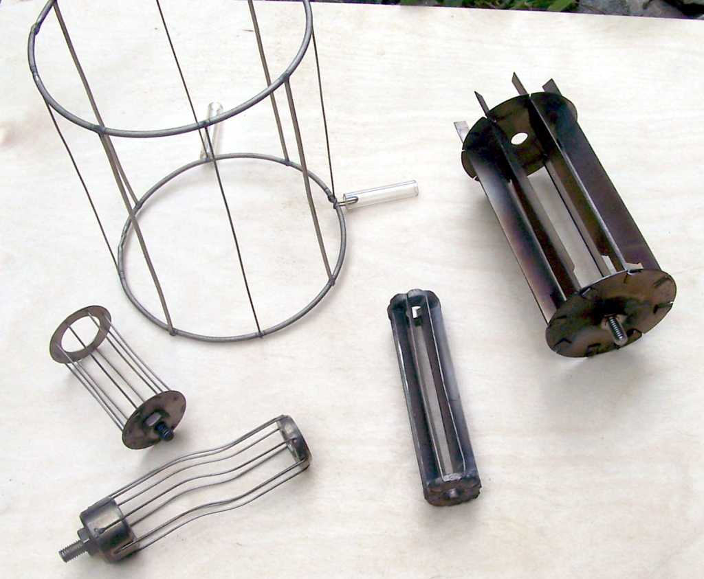

One big caveat -- I stretch the wire a bit to make it really straight for my cylinder grids, and it doesn't stretch perfectly evenly, or relax uniformly the next time it is heated. I've had that trouble with the sheet when I make vane grids as well, even though I just sheared it to cut it. What this means is if you make a grid or other complex shape with this, all welded up, the first time you heat it it will warp and if it's fully welded, there's not much you can do about that. So either design for some slip to accommodate that, or pre-heat it well with say, a propane torch to let it assume its final length before putting something like that together. Best is just to do the mechanical design so that there is a way for one end to slip.
The thin sheet drills easily with PCB small drills at high speeds in a dremel drillpress. You might want to spot it first with a punch to keep the bit from wandering, though. I cut the slots for the big vane grid below on a regular shop metal bandsaw, then cleaned up the burrs with a file.
Here is a picture of some grids, which illustrates the do and don't do things I mention. Click the pic for a larger view.
As you can see, the one in the lower left has sagged from heat - at bright yellow hot, it wasn't strong enough to hold the heavy end washer I made. So, don't do that!
The one just above warped a bit because I didn't do the pre heat before I welded the wires at both ends, but that one has had hours at high heat and at least didn't sag.
The small vane grid to the right illustrates a couple don't-dos -- I TIG welded both ends of the vanes, and it's very warped now. The larger one above, however, has one slip fit end and is fine still.
I used spot welding for that one and all the wire grids, works great. The sharp-eyed might notice that the big vane grid has a non rectangular vane design. The tip for that is to shear them all, then clamp them on the milling machine between two sacrificial pieces of say, scrap steel, then mill them all at once. This makes it fairly easy to do, and they all come out identical.
The big guy was made out of a few different diameter wires, to get strength/weight in the right region. All fat wire and it would intercept too much, but need a few to make it stay together and straight.
