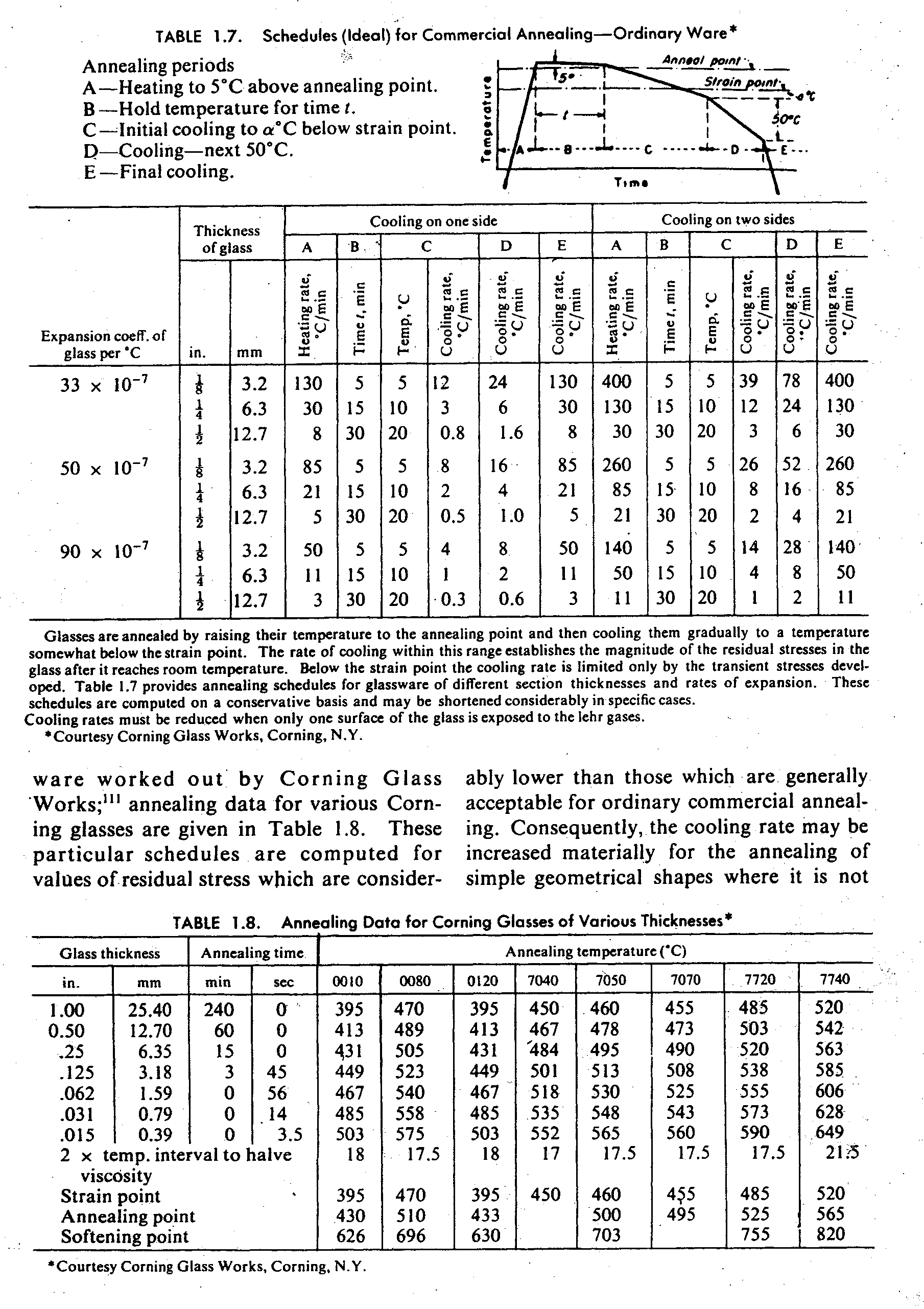

Here's what Kohl has to say about annealing glasswork for a few of the popular alloys and tempcos.
Kohl's tables on annealing
I've used these (and much other info from this source) and yes, this is good data.

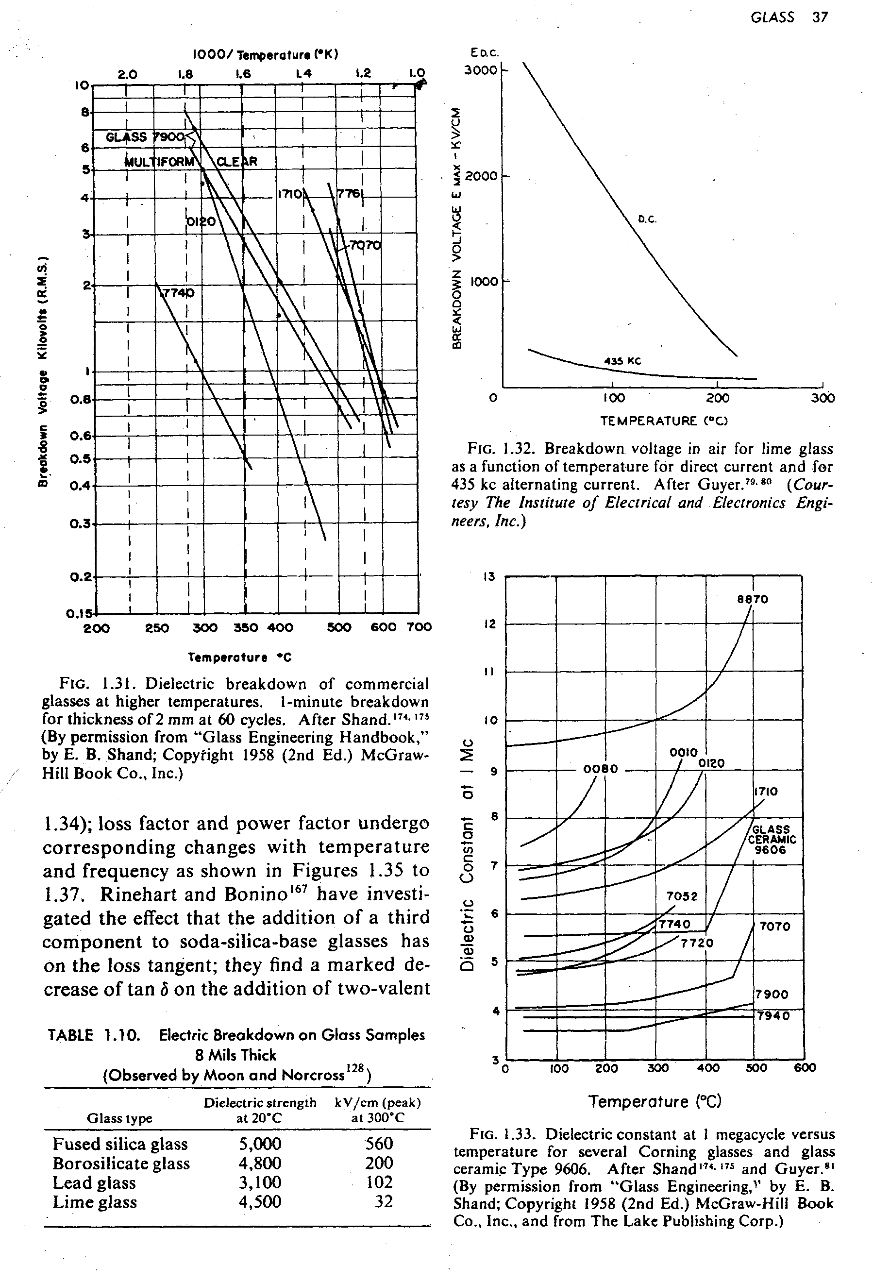

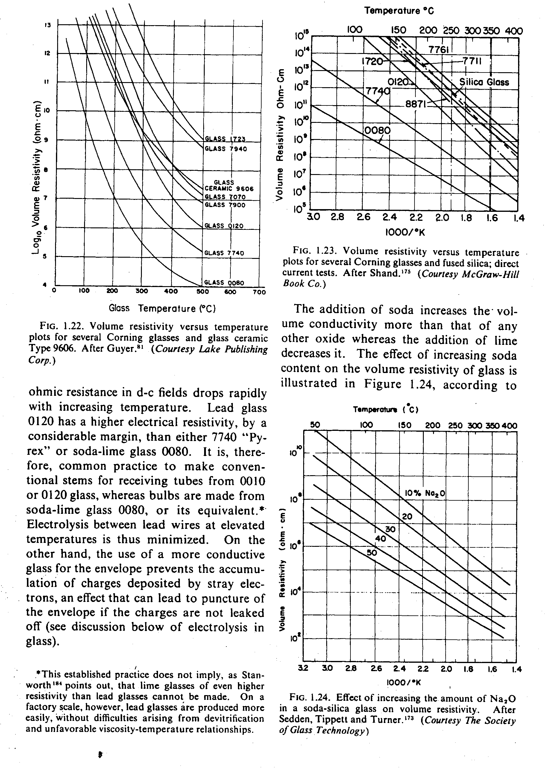

Here's some data on volume resistivity of glass vs temperature. Sadly, there's no one nice table that matches the names to the numbers, but things with a lot of 9's in the numbers tend to be either quartz or vicor, or quartz/alumina.
Bulk resistance of glass alloys

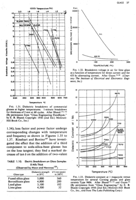

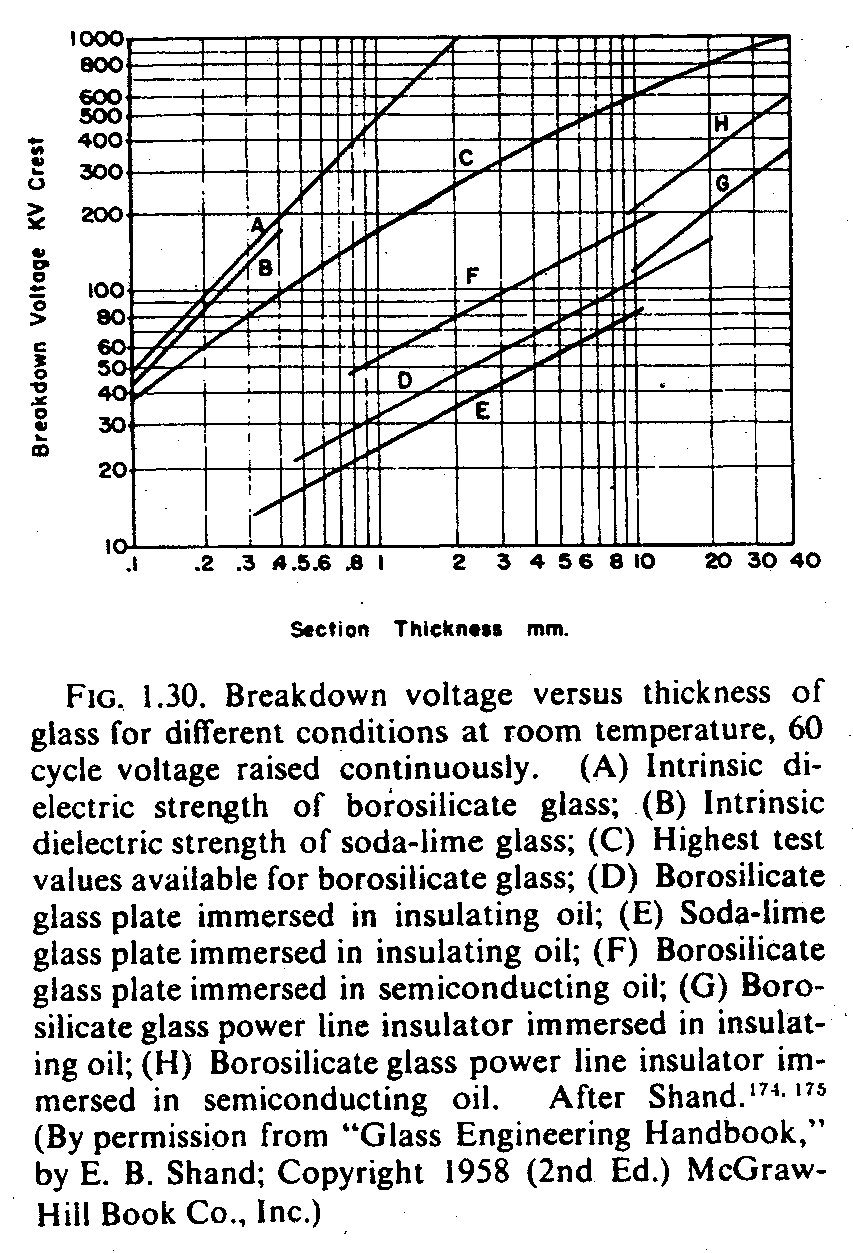

Glass breakdown voltages vs this and that:

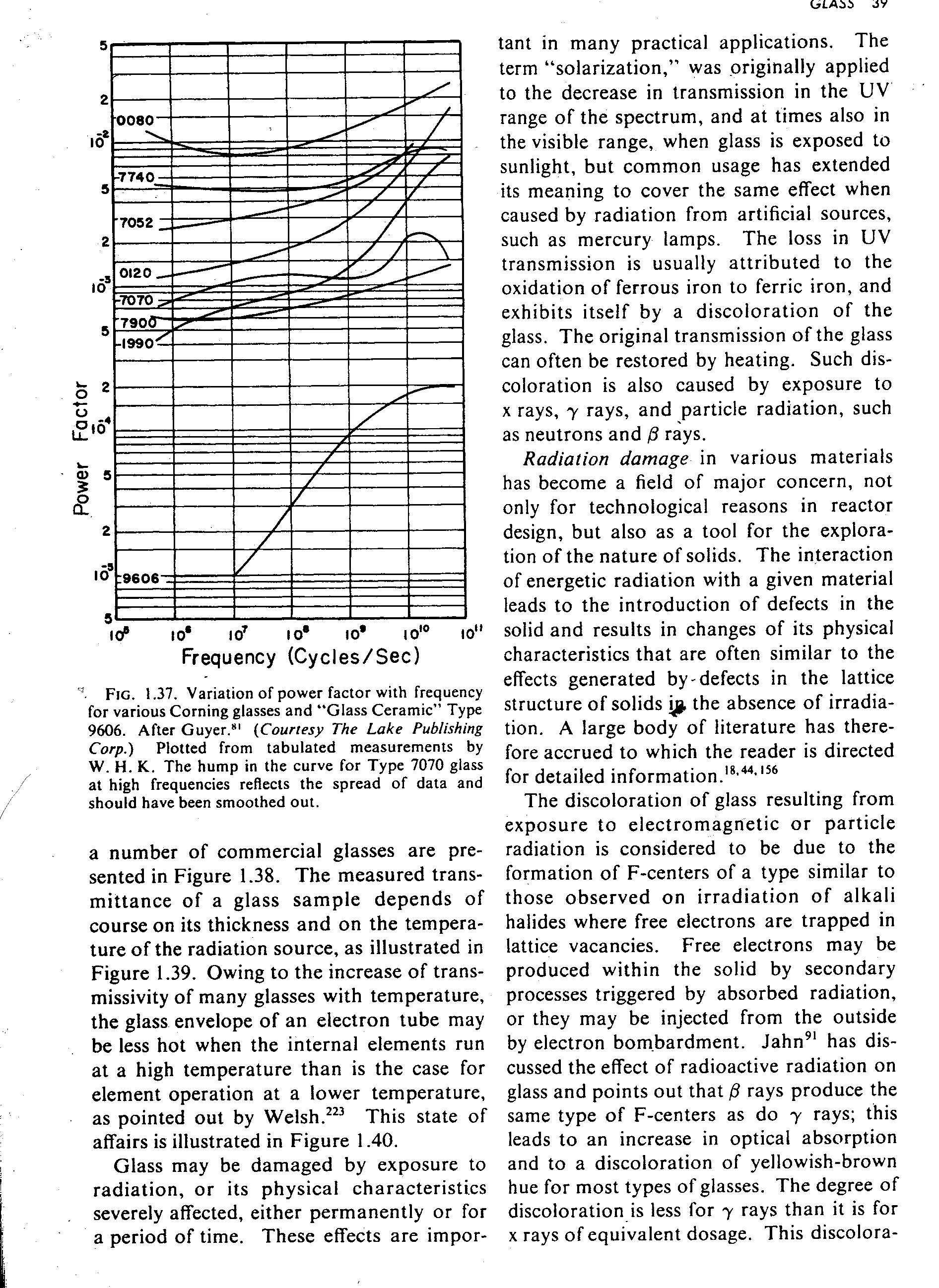

Here's some info on RF losses. It will be obvious why I had to go from 7740 to quartz for the microwave ion source. Losses!
Anyone who needs more, ask. If you're doing serious work in vacuum, note that this is a tiny part of one chapter of a very good book on many materials for vacuum use, not just glass, and you should bite the bullet and buy it if you can find it -- well worth it -- likely to actually save you more than it costs.
