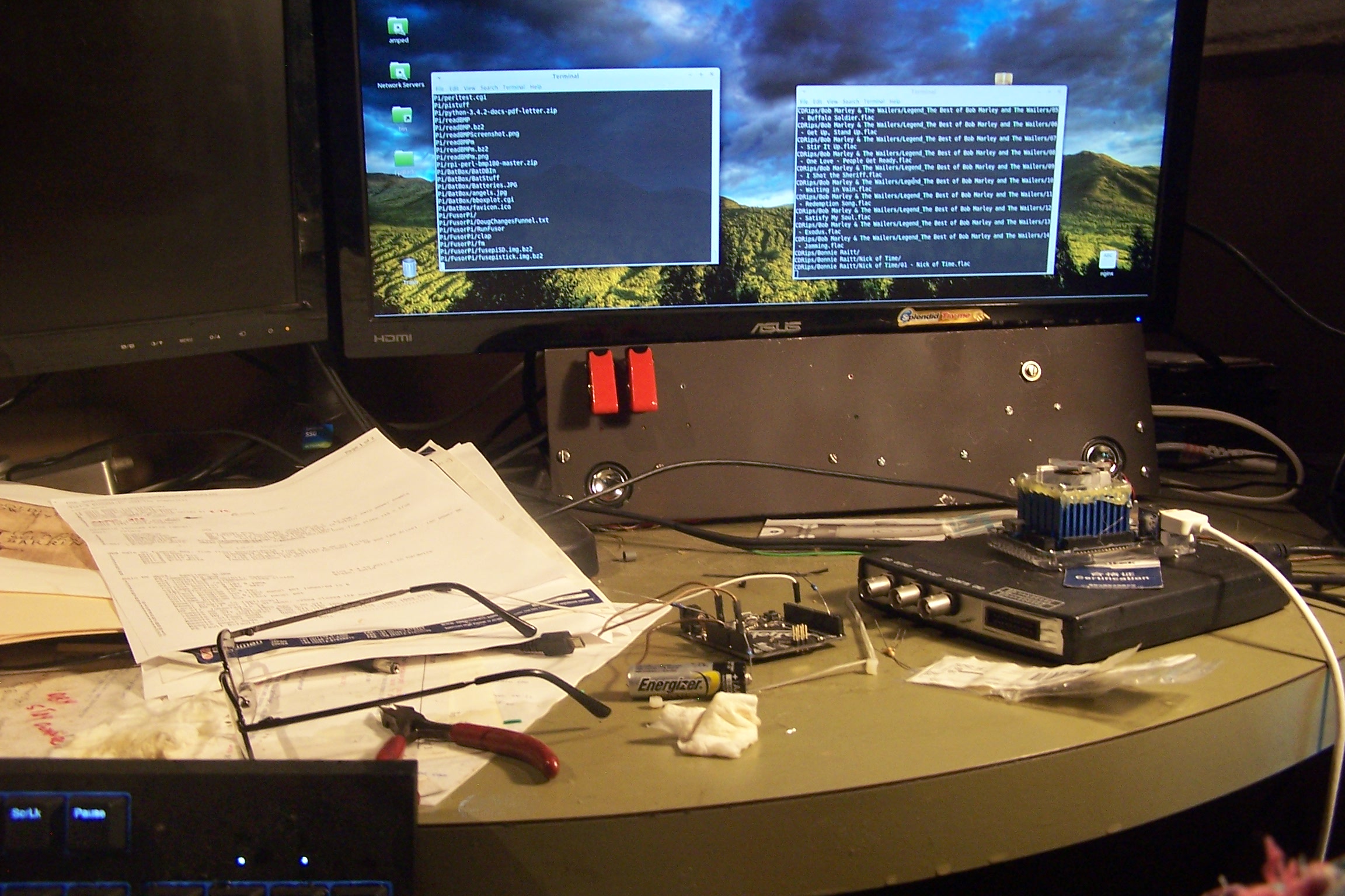

Here's some pix of the op position end.

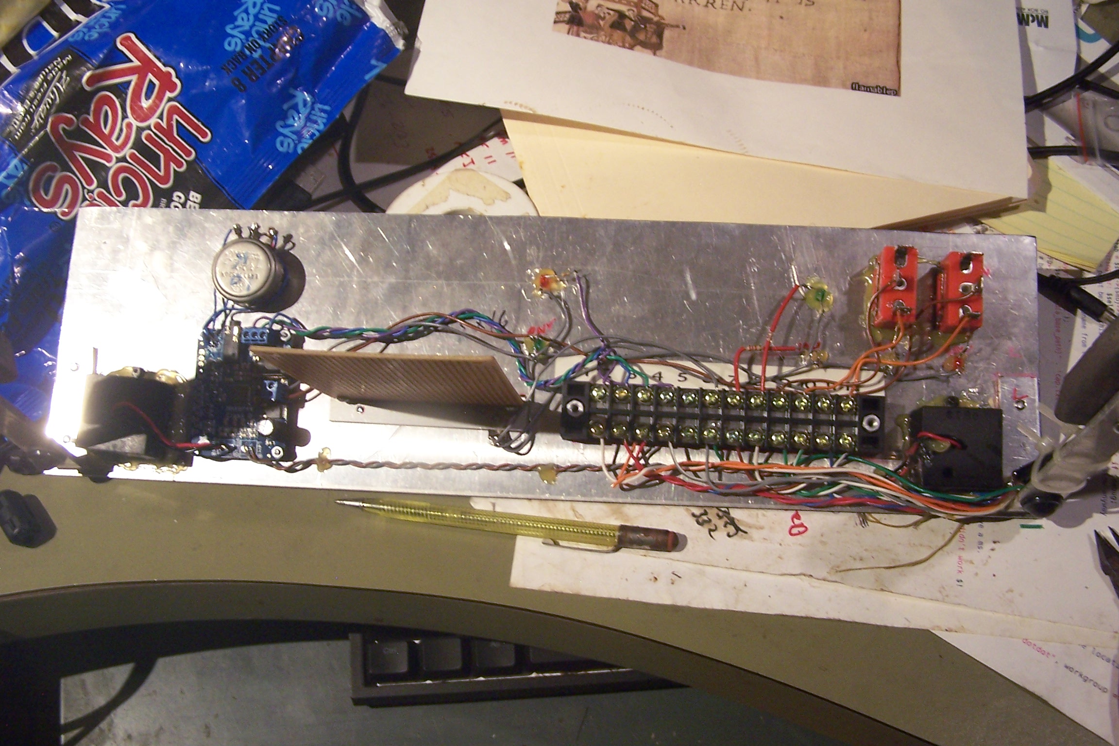

The back side. The legs and lead weights are to make it stable on the table.
I used some of the aluminum I cut from the main panel to form legs and weighted them so it'll sit nicely on the table here. Scottish, you'll understand.
Looks fairly nice in place. All I had handy that wasn't black paint was brown, so it's brown. I won't be looking at it much, or if I do, it'll be to see the leds, which are various of red, yellow, and green for various things.
It's at its home now.
I (duh) didn't know this before. Those sexy "safety cover" switches auto close when the cover is closed. To turn them on, you lift the cover and flip the toggle, like any switch. But from there, you can either flip them off, or just close the cover (even just punch the front panel like the Russian cosmonaut in Armageddon). I'm guessing that since you also see stuff like this in fighter planes, they were designed for high adrenaline situations when people might be somewhat distracted, like a fighter pilot - of a fusioneer who is having great success.
