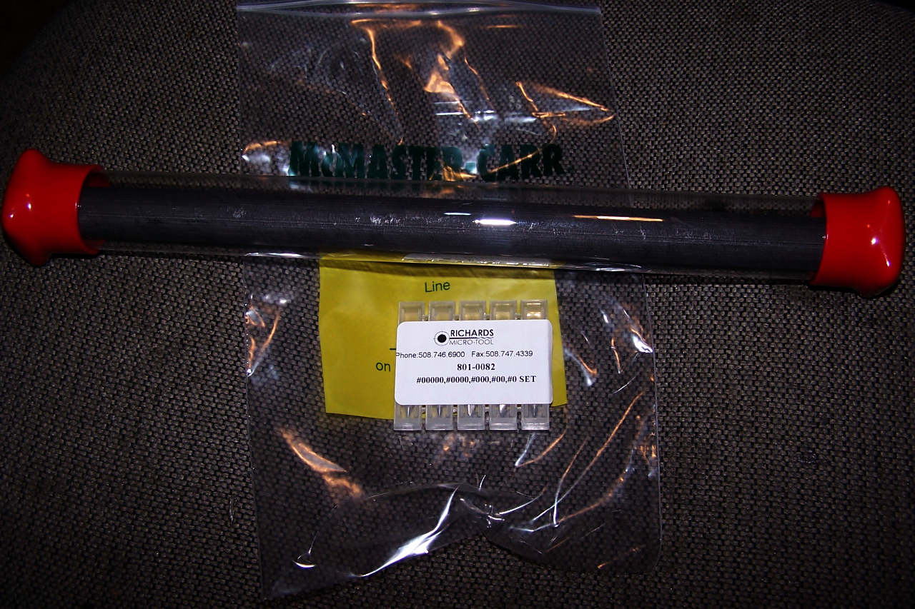

Don't you wish all your vendors were this fast and this good? I ordered this yesterday about this time, and here it is:
Stubby drills and graphite rod - 23 hours after clicking "submit".
The graphite rod is even 5 mils oversize, so I can turn it to the precise dimension. Win! I'm working on something else right now - the MCA project with Phillipp - but I'll get to this real soon.
