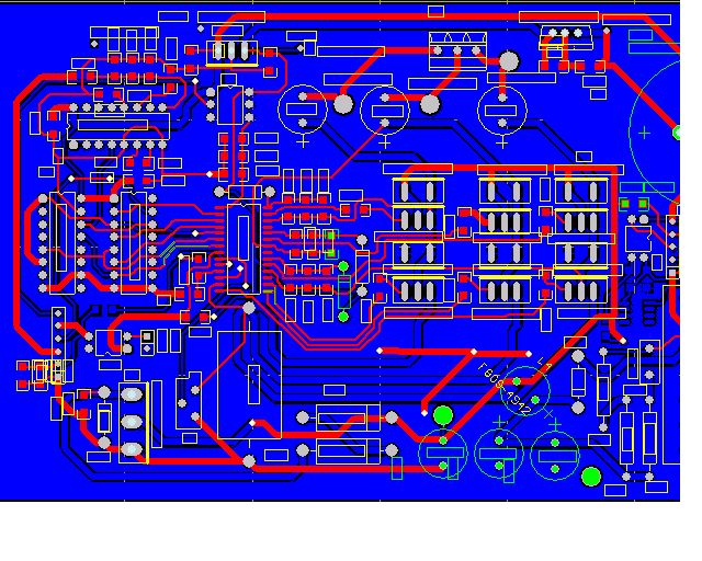

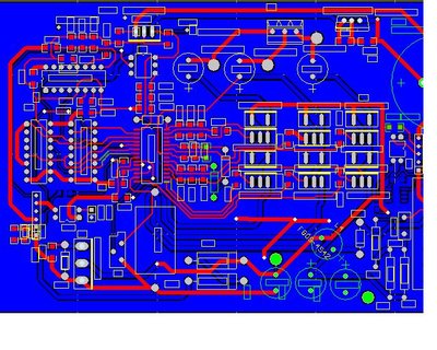

turbo drive electronics looks like this attached PDF
board layout should be like this around the gate driver chip keeping gate signals away from the large circulating currents on the output phases
All should be self explanatory
circuit gets filtered PWM 0-5 volts to 4046 VCO to set frequency into ring counter to produce 3 phase and three antiphase signals for the gate driver chip the buffered feedback freq to the uP = 6x motor drive freq.
the gate driver chip is power on reset hence the optomos on the VCC input to clear a fault condition
component values around the 4046 for 70,000rpm operation.
transformer tap relay shifted by uP @ 0.5 freq.
no heatsinks required for 50L/s pumps but bigger pumps with more current require them . peak current @ start 2.5 amps At 45 volts DC Bus run current 150mA @ 103 volts DC bus
The big FET on the DC Bus is for power stop applications. For this the stop button is pushed twice which switches in the low volt Bus and the PWM 0-5 volt signal is ramped down over 1 min, the motor now turns into a generator pumping up the DC bus to the conduction point of the Zeners on the FET gate the FET is now dissapating the potential energy in the spinning rotor. This fet needs a reasonable mass of something to absorb the heat not necessarily a heatsink.
normal stop is one buttom push to uP and the PWM is ramped down over 5mins at low DC bus volts.

Postby Jerry » Fri Aug 13, 2010 3:45 am
Thats pretty simple. Cant see why it couldnt be modified to drive those cheap pfeiffers sitting on ebay. From the manual I found on them they are two phase motors with the coils in a Y config. (3 terminals) Single hall for RPM feedback and a temp sensor. Probably 24v.
For that you probably could get away with using a couple integrated H-bridge ICs, maybe something like the LMD18200.

Postby johnf » Fri Aug 13, 2010 4:20 am
I think you will find they are actually 3 phase delta connected = 3 wires
I originally designed this for Leybolds that do not use rotor position info ie no hall effect feedback
one of the pumps in the "sacrifices to the gods of high vacuum" is a Phiffffffier (is that enough f's) I'll try and spin it up on the controller it has stuffed bearings and its Phieffer controller faults out about two minutes into windup.
Rotor position is not needed if you use pulse / pulse current limiting that that chip uses, if you are not drawing excess current then the rotor will be tracking at an acceptable lag.
all this can be worked out by measuring the inductance of the motor windings over the frequency range of interest.
a Leybold TMP50 runs at about 14 watts at normal speed on my SEM its been doing that for 1.5 years 24/7 with this controller. The TMP 150 /360's need lower bus volts but lots more current so the I^2R losses are higher but at speed the 360 runs at around 38 watts input
