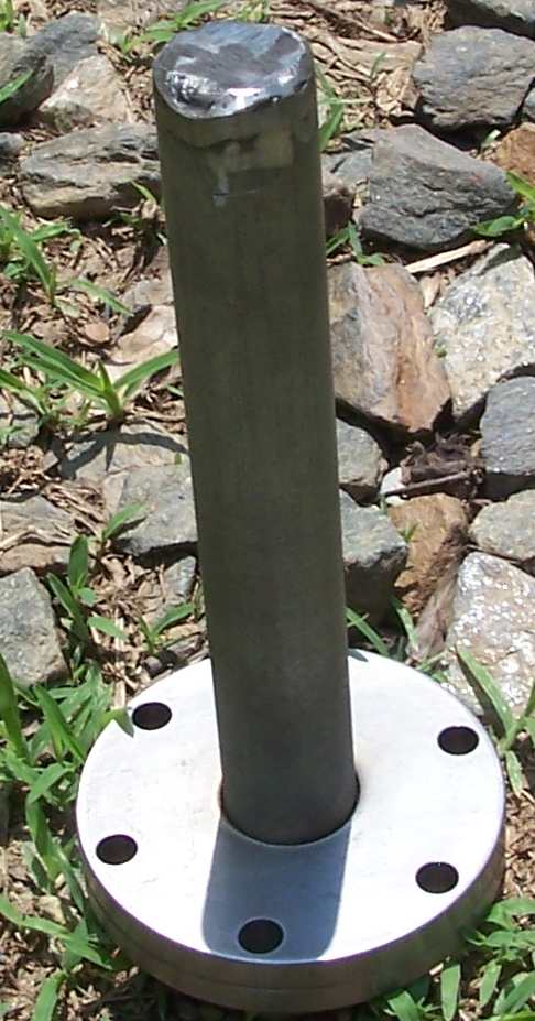

Reused flange and SS tubing welded in
Not the prettiest weld I've ever done (or seen) but good enough. I had some thickwall SS tubing in the junkpile and this flange that had a 3/8" hole in it off center. I put a 1/2" mill in the lathe tailstock to clear up the off center hole, then drilled it for real to fit the tube. The trick here is to not drill quite all the way through, leaving a thin bit left. This gives a flat shoulder to make the tube align straight, and a little extra material as filler - automatically the correct alloy too. This cleaned up nice on the lathe and with some grinding and steel wool on the inside.

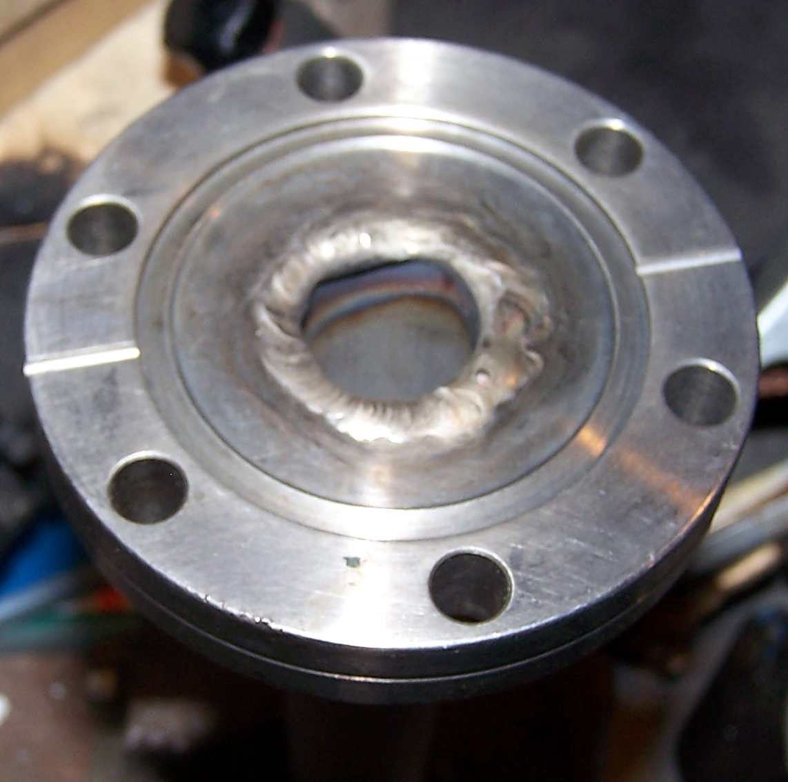

All welded up
I cut a piece of 1/8" SS plate to weld over the other end. Ugly but tight, and it also cleaned up nice on the lathe after. I should remember to do a practice weld first - it always takes me a minute to remember the technique.

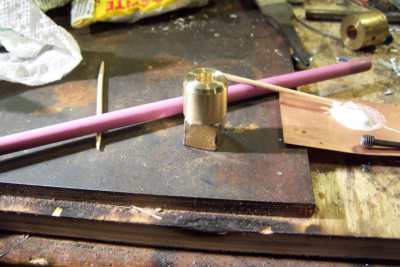

Magnet and rod holder
For various reasons, I wanted an insulated actuator, both electrically and thermally. The thing is, ceramic is not your easiest to work with material. I had a grade 50 NeFeB magnet that fit in the tube nicely (this piece of tube was wierdly sized), but didn't trust gluing the rod right to the magnet, so I made a rod holder with a setscrew to glue to the magnet. In the picture, the magnet poles are left and right, so a single yoke can do all the required motions -- push pull and rotation. I used brass at this end as it's a non galling material against SS. I'm still thinking about options for the other end at the moment...probably I'll make a few different ones for different jobs.
More when I finish and test this thing. It has plenty of strength out in the lab air, a little sticktion, but should do for target positioning. One reason to insulate this is to have a wire off the target holder for diagnostics -- measuring net current and so on, or biasing the target. Or faraday probe -- whatever.

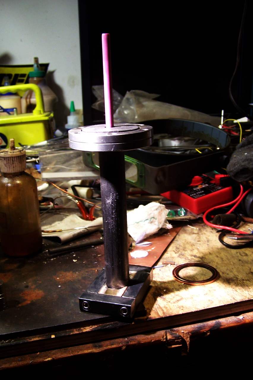

Another day, another little bit of progress. I made the magnet and yoke for the outside, and a viton gasket as this might be the main port that gets opened on the new system. Yet to do are cut the ceramic to the right length, and make a holder for the end for whatever it might wind up holding. Pretty much anything I can devise that will take a 1/4" rod in one end.
No claims on the magnetic design here - I just needed a handy way to hold the outside magnets, with a side of keeping the stray fields down a bit. These grade 50 magnets are way overkill for this - several kg of force at least, but I had them and they're the right size for this. I'd originally bought them for the cyclotron project, but found it more or less impossible to gang up without things flying apart - even with some special tools made to make that attempt.
The stick, almost ready to install
I also painted the outside of the SS tubing with graphite dry film lube so it's easy to slide without a lot of stiction.
