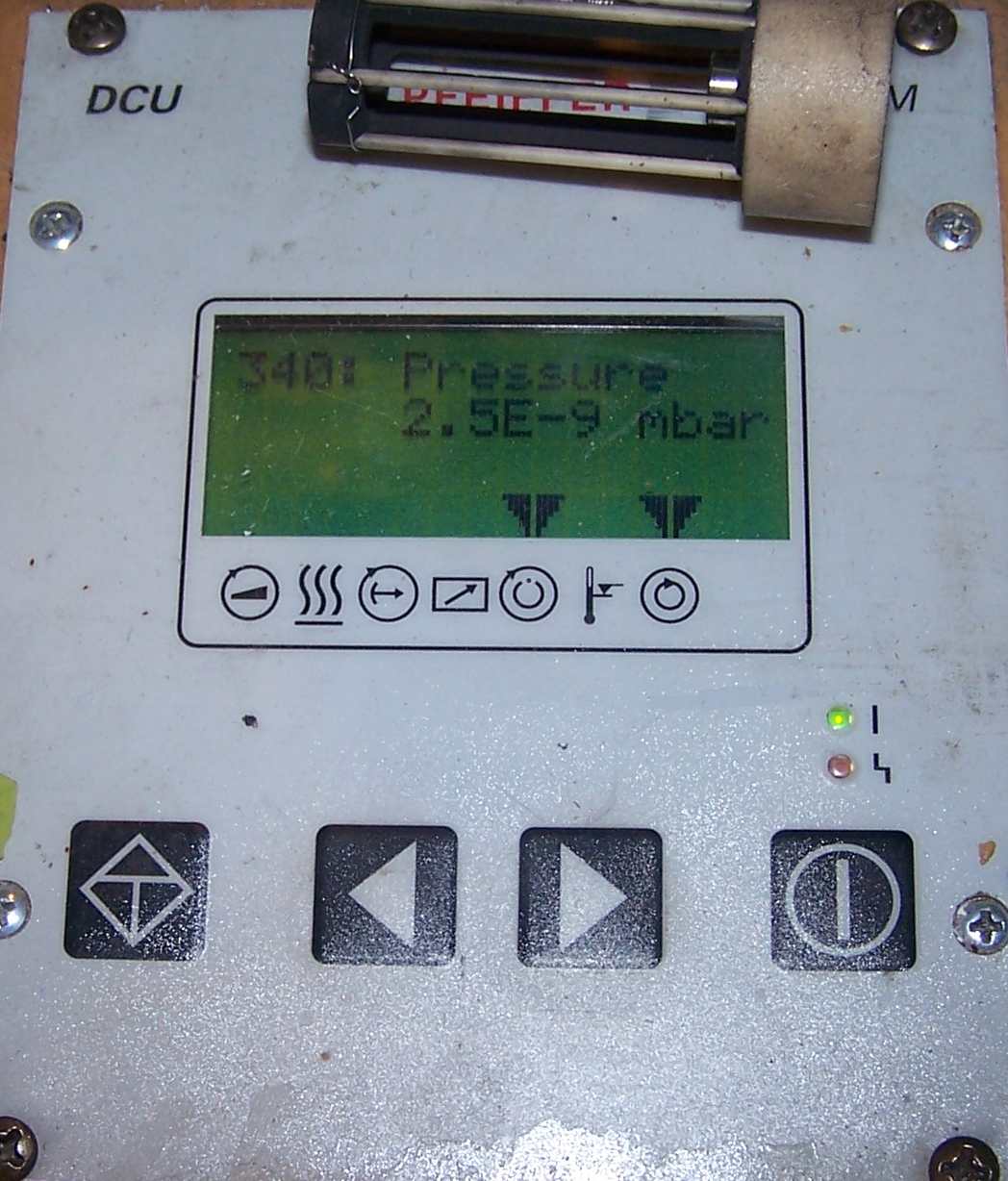

OK, so I've fixed the leak and now I have super nice base pressure. See pic!

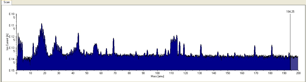

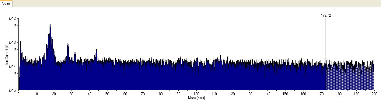

Since that made it purty for the mass spec, I made a couple special runs at very slow speed (1 sec/amu) while hard-baking and after. My hard baking is 2kw worth of quartz heaters at full power, which make enough UV to break up water, and make everything in there very hot very fast. I probably pused a little too hard here and saw some lines from things in the tank decomposing (even lines from the solder on my LV instrument feedthroughs). Maybe a little oil from when I had that motorized throttle valve in there too, who knows.
Then I let it cool off and took another spectrum.

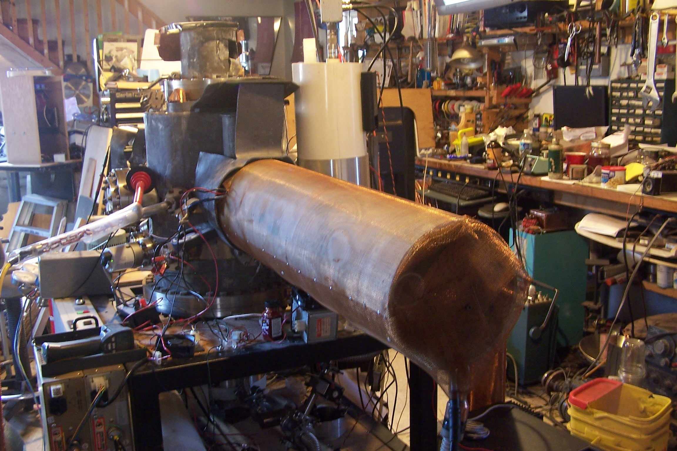

Now, one last problem to solve. How to have EMI shield that I can put on by myself. So I made this thing, which was more work than it looks like. I had to heat-stretch a piece of 8" PVC from the junkyard to fit an 8" flange (the pipe was about 1/8" less ID) and final sand to a snug fit. I drilled and tapped the flange for a 10-32 bolt to hold it on, and re-jiggered the inside ballast resistor insulator and air channel for it all to fit together. The result was worth it, however, as now I have zero exposed HV wiring and no EMI to speak of at all anymore. The pure copper screen and good grounding scheme sees to that one.
