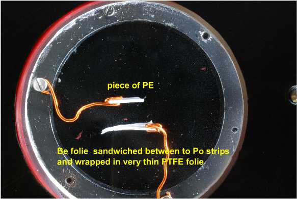

like You proposed I use the two strips of the static master on both sides of the Be folie and wrapped the whole in a thin PTFE folie to held it together. After about 200 shots I didn't see any evidence of neutrons.

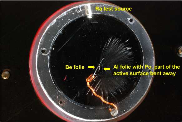

I also used a simple sandwich and bent away a small part of the active surface. Here the alphas a readly seen but nothing hidden by a neutron
But I don't wonder about because the chamber I use is a Wilson chamber which has a sensitive of about 0.2 seconds and a repetion rate of about 2 minutes, so the active time is short. I have to do much more shoots. I also have a longtime sensitive diffusion chamber, perhaps I should make a try with this device, although it's less sensitive than the Wilson chamber

Of course the cross section of the atmosphere, mostly air, in the chamber is low. Perhaps I should make a try with some other gas, perhaps even deuterium, if I'm realy shure that there are no leaks in the chamber.
But for the next I will buy a power supply for my nikon kamera (I can't build it myself because the camera has a very strange conector) so I can run the chamber for some longer time. Because the chamber and the camera are controlled by a PIC processor I can run it for some days and make some thousand shots if I use a external power supply for the camera until the sd-card is full.
