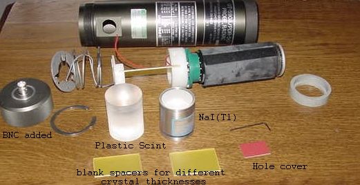

As the project developed, it became obvious that this probe case and PMT could be used with a multitude of different crystals, for testing
and actual radiation detection use.
As mentioned, the original crystal is only 1/8" thick at most, but there is
room for at least a 2" long crystal if the small un-needed circuit board is first

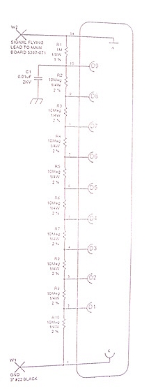

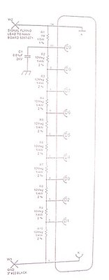

removed from the housing. Rewiring the base to a standard 950+ single coax
feed like we use on all our probes was easy, and a BNC was added to the rear
cap, once the handle fitting there was removed on the lathe ( a hacksaw will suffice). Removing the original RADIAC
electrical connections left a hole on the side, which was covered with a small metal plate attached with black epoxy. Be sure to use a light tight cover here.
Inside the original probe is a circuit board which contains preamplification and energy discrimination functions that we do not need.
By removing the circuit board, space is made for different thickness crystals with the original total overall length retained by the use of blank spacer plates in its place.
Also on the lathe we turned the square block of plastic scintillator into a cylindrical shape, being
careful not to scar up the polished ends. Turning the scintillator plastic
on a lathe is very similar to any Plexiglas type product, you just have to
use a sharp tool, and keep the speed low so friction doesn't melt the
plastic and mess up your work.
Once the final shape was achieved, the thing went together just as if it had
been designed that way from the beginning.

Schematic:
http://www.qsl.net/k0ff/DT-590%20Probe% ... 4_32_1.jpg

12 pin base rewire
Multiple Scintillator Crystals and their associated spacers.
